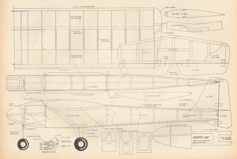

I think it was a mid '60s design
Spot on FB - Bud Atkinson's Aristo-Cat published MAN May 1964.

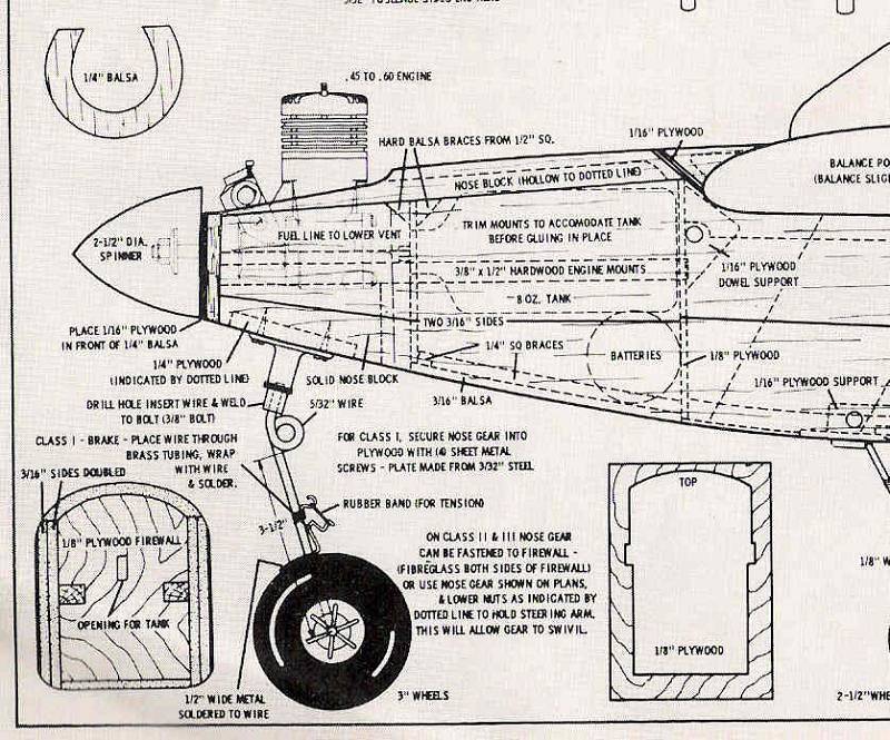

I like the size of the nose wheel on the Penetrator; and it appears as if the nose gear is mounted forward of the firewall.
Tom

Tom,
It's done like this - rather unusual.

Thanks Ray. I bet that would withstand my 'carrier landings.'

Class I airplanes have a larger nose wheel and swept back strut to help cushion the landing. Without an elevator to raise the nose for the landing flare, it must be accomplished with the addition of a small amount of power at just the right time to raise the nose for the landing. Without the short burst of power, the airplane makes a hard arrival. Most Class II airplanes do not require this method.

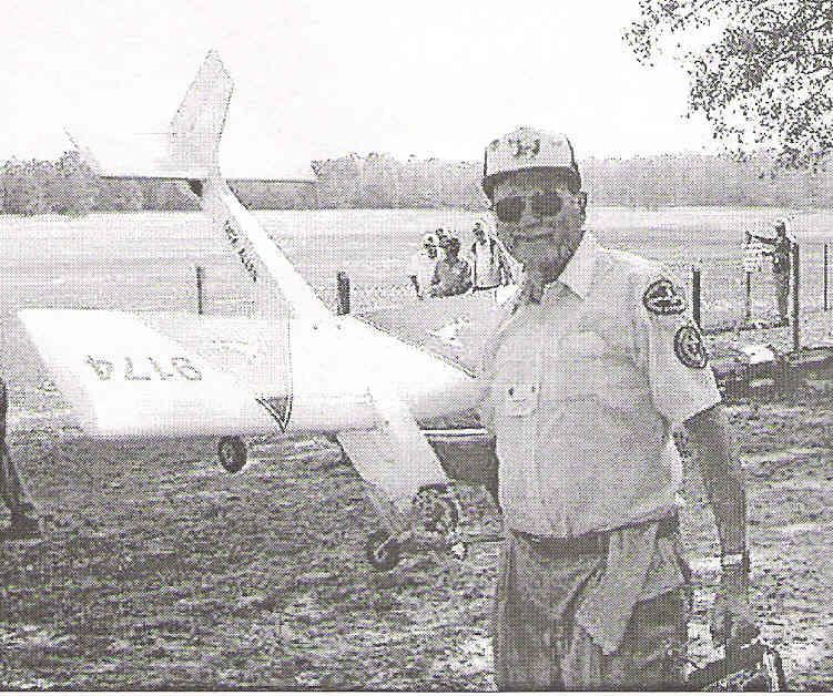

Jeide - II Perfection plan from [link]http://www.rcmmagazine.com/store/store-plans-catalog-tem.html?item=plansl-327&sid=0001T58tFI1KdGgbck9b922[/link]
This is Dick Allen with his Stark Shark considered by Art Schroeder to be "the best rudder/elevator model ever"
If you do opt for the II Perfection the secret of success is to build it with a light wing. This is true for all models of course but especially so for the Perfection. I base this advice on having built at least half a dozen of them for myself and other people. One used an obechi veneered/glassed foam wing and flew like a pig. The best had a built up wing covered with 1/16" contest grade balsa. The contrast in flight between them was amazing.

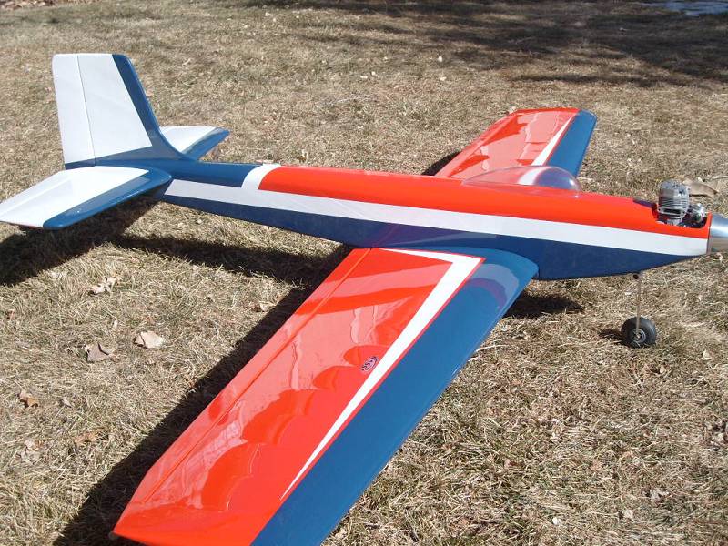

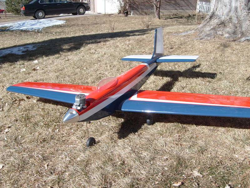

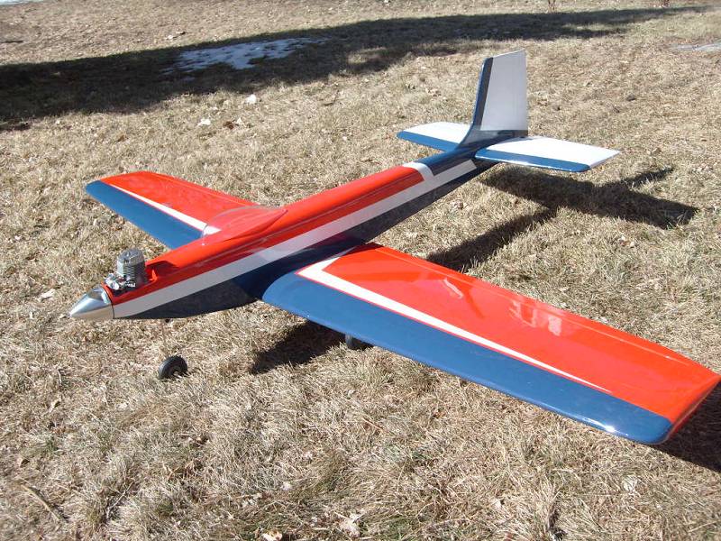

Hi Ray.Thanks. I will build it light. My Daddy Rabbit built from the original plans is 5.2 LBS ready to fly. Jim
