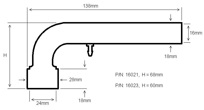

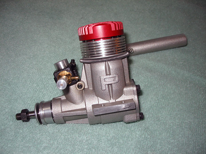

I traded an engine for this NIB Picco .60. I'm waiting on it to arrive. Has anyone owned and flown one of these? I understand they are very similar to OPS's.
The Rossi header should fit since it has an inside diameter of 24mm and my Picco's exhaust port is 22mm in diameter plus the thickness of the rubber o-ring. I imagine I can try different o-rings until I get a snug fit.
I'd appreciate any info about this exotic Italian critter.

Hi! these engines are stronger than OPS. Run it with 20% castor and 5% nitro. I used to fly it with 11*7 1/2 prop.

Thanks windcosmic. I'm glad it's a strong one. I heard back from Sahak, the proprietor of Rossi USA, and it looks like the Rossi header will work fine. I might need to try different o-rings until I get the best fit.

Sure with 22 % of oil the engine will last longer. My picco had the slide carburetor type that fitted the OPS,too . Anyway, this Picco .60 is one of the last .60 produced by picco, so i am anot sure if it has some parts which are interchangeable with OPS. I am sure that the two piece cranckcase version (the older) had the front end that could be mounted in the OPS and the conrod was identical,too.

I flew a couple of Picco 60 engines in the early 1980s. The engine design did not change much, but the carb on yours is the newer (super tigre-like) design.
Nothing at all mysterious. They run well.
Yes, the rossi headers do fit. R4 plug worked nice.

The Picco arrived along with the header from SG Rossi USA. It's a perfect fit.

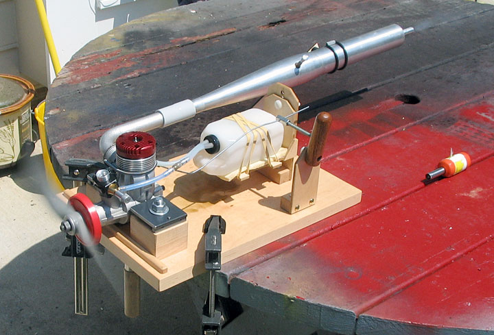

Wow, that was exciting! I just ran my very first tuned pipe. It took me several minutes to find the right needle valve setting to get it running ( don't have the engine's manual). At first I used the pressure fitting on the Rossi header and the rpms seemed to pulse; I didn't have it leaned out, either. I switched to the pressure fitting on the pipe, which is just before the widest part, and it really smoothed out. Man, this thing howls at WOT! I used an APC 11x8. I have read that pipes make needle settings more critical and this seems to be the case with the Picco. It didn't take too much turning to make it jump to a lean setting.
I haven't even started taching it or cutting the header. I will need to do this at the field since it's a bit loud for the neighbors to tolerate for long. Even at the stock length you can tell this thing is really screaming.
I need to find out the thread size of the crankshaft. I didn't have the correct spinner adapter to use an aluminum spinner, so I used a Goldberg plastic spinner. That was a mistake as it kept flying off! So, if anyone knows the thread size I'd be grateful. I want to use a red anodized spinner nut which will match the head.[8D]

A properly setup pipe will still leave you a pretty broad needle range. Should not be difficult to set up at all.
When you tweek the pipe length for the most possible rpm, then yeah, its a narrower needle range. But in general you do not want that for a decent pattern plane.
Glad to see you enjoyed the experience !
And yeah, the plastic spinners like that are best left for an an FP46. [&:]
