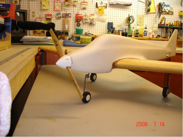

I have to get this VI finished. There are more in the attic, but I have carried this one around for 30 years, 10 re-location's. Will use Rossi 60 for power, Spring-Aire's, altho I have plenty of Rom-Air's.
It is still intact, and only problem is the skin's have separated on the stab cores. Wing is fine, but it had been glassed.
Have to move the NG down to the tank floor bottom for clearance of wheel into wing LE, 3/16". Not much sticking out, but want it to be smooth, hid when retracted. I have purchased many pairs of Kraft wheels, and have enough now for a lifetime. Little heavy, but so what, great wheels. Pictures here show retracts and wheels on, checking 12" prop clearance to terra firma.
I will take pictures as I move along, but not every tiny thing as I did with the Intruder's. Same paint scheme. DBrown or Tru-Turn metal spinner will look good on the front.

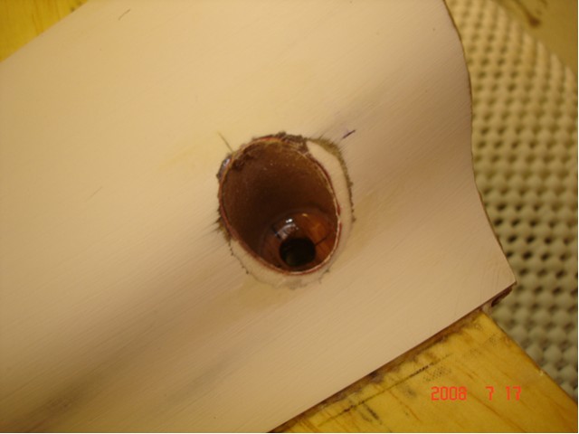

Moving along. Tubes in and dried overnite. File then sand off to even on pan. 8178 advised to use CA on the cardboard tubes, and a better idea then the swipe of epoxy I initiated. Sanded most of that out, and applied the CA for resilency. Hardened up fine.
Enclosed photos also show a hair spray can with the glass cloth. I use the hair spray applied liberally to the cloth, drys fast, and stiffens up the cloth, making for better cutting and applying. No angel hair flying around, no problem with glass resin.
I used a couple of pieces on the tank floor.
Next up, attach wing, with Saran-Wrap sandwiched under the wing and saddle, to keep micro-balloons and epoxy from oozing down when mating filler up for contour of wing to fuselage, front and back. Let this cure for a couple of days, then back to it.
I was slow getting this Phoenix back to finish, just kept looking at it, making excuse's why I could not finish it. Built the two Intruder's, did the build threads, (re-built the ARF's I should say), on RCU. You probably have seen one of them in the background of these pictures.
I am enthused to get this P-6 done, then maybe get on one of the other Phoenix' or Vertigo here. Should have this fuselage ready for primer by this weekend, stab glassed, etc., ready to go.

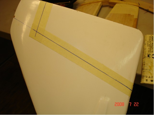

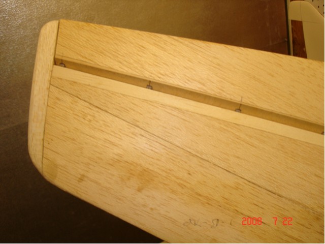

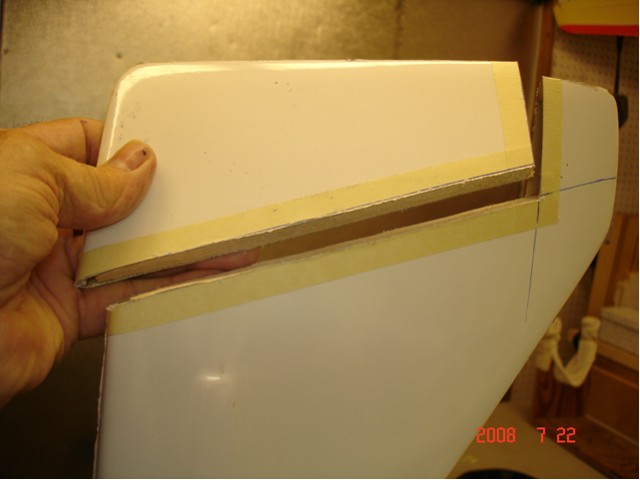

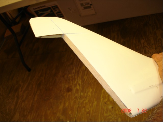

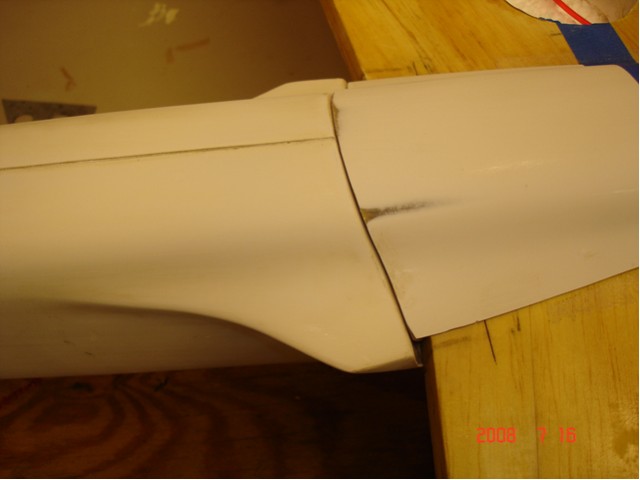

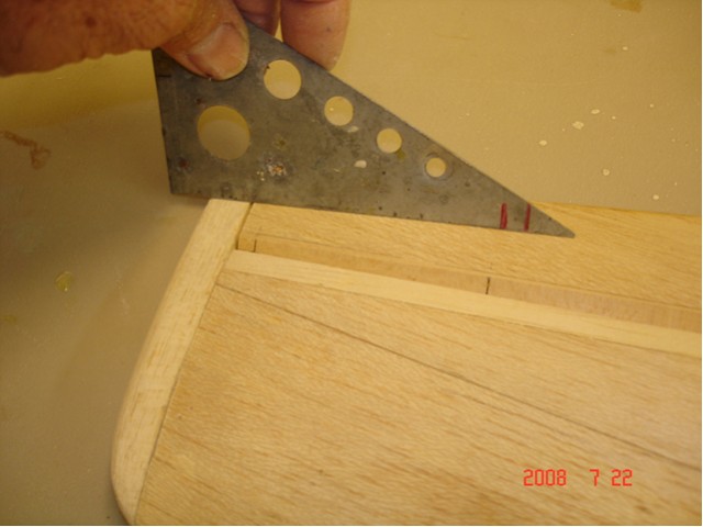

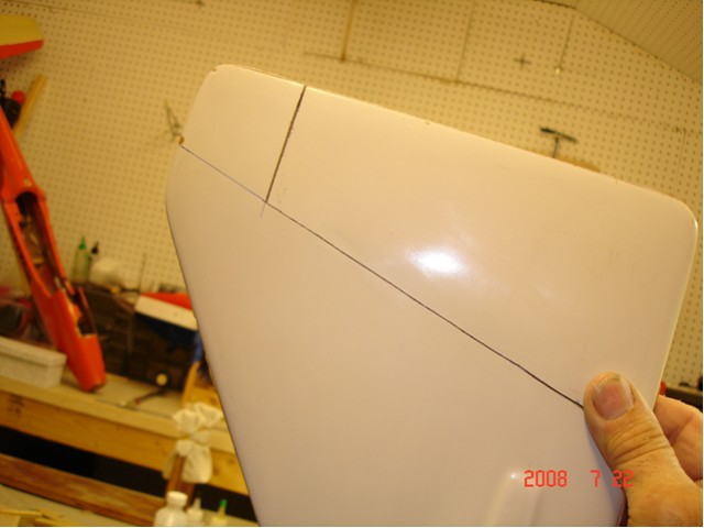

[b]I was going to stay out of the plane shop for a while, but decided to get this stab finished and secured into the tail, then let it set for a few days while I get some work done around the ranch.
Attached pictures, the 30 minute epoxy standing by, use it to re-attach the skins to the foam. This has been sitting for some time, and the contact cement gave way a little. If this had been finished and glassed, this would not have happened. Brush the 30 minute in, put on the wax paper, then wrap with tape. I try to use 3M or Scotch tape. I don't know if it is made in China or Formosa, except I always buy a name brand product. You pay a little more, and the QC is there. Better all around.
Epoxy in, tape, set aside. Picture of elevator's here. Using Robart's on each, and will do same with wing. I can section these hinge's a little, get the surface's closer to the stab and wing. Plenty of alcohol nearby for cleanup of epoxy. You can also salvage the throw away brushes after epoxy use, just soak in alcohol, clean out then dry. Also great for your hands clean up, and where you have oozing out of intended area's.
After this is done, tips on, then carve. If you look at the tips closely, you can see 1/16" plywood sandwiched between the upper and lower balsa pieces. This is also done with the wingtip's. It makes for a uniform carve for form, and also protects the tips from hangar rash, etc. Sanding against the ply will not let you go further then you have set up. I see other guys using this method.
Let this dry, get back to it later. 3/4 oz. glass cloth and finishing resin will be applied to stab and control surface's. Wing is already done. Let dry, sand then apply thin coat of resin, wet sand, then secure to fuselage, with wing bolted on, eye up, make sure all on the same plane.
I have the tip on backward in the picture.

Epoxy has dried. Tips attached with 30 minute epoxy. I like the slow drying epoxy, it is easy to sand when cured. You can see the TF woodpecker tool. I use it for MK sheeted areas, and also to perforate balsa when epoxying or gluing pieces together, where strength is needed. Probably going overboard with this method. The perforation's allow the epoxy to ooze into the holes on both pieces, creating a stronger bond when cured. It becomes like stringed epoxy bridging each piece into the other.
Attached, filed and sanded to form. I use a square of triangle to even things up, where the elevator's meet the stab, level out, then put a piece of trailing edge under the front of the stab, until the elevator meets the stab top and bottom. All even, then sand into each other, true plane all the way across, bottom and top. Always use a sanding block, as I'm sure everyone does.
I will finish sanding the tips next time in shop, then glass, secure to fuselage, add filler sand, finish to prime.
I cut the rudder away from the fin. You can see the balsa which was added when the fuse was laid up. Not all the way, so I will have to add some. I can use this rudder pattern for the other VI. Taper edges enough to get good rudder throw both ways.
A picture of the Phoenix V fuselage is here next to the VI that I am working on. They are both Skyglas. The other VI fuselage is Skyglas also, and is epoxy. Phoenix V & VI fuselage picture, next message.
Crank
