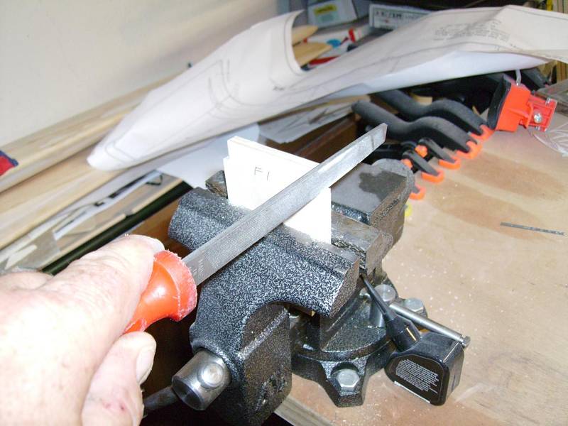

Just got back up from the shop and have some progress to report. It's kind of nice when you have to do laundry for the wife and your workshop is right next to the laundry, you don't even get in trouble.
Glued the doubler on the second side (picture 1). While the 12 minute epoxy was doing its thing I cut all the formers out of their plywood skeletons and sanded the bridges off. I then found that there is a radius on the router cut parts so I took a dial caliper and found it was approximately 1/32 inch. I then took a mill ******* file and squared up the corners (picture 2). After reading theplans and the article (supplied to me by RFJ Thanks) the actual Tiger Tail used a 1/16 balsa doubler with the grain on an angle of about 35 degrees. Whereas the Eureka uses plywood doublers. It doesn't seem to make a huge weight difference. The balsa in the fuselag parts is relatively light and decent wood.
