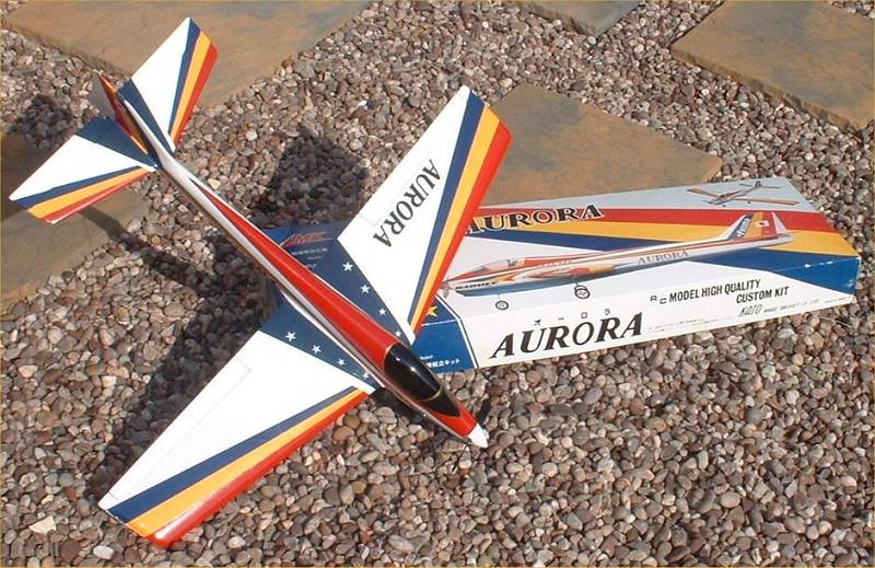

Attached is a picture of a electric Parkfly Aurora made by Union Model Co. sadly no longer available.

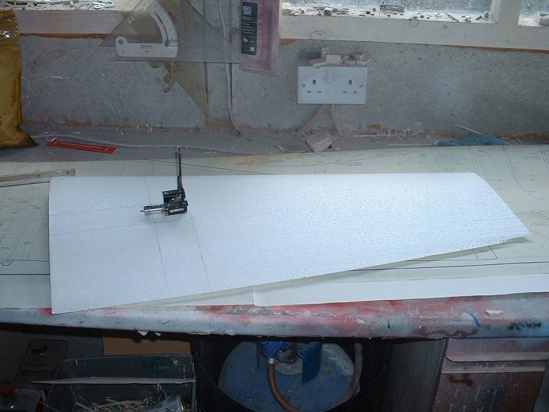

On with the wings. Temperlates were cut from 1/16" ply drawn around the original kit supplied balsa wing ribs. Again high density foam was used for the cores, cut with the aid of my father.
Two liteply false ribs were let into each wing core either side of the retracts. These offer more strength for the retracts, as I my flying site is a well mowed grass stip. We all know retracts don't always fair well to grass strips ! A liteply box with hardwood beam mount is also let into the core for the retract mount.
The aileron servos boxes and wires were hollowed into the core with a small hot wire cutter. I drew onto tracing paper where they were located in the wing, as once the wing is skinned, tring to locate them can be troublesome.
As with the tail, the wing cores were skinned with the kit supplied 1/16" balsa and vacume bagged.
One thing that struck me, was the wings were not as light as I would have liked. This was due to the high density foam, also the balsa kit supplied skins were a little heavier than if I were to use contest balsa. Despite this, I proceeded on to cutting the retracts and aileron locations lining the retracts and boxes with 1/16" balsa.
The wings halfs were then joined together. With two incidence gagues at each wing tip, the wing halfs were out of aline by 1/16" at the root, something I could live with.
The ailerons were cut out of the cores, faced with medium 1/4" balsa. I was kind of amused that a foam balsa skinned aileron weighed exactly the same as the kit supplied preshapped solid balsa aileron. The solid balsa kit ailerons were used instead of the foam ailerons, as the aileron horns would be a solid mounting.
Finishing the wing required the epoxy bandage around the centre section, balsa wing tips and wing mount to be glued in place.
The all up weight of the wing without retacts and servo is 738g ( 26 oz ) Humm.... I think I should make another wing []

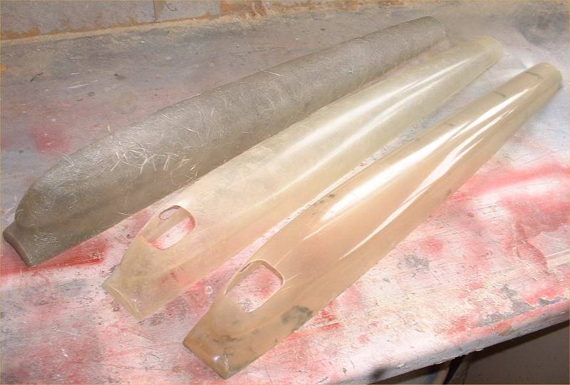

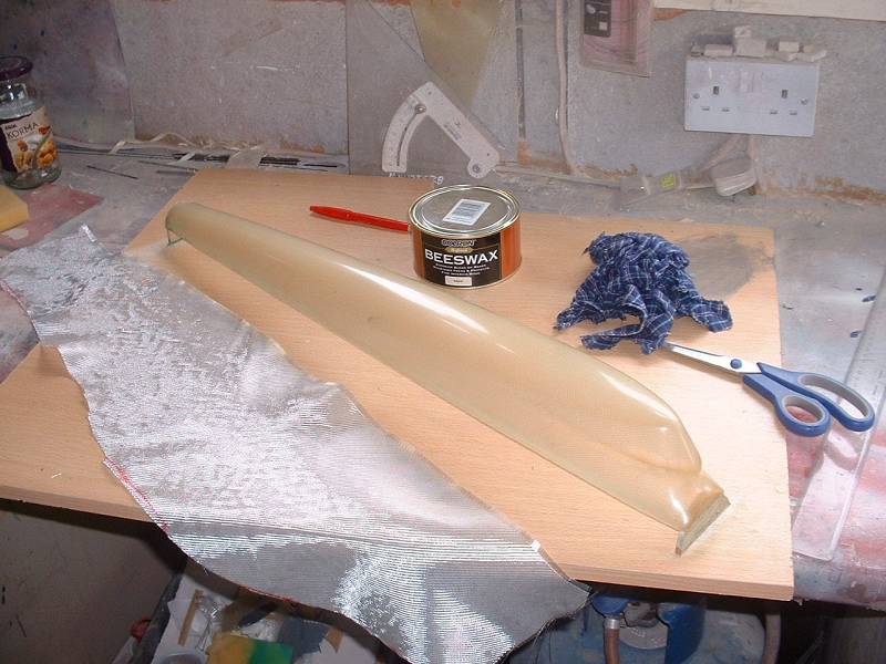

While I debate on making a new lighter wing ( I welcome your comments regarding if I should do this or not ), it's onto cutting the belly pan.
I took the opportunity of making a glass fibre mould incase I accidently break the original or decide in years to come, build another Aurora
The mould was made from polyester glassfibre resin, 163g cloth with chopped matt strand cloth. Lucky for me with Atlanta 60 help via email, the mould worked out perfectly.
I made a tempory bellypan from one layer of 163g cloth. This was very flexiable. This was used to cut away until the belly pan fitted around the YS91. Once happy, I drew the cutout locations of the cylinder head and exhaust onto the original kit supplied belly pan.
It's a tight fit, I'll tell you with a YS91. Those of you who have experience of the soft mounts know the engines rock quite a lot on tickover. therefore more machining is required so the engine will not catch on the bellypan at tickover.
So here we are, I'll keep you posted as I progress with the build. Till then I welcome all your comments, constructive or not, we can all still learn something.

The retracts I'm using are Romair. One slight differnce in the nose wheel mounting I came across in comparison to the kit ,was the original MK retracts are mounted directly to two thin hardwood beams. The Romair nose retract requires a slightly modified mount. This was quite simple, using a beech hardwood block, held in place with JB Weld epoxy.
As you will see, there isn't much room with the YS header pipe next to the retact, but they don't interfear with each other.
Finally for today the wing retaing bolt is epoxyed in place with JB Weld.
Attached are the belly pans mentioned previously. A mould is shown furthest away, next is a light flexiable temperlate used for locating cylinder head etc, lastly the original belly pan supplied in the kit.
Mike.
