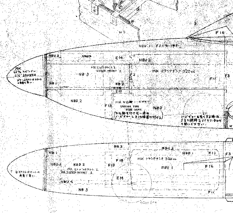

I am redrawning an old set of MK plans that does not list the right and down thrust. It looks as if there is both right and down thrust based on the plans. Is 2.5 degrees right and 1.5 degrees down typical for most 60 sized pattern planes?
Bryan

The beetle plan calls for 1.75 down and 2.5right.
