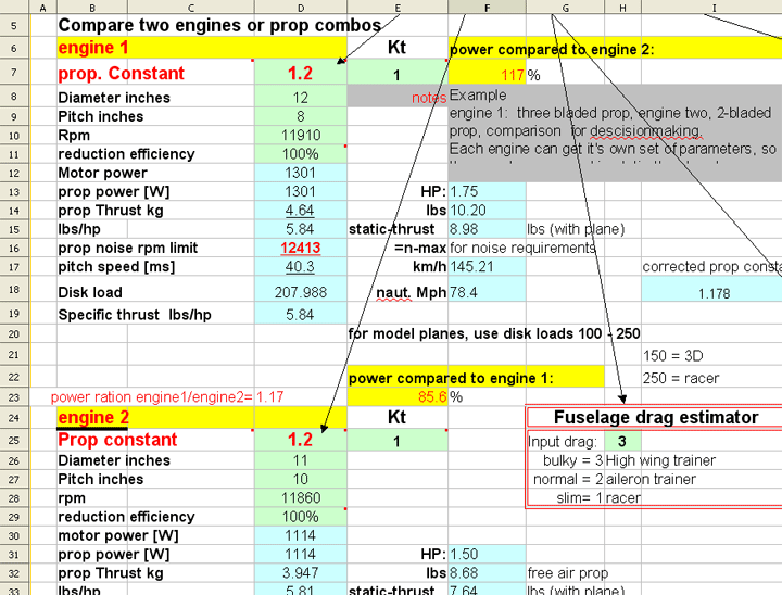

I also agree about using a tach. But, in addition, you should download Pe Reivers' thrust/hp/speed calculator:
http://mvvs.nl/prop-power-calculator.xls
It's the only one I've found that factors in prop pitch. The others, like ThrustHP, give the same data for an 11x4 as they do for an 11x10, which doesn't help much. Here's a partial screen shot of Pe's spreadsheet.

The program raindave mentions looks really handy but will take some time to figure it out (for me anyway)...So lets look at Propeller Load Factor (PLF) to simplify things...

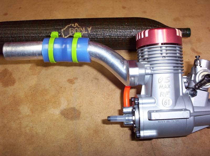

Sometime on the ABC, I am having a little problem on transition. Both 7L carb's.
Vince (Crank)
Vince (Crank)
Even thought you may have a NIB engine...Keep in mind it's probably working on 20 years old...he he
