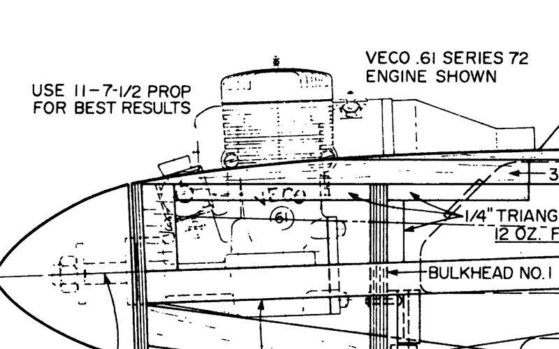

From the Kaos and Super Kaos plans.
(sorry to drive this thread off topic)
David
