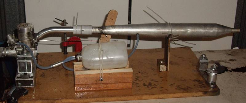

Hi all,
I have completed my Inital test on my 2 OS 61V Engines
I need to decide which of my two engines and carb /Pump setup I am going to use to power the arrow before I start sanding the engine bay.
My main goal is to work out which is going to be the most relable, and I am a curious person :- I like to work things out for my self much better than a blind guess.
This is what I will be testing
OS 61 V Which I am going to call "Engine A " :- Low usage engine came fitted with 7M carb only no pump, bought in box with Manual only damage small scrape on one fin nothing to fuss about.
OS 61 V Which I am going to call "Engine F"(Frankinstien):-It was bought "AS-IS" for its OS pump and 7D carb condition unknown, it has had a hard life crashed at some stage lost a Whole fin on the head and the pipe mount area was welded back onto the casting and machined flat new holes were tapped to take longer Non Metric Bolts. The piston and linner are NONStandard and have had a radical porting job how good a job we will soon see.
Both Engines were run on a Standard fuel of 20% Castor, 5%Nitro Same pipe / same Glow plug same Props Even same prop nut.
RPM by a Hanger 9 Tacho from behind the prop.

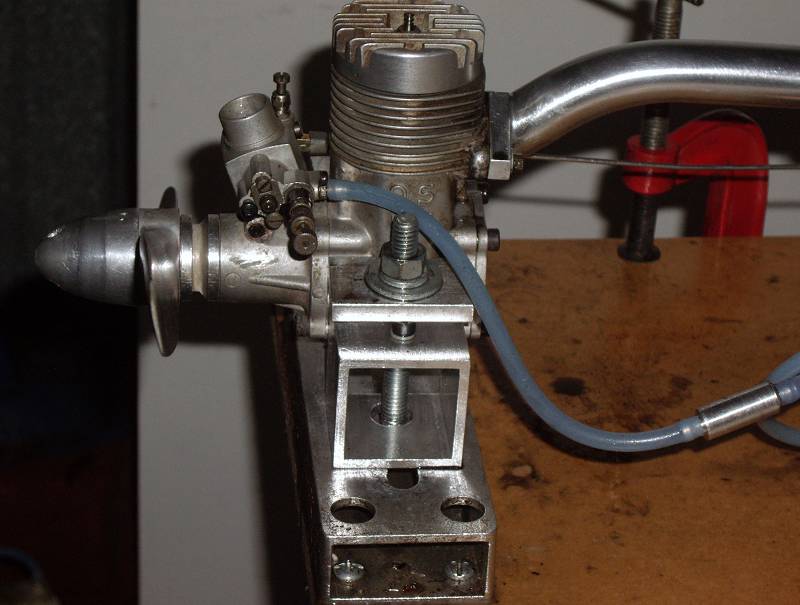

The two Photos are "Frankie" Engine F on test

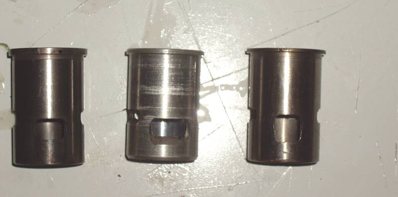

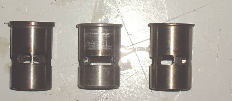

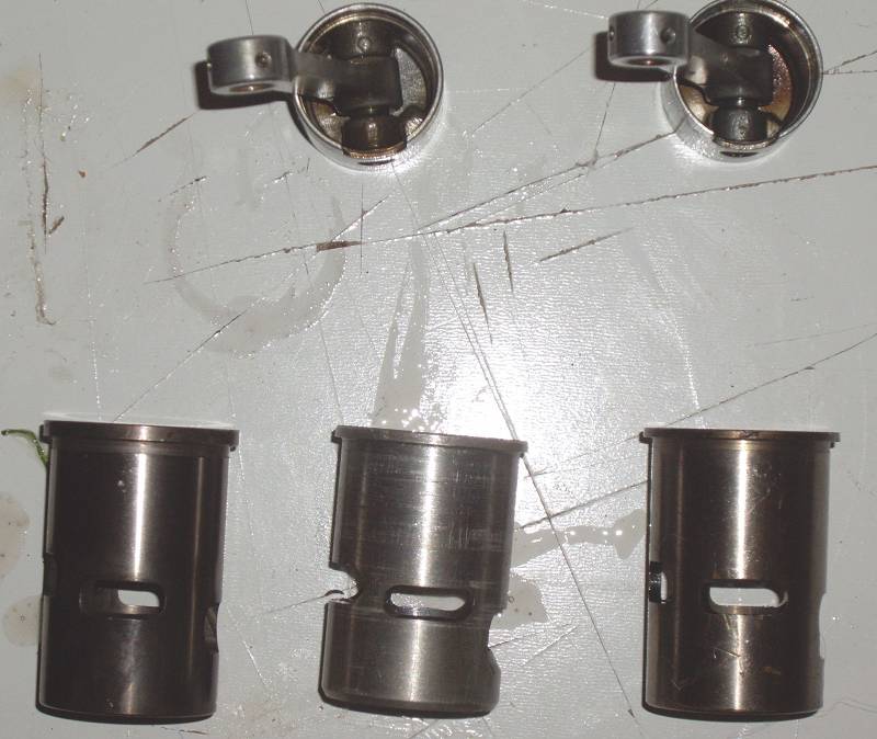

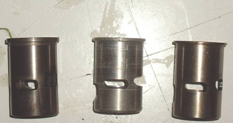

Hi Will, thanks for the info on My 61 V, I have never seen a Performance Specialties (Dave Shadel) replacement piston/sleeve set
I will Pull both engines Appart and Photo the Sleeve
Were there any Stamps or ID numbers on them?
Will post Photo's Shortly

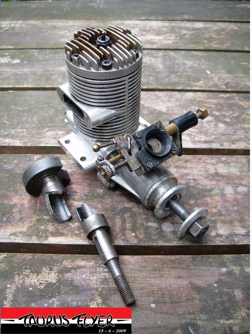

When you are interested in max RPM, I can show you other results, see picture, my pumped Webra Speed 10 CCM, with Sonex pipe after a speed attempt + 150 mph..
Success, Cees

I have pulled down both engines, I needed to install new crank case gaskets on Engine A, before I install it in the arrow.
I have Photo's of both engines and a Spare 61 SF Sleeve
Left :- SF 61 Sleeve
Middle :- Engine A
Right :- Engine F (Franki)
It looks like Engine F is running a Ported SF Sleeve, and is putting out more power than the Standard sleeve on Engine A which looks the most ported.
The pistons both look the same but the liner on engine a is light in weight and is made of alloy.
Usefulinput Please
Middle :- Engine A
Usefulinput Please

Let's make a "port timing diagram" and look what our expert Frankie did make of it.
For that we also need the crackshaft of Frankie.
BTW is this the same person as Frank Myers from the Ed Kazmirski's Taurus?
Cees

The aluminum liner is a Shadel/Nelson liner. The top flange on the SF liner (same as RF just rotated in case) is thicker than either of the others and would impart different compression. The bore of an SF is smaller than a VF too.
Terry in LP
Terry in LP

The SF liner is From a Ringed Version and it also fits the crank case that must be why it is thicker, and is a "long stroke" engine
So if any one has a Dead 61V it would be possible to use a OS 61 FSR ABC Sleeve and Piston to put it back in to service.
Would it be Possible then to use a piston and sleeve plus ring and head from a 61 FSR of SF Ring engine ?
Has any one tried a Current OS 61 FX piston and sleeve in a FSR , SF or V / VF ?

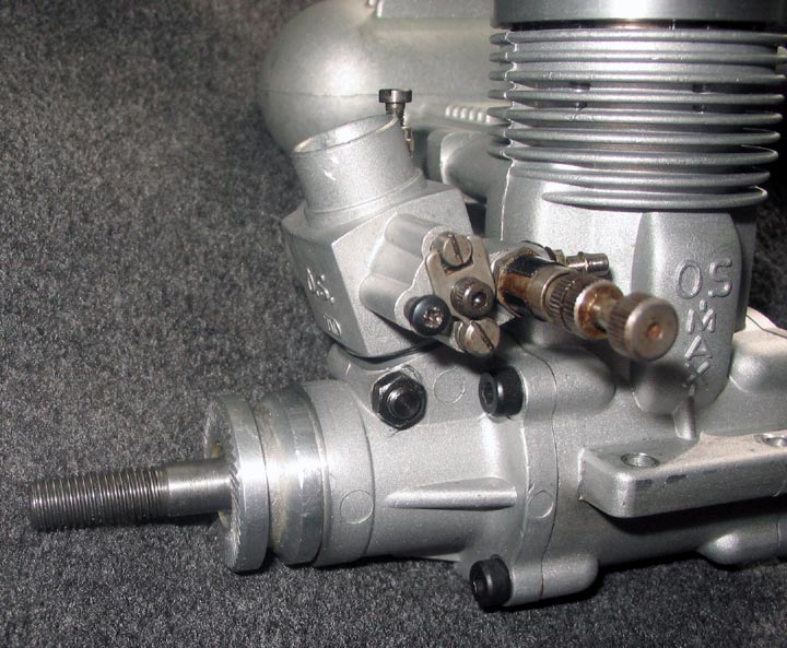

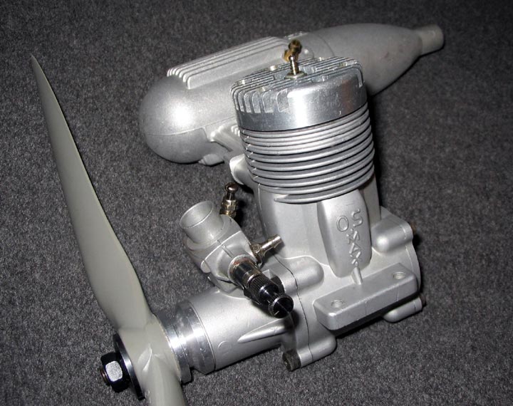

Thanks for posting that Terry. Iremembered a thread of that nature but I wasn't sure what to look for.
John, that RX crankcase looks sweet! I didn't know OS made a RE Heli engine. I'll have to look up the vintage.
I'm actually wondering how well that crankcase might convert a 61 RF and/or RFHanno... If it worked, it would make a great backup for a Hanno.
What struck me about the liners was the thinner head shim on F. Did Nelson stroke out that VF? If memory serves me, the V series were short stroke engines compared to the FSR/RSR and then the SF/RF series. My 25 VFcertainly is a short stroke but then it is a DFengine (28K rpm anyone...
David.
)David.

OS made both RF (LS) and RF-N (short stroke=VF.61 P/L/crank) heli engines. I have examples of each.
and Johnkpap,
Aside exhaust piston won't work in a rear exhaust case.
Terry in LP
edit to change...rear exhaust 'liner' to case.
