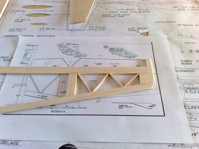

With the crap weather today(really, really windy) I broke out some wood and started. The antihed of the stab seams a lot compared to the Birdy planes which have a total of 10deg's the magic has 19deg anyone done something different. I think I may reduce this to 15deg or maybe even 10deg. will have to look at it. I used 3/16" for the stab and will use CA hinges just for the ease of fitment. Looking at the wing I will proberly drop W4,6,8,&10 as the space between looks OK with out them.
Third photo is size difference between the plan for the Magic 20 and the 80% one. Printed that out to check antihed.

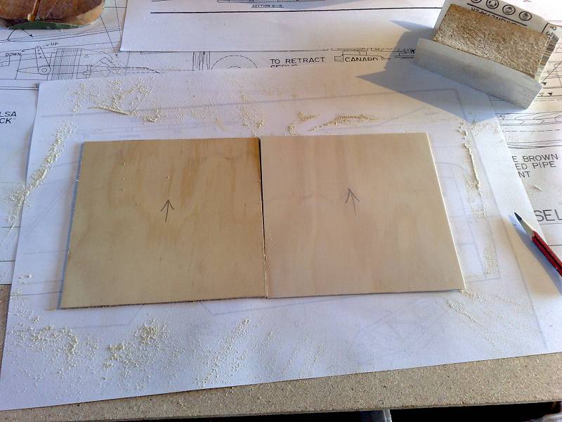

Made the ply just have to leave it till morning. (photos)Sanding the sheets and laying them cross grained and weighing them down.

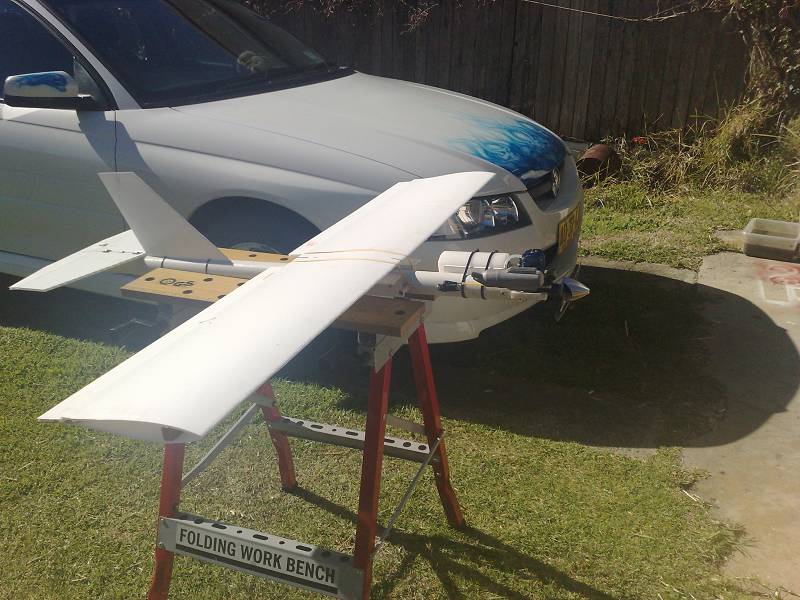

Ran the motor today, just with the muffler as it has not been runn for a while, will need to replace the bearings as it had a very runny nose.[sm=drowning.gif] O'well.

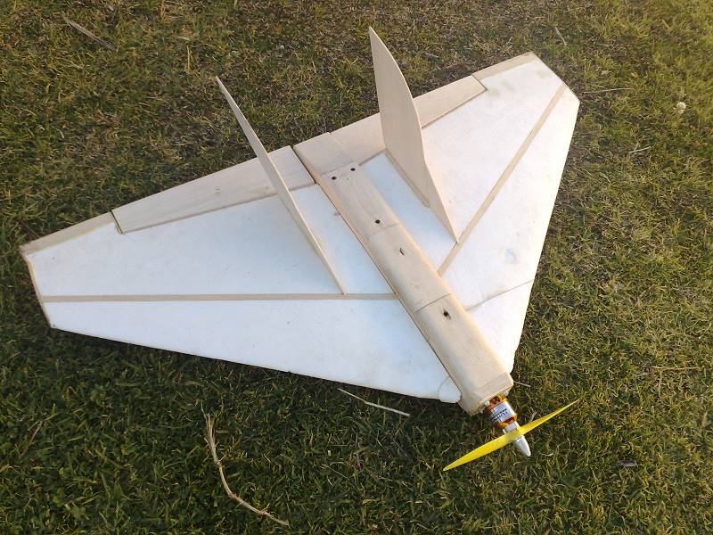

Played around a bit more with the pipe and coreflute plane.

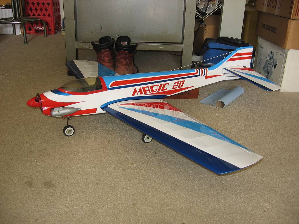

Cool! A Magic 20 thread that is current!

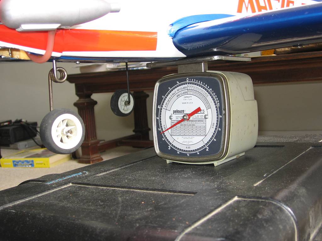

I built this one from the MK kit back in the mid-late 80's. I dug it out of the stack last week, installed a new flight pack battery and used my JR7202 radio to communicate with the original Airtronics receiver and 94831 servos. Flew it yesterday for perhaps its 9th or 10th flight.
It's fast and smooth with the old OS 25FSR. 3#~6 oz. without fuel. You'll enjoy your Magic.
