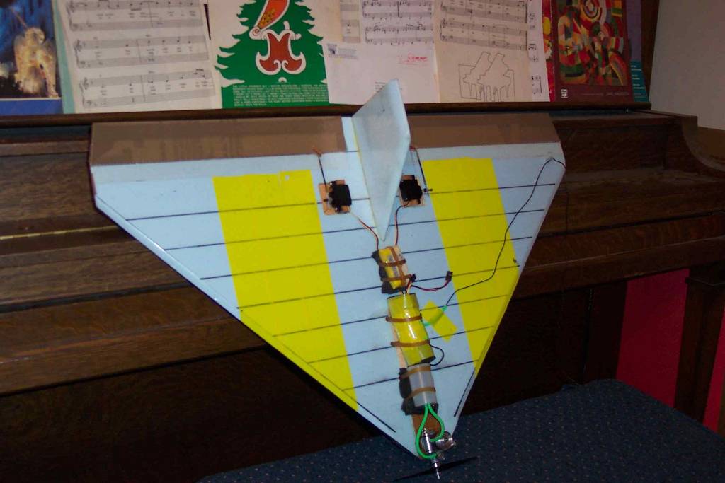

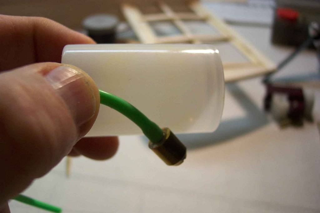

I fly a lot of 1/2A, so my tanks are quite small. I needed some small tubing, but the LHS doesn't cater much to the small flyer. However, the shop was big into RC cars. I cobble up a lot of stuff and am constantly looking for things I can get locally and easily. The shop carried noodle wire - this is the high strand count battery wire with silicone insulation. I bought a couple of feet of 14 AWG (which was cheaper than an equal length of tubing), then stripped the insulation off the wire - it does take some effort. The insulation is completely impervious to 25% nitro and makes excellent fuel tubing. You may want 12 AWG to get a larger ID.
I've attached a pic showing the flexibility using a standard Sullivan clunk and a 35mm Fuji film can - the clunk will hit all sides.

Andrew...
Bet that is a going Delta ! Nice, I like it... how about one in A size, like for a OS .25 ?
I think I have seen the Noodle Wire you speak of and 12 AWG should be just about the right size..
Will raid the nearest LHS and see it they have some.
It would be a great find if they have that size...
Thanks Andrew !

Wow Doug, How did you come up with that one!! That's a killer idea. I have tons of wire off a military nuke sub that was refitted. I was going to use it on a sailboat, but the wire isn't tinned. The jacket is impervious to almost anything though ...
Thanks for sugestion!
