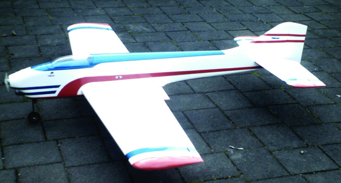

Actually either Atlas or the older Superstar 2 would be very suitable. The all wood versions shown are both under 7 lb and with the .60 two strokes are really not underpowered, not too fast, although they do eat up the sky, and are both very honest (neutral) aeroplanes. Both could be flown 'SPA' with wheels down and 'BPA' wheels up. These two are from English (RCM&E) drawings and are pretty simple builds.
Evan, WB #12.

Is that Your Atlas Even???
Gorgous!!
DM
Old 09-24-2009 | 04:23 AM
Joined: Nov 2005
Posts: 1,961
From: Auckland, NEW ZEALAND
Default RE: Which plane best for first classic pattern scratch build?
Yes, I fly both in pattern competition, against the 2m stuff, in the beginner (Sportsman) class. But that's 'cause I'm not a particularly gifted pilot. They still don't like it when I get podium finishes...I just thought of another classic, what about a Sicroly 2? then you can have flap/airbrakes as well!
Evan.
