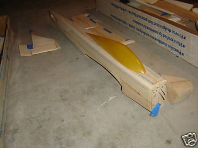

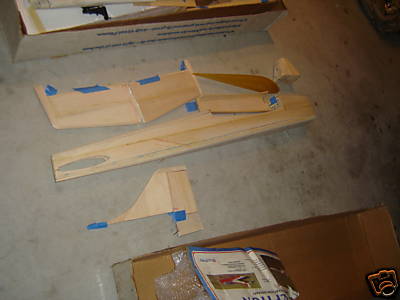

I don't think it makes much sense to make a full composite fuse but maybe I'm mistaken. If I am, I would think that it probably ought to be re-designed on the inside to accomodate a RE engine setup.
A two part composit fuse (fuse & canopy) or a copy of the one (wood fuse glass canopy) in the pics would be cool!
Pics;

#36
ORIGINAL: Roguedog
I like the idea of a RE Deception. I saw a RE kit for sale on ebay last year. Save the listing pics cause I always thought that the Deception was a side exhaust.
just to mention, there isn't such a thing as a "RE kit". As shown in your pics, the Bridi Deception box photos show a build with a RE engine. Jim's original construction article in 1978 showed a short stroke SE Rossi and pipe. The only difference between the two is the modified FW on the RE setup to accomodate the fuse top header. The canopy on the RE plane is obviously also cut to allow the header in and pipe exhaust out. The configuration is very similar to that of the XLT, Escape and Arrow.
David.

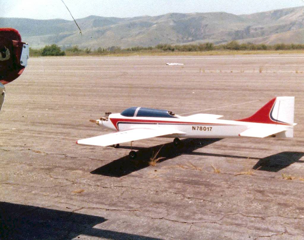

#44
In order to make these more accessible and available for all to enjoy, I did a very quick job on the scans Jim posted as PDF files. Here are the pictures of his White RE Rossi Deception. Date pictures taken?
Note how Jim concealed the header beneath the fuse top to enter the canopy from inside the fuse rather than exit over top. Were there any heat or space issues with this setup considering the area available for the header, tank and nose gear?
Looking forward to progress shots on yours Rusty!
David.

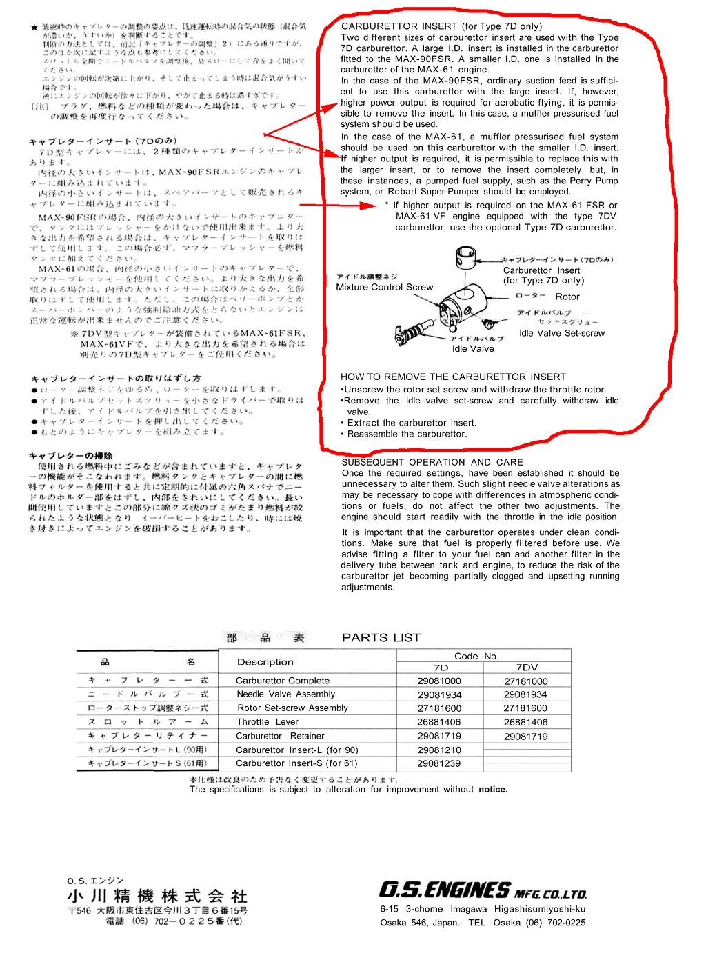

Here's why I'm asking. I acquired a 61vf with box and it had a carb manual for the 7D & 7DV. In that manual it references that you can remove the carb insert to increase the power but that it requires a pump. What do ya think? Here's the manual;
