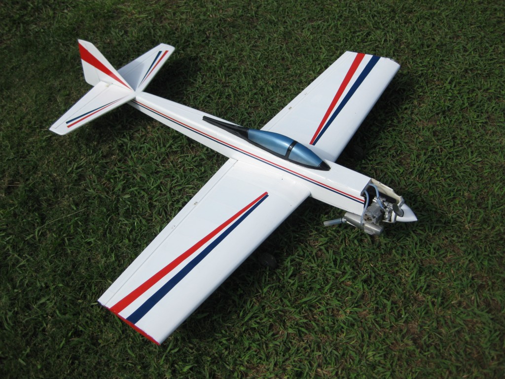

hello guys i have a 60 size super kaos that i have been flying since 1990 and i was told the wiggle came from the design to be almost out of control when ballanced perfectly that was what made it such a good early pattern ship this info . came from a a master builder and monocote expert and is also a judge at top gun take that for what its worth

Does your Kaos have a canopy? I know the Kwik Fli would wiggle with a canopy, and much reduced without.

Whereas my Super Kaos DOES 'wriggle'. Something to do with airflow breakaway from the fin, and does affect lots of aircraft, model and full size. There are cures, most are simple, thickening the trailing edge of the rudder will do it, a simple litho angle attached both sides of the trailing edge then trimmed to suit is a common one. That being said, my wriggle is only apparent in windy (turbulent) conditions, and is not visible in calm weather.

Add a dorsal fin. Seal your hinge gaps (all of them). Fix your sloppy rudder linkage. Use a smaller node wheel. It is destabilizing out in front of the CG/CP.

the original kaos[1965] added a sub fin to eliminate this problem.

hello yes it has a canopy

That was the theory I remember hearing most often, back in the mid 70's...a big bubble type canopy causing disturbed airflow around the fin/rudder.
There were a couple guys who built a lot of Kaos's (probably 7 or 8 between 'em ) and they decided that the canopy of choice was the Wing Manuf. streamlined style or the jet fighter style...not the original big bubble type.
Another friend built a Kwik Fli III without a canopy at first, then added the stock canopy to test the theory...he said he thought the big bubble was "probably" what caused the "dance".
Another theory though was the thick wing tips (and possably the barn door ailerons ) of the constant chord wing causing the "dance" vs. the thinner tips of the tapered wing Kwik Fli...but I don't know about that? (I mean the Kaos has a tapered wing, aye!? )
I just started flying a Tower Kaos .40 with a Webra .50 but have yet to notice any wiggle...only have half a dozen flights on it...will have to look out for it next time

I have found that the wiggle in the Kaos and the Kwik Fli was related to the design of the rudder pushrod and the poor servos we used tp use. Most people made their pushrods with a long 2-56 rod exiting the fuselage and then having a bend in it before it attaches to the rudder. If you re-engineer the pushrod using a 5/32" or 3/16" carbon tube with short straight metal rods at each end (preferably 4-40 at the rear) and NO bends, and upgrade to a high quality servo with a minimum of 60-100 oz of torque you will be amazed at the improvement in the way these airplanes fly and respond to rudder inputs.

This Kaos I built from plans using the rudder pushrod on the plans and it had the wiggle and felt like the rudder was "soft" in k.e. and in the point rolls. Put in a straight carbon rod and what a difference! So much more rudder now in k.e. I had to add expo. Wiggle in the figure m and at the bottom of split s disappeared. I built a Kwik Fl from the Graupner kit and found the same solution to work.

I had a Super Kaos 60 with an OS 60FSR with the perry pump and carburetor. It had the wiggle at full throttle which I cured by adding a triangular piece (fin) in front of the vertical fin, I don't remember how much area, but it worked. I suspect part of the problem was the increased available horsepower (and resulting flight speed), but I only had my Super Kaos for 27 flights, then the RX took a vacation and the plane rolled through some trees at full speed..[&o] . I moved on to the Dirty Birdy shortly afterwards.
