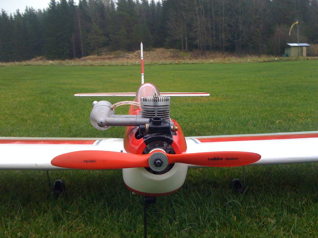

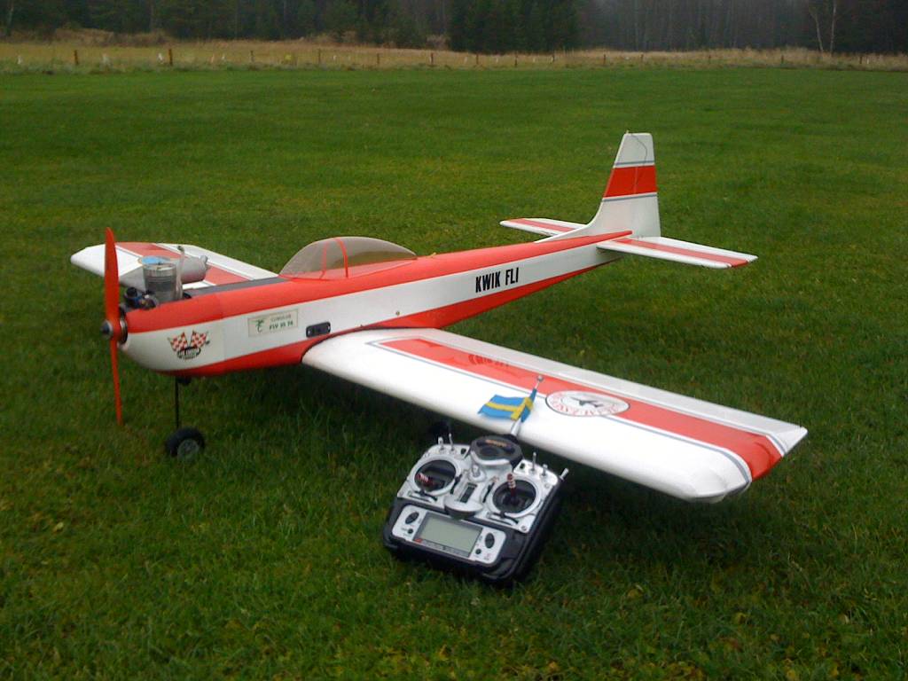

I was out flying my new Kwik Fli today, and I have a problem with the "knife edge" flying.
I'm not an experienced pattern pilot, but I'm learning.
So when I put it in KE I need to compensate with very much elevator, I fly with canopy agains me and it goes left.
Any tips or tricks.
