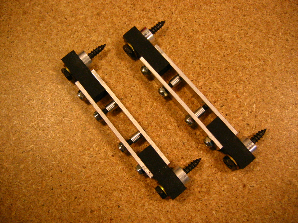

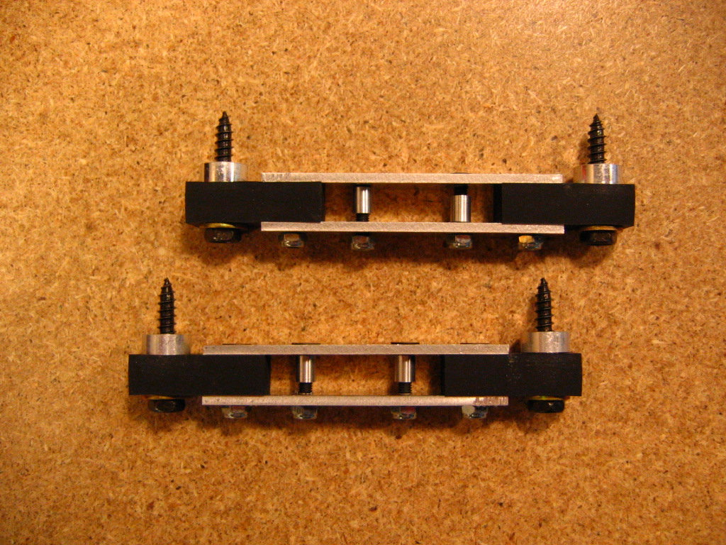

I'd use a glass filled mount (e.g., DBr or GP) rather than an alum one. You can then back the mount with a thin piece of rubber (~1/16") all around it. The DBr mounts are circular so you just cut a ring.
Also, MK used to make some nice soft mounts for the YS's. Both the 45's and 61's fit in them. Basically there is a rubber dampener that mounts to hardwood beams for the engine and then, in turn, that is mounted between two steel plates that have screws passing through the assembly (see pics).
In a pinch, you can simply mount it directly with 4 x 6-32 bolts to the FW using the above glass mounts.

It has some sort of soft mount in it, I'm not sure if it's homebrew or was a commercially available product. It has glass filled beams with four rubber isolators on the back side of them. I've never seen beams that look like these. Back when I was flying OS 1.40 RX's, the vibration in those was not bad at all, and I have a hard time believing that a .61 would need to be soft mounted. As tight as the nose is, it looks to be a bit of a pain in the you know what to try and get a nose ring in there. I want to take a good look at the stab and see how it's glued in and see if some weight can be saved there. The wings are heavy as lead, and regardless of its landing gear configuration, I will be replacing those.
