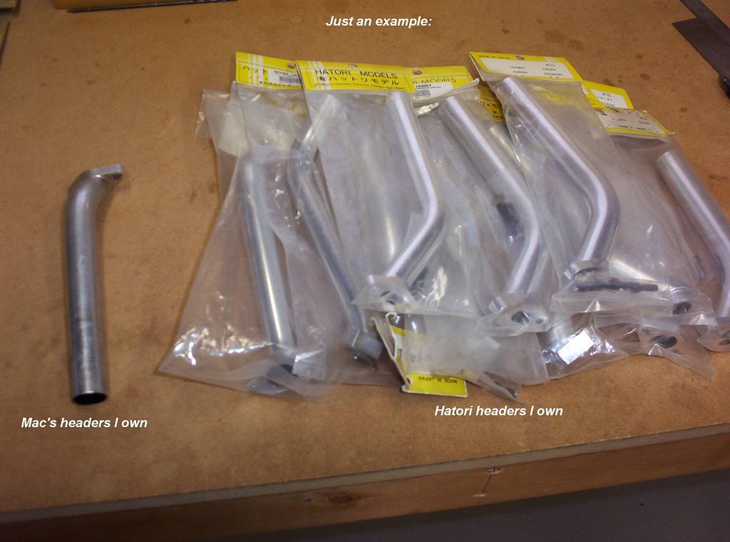

Hatori uses thicker wall tubing on their headers so they're going to be heavier...That's fine with me...I'm the dude paying for it and I'll gladly sacrifice a couple of grams in weight for durability any day...
It's great to have an excellent reputation for replacing defective stuff!! But it's better to have a reputation for making stuff that doesn't need to be replaced...
I'm just not really into returning stuff under warranty...Like I say it's a personal thing...If something breaks I'd rather toss it and get a new one...I did actually call Mac's on the most recent header which lasted me a total of 30 seconds, I thought that was a little ridiculous...He was very kind on the phone and asked me to send it back and he would look at it and either repair or replace it as necessary...Very nice of him but I decided to toss it instead and buy a Hatori...
I am not trying to bash Mac's!! I'm glad they are around!! I've only had a problem with their headers (3 or 4 of them)...I like their pipes and will buy more I'm sure...I'll just try to use a different source for headers when I can...
These are only my opinions based on my own personal experience

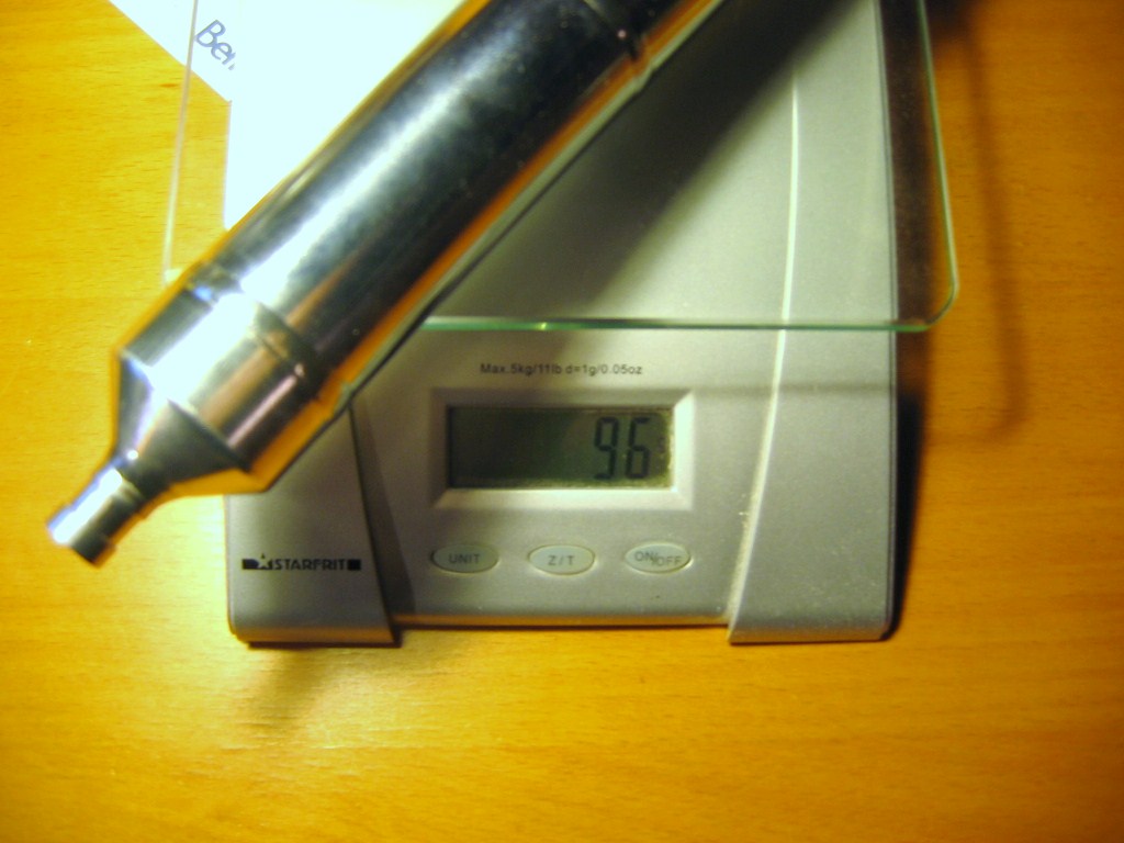

I was curious so, for fun, I weighed some myself (note the weight difference compared to Chuck's photos. I guess not all scales or pipes are equal).
In order: Mac's 6.5 MP (14.25", 3.3 oz), Hatori 401 7.5 (14.50", 3.4 oz), Mac's 7.5 QP (16.25", 3.7 oz).
In fairness to Mac's, the 401 is sized more closely to a 40 size pipe (6.5 cc) rather than a 45-50 size pipe (7.5 cc) even though its intended purpose might be different. The Mac's 7.5 cc QP is a much longer (and probably quieter) pipe although both the 6.5 and 7.5 share the same header OD of 3/4".
It appears that Hatori makes comparatively shorter pipes than Mac's for the same application. I was surprised when I purchased a Hatori 10 cc LS pipe (650) and saw that it looked more like a 7.5 cc pipe! I actually thought there might have been a mixup.

are you sure that's a 7.5 cc QP and not a MP? I'm surprised it weighs less than the 401!
The 7.5 QP should be 16.25" long and ~3.7 oz (Mac's specs say 16.5", 3.4 oz). The 7.5 MP by Mac's specs is 15.25" long (1" less) and 3.6 oz.

It's 16.25" long...I couldn't remember for sure what pipe it was but know I *would have* bought a quiet pipe (relying on my memory isn't very reliable though)...So I went to the Mac's website and noticed the difference in length between the MP and the QP...That's how I confirmed which pipe it was...I have three YS 45's and had only one Hatori pipe so I bought two Macs at the time...I've since got another Hatori 401...
Man my scale is wayyy off...Dang...I switched to OZ and the Mac's pipe weighs 4.0 oz and the Hatori weighs 4.2 oz...Something is really goofy...I think I better get a new scale!!! Oh Well..it's always something...
Both of my pipes are new so there's no residual oil or crud in them?? Weird...

that scale does sound off. They're supposed to be pretty good. Warranty...? Or toss it and get a new one? Mind you, my scale is a $20 job but given specs and actual weights I trust it is in the ballpark.
Take a pack of steaks weighed at the store and throw them on. You'll know how off the scale is! But don't go away thinking you've got a meatier dinner in your hands...
