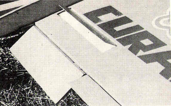

Although Ican't presently find it, I'm almost certain that I've seen a picture of one of the old classics with a combination flap/spoiler arrangement (one of Hanno's, I suspect). I'm presently building an ultrasport, and am putting flaps on it, and have the crazy idea of combining a spoiler function with the flaps. Basically thinking about using something like 1/32 ply laminated to the dorsal surface of the flap and extending something like 1/2 to 2/3's of the flap cord forward of the flap, and recessing it into the TE. Thinking I could use CF veil or 0.5 oz glass on the underside of the spoiler portion if needed for rigidity. Has anyone tried this? Any ideas on the effect on handling characteristics? I suppose I could get the same effect by simply programming a bit of up reflex into the ailerons to mix with the flaps, but for some reason this idea appeals to me.

Acutally it was the curare, the initial one. Later versions of the curare had blade spoilers, and the flap/speed brake was upgraded to a coupled "snap-flap".

I haven't seen any other classic that had this early Hanno flap/spoiler combo. As Rendegade points out, by the time Hanno switched to the Magic from the Curare, the configuration had changed. Matt, used separate flap/spoliers on his Arrow as we know.

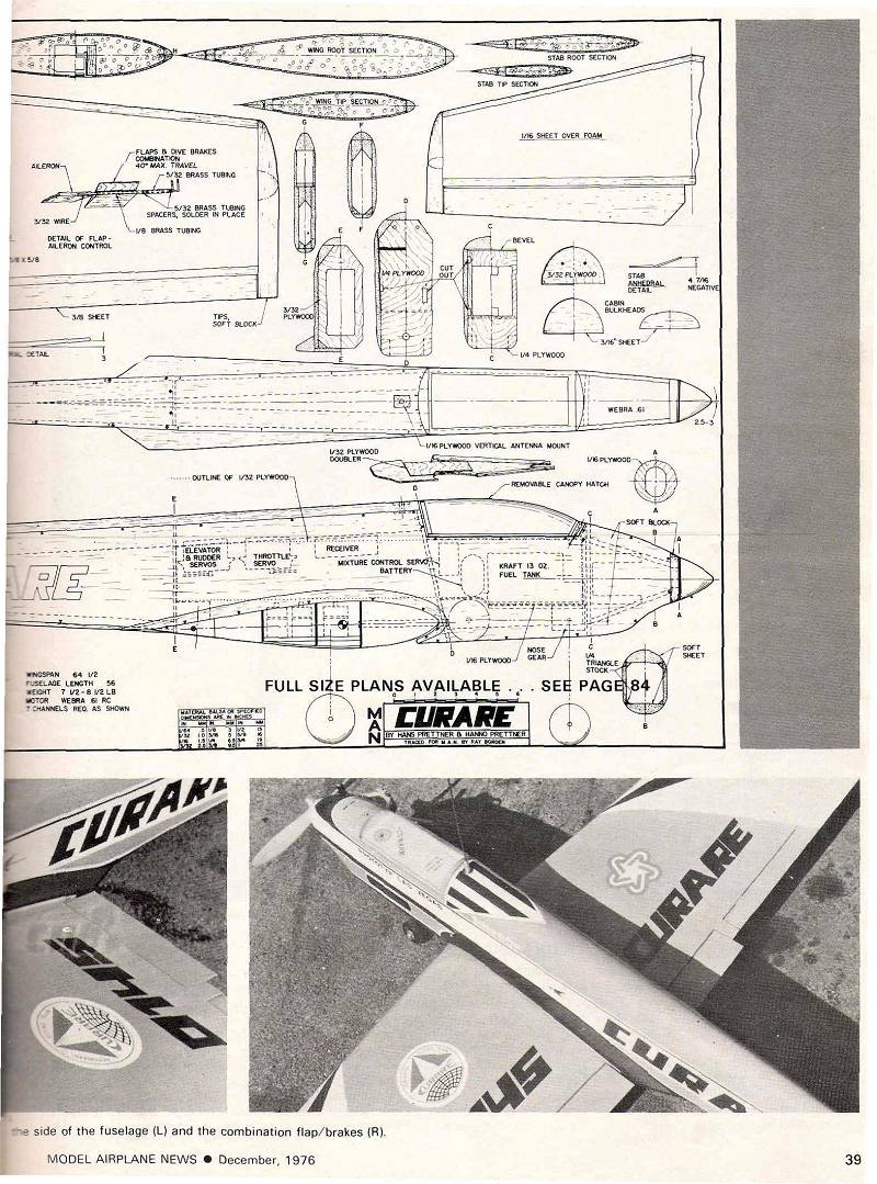

Both Super Sicroly and Curare use the combined flap/spoiler, both MAN and RCM&E plans illustrate the concept. I fly both models, Hanno says there was no trim change when actuating the flaps, both of mine go nose up, controlled by simply closing the throttle a bit more. Landings without are quick, landing with allows you to drag the model in pretty slowly so if it's windy you don't ned them, if it's a bit calm it certainly helps. I haven't used them in flight (spins) as I can't think that fast (which switch was it?) but they work really nicely in the circuit. Construction is balsa and ply, no cf or glass needed as they aren't very big, and there is little aerodynamic load on them. Standard JR 517 servo is more than enough power to get them down, even at full speed, but watch the nose-up trim!

Both Super Sicroly and Curare use the combined flap/spoiler, both MAN and RCM&E <font color="#000000">plans</font> illustrate the concept. I fly both models, Hanno says there was no trim change when actuating the flaps, both of mine go nose up, controlled by simply closing the throttle a bit more. Landings without are quick, landing with allows you to drag the model in pretty slowly so if it's windy you don't ned them, if it's a bit calm it certainly helps. I haven't used them in flight (spins) as I can't think that fast (which switch was it?) but they work really nicely in the circuit. Construction is balsa and ply, no cf or glass needed as they aren't very big, and there is little aerodynamic load on them. Standard JR 517 servo is more than enough power to get them down, even at full speed, but watch the nose-up trim!
Thanks, that's exactly the kind of info I was looking for. How do they compare to a flap equipped plane? I'm hoping a bit better (quicker) slowing with a bit less ballooning. Do you still benefit from some increased lift like with flaps alone, or does the spoiler portion negate that? I don't have the old plans to look at. How does the spoiler portion chord compare with the actual flap chord in terms of width? The nose up trim change surprises me a bit, as I would have expected to still see some nose down as with flaps alone. The minimal servo requirement doesn't surprise me as I would think the spoiler portion would act something like a balancer for the flap, not to mention the rather short length of the assembly.

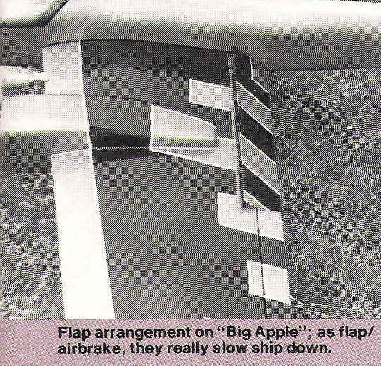

haha I finally remembered where these flap/spoilers came from. Try model airplane news plans for a twin pattern .40 by Dick Sarpolous called the Big Apple. His earlier similar twin was the Magnum 80. I built a number of these twins and still have plans for both of them somewhere. Great fliers. 2 of mine had K&B 6.5 pylon motors with 60 carbs and perry pumps and tuned pipes retracts. Very fast. The last one had K&B 7.5 ducted fan motors. It was just unreal with a load of nitro.....when I could get both motors running together.
That's it exactly. cool. I'm sure there is a force balancing factor here too. Even a big top of the line servo back them was maybe 45 oz. I don't think these flap/spoilers took much force to move as I used to play with them in the air at full speed even on the twins. They were really necessary as the plane is very clean doesn't slow down very fast. Just make sure the spoiler part is well attached. If it ever came loose while landing......well just hope somebody got a good video. haha I had to edit this after I looked at the drawing again. The spoiler air actually goes in front of the interior trailing edge because of construction of the wing. The idea is correct however.
The Big Apple is my favorite twin. It's very easy to build and with todays carbon fiber you could add a little and run .60's on it. Not very expensive to build either. It's great flyer. Very fast and stable. I had many flights with one motor out and never had a problem. The hardest part of running the 7.5 fan motors was setting them rich enough on the ground so they wouldn't go too lean in the air when they came up on the pipes yet they had to have enough power to get off the ground. They had a lot of rpm available and they would really unload in the air. It was usually a pair of plugs a flight and the props were pretty close to the ground so even the slightest bump and it would be a pair of props too. I often just chopped the throttle just before touch down. I was a lot younger then and heavily involved with pro drag racing so it wasn't unusual to toss a lot of parts away. Money didn't mean much back then. A buck for a plug and another for a prop. Big deal. I often would buy 30 plugs and 30 props at a time. The LHS would usually give me a deal. We would pour more nitro on the ground in a weekend than I used in a month with the model airplanes. A single loaded racecar piston cost more than a 7.5. We could burn all 8 several times on a heavy weekend so toasting a 7.5 wasn't a big deal. It was more like how soon could I get new ones. We were definitely not very "green" back then......more like pitch black head to foot, the only thing green around us was money. It was really something to be young and get paid a lot for having fun running all over the country with a big hot rod. Today, I sure wish I would have packed away some of the loot. haha There will never be times like that again so it's a good memory.
After I get moved I'm going to dig out the plans for the Big Apple and look into building a pair. Definitely will have 60's maybe even 90's. I'd even consider electric if the weight could be kept down. You could clean up the nacelles even more. It would have to be capable of at least 120 mph however. Probably paint it like a warbird since that's what I do now. Have to have flap/spoilers, retracts, improved landing gear, gear doors, maybe a speed brake like an F-9-F or F-18. Modern warbirds always have lots of laundry" hanging out while landing.

I appreciate the replies. The pics of the Big Apple's flap/spoiler combination is what I had in mind, although I didn't realize that the wing was slotted to redirect airflow from the spoiler. That is the direction I am planning on going, since I plan on using the torque tubes for the flaps. I'm uncertain if I will slot the wing, or just hope that the spill and induced drag from the spoiler will be adequate for effect without the wing slots. I would assume that you would want to build a sealed chamber in the wing if you were using the slots. Slots and a chamber go a little beyond what I was planning on for a KISS build on the US.

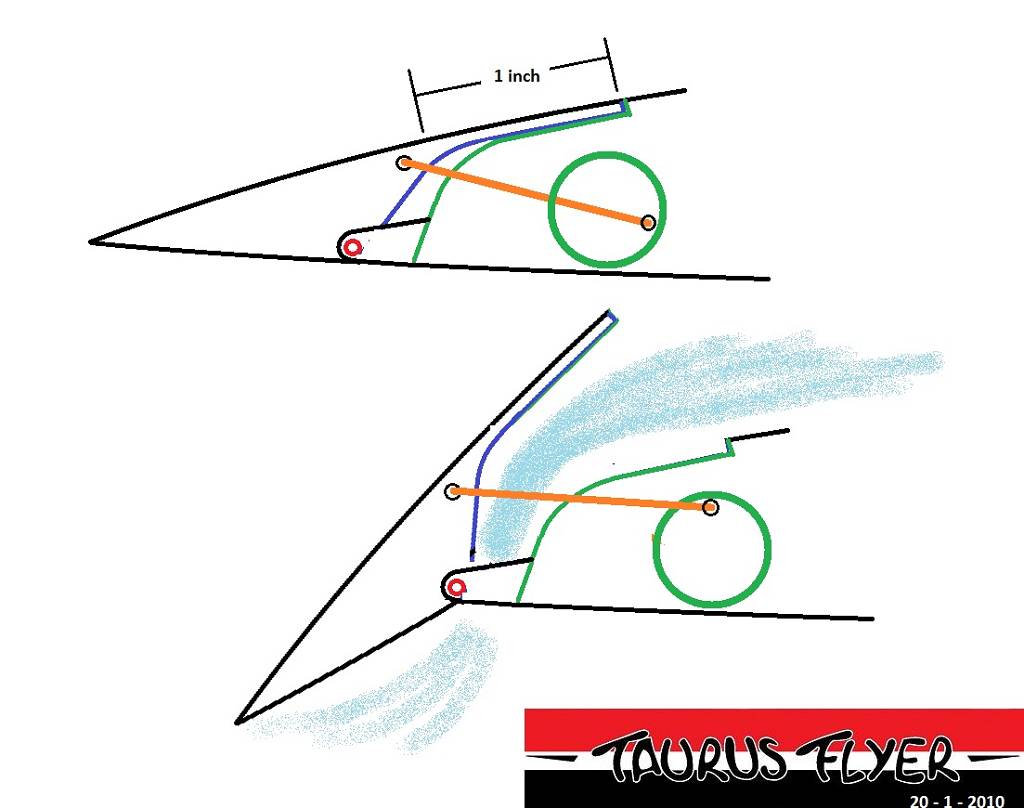

Bob,
It is whatever you want, and I think a flap without a slot will do.
I did make a picture of the way you can make it easy when you want a slot, and maybe this is also the way the drawing of the Big Apple does show us.
Make the TE spar of the wing (near the TE of the flap) of light balsa but massive, you can cut out the slot later if you want.(See the blue part of the picture.)
You do not have to make the slot over the whole flap LE, see the picture. I show one section of the flap, there are 4 I see, one small three normal.
With the torque link you still can make an overcentered position of the linking to keep the flap closed without any torque on the servo axle.
I think lowest position of the torquelink and hinge in the TE of the wing is the best, to keep the distance between TE wing and LE flap, bottomside, as small as possible in closed position.
Just to make my story complete.
Success Cees

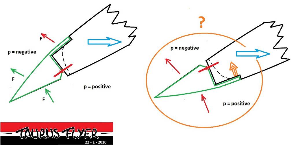

Bob, you write
Did I miss something in terms of a mechanical self-locking feature
I think the over pressure on bottom of the wing and sucking pressure on top will give you no trouble in normal flight position, so probably that will be a natural self locking feature I think.
It seems to be a little bit undefined because you still can have some leak from “over” to “under” pressure.
But.
First; you want a certain closed position and the adjustment of that is possible with an (over)centered position of the linkage of the flaps to the servo’s. See the picture 1.
In closed position the leverage on the servo is zero and the adjustment not critical. You even can pré-adjust some force to keep the flap closed and reduce the leak with soft sealing.
Second I think this kind of linkage give a more linear effect of the brakes to dosing. I compare these kind of flaps with the characteristic of butterfly valves, so very effective/sensitive in nearly “closed” position, especially with the slots, but nearly not in more “open” position. The linkage gives a sort of "exponential"
Last and for me most important point (double security!).
Whenever your plane turns over in inverted position and for example makes an inverted loop, nearly any green force (see picture2) that did want to close the flap becomes a red force trying to open one of them, that’s the moment Murphy probably will catch you by opening one of them a little and in an inverted dive maybe more. Will the yaw be the same as an engine quit? I do not know but like to play the safe game.
Even with a servo failure in closed position the result can be the flap will not open by the aerodynamic forces, for that a little (2 degrees) over centered position will be better than centered!
