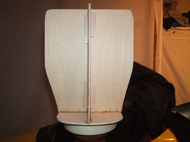

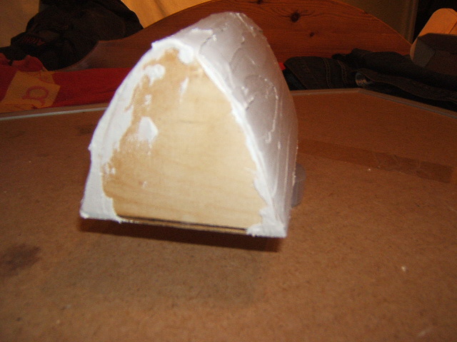

hi guys ,
the cowl plug in the making , i will post the pics to show how the cowl begins it`s life. stage one: profile front rear sides and width . stage two `BLUE FOAM inserted into the spaces . stage three : sand to shape . stage four : fill the cowl ready for a sand of when dry. The plug is now drying so i will post the next pics when the cowl is sanded ready for glassing.

RE: supra fly 2500 build thread.
Cool!
What do you use for the fill? And what, if anything, is needed over the fill prior to glassing to allow the mold to be pulled? Actually, with that shape I can't see how the mold can be pulled so I imagine the cowl is made in two sections (left and right) and later joined?
David.
David.
Join Date: Jan 2006
Location: hampshire, UNITED KINGDOM
Posts: 79
hi guys,
just standard house hold filler (poly filler )... sands very easy into the foam , two piece mould i will show the splitter board etc. later on . just keep running out of time!!, must give this work lark up!!.
regrads
steve
regrads
steve

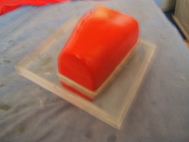

Join Date: Jan 2006
Posts: 79
ok,
slow but sure we are getting there, plug will be sent of this week so the canopys can be vac`ed out. canopy plug is solid balsa then glassed , 2 to three coats of resin cut back then 2 k clear. thn cut back and polish.

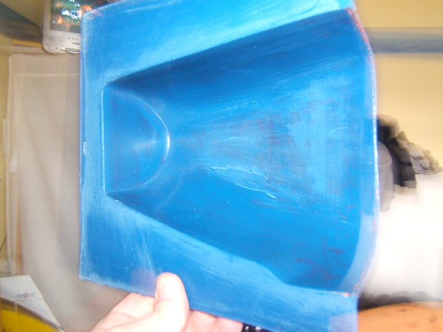

Join Date: Jan 2006
Posts: 79
hi,
plug now has the splitter board around the plug , this devides the the mould in to 2, the splittter board is perspex.
9 coats of wax applied 1 hour wait between laters , long day.The wax is called KANSTIK WAX SILICONE FREE. from the usa.
