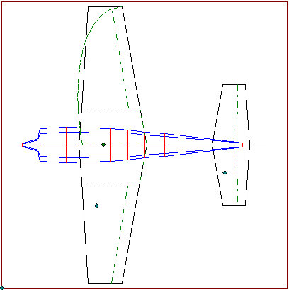

I received a vintage (1984) GP CAP 21 yesterday with a 60" wing span and 550 squares. Designed for a 45, this is the smallest CAP 21 that GP produced back in the day. It was designed and drawn by Don Anderson himself back in the early days of GP. He does look very young in the brochure picture!
In any event, I would like to scan the plans and re-design the model with a lighter (probably interlocking) structure and some modifications with the goal of producing a Gunter Hoppe 1980 TOC style model. Hoppe's model, like Hanno's Dalotel, was large and likely used dual geared Webra's - in his case 60's rather than 90's. He was swinging a TF 20x10 prop! My plan would be for a smaller model - probably in the 1000 squares size ballpark.
I'm in search of a Don Berliner article that appeared in MA June 1982 which documents the background on the CAP 21. If anyone has this article, it would be much appreciated.

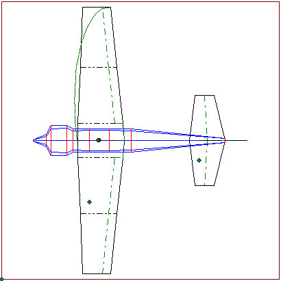

So I sized things to my target scale (80" span/62.6" length - might stretch it a little bit for an aspect ratio of 1.25 - i.e., 64" fuse length) and started putting some lines to paper. Very early stages but here's a draft fuse side view and wing/stab planforms. BTW, I used the E168 airfoil that you recommended. The GP model also has a very similar airfoil although it is not flat in the rear 1/2 of the airfoil - I'm not sure what airfoil is being used there.
Here are the current specs of the model:
Length = 62.6" (1590 mm)
Span = 80.0" (2032 mm)
MAC = 11.84" (300.7 mm)
Area = 946 sq in (61.0 dm^2)
Loading = 23.1 oz/sq ft (70.6 g/dm^2)
Weight = 9.5 lbs (4309 g)
Engine = .91 cu in (15.0 cc)
Motor = 1900-2100 W (8s/75A/17x8 - 18x10)
Some formers will follow.
David.

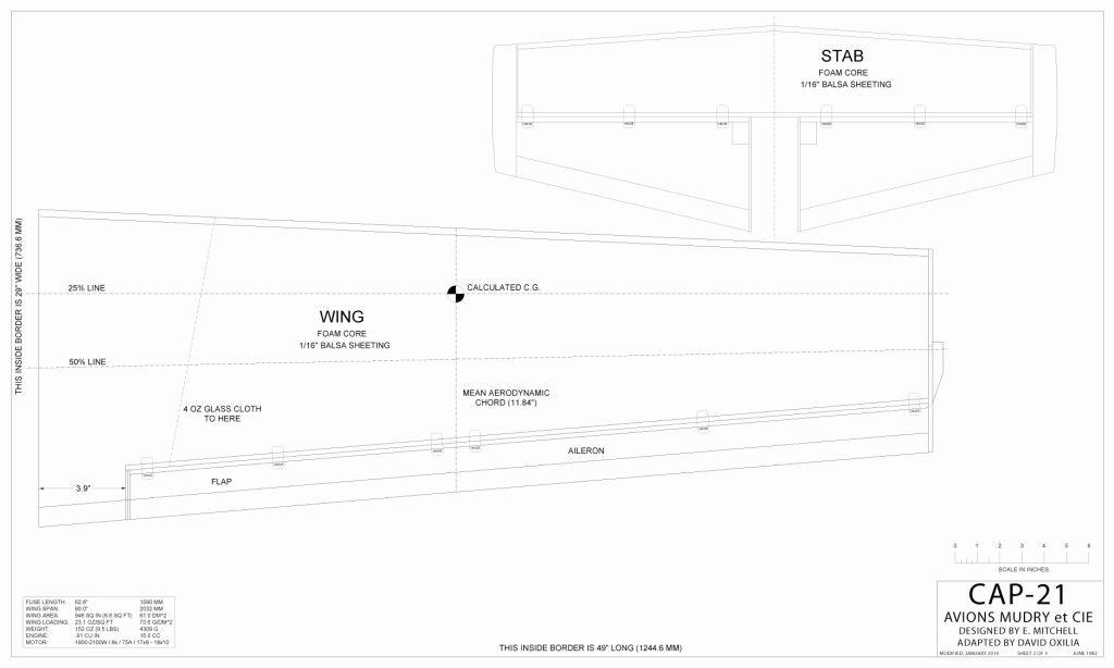

very wise comments. I have heard and read about the behaviour of scale layout CAP's. In fact, much has been said about the flying characteristics of the GP 21's in particular and all comments reflect what you are mentioning. I believe that GP's realized the turnout of their early foray into scale layout CAP's and, to that end, made x% layout modifications to later and current CAP's in order to tame their behaviour. The 232's I have certainly have lower stabs positioned further back and in some cases, higher wings as well. At 6.5 lbs, the 40 size/550 square GP model is certainly a lug and as soon as I unrolled the plans, I saw why. Planform aside, I wonder, as UStik suggests, if the "ball snapping" tendency of those kits was due to the massive weight of them. Back of the envelope gives me a 28.3 oz/sq ft max wing loading for the 40 size model! [X(]
If I ever build that model (that's not why I bought it really), I can see substantial wood disappearing and kit bashing that would take place.
For the TOC (and proto 25 sized) versions, the question remains - should I deviate from fuse planform as well as wing airfoil or should I try and stay closer to scale while making sure I build light? My target max weights would be 56 oz (25 sized) and 152 oz (90 sized) for loadings of 18.7 oz/sq ft and 23.4 oz/sq ft, respectively. For comparison, the Dalotel would have slightly lighter loadings (if built to the same weight) of 17.9 oz/sq ft (25) and 21.7 oz/sq ft. What are your thoughts on these wing loadings in terms of "snapping" tendency for the electric CAP's? Does it warrant scale deviation or should I keep them scale provided they are built to these specs? Or perhaps they are independent decisions and scale deviation for the CAP is worth considering anyway?
The wing airfoil I used in the plan shown above is a modified E168 (thickened and stretched) so it's no longer a 12.45% airfoil. The thicker E169 14.4% airfoil might be closer to the modified E168 shown (haven't checked). I adapted the airfoil based on "gut feeling" and so that it would match the percent thickness of the Aerospatiale V16F airfoil of the full scale (presumably also used in the quarter scale version). "Gut feeling" also tells me that, at least raising the wing a tad wouldn't be a bad idea. Question is, should I lower the stab by the same amount? Of course, "gut feelings" have little to do with aerodynamics so perhaps you will all have some good suggestions on these questions.

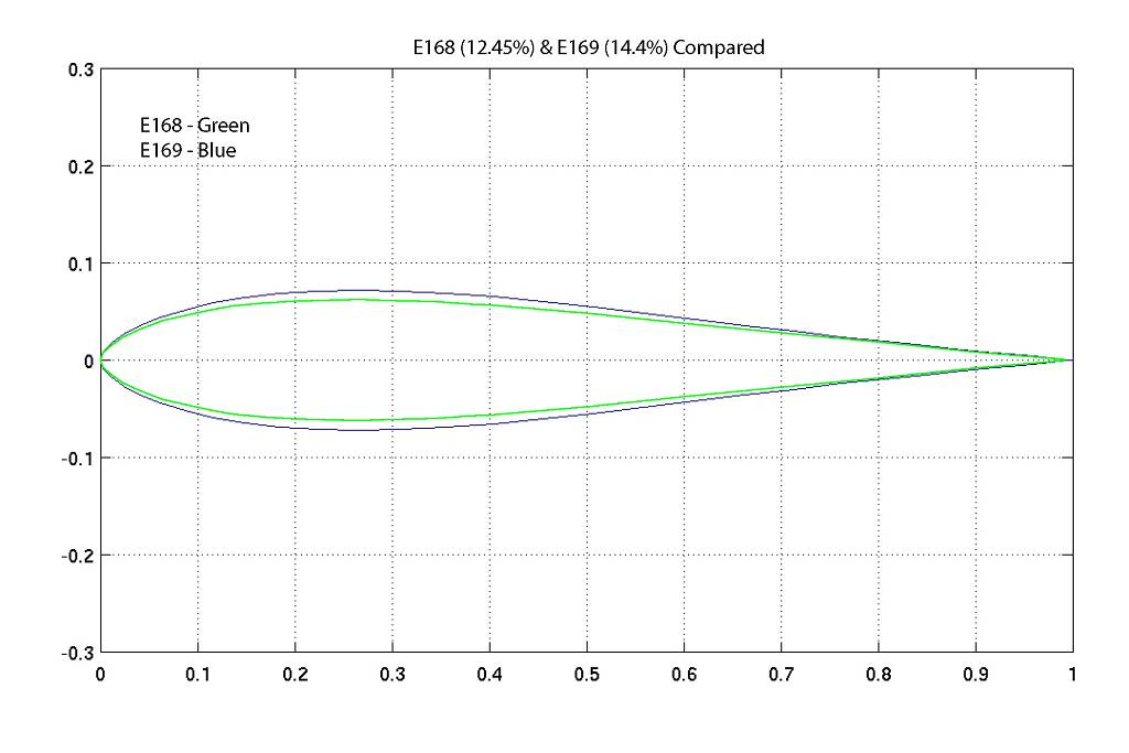

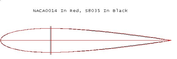

I found an interesting thread discussing the differences of S8035 vs N0014:
http://www.rcuniverse.com/forum/m_160720/tm.htm
It would be interesting to find a similar discussion (or perhaps wind tunnel tests) on the difference between E168 and N0014. This latter looks to be very similar to the airfoil used in the GP CAP.
If the desire is to keep fuse planform (wing/stab positions) on the CAP, would it be preferable to use something like E168 or N0014 to prevent "snapping" tendencies at low speed?
Attached is a drawing comparing S8035 & N0014. For comparison, beside it are the E168 & E169 flat rear airfoils. Max thickness of the latter appears to occur at about 26% chord.
David.

David, I don't think the snapping noticeably depends on the vertical position of wing and stab. That's more a matter of belly pitch in knife-edge, what the originals were (still) not made for. Hanno "cheated" on his Dalotel by lowering the stab. (Just can't find the Dalotel thread here.)
Snapping surely depends on wing planform and airfoil, but I think wing loading is paramount. A small drive allows lighter structure and maybe even the same performance as the usual heavy models. Maybe it's just impossible to build a 40 size CAP light enough so you have to modify it somehow. I'm not impressed by the idea to build a small proof model, at least I wouldn't even try to fly it. I would expect substantial differences in flight behaviour to the bigger versions due to inevitable higher "relative" wing loading and Re number effects. Even the 1:4 version will and can not fly like the original. The test pilot reported a smooth and stable stall without wing dropping. As Deadstik said, the CAP model is a pilot's aircraft, meaning the pilot has to avoid slamming the sticks to their stops. A high-wing-loading model has to be flown quite fast and is not able to fly sharp corners - that's all.
You may read [link=http://www.eng-tips.com/viewthread.cfm?qid=183605&page=2]this[/link] and [link=http://www.eaa1000.av.org/technicl/onedesaf/1desaf.htm]this[/link] discussion of aerobatic airfoils to find very interesting characterizations. The flat-rear airfoils just give a sharp stall instead of a smooth stall of the NACA 4-digit series. I have a book with measured behavior of E168 and 169. For a small model you should use the thinner airfoil. The thicker one has more stall hysteresis and a soft stall with little lift at small Re numbers. Both have small drag over the whole AOA/lift range. So they should be really better than S8035 or NACA 0016, regardless of model size and wing loading. By the way, maximum thickness is at 25% / 27.9%, respectively.
Me seems your TOC size model would still be too small to come closer to the original, even at the ambitious low weight you specified. I think Hanno knew why he built his Dalotel to the maximum size allowed (and still "cheated" ), he just didn't tell it explicitely. You could cheat by reducing the taper ratio.

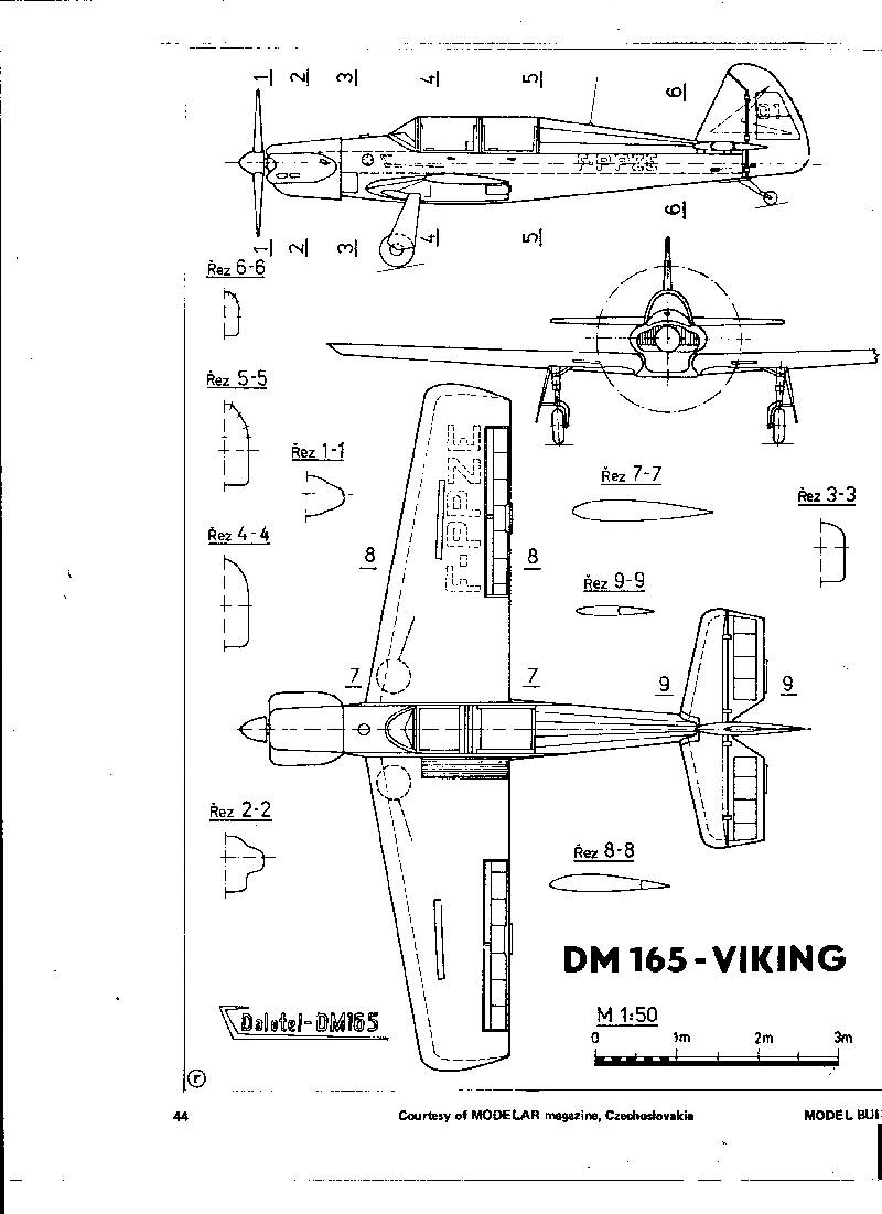

On a related note; any idea what this Dalotel airfoil might be?
Looks closer to N0014 but with a max thickness closer to the LE.
David.

As to Hanno's Dalotel, I just compared the picture to the original's drawing. I think the model has less dihedral and a symmetric airfoil and maybe even more modifications. The original comes close to the Z-526 in my eyes. With both you have to decide building a scale model (also in behaviour) or a TOC-like flying model (looking roughly like the original). The CAP is nearer to modern planes but may still need some modifications. Actually, I'm not a designer but like to figure out the aerobatic designs. I've compared quite a few of them in different model sizes and at different weights, but not the CAP so far, so I'm all but sure.
My last sentence was wrong. I actually meant increasing the taper ratio or reducing taper for a less tip-stall prone wing planform. I think Hanno followed "bigger flies better" by building his model as big as possible. Not that the snap behavior is better, most important is the lower "relative" wing loading.
You are right, today's models are very lightweight and less airframe weight requires less drive power and weight. Besides, the low wing loading makes for slow flight speed and low drive power. Obviously, Hanno already used the same trick. I think the two .60 engines combined were still not that powerful for the big model, but the gear made a slow-turning big (high efficiency) prop possible and that made for more prop power than a bigger gas engine.
But "bigger flies better" simply means that some movements are scale-like at the same cubic wing loading and most of them even at the same quad wing loading as that of the full-size airplane. That requires a very low absolute wing loading and weight for small models. One reason I admire Ken Bonnema's Brushfire is its "consistency. It's quite big (850 sqin) and has to be built carefully for low weight (lightening holes in the foam cores, film covering, ...). Deadstik achieves 8 lb, giving a wing loading considerably smaller than that of Curare. (BTW, the Curare airfoil could be E169, I should check that.) Still its relative wing loading is quite high (22) so it flies more like a jet aircraft. Fortunately, or consistently, it was designed in the ballistic pattern era when jet aerobatics were imitated (maybe triggered by the Blue Angel) so it even looks like a full-scale jet. Problem with the scale models of full-size aerobats is that they look like an aerobat but fly like a jet. But maybe that's only my problem because I'm a purist.

that is one heck of a picture! Not only do we have Hanno and the Dalo at the 1980 TOC in the foreground but, I'd say that is Hoppe's CAP 21 in the background! Unless, since we can't see the wing, it is Bonetti's or Tracy's CAP 20 (same fuse/elliptical wing).
I compared some other Eppler airfoils to the Dalo wing and found the E472 to be the closest match. Actually, at ~12% it is still too thick compared to the airfoil chosen by Obi. Fluid dynamics aside, hopefully, this will translate into an airfoil that will fly the 72" TOC model favourably as well as the much smaller 48" version. The proof is in the pudding I suppose.
Actually Obi, coincidentally, published a first pass at his Dalo in MAN June 1982 - exactly the same issue of MA for the CAP-21 - nice! In that case, his model was a 40 size 54" span and all indication in the review was that the model flew very well. I hope that trimming 6" off the span on an improved design won't change that!

David, it was late yesterday, too late for me, and I even forgot about the unusually high aspect ratio (7.1) of the CAP 21 even though you mentioned it. I think that may contribute to the snap behavior. The Z-50 has similar behavior with only 5.9 aspect ratio, but it has conventional NACA 00xx airfoils. After some experimenting I'd say it should be possible to make the CAP less snappy with a suitable airfoil. It shouldn't lose much lift when stalling, what the NACA 00xx do, though, and the E 169 does as well. The other modern aerobatic airfoils with very forward max thickness (less than 20%) might do the trick. E 472, 473, 474, 475, and 479 might do as well but they are suitable only for bigger models and have much increase of drag with AOA. (By the way, did you read that they tested the type in a spin wind tunnel?)
The CAP 21 has a quite big stab and huge elevator and long tail moment arm so you may pull it to a stall AOA very easily. Due to the high aspect ratio it will stall even at 17 degrees. Besides, it has a pronounced mid-wing to tip stall (giving better snaps) due to the special wing planform. Not as much as modern aerobats but enough to require a special airfoil (my guess, I'm not an expert). Like me, you may find it interesting to compare the planforms of various aerobats (Z-526AFS, Z-50LS, CAP 21, Su-26M, EA-300S, Edge 540) with comparison to elliptical planform.
My simulator is good but still a rather simplified rendering of a model and stall aerodynamics. I tried the behavior with a 1:4 scale model of the CAP 21 and found it snaps and spins like crazy with only 25 degrees elevator (30 degrees rudder aren't even needed to snap). An airfoil which doesn't lose lift in stall calms things down.
There's no parameter for the stab position, but moving the wing 2" up turned the substantial belly pitch into a bit canopy pitch (1.5 degrees dihedral unchanged). I find the belly pitch not really bothersome and would mix it out.
By the way, 1:4 scale (2.02 m / 79.5") really seems too small. It gives 890 sqin wing area, and with 9.5 lbs weight the model is somehow similar to the Brushfire. You might deviate from exact scale by clipping the wings, as you mentioned, what would reduce the snappyness and make it easier to build a strong but lightweight wing.
A 1:3.5 version, exactly scale (2.31 m / 91"), at 14 lbs (6.35 kg) is noticeably less snappy, and if you could build it to 11 lbs in that scale it would be just perfect! By the way, the three-view of the original seems to show about 1 degree incidence for the wing. Even less than 1 degree removes the belly pitch but requires a bit more down elevator inverted. Another choice.
I used 0.25 degrees wing incidence and 0 degrees stab incidence (4% static margin), giving neutral trim upright and nearly neutral inverted. 3% static margin might make it neutral both upright and inverted. But how about giving both wing and stab 1 degree incidence. That makes the plane look better in the air, again both upright and inverted.

Rusty,
Thanks for your call to D.Guerin.
The wing is actually already floating somewhere further up in the fuse. I am determining how to finish the fuse bottom without loosing too much of the original scale appearance. The cowl rear bottom and wing TE location on the fuse are not at the same level which is something that is taken care of by the wing airfoil. With a higher wing, some compromise has to be met on how and where to break the angle of the fuse bottom. The easy solution is to just extend the fuse rear to the fuse front at the cowl junction but this might not be very elegant. Lowering the fuse at the wing TE (greater lower fuse aft angle) might also be a better way to preserve scale lines.
All this of course leads to the idea of plug-in wings which I'd prefer (for space constraints if nothing else). You mention that an alum tube helps with adjusting dihedral angle - how so? However, landing gear struts are mounted to the wing LE and the wing hold down plate in the fuse. If the wings are designed to be plug-in, I'm not sure that the tube would withstand the stress of a 10 lb model landing on the wing panel LE's!? I know this was done with early turnaround pattern designs which had panel retracts but they were located much further back. Any thoughts?
I was taking a look at the GP CAP EAGLE 580 EP (Matt Chapman's model) and see that the stab has been lowered to well below the thrust line. It is also moved back a tad so the stab TE is no longer inline with the fin LE. Angle cuts in the elevators are needed to clear the rudder. Both of these changes break the "scale" appearance in my opinion but I'm sure that the rearward stab position smooths elevator response somewhat.
The GP 27% CAP 232 has a slightly higher stab position (still not scale on the "fuse top" where it should be) but it is in the correct rear/aft position. So, with that brief analysis, it seems that Dave's recommendation to leave it in the scale rear/aft position and lowering it to the thrust line stays within a 15% TOC deviation (for what it's worth) while maintaining scale appearance.
As far as the wing goes, I will probably locate it higher up in the fuse at the equivalent % stab departure from its scale position. This seems like an even scale departure for flying surface locations.
I look forward to any feedback on these comments.
