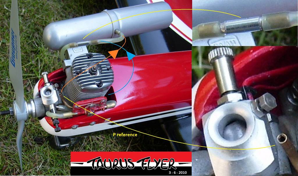

George,
Webra, right choice
When you look at the backside of the black (nylon?) bottom, you see the adjustment screw of the pressure regulator. On both sides of the screw there are little holes, see the green arrows on the picture 1.
For us this was an indication these holes are probably to position the regulator when fastening the pump/regulator in the aluminum housing.
For that we did try to screw open the aluminum insert out of the housing, see picture 1.
There is a fine thread used to mount these two parts together with all the internals in it as a sandwich.
It was possible without any tool to open the surprise, but when not possible by handcraft try by rotate the aluminum inside with a tool but protect the material with a piece of cloth or else.
Be careful with the fuel connections and DO NOT REMOVE THEM.
When you can open the housing the inside parts you can assist to come out by blowing on the crankcase side of the housing. (Hanna’s suggestion, see is the physicist I am the engineer!)
For the diaphragm you have to unscrew the little nut and remove the valve to separate the diaphragm from the valve seat part.
After the diaphragm is separated you also can remove the screw and two metal plates from the diaphragm. Take attention for the position of the valve on the screw.
The valve is mounted between two nuts and it is good to give the valve the same position when mounting the new diaphragm, because of the “work point” (compensation of the proportional fault of the regulator! LOL)
Success, and we are interested in the progression and if we can help, ask.
Hanna and Cees

#62
Lazer,
for information only
The pump and pressure controller as built for the Orion left side.
The pump is driven by the crankcase pressure of the Enya 60 4C, but the combined regulator is like cline.
This combination you can compare with a Walbro carburetor.
The amount of connections show us this is more complicated than a Perry pump (right side).
There is a sixth input on the backside to sense the airpressure in front of the carburetor input.
It is this picture that shows us also you need a lot of R & D to make a reliable and accurate fuel system for a 4 cycle I think.
Cees

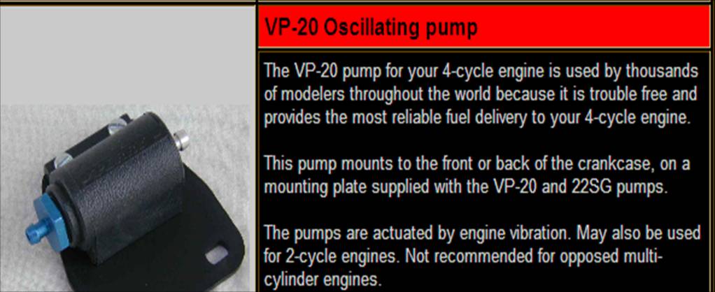

[img]file:///C:/DOCUME~1/UserXP/LOCALS~1/Temp/moz-screenshot.png[/img]Just a question:
Here in the specifications of the VP 20 Oscillating Pump says that it may be also used in 2 cycles engines.
Have one of you guys used one of these pumps (VP-20) in a 2 cycle engine?

Has anyone tested the Webra fuel pressure regulator? It uses a slightly different approach by pressurizing the fuel tank via the case then regulates that supply by muffler pressure to match engine speed. Sounds good and doesn't mention a need for a special carb.
[link=http://www.webra-austria.at/motor.php?folder=ACCESSORIES&lang=EN]http://www.webra-austria.at/motor.php?folder=ACCESSORIES&lang=EN[/link]
#75
ORIGINAL: 790
790,
The Webra fuel pressure regulator.
I did not try the Webra regulator but read the description and for me they are nearly all the same so I give you my two cents!
Webra let you connect the reference input for the controller with the connection of the muffler.
Background of the principle is:
During flight the regulator will control the fuel pressure to the spray bar of the carburetor equal to the pressure of the reference input of the controller, so in this case the exhaust pressure.
This way of connection the result is, the carburetor is feed with the same pressure as normal when the exhaust connection is connected with the air input of the tank.
Your profit is, the position of the plane doesn’t any matter, the ratio of fuel and air is like horizontal flight with “no regulator” and the standard carburetor.
Some points to think about:
First, mount the controller as close as possible near the carburetor, see the picture for example.
Second point is, the exhaust pressure is pulsating, when you cannot adjust the fuel air ratio adequate you maybe can put a restrictor (and capacitor) in the line between the muffler and the reference connection of the regulator. Normally the tank pressure is an evenly average pressure of the exhaust pulsating pressure.
Third point is, be aware of the tank pressure when used a crankcase tap, it can rise to 5 -7 PSI, enough to pres the fuel 20 – 30 feet above the plane!. Think about where we can find the hydrocarbon liquid when something goes wrong in the plane!!!! ( google for “Koseq”)
No engine pressure tap?
Because we normally do not need such a high tank pressure when the tank is mounted behind the firewall, I use the exhaust connection and a check valve to pressurize the tank , see the picture.
The reference connection of my controllers/regulators I connect with the brass tube in same position as the air intake of the carburetor, this way I realize compensation of any (airspeed!) pressure near the air intake also when the engine is mounted inside a hatch.
Keep in mind, the Webra regulator you probably also can use the way I do, see the blue and orange arrows.
If there are more questions I maybe can answer, please ask.
Success.
