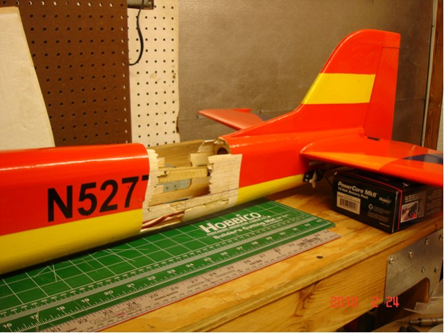

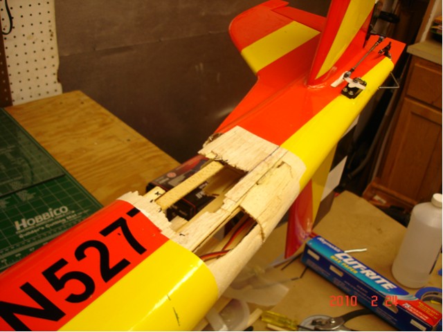

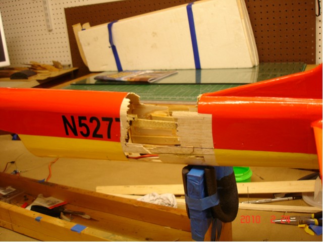

# 3 Crash & Fix. Temporary framework set in, will apply stock longeron's, balsa skin, glass and re-cover monokote. Be like new.

Looks good crank. Easy fix, you will be ready for the weekend. No damage to the wings?

Joefroo - Wing is fine, it hit on one wing tip, separated the seam that is butted up to the balsa, it is fiber-glas wing tip's. On these Intruder's, I join the wing halve's, glass the center section, just like a foam wing.
I had a write up on the first post, too much to read. This is Intruder #3. This fuselage broke at the exact place that Intruder #1 broke at the Apopka contest over two years ago. Downwind turn on final, cut throttle little too soon, it just fell out of the air, high speed stall? Fell nose down into a sand pit, you could almost mate these fuselage's together, both broke right in front of the dorsal fin. Many years ago, flying Goldberg Falcon 56's, a hard landing, the fuselage would crack right in front of the stab.
I will glass this area, monokote, will be like new. These WM Intruder's are stripped of the factory film, monokote applied.

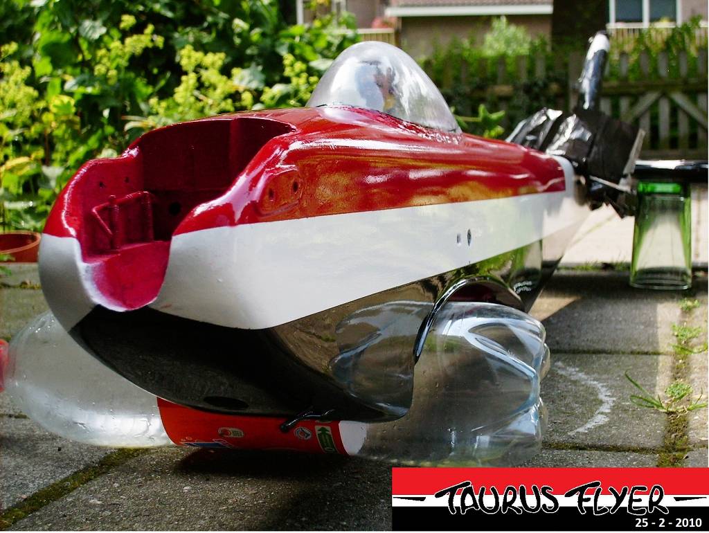

My Taurus fuse also was on a moment in two pieces after an low inverted dead stick. Picture 1
The drawing, picture 2, show how I repair: renew the destroyed section by replace new material. Make the glue joint surfaces with a ramp of about 1 : 10. When these glue joints are good you do not have to add extra reinforcements.
During repair I fix the front and backside exact ā€œIN LINE and on RIGHT DISTANCEā€ on an extra structure of plywood..
The picture of the painting (3) of the repaired section is during last overhauling, only inside the fuselage the glue joints of the crash are still visible.
I only use the old school sheeting and finishing materials, so never glassing or film.

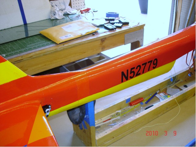

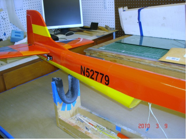

Finish. Glassed this, done. Stripe's will hide the crooked line separation.

Vince, I see the Focus in the background in one pic. You're goona have to get that thing out and fly it some or give it to me
