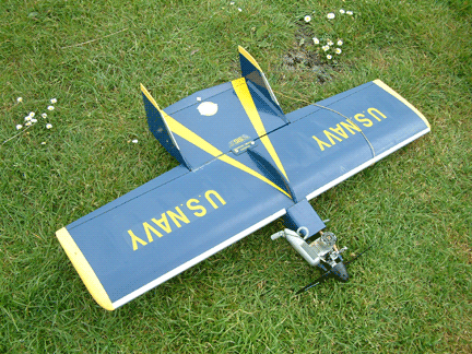

Free Bird got it first. It's a Shrike.
I had a Speed 400/.049 kit from just before Bubba sold out to Hobbico that I put together two years ago when I moved to IL. I had it powered by the equivalent of a .10-.15. It was a rocket and lots of fun, but due to problems with my eyes I needed a larger one, so I gave the old one to a friend.
I started by putting the outline of the Speed 400 Shrike (published in Flying Models) into CAD, then scaling it to 35" span and putting a structure within it. This new one has E-Flite electric retracts and a Power 25 Heli motor. Just under 300 sq in. I expect to have a bit of fun with it! I may drop down to a Power 15 if the Power 25 system is too heavy for safe landings.
It's not Classic Pattern, but it's a classic and VERY aerobatic (I'll probably add rudders to it).
Andy
Andy

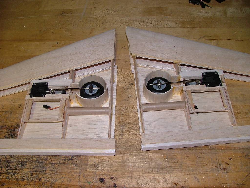

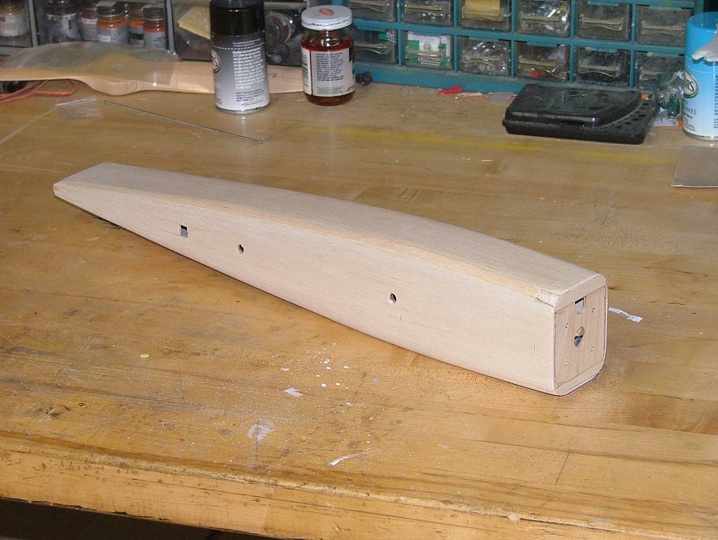

Time for a few more pix. I haven't been taking them as I go, so what you see is what it looked like this morning when I left the house.
The wings are mostly sheeted. I only have to install the wheel wells (1/16" balsa wrapped around a 2" rattle can for a mold), then cover the center section around the wheels and aileron servo panel, and add cap strips to the top side of the outer three ribs. And make the 1/2" thick tips.
The DB pushrod spars are not installed at this time - they are used as a jig to build, but removed so that I can work easily. They get glued in when I attach wings to fuselage. The big paper tube is .5" ID model rocket body tube used as a conduit for the servo and retract leads.
The fuselage has barn door access. The front hole will be covered by a door when the gear is up. The rear one is the battery hatch and it will be held in with magnets. You can also see the 3/8" sq stab framing. The elevator servo will be installed behind the rear hatch, accessed through the air exit hole (yet to be opened up).
My plan is to finish it the same as my Kaos - white and orange with black and silver trim. Spektrum colors, of course.
Andy

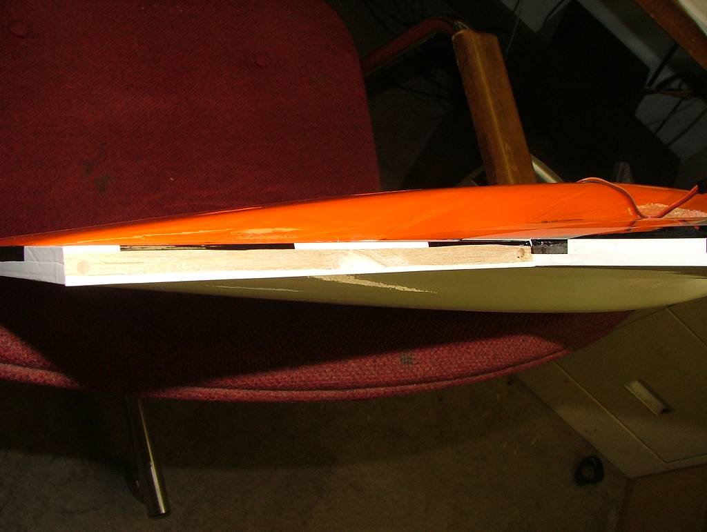

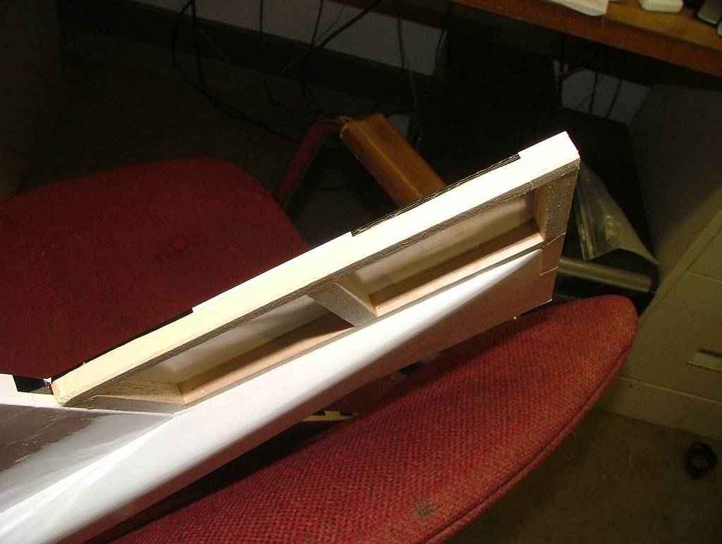

Covering is just about complete. I wanted to show a little trick I use, which is especially important on the Shrike.
We all know you can't glue to covering and expect your model to stay together, and we always do most of our covering before assembling components. So how do you make nice edges and remove the covering where it normally gets so that you can make a strong glue joint?
On the Shrike, this would be the wing roots to the fuselage and the vertical fins to the sides of the stab.
Here's my trick. I make a template the size of what I want to glue using masking tape. It is about 1/16" to 1/8" smaller than the surface (larger surface area is better). In these photos you can see (if you look closely, it's hard to see) where I put masking tape on the side of the stab before covering. I then covered the stab normally, and then cut the film away using the masking tape as a guide for the tip of the knife blade.
In the second photo, I have removed the masking tape and covering that went over it. You can see a nice glue surface left behind. You can also see the 1/8" dowels that peg the stab together.
My goal is to have the Shrike ready for a Memorial Day maiden flight. I would much rather be at Rusty's contest today but I was at an event last week and another next week. I think me being gone three weekends in a row is a bit too much to ask from my wife.
Andy

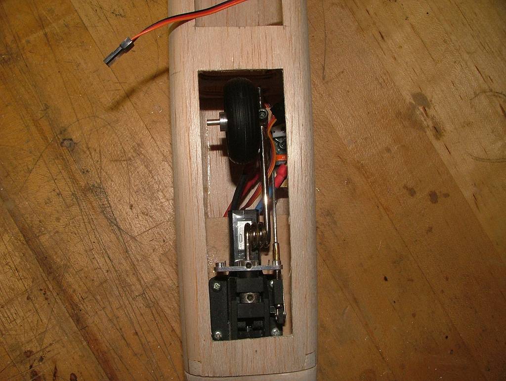

Somebody on RCG asked about the nose gear door. Here's what I told him:
The door is simply cut out. The bottom of the fuse is curved there, so the door itself is curved but the hinge is tape only on the back half. There are 1/4" sq front and rear. The front one rubs against the side of the gear leg as it drops, pushing it all the way open. There is a short piece of string CA'd to the inside fuse about the height of the retracted leg, and to the door at the bottom (when open) edge. As the leg retracts, it contacts the string and pulls the door closed. Super simple! (Things work best that way).
The main doors will simply be attached directly to the legs. Attached are some stills.
A video of them operating is here: http://www.montanadesign.com/planes/...e/dscf7903.avi
The tape was just something we did real quick at the field. The concept works great, I just need to clean it up a little.
Andy
