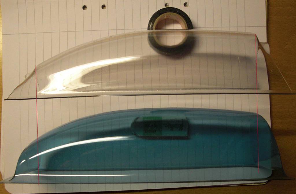

Hi,
I have both MK Super Sicroly II and MK Curare 60 canopy so comparison is easy. They are as You said close to match but the Super Sicroly II canopy is little longer then Curare 60 canopy- see images below (SuperSicroly II canopy is the blue one). I did not know that Eureka Aircraft do not ship outside US anymore - I have bought short kits from them and it was no problem sending outside US.
/Bo

Hi Bo,
Thanks for posting images of the MK Super Sicroly and Curare canopies. It's good to see them side by side.
I wonder whether, after the canopies are cut to fit, the differences seen in the mouldings will matter at all. I think either canopy will probably fit either plane. Aesthetically, the Super Sicroly canopy has a little more of a curve to its top profile, but after it's built onto a model it will take a very sharp eye to make out the difference.

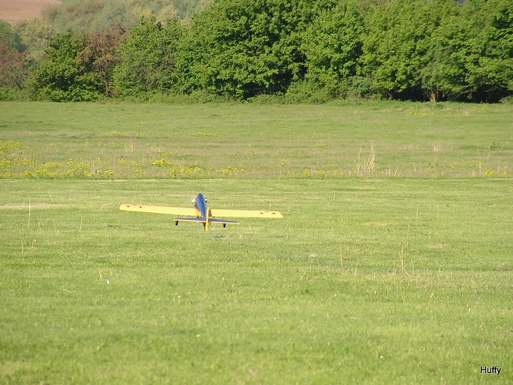

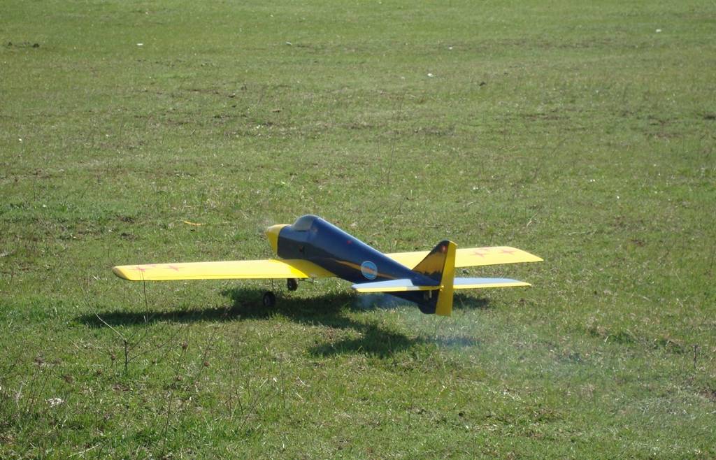

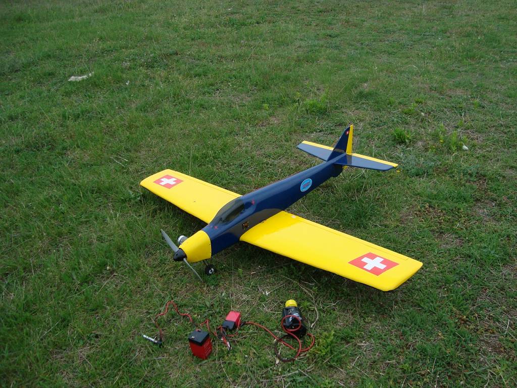

Hi guys !
About two years ago a bought a classic pattern plane from an old modeller. He told me that it was a Sicroly that he builded in 1972 after he received some hand drawn blueprints from Hans Prettner. The plane was kept in the attic since it last flew in 1995. I asked him how many times the plane was flown, and the answer was "with this Webra that I put in it in '77, about 150 hours but no crashes". He also told me that the plans were never published and probably this one is unique. After this story I paid for it together with the RC 150 Euro (~ 185$ at that time).
Indeed, the engine was totally wreked, piston skirt rounded, the pistonring very tired, and the conrod had 0.5 mm play, the bearings had so much play that were about to dismantle themselfs. Also the Kavan wheels were hard as a rock with the stripes hardly visible. It seemed that the old modeller was telling the truth about the age of the plane.
It took some time to restore the plane, it was painted so I had to whipe it using a lot of nitro solver and then fine sanding the plane and use some filler to level the surface of the wing. The tank (MK 270ml), engine mount, wheels and hinges were also replaced with new ones. I recoverd it with Solarfilm, installed some new electronics (the original servos were Simprop Contest Speed and the RC a 1978 Simprop Contest 8 SSM with dual rates). The engine was replaced by a HB PDP 61 with Perry pump and carburettor from the early '80s.
Until now I managed to do around 20 flights. The engine was difficult to tune in the begining but after this was settled it's turning an APC 12x7 prop at 11.200 rpm using 5% nitro fuel and has enough thrust for my style of flying.

A most unusual looking Sicroly...unlike any in any of the published photos going right back to the late '60's. The plans would be worth quite a bit if authenticated...
Evan, WB #12.

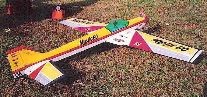

The dimensions (and ultimately a plan) on the Mystic 60 Hanno Prettner flew at 1993 World Championship should really fill a gap in my opinion. I know there was Mystic 30 and 90 ARF from EZ but that is not quite the same as the WC model Mystic 60.

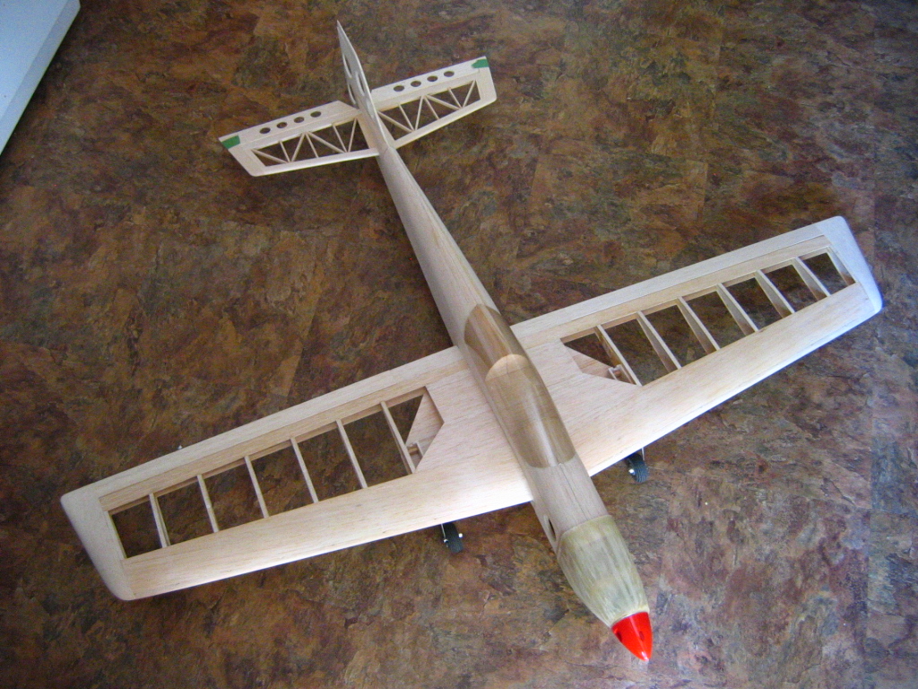

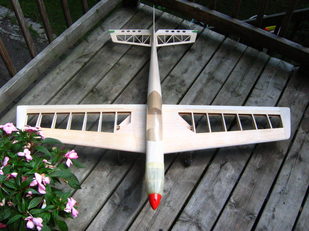

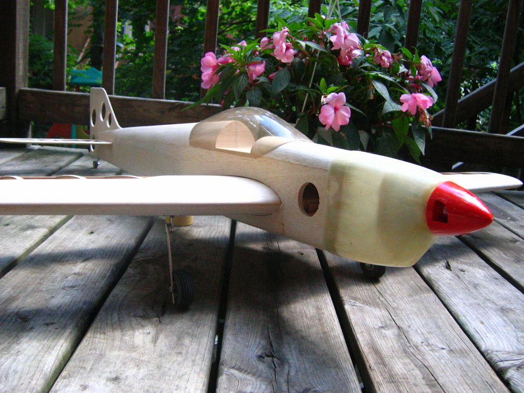

You guys mean a Mystic like this...
Getting there... just a little more work but little time lately. This is the E-Mystic (4s, ~750W), there is also a G-Mystic (OS 32 SX and #300 Hatori pipe) in the works but needs a little more hand cranking before its read for finishing. Electronics are fortunately all lined up - 5000 series Spektrum servos on the tail and Hobbico digital CS-110's on the ailerons.
But these are just 30's. The pursuit for a real Hanno '93 WC Mystic 60 plan is something that I would also very much like to see in the flesh. If Hanno only were to be able to share these plans with his fans for posterity and the good of all mankind (well, maybe that's a stretch...
). The Calypso plan is something that I have began working on since I have an almost complete built up model. The design of the Calypso is perhaps one of the simplest models I have ever come across. A joy to build and it will be fun to one day finish up those plans.
John, I seem to recall that you were going to do some extrapolating from a Model Tech ARC that you had if I'm not mistaken. The kit built is a little simpler than the ARC but the lines are the same - just no foam on the fuse. A simple box with cross grain sheeting all down the top with a pair of turtle decks built atop. I have posted a bunch of photo of the Calypso build here and on RCG. BTW, it wasn't me, unfortunately, who got to spend time with Mr. Prettner. It's our friend Michael who says he lives not far from Hanno.
Michael, please keep me in the loop if you happen to come across a set of original Mystic plans from the master himself. I have been known to do extreme things for treasures like that...
I almost forgot, one of the extreme things I've done was to procure a NIB Hanno Special. Received it just a few days ago...
'tis a Mark I intact with Hatori header and pipe (well, the red pipe is branded by OS but it's really made by Hatori). That engine is reserved for an M60 that will be built the day plans are something we can work from.
David.
). The Calypso plan is something that I have began working on since I have an almost complete built up model. The design of the Calypso is perhaps one of the simplest models I have ever come across. A joy to build and it will be fun to one day finish up those plans. John, I seem to recall that you were going to do some extrapolating from a Model Tech ARC that you had if I'm not mistaken. The kit built is a little simpler than the ARC but the lines are the same - just no foam on the fuse. A simple box with cross grain sheeting all down the top with a pair of turtle decks built atop. I have posted a bunch of photo of the Calypso build here and on RCG. BTW, it wasn't me, unfortunately, who got to spend time with Mr. Prettner. It's our friend Michael who says he lives not far from Hanno.
'tis a Mark I intact with Hatori header and pipe (well, the red pipe is branded by OS but it's really made by Hatori). That engine is reserved for an M60 that will be built the day plans are something we can work from.David.

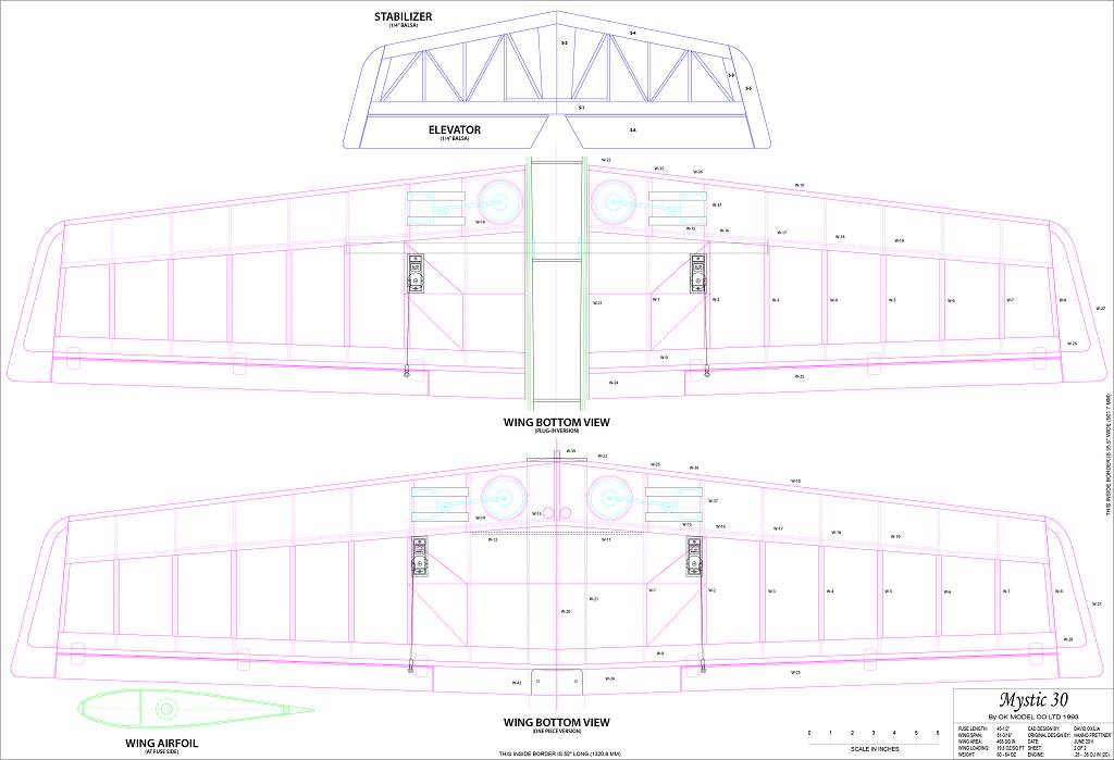

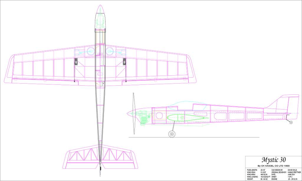

Speaking of plans, for those who missed a post I made a few weeks ago in the Mystic 30 thread, I've managed to make some progress on the M30 plans based on the OK Model plans but already modified for flexibility to build with a plug-in wing. Much work still to be done but they may serve one day as a basis for the M60. Moments and aspect ratios are somewhat different from what I've been able to infer but they will provide some sort of outline at least.
