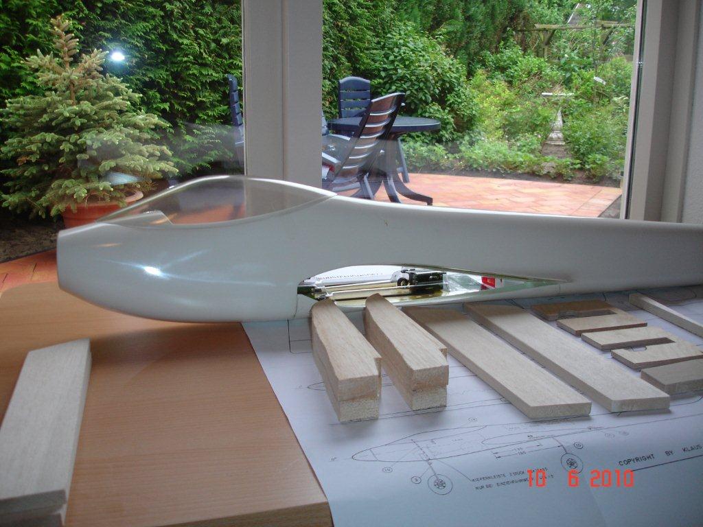

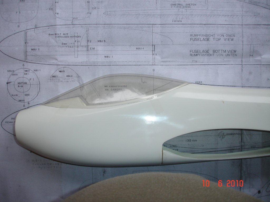

Also some pictures with a comparison of the Red Devil Fuse and the old style BA drawing.
As you can see the fuse is identical to the BA
Only the vertical stabilisor is different from the original BA, as it is higher and the fin underneath the fuse is missing.
We will shorten the stabilisor as per BA drawing and add a fin to the bottem of the fuse.

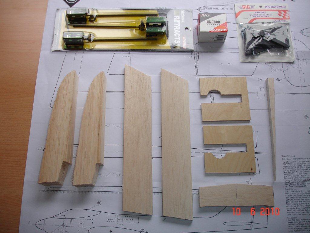

Also we already cut out the elevator halves and frames for the retracts and some other parts.
Also the wing tips of the original BA drawing were used, as the Red Devil type has ailerons which continue all the way to the wingtip.
The same we did for the horizontal stabilisor.
The picture clearly shows the RD wingtip and stabilisor tip and the (roughly shaped) BA style wingtip

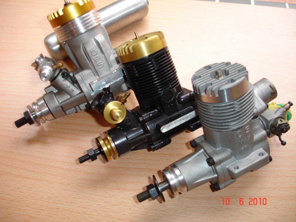

From: Ter Apel, NETHERLANDS
Still have many decisions to make.
What engine to use for example.
I have the normal O.S.61 side exhaust engine and the Irvine61 side engine, but also a few engines which are more "exotic"
An OPS61, an HP61 Gold cup and a O.S.61 VF
Any suggestions?
Regards,
Gert
Any suggestions?
Regards,
Gert

OPS-

Thanks everybody for the advice.
The OPS 61 is very tempting and it was only run in, has never flown.
It is a very reliable engine, starts with one swing against the prop and idles also beautifully.
On the testbench it ran a 13" prop with the same rpm's as the 11", with the 11" it just would not go higher in rpm's then with the 13"
So the prop to choose will be most probably a 11x11
The only problem is the exhaust pipe, as it hardly silences and in the Netherlands we go to max 80db at 7metres.
The exhaust connection on the cilinder is somewhat overdesigned and a normal header won't fit.
So I will need to have a header made.
Personally I like the looks of the HP61-F Gold Cup, but it has never run and I have no idea if it will perform like a pattern engine.
Also still lying around is the original Enya61X, and as far as I know that is the engine Yoshioka used with a different carburator (as the original was useless)
I also have some Webra 61 speed engines (side and rear exhaust, long and short stroke)
Looking at noiselevels the Webra 61LS with a Hatori pipe and 11x11 prop is the winner as it is very quiet
For now I will put all the engines next to each other on the table and look at the pro's and con's, and as I still have to install the engine mount all options are open.
Choises choises[sm=spinnyeyes.gif][sm=spinnyeyes.gif]
Regards,
Gert

Hey Gert,
You might want to consider the engine weight. I seem to recall that people building Blue Angels have trouble with the CG ending up too far forward. There might even be something about the CG in Mike's Blue Angel thread, if I find any reference I'll post again.
The engine Yoshioka used in his Blue Angel, and the engine the MK kit was designed for, was the Enya 60 B-III. The 60 B-III wasn't a Schnuerle-ported engine, it was cross-flow scavenged. I think the 61X was a later, Schnuerle ported engine. [link=http://www.enya-engine.com/ListCL_E.html]Enya still supply a control-line version of the 60 B-III.[/link]
The Enya 60 B-III only weighs 380 grammes. A later, Schnuerle ported engine, as we will tend to use in a ship like this today, will weigh a bit more. For example Webra 61F, as used by Prettner in the Super Sicroly II and Curare, and by Matt in the Atlas, and [link=http://www.webra-austria.at/motor.php?search=1024&folder=AERO&lang=DE]still made by Webra[/link] weighs 445 grams.
I too have a pair of Webra 61 LS long stroke, mine are rear exhaust. I haven't weighed them but I'm sure they weigh a bit more than my 61F.
And about the HP 61 Gold cup, going from the [link=http://www.mecoa.com/hp/61/2203.htm]specs given by MECOA for the HP 61 Gold Cup they make today[/link] the weight is 17.1 ounces, or 485 grammes, that's over 100 grams more than the Enya 60 B-III.
Best regards,
George
