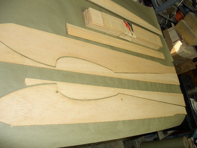

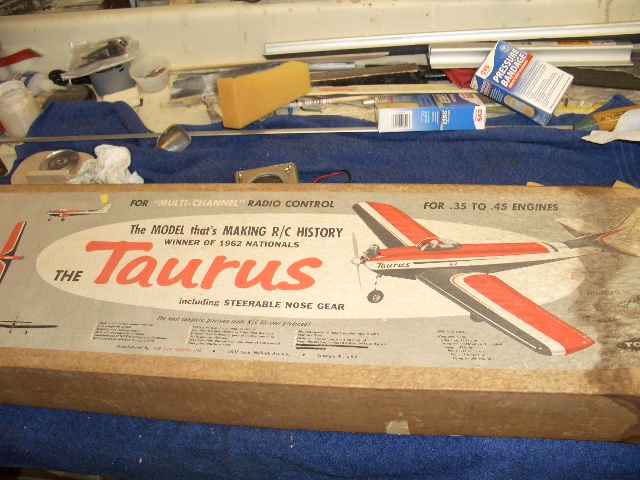

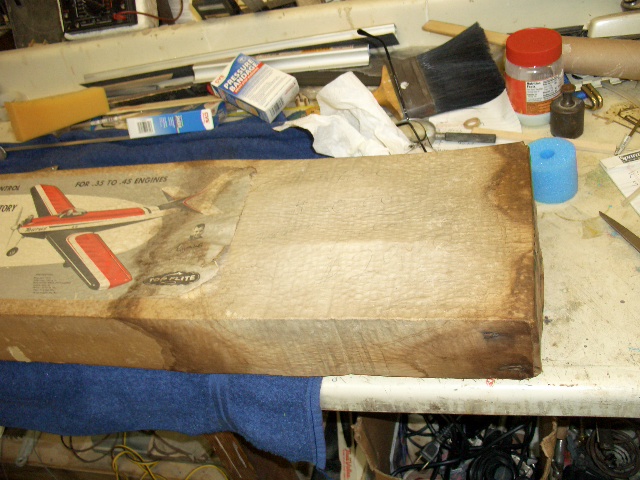

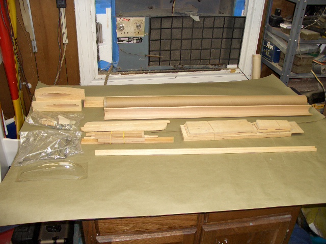

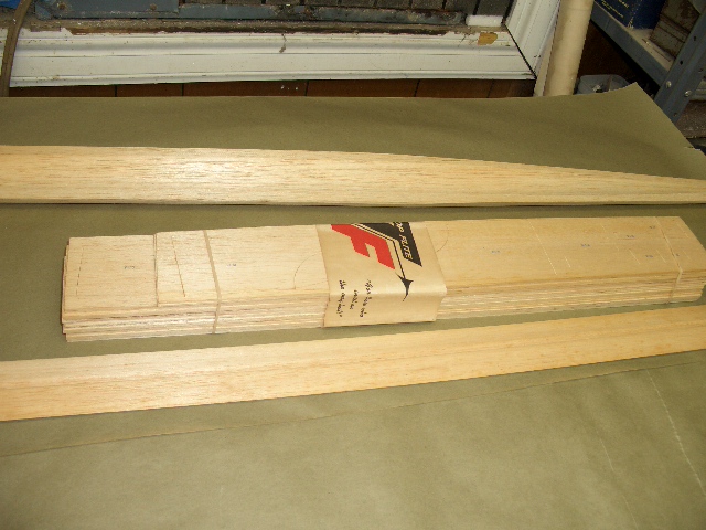

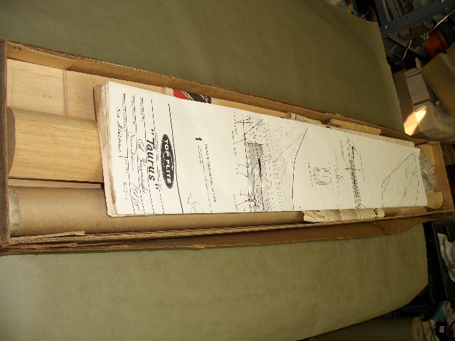

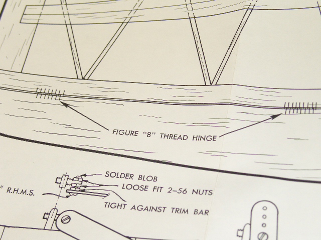

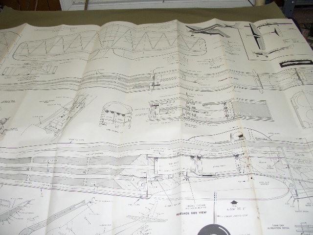

Here are the photos. He says the kit is complete. There is some water damage on the box, but the wood is not affected. I thought I'd post the photos here, let you guys look them over to make sure there aren't any glaring problems, and then list it in the classifieds.....sooooo, if you guys don't mind, look the pics over and let me know if you see something wrong, or if you don't see something that should be there. I want to be truthful when i list it, and I know nothing at all about this kit. Thanks.
