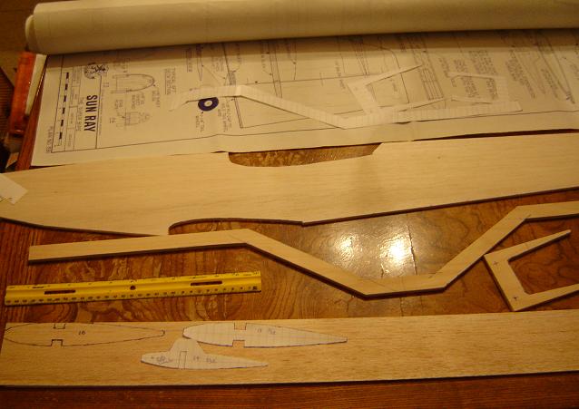

I've already cut out several parts including the gull wing spar from 1/4" ply. I'm using notebook paper to trace parts on the plan. I taped a few sheets together for making a fuselage side template. The notebook paper isn't very transparent but I was able to see thru good enough to trace parts.
Next I want to make the wing ribs. I need to make 18 identical ribs for the upper wing and 24 identical ribs for the lower wing. Cutting these individually would take a long time. Anybody remember a method of stacking balsa blanks between two plywood rib templates and then sanding them to shape. I think you drill two holes thru the stack and bolt them together before sanding. Is that how it's done?
Anybody have a March 1975 RCM handy? I wish to see if the article has any helpful construction photos. My RCM plans only included a copy of the text. Real bummer the photos aren't included.

nice project. That's a good system to cut the ribs. Start with two identical ply templates to sandwich the oversized balsa ribs. You can bolt them together if you bore two holes through the stack but drilling nice round holes in balsa ribs is tricky unless done with a very fast rotation bit (i.e., a Dremel). I find a satisfactory method is to clamp the stack from one side of the ribs (e.g., bottom) and then contour the top ribs to template with a band or disc sander. You then flip the clamps over and repeat for the rib tops.
If you want to make some lightening holes in the ribs, I find that a Dremel drum sander works well. Make your hole in the templates and then sand through them with the Dremel. With a little care, you end up with a nicely bored set of ribs.

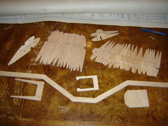

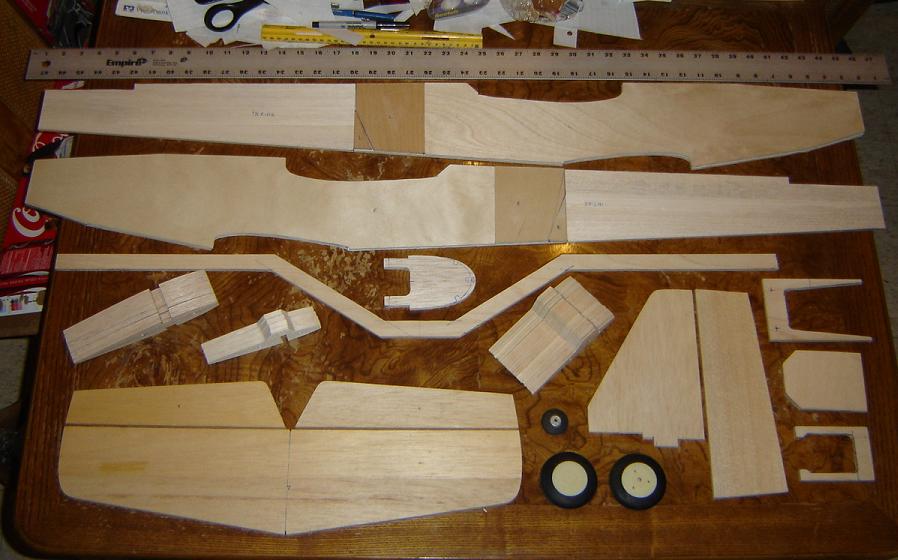

I finished all the ribs! I only sandwiched 6 rough cut ribs at a time between the ply templates. That seemed easier than dealing with a tall stack.
Guess I'll make the ply fuselage doublers next and misc balsa fuselage formers.

Looking great! If only my hand-made parts would ever look that immaculate, haha. I'll keep checking back to see your progress in the hopes that it'll get me off my duff to attempt my own build. The Sun Ray is just quirky enough to be my kind of model. Good luck with the build, not that you'll need it seeing the quality of your workmanship this far. Take care. -Mitchell

Thanks! The parts are slightly oversize after I cut them with my Dremel scroll saw. Then I carefully sand them to match the plan. I used a straight edge and an xacto knife to cut the fuselage sides. Luckily so far I only messed up one part. I incorrectly cut bulkhead # 3. I didn't notice it should have an angle at the top.
Today I'm going to the hobby shop for a few misc supplies including an engine mount and spinner.
I hope you decide to build a Sun Ray too!
