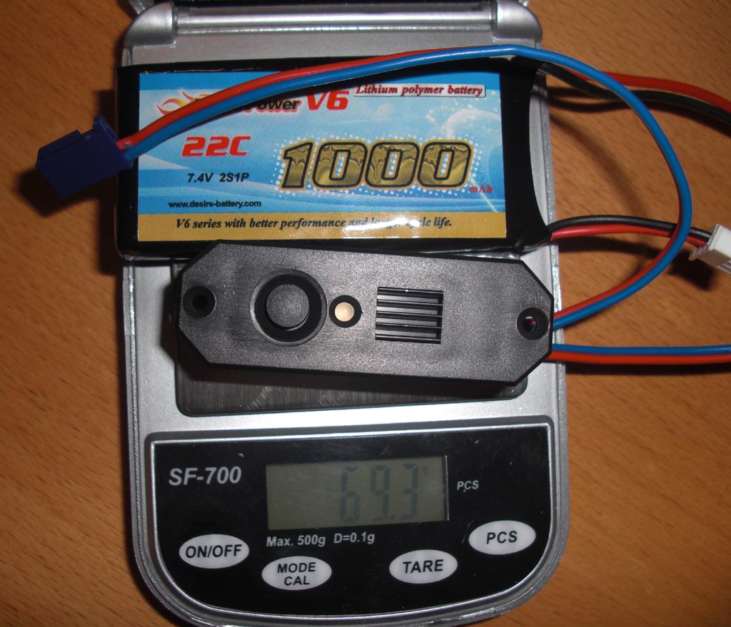

I have one 2 cell LiPo 1000 mAh here that weight only 53 gram - even a 2 cell 1800 mAh LiPo battery pack weight about only 100 gram.

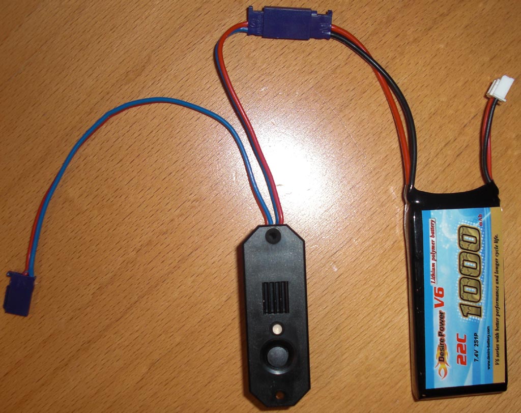

What voltage regulator You may prefer I do not know but I use PowerBox Systems "Digi-Switch.
http://www.powerbox-systems.com/e/po...itch/start.php
It is a combined Voltage regulator, Electronic switch and multicolor LED voltage monitor.
Weight: 15 gram
For two LiPo (or LiFe)
Two pictures below of my 1000 mAh LiPo and my Digi-Switch (combined weight just 69 gram).
