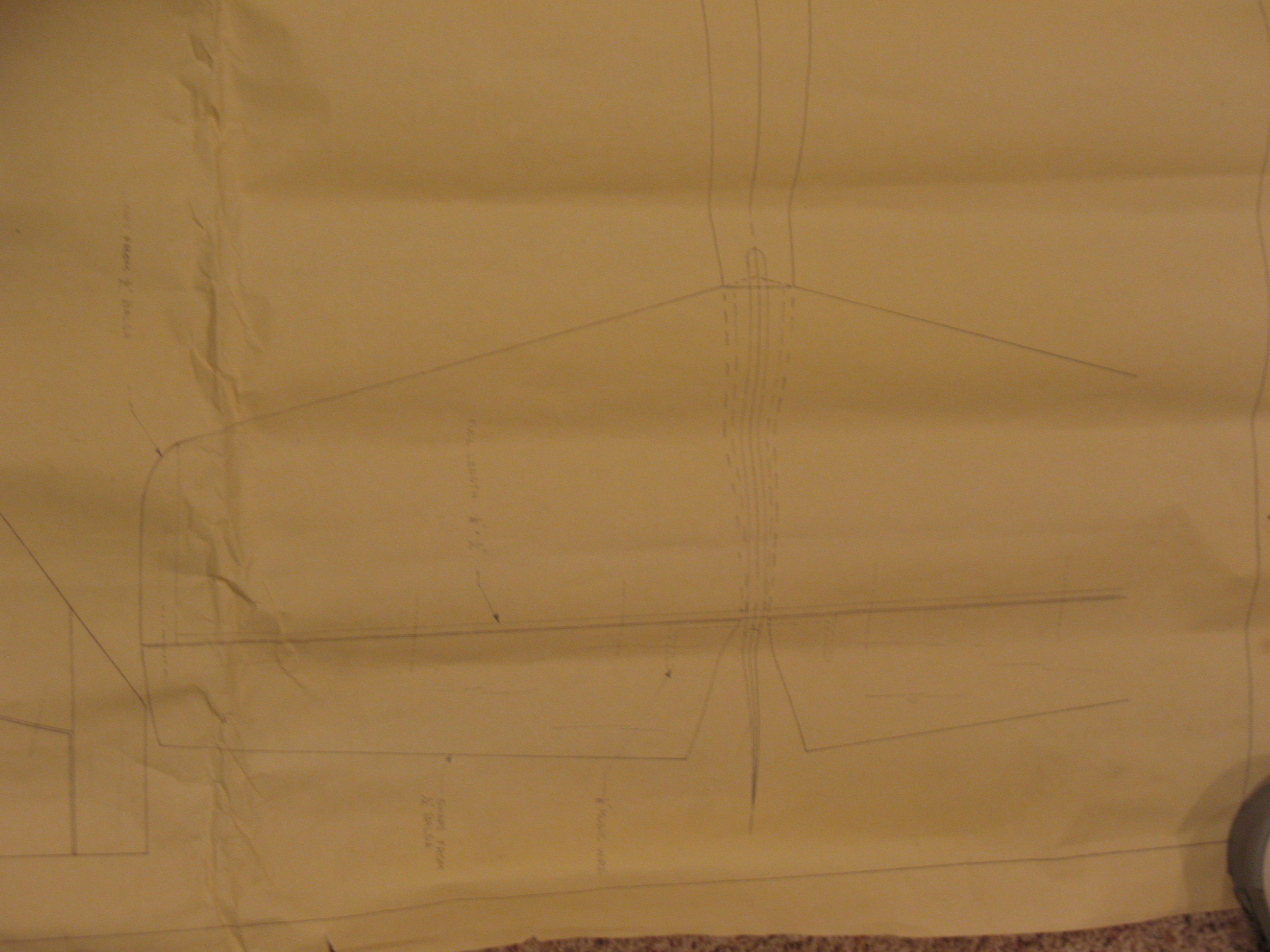

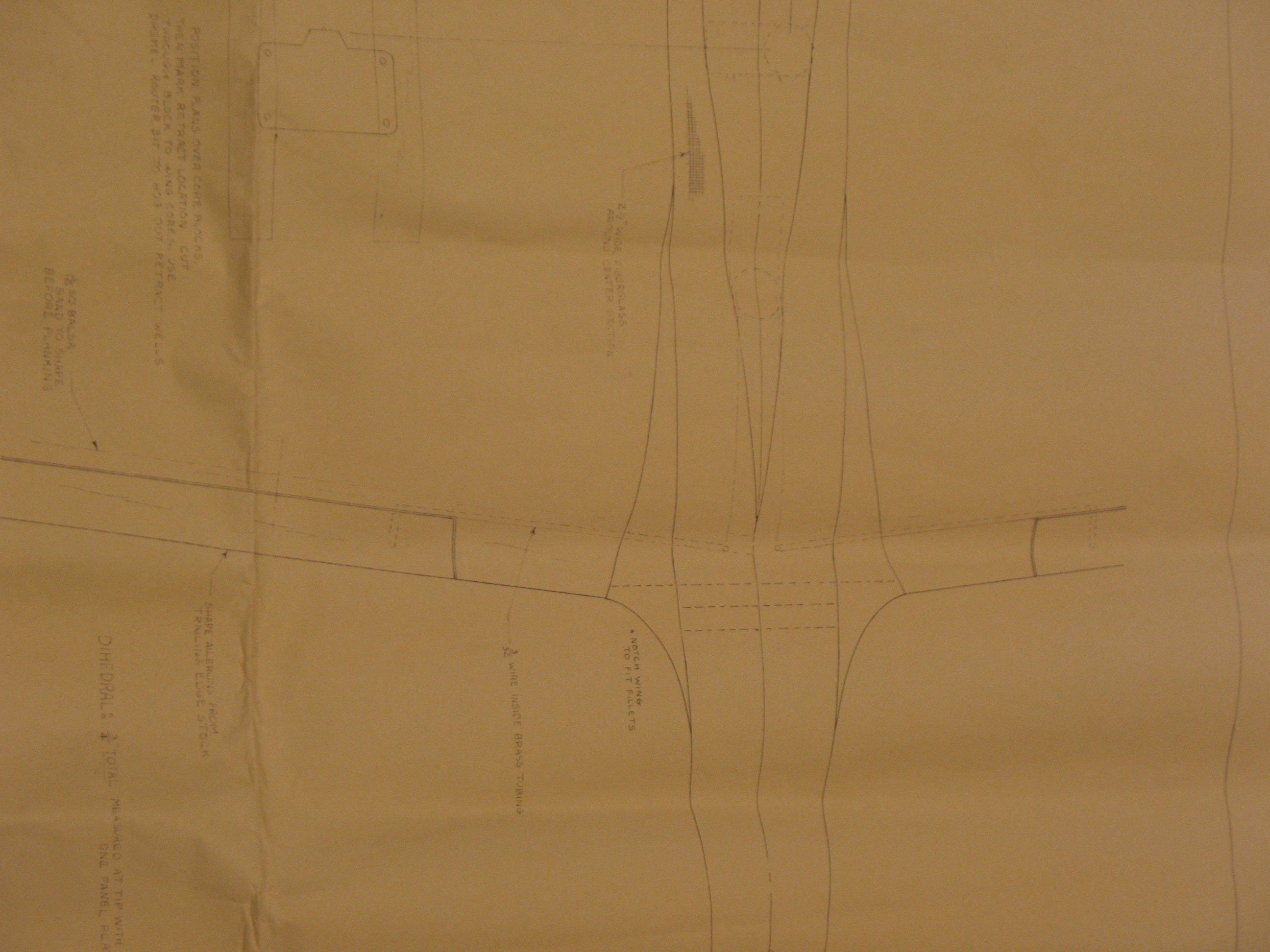

Ok, I uploaded some more pictures of the plans. Hope this helps.
Question on sheeting the wings and stab. The leading edge is very sharp. Do you sheet this with one piece of balsa? If so, how do you make the bend w/o breaking the sheet of balsa?

Wow, that is sharp! If it were me, I would sheet the wing first, then carefully sand back the leading edge of the core 1/4" and glue on a piece of 1/4" or 3/8"balsa square stock and plane it and sand to the original core/airfoil shape. This will allow you to sand the sheeting down to a bare minimum if needed and still keep good strength in the leading edge. Good luck with the build! I have a brandy spankin' new original Mach I in the box that I'm planning on building next winter. Definitely one of the sexiest pattern ships of all time!

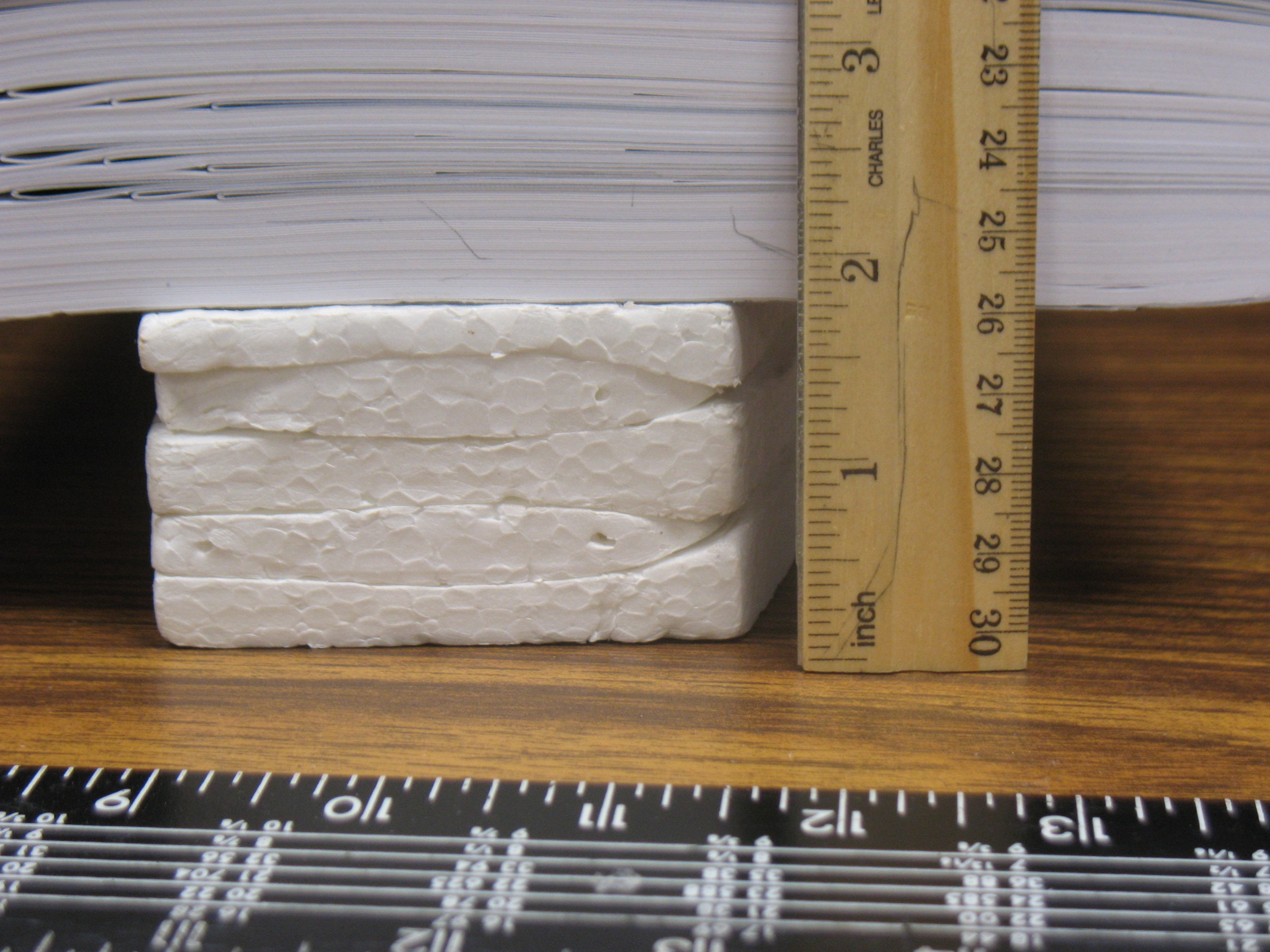

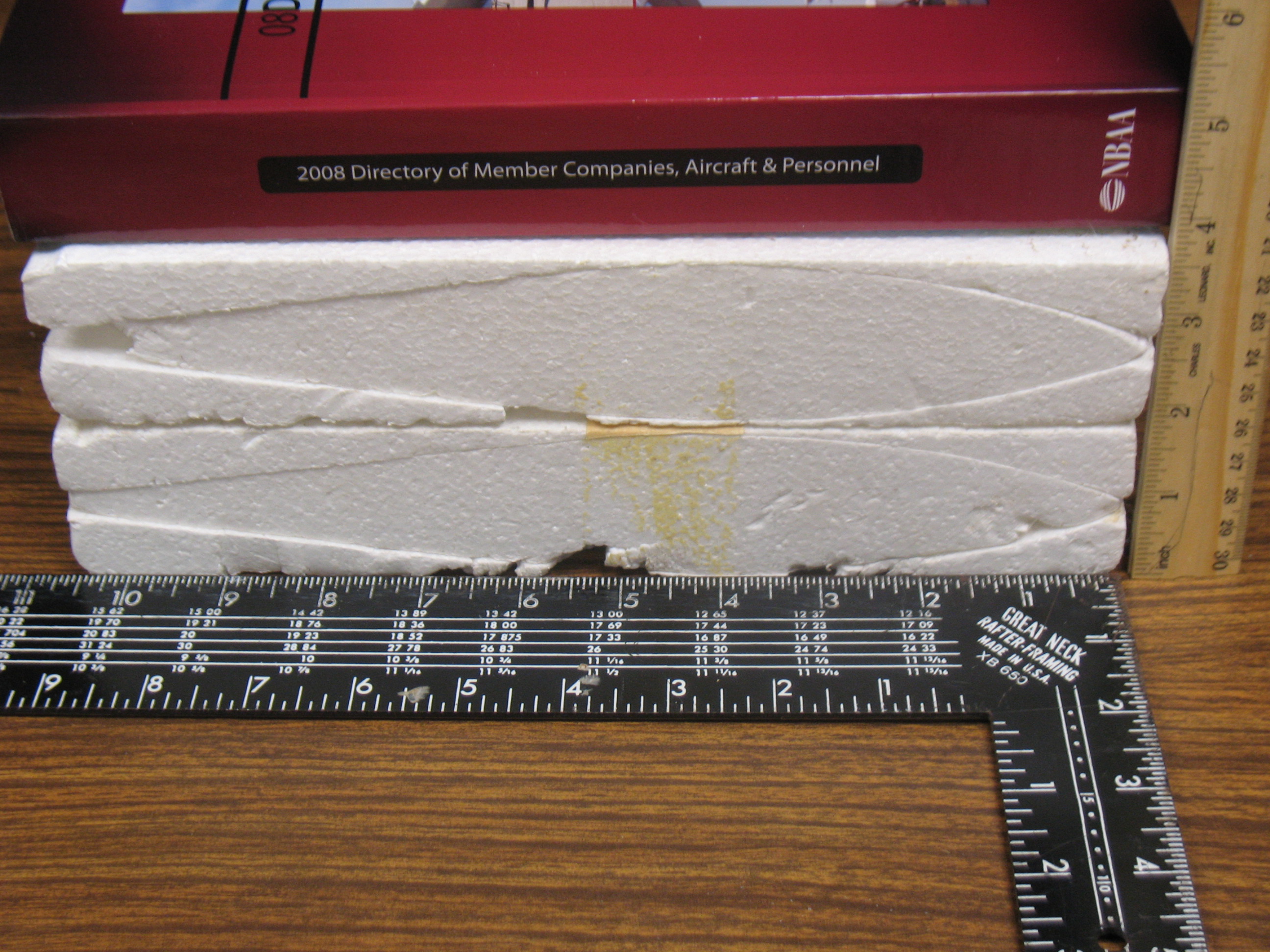

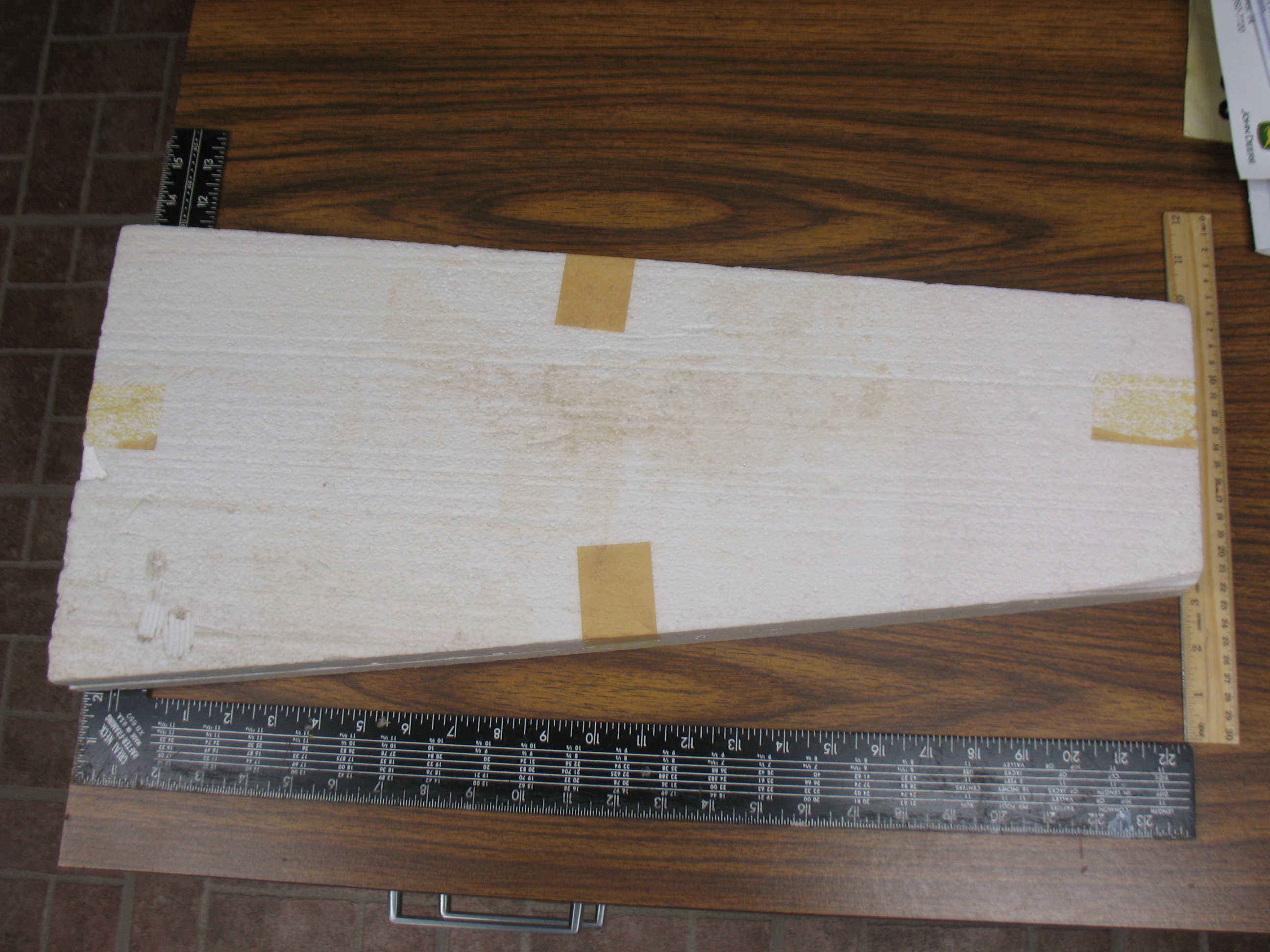

what catracer said. But are the cores cut with a flat front or a sharp LE? Either way, it works out best to have a balsa LE from a construction standpoint. So sheet, then cut back and sand. It is also easier to fix a ding in a piece of balsa than in a sheeted foam LE section. Use the lightest 1/16" contest balsa and laminating epoxy for sheeting or some good 1/32". I'd go 1/32" - everything about this design tells me it ought to be 3.5 lbs but back in the day everything was built much heavier...
If you make a sketch of the wing and stab core planform with dimensions and trace the root and tip airfoils, I can draw up a set of CAD plans them. Something like the drawing below which is in progress (this one is framed up of course).

Some glass/foam kits had cores with produced rounded LE's. The Phoenix kits were among them - see Crankpin's build threads. The cores would be sheeted with contact cement by wrapping the sheeting around the rounded LE. This is easier to do with very thin HW veneer than balsa but if the balsa is pre-molded by several wetting, wrapping, wetting cycles, then it can be done with balsa too.
In the end, with a sharp LE like that, it will be easier to use a piece of 3/8" balsa to produce the LE. Sheet the top and bottom of the cores with two separate "planforms" of sheeting. If you want to be detailed about it, you can keep the grain parallel to the LE back to about 2-3" from the TE at which point you switch the grain to parallel to the TE. Otherwise, if you want to keep it simple, I'd recommend keeping the grain parallel to the LE all the way. I'd also recommend marking centerlines on your cores everywhere: root, tip, LE and TE. And, of course, if you use retracts (5 oz electrics are just the ticket for this weight class), do that work on the cores before sheeting. It can be done afterward but its a little cleaner if you do it beforehand.

Guys, I almost snagged a Mach 1 on RCG but was second in line. Missed it by that much (Maxwell Smart)! Oh well, there are more out there.
Doxilia, I'll have to set up a bigger work area to make a sketch but I did take some pictures. Hope this helps. As said before, the cores are not the best shape. This was an attic find where cores, shucks, fuselage and plans were all in different boxes & places. I think it would be best to cut new cores. I looked into a home made bow foam cutter but it looks to be a project in itself and I'm not sure if I'm up to it. My buddy thinks they're repairable with micro balloons, epoxy and reshaping.
Anyways, here are some measurements:
Wing (measured trailing edge sweep instead)
Length 23 3/4", root cord 10 1/2", tip cord 6", sweep (from bottom edge to trailing edge tip) 3".
Stab (root & trailing edge are 90 degrees)
Length 9 1/2", root cord 5 1/4", tip cord 2 7/8".
Both the wing and stab appear to be fully symmetrical with a sharp leading edge and a flat trailing edge. Mach 8 indeed!!!
I like the idea of a balsa leading edge but I want to stay true to the original shape.
Skyhawk, good to know it was a good flyer @ 5 1/2lbs. I may have to use a GP adjustable mount and try different engines. I bet the Magnum 45 would be a good fit too.
