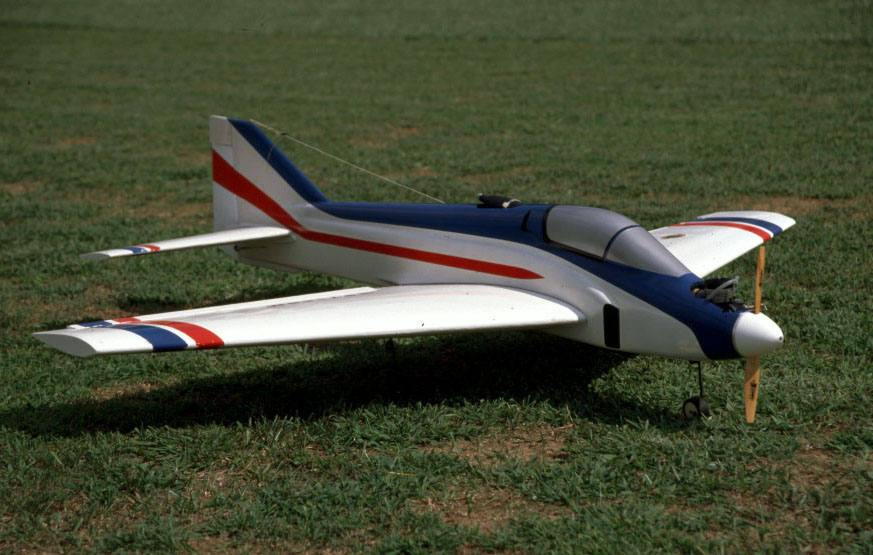

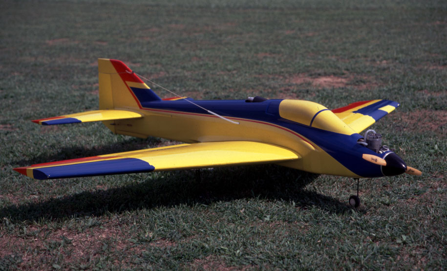

Back in the 80's we had two EU-1As. One with a fix stab (blue/yellow) and one with a flying stab (red/white/blue). Both flew great but the one with the flying stab was the best AMA Pattern airplane I ever flew.
http://www.rcuniverse.com/forum/atta...mentid=1958653 http://www.rcuniverse.com/forum/atta...mentid=1958654
