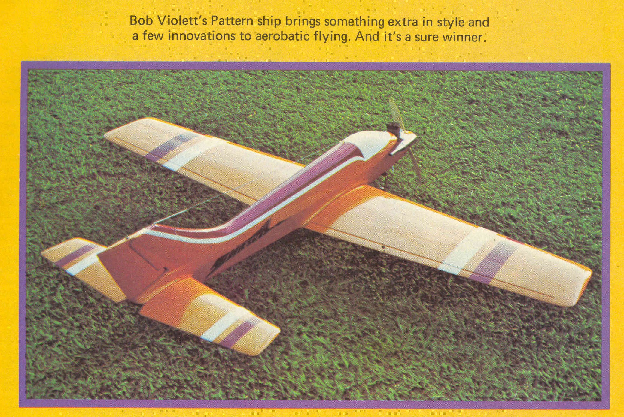

Bob Violett "Shrike":
(search in rcgroups Classic Pattern Flying forum to see the plane)
Carl Weber "Sequel":
http://www.rcuniverse.com/forum/m_30...tm.htm#3081399
/Bo

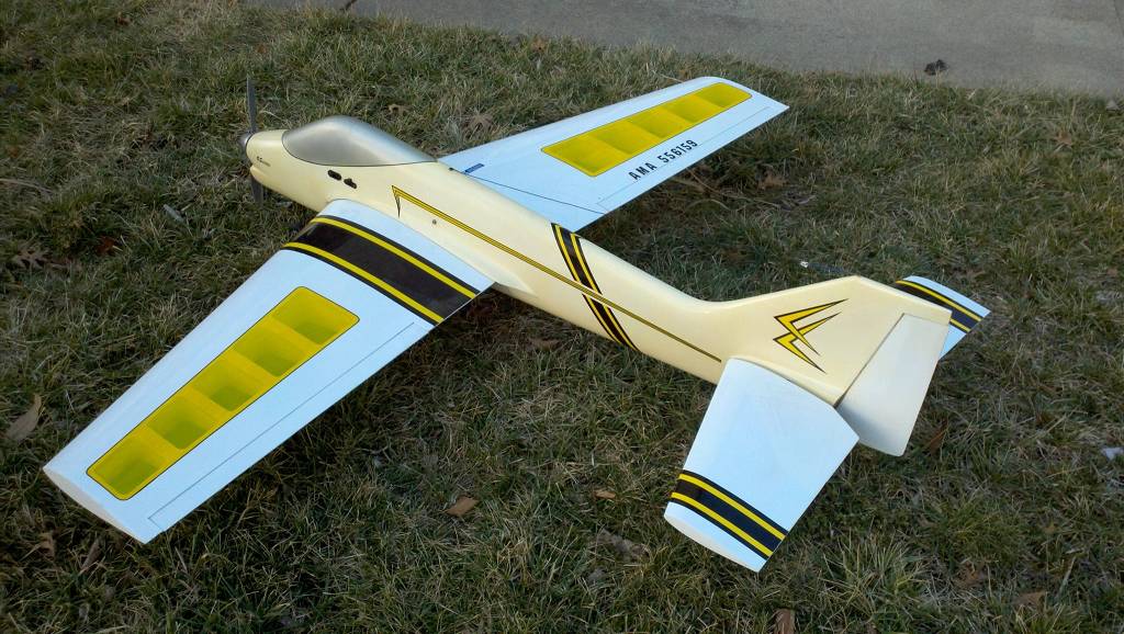

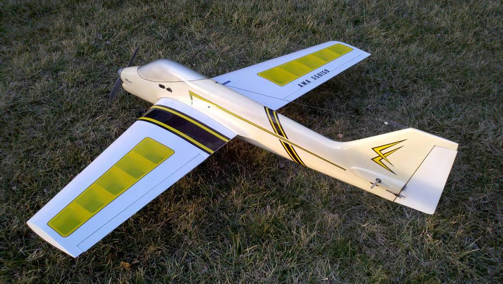

This is a S&W Brushfire Plus I picked up at a swap meet. It has the Giezendanner unit. Hoping to have out flying in April once I go through it.

Default Bob Violett Shrike
Bob Violett's "Shrike" from American Aircaft Modeler.
Jim

hi nice brushfire, I stated making them again. Stan S&W

Hi All. I Manufactured the Brushfire Plus kit back in the 80s sold hundreds of them. Now that I started flying Classic Pattern again the idea to start making The kit again came about, as soon as I finish a new F3A design by Dean Pappas I will make a few Brushfires maybe buy December. I will keep
you posted.
Stan S&W.
