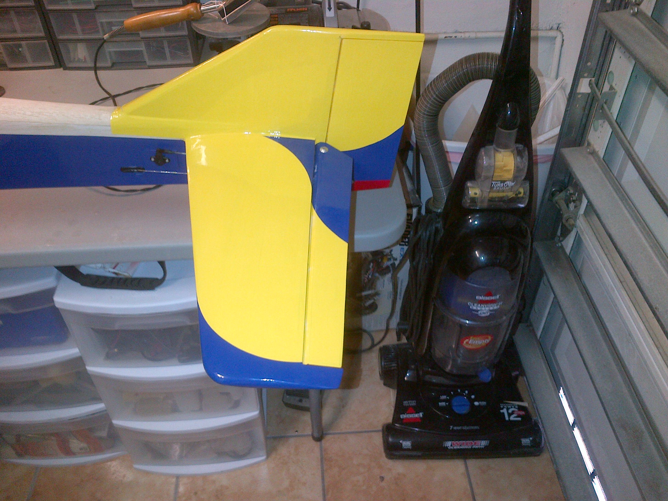

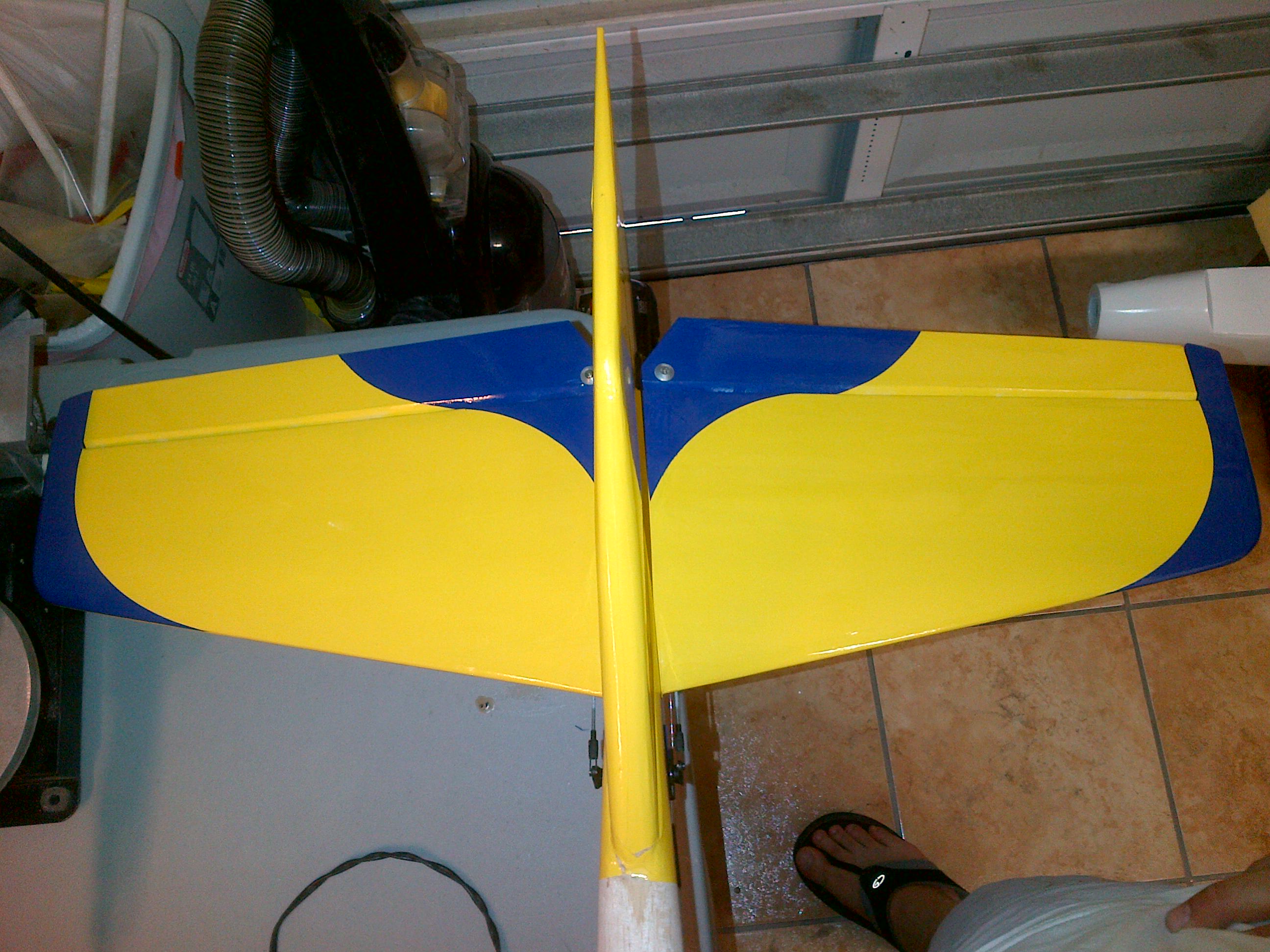

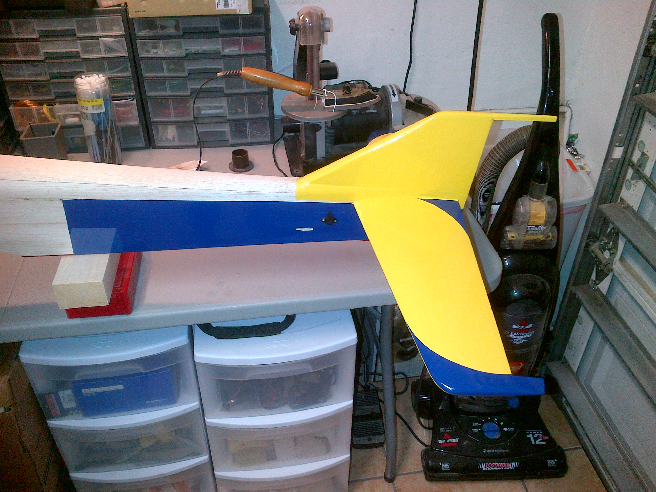

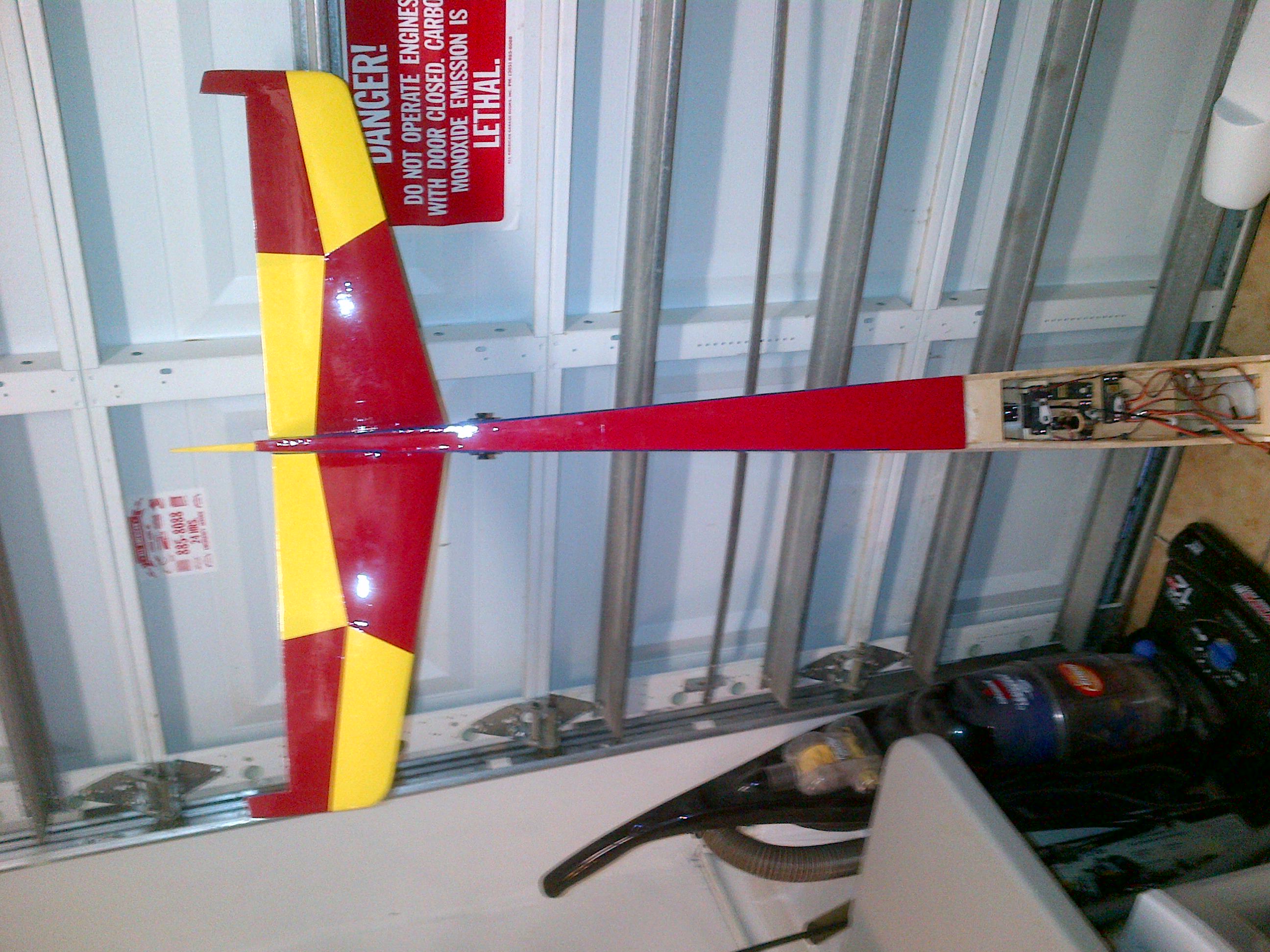

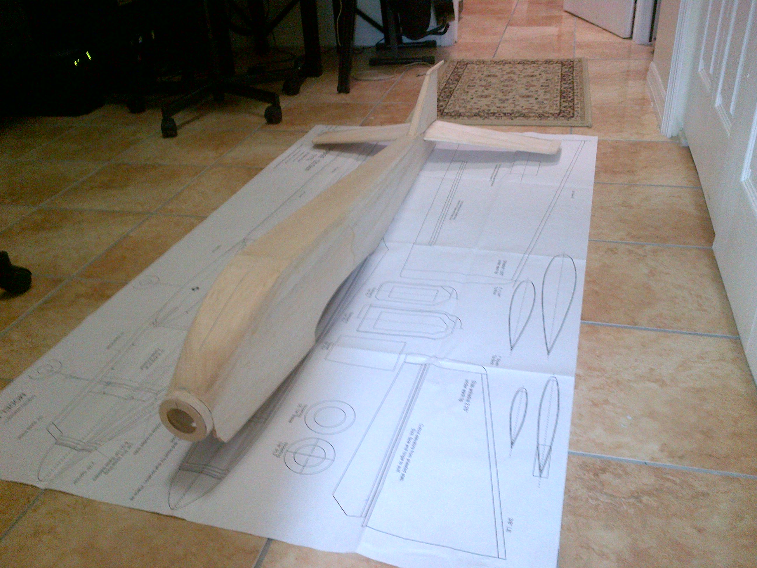

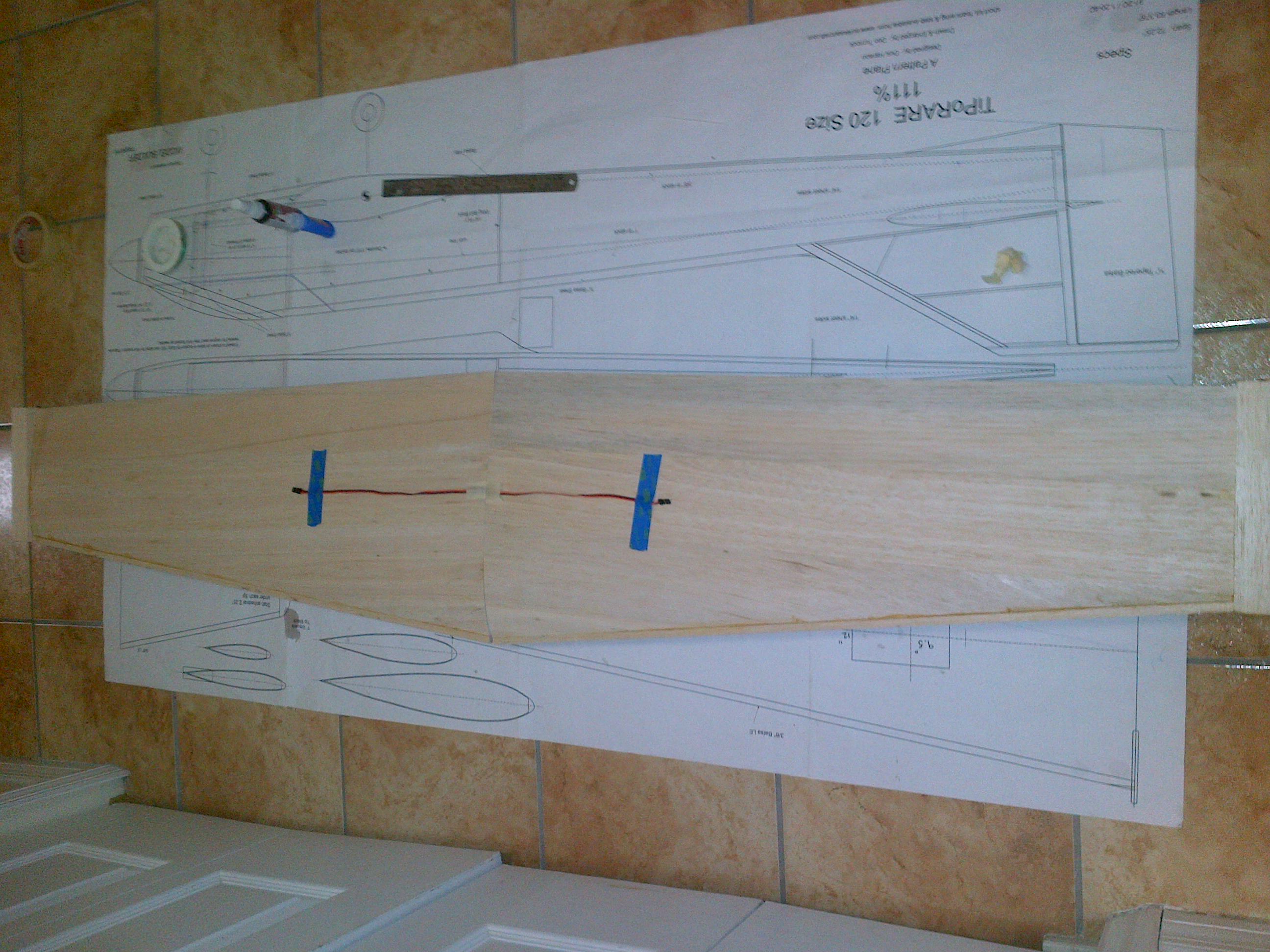

Hi:

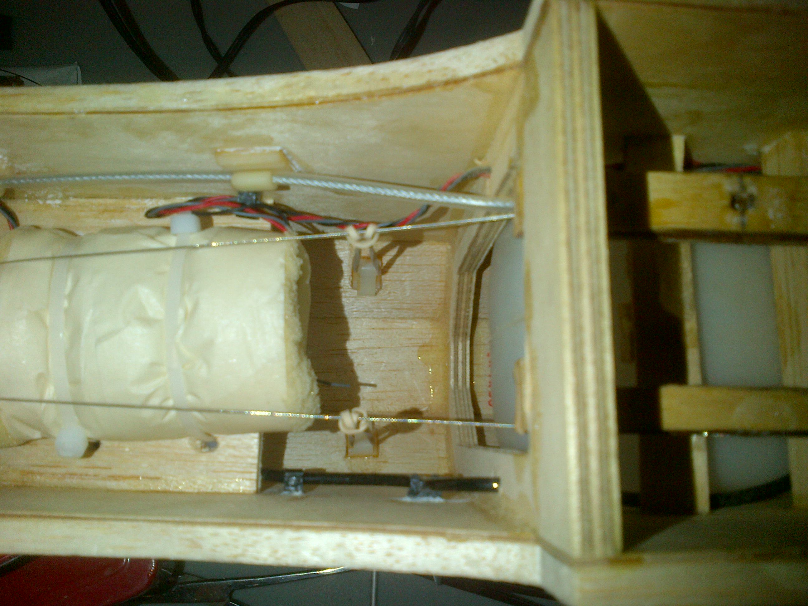

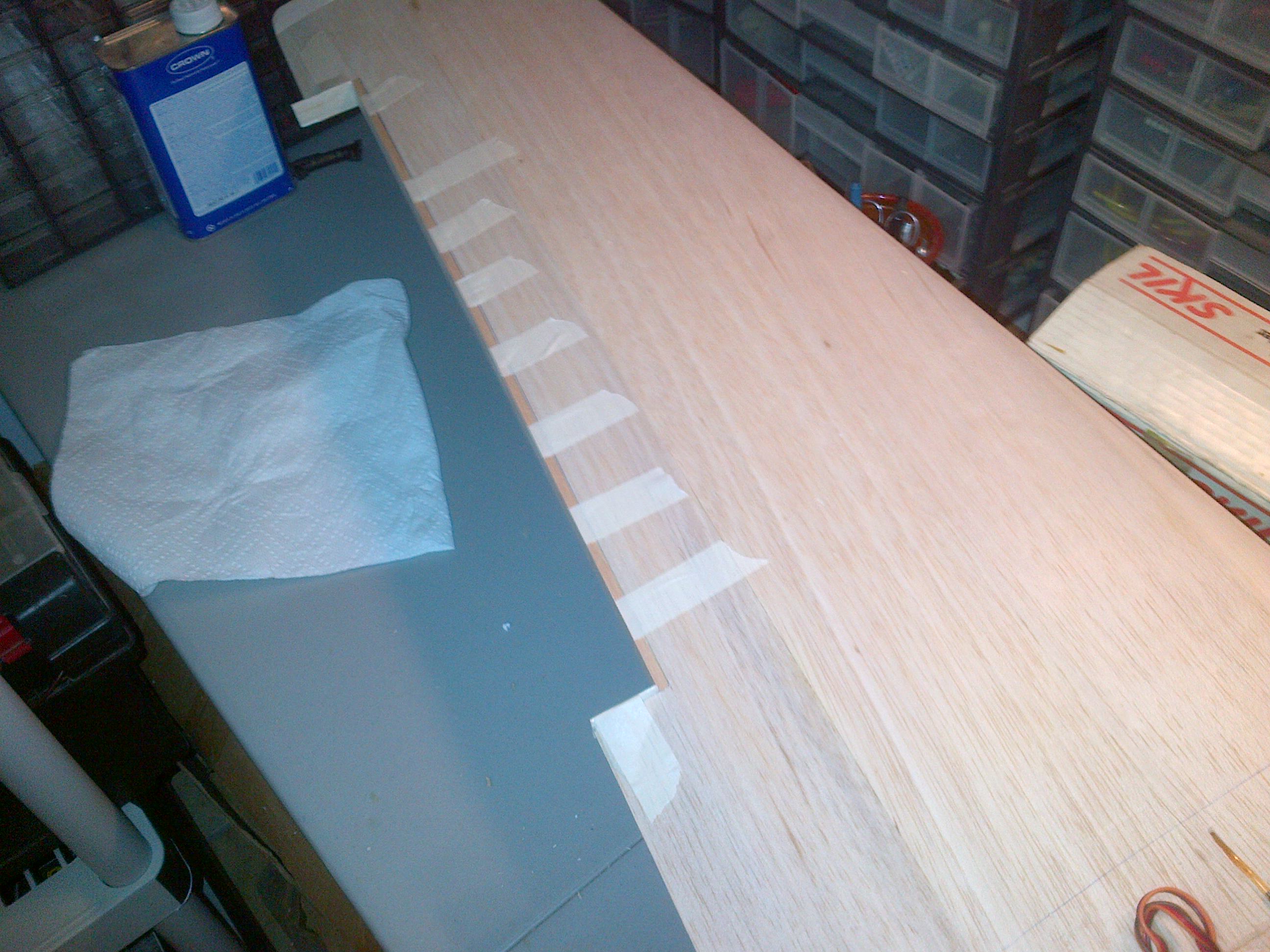

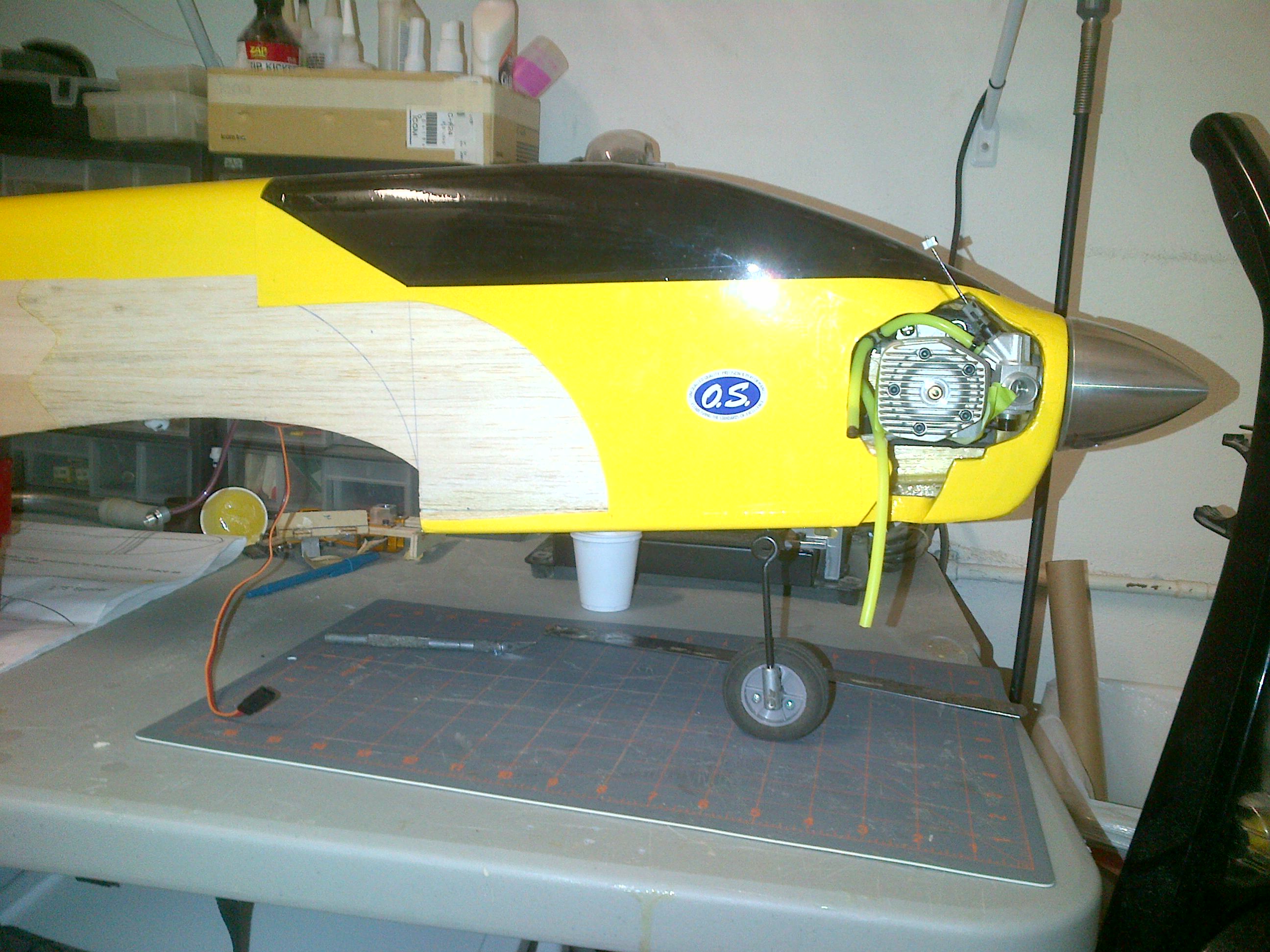

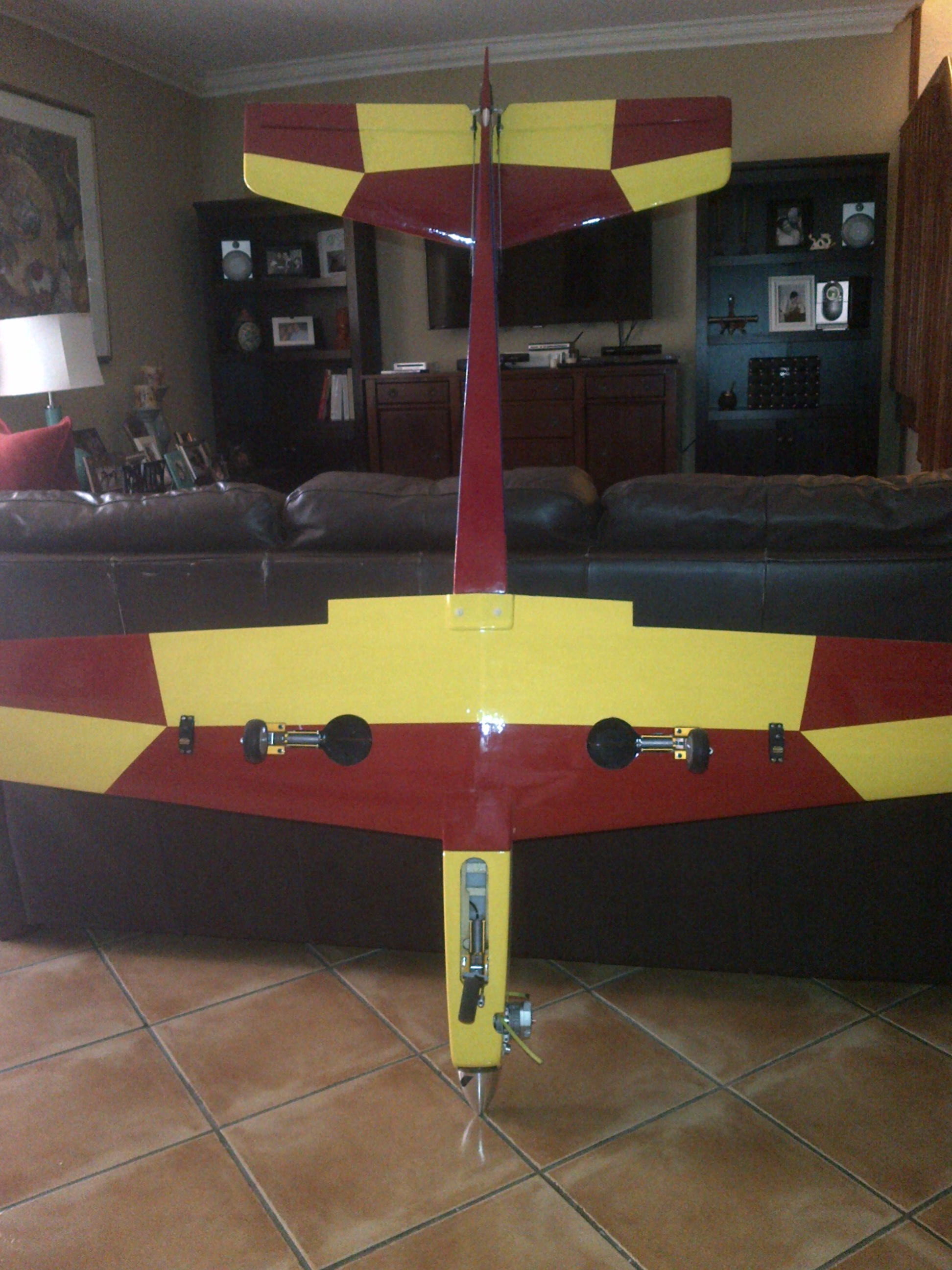

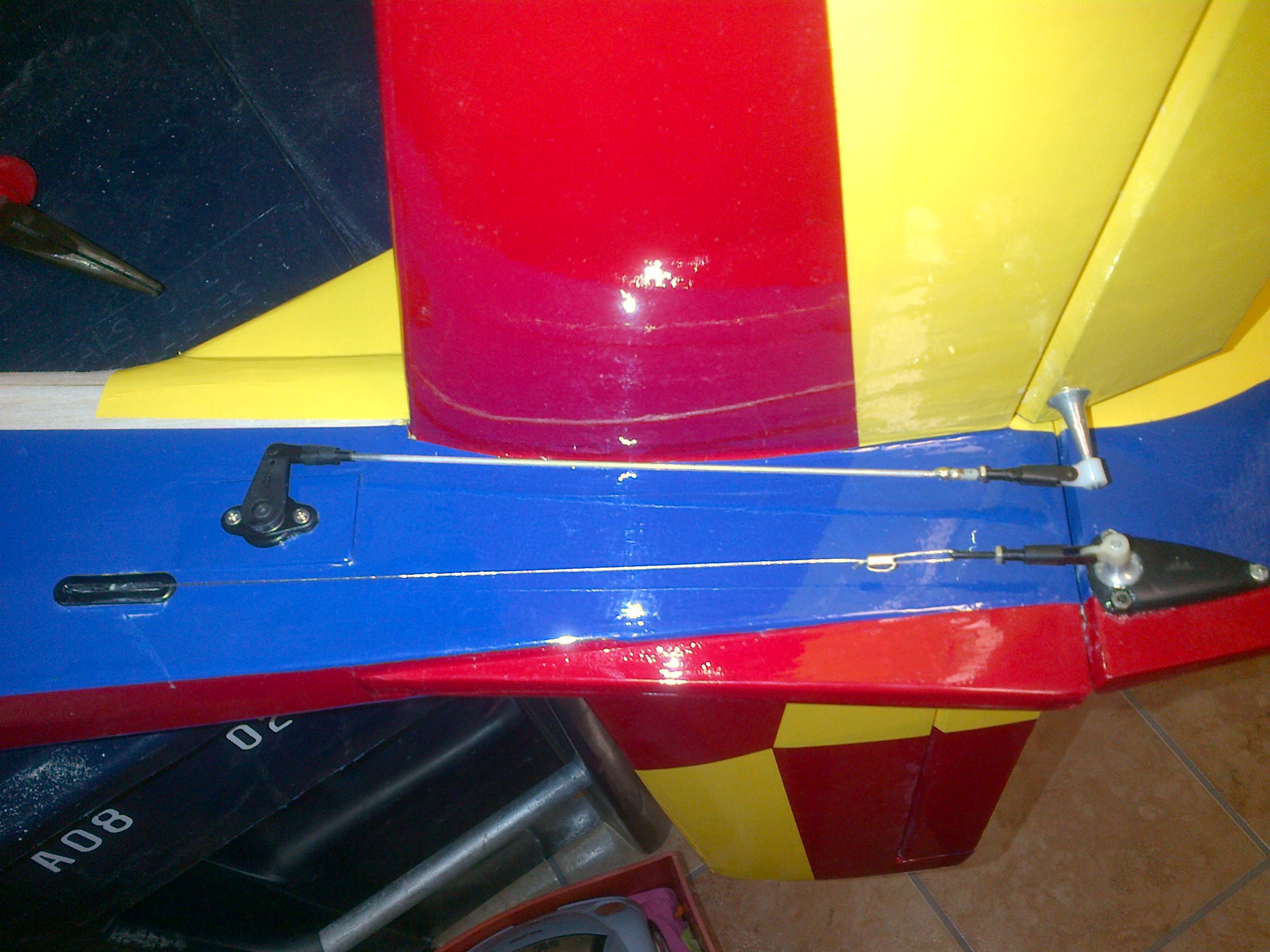

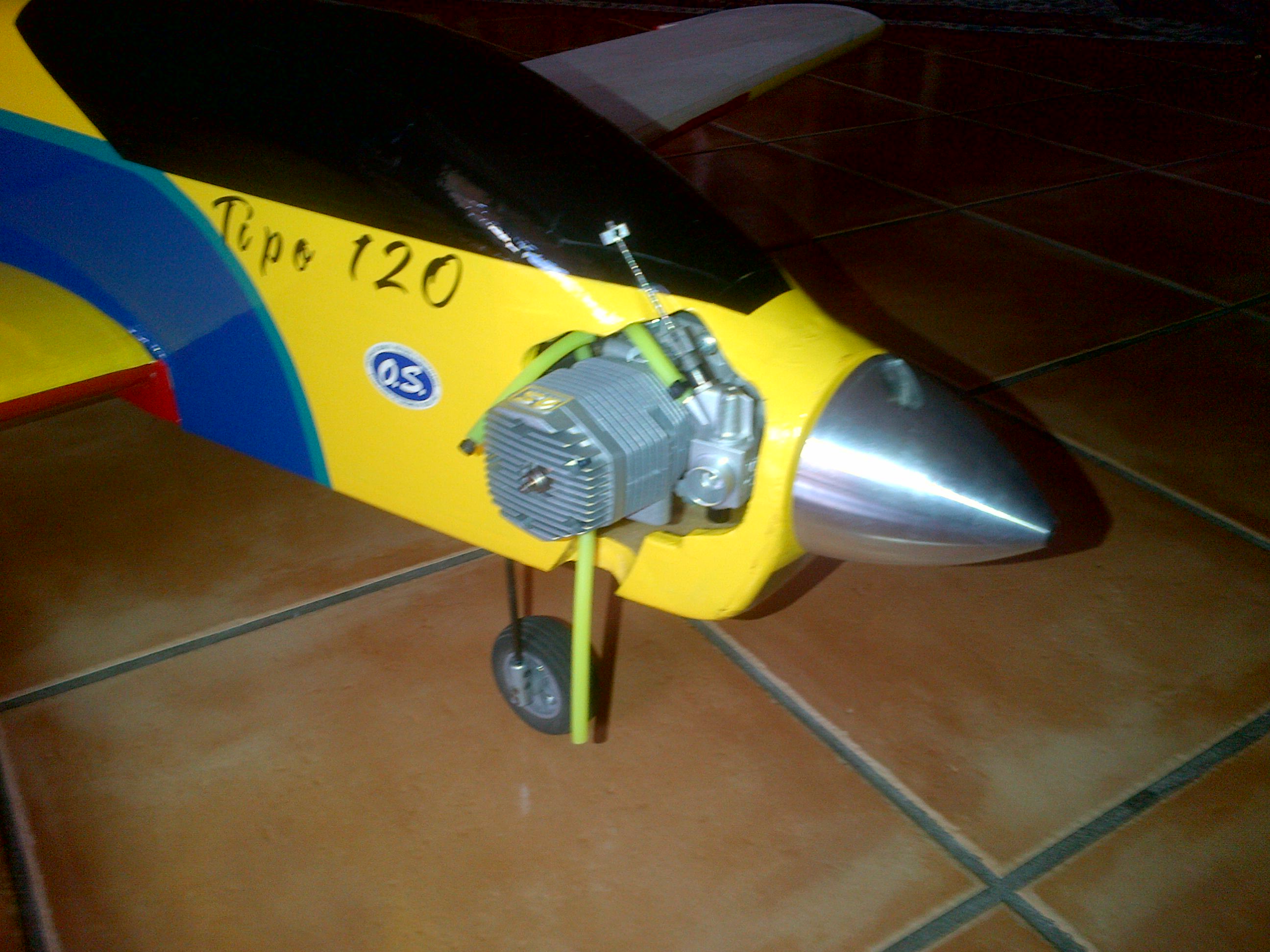

I would like to share with you my latest build. A Tiporare 120. Why 120?, Because its the 111% enlarged version I got from Don Turnock from Eureka Aircraft. At the time (about 2 years or more) Don only had a partial kit offering the foam wing and stab, plans and semi kit but was kind enough to calculate the remaining needed wood I would needed to finish the plane. It is now included in his list as a standard option.
Although I do not have the complete build I want to share some pic through out the build. The pictures are not in order but I will give you a brief description:
Tiporare 120
Span 72.25
Length 63.375
Power OS95 AX with Macs Pipe
Servos JR8411 on Elevator (elevator has a bearing bellcrank from RC City for double elevators) and Ailerons, Rudder JR8611 with pull pull system, Throttle JR4131 and gear JR 3421
Radio is a JR 12X DSM
Gear is Robart springdown
Construction is very straightforward, not for the beginner, lots of sanding,not much info on the plan but basics and no building manual (lots of guessing). Incidence and correct angle measuring on anhedral stab gave me a hard time. I just broke the engine a week ago and finished balancing last night (a bit nose heavy). Plan to test fly my Tipo this weekend.
If you have any questions I will do my best to answer them for you. Thanks.
Christian

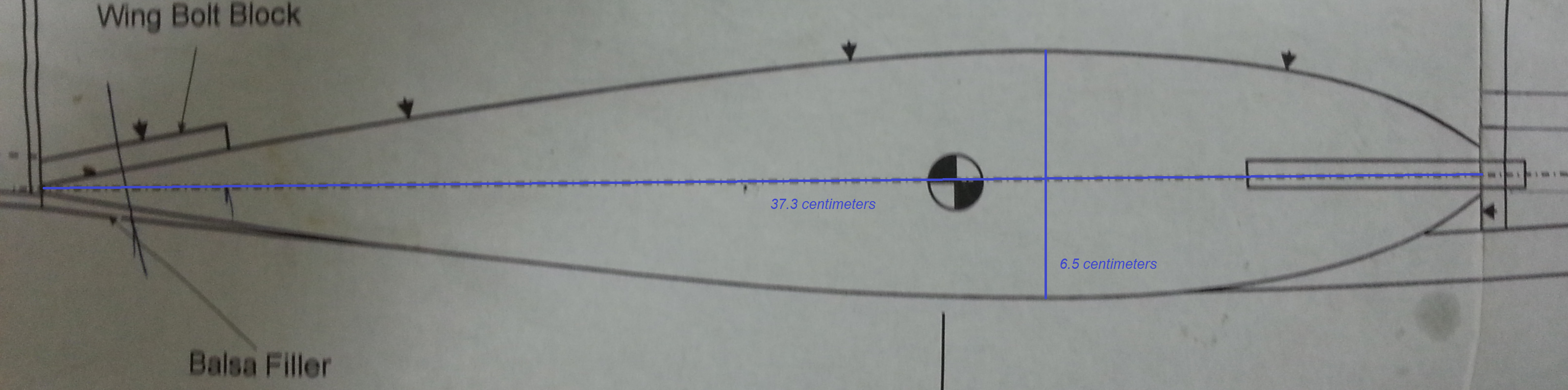

HI847 08-15-2013 08:50 AM
1 Attachment(s)
http://www.rcuniverse.com/forum/atta...mentid=1908237 Here are the chord dimensions and the thickness of the wing. Thank you for your comments. I followed the smaller scaled Tipo's but I wanted something bigger. 10 lbs? I wish. Unfortunately no. I'm pushing around 12.5 lbs. Fuse side wood was thick plus plywood doublers. Cabin area is made out of carved balsa, very solid I must say. I will post my comments on the flying after this weekend.
Christian
doxilia 08-15-2013 10:25 AM
Christian,
thanks for the info. The CAD re-design looked a little hefty. I think this bird can be built to 10-11 lbs using 3/16" sides, a 1/32" lightened doubler and a 3/32" skinned deck rather than using the block balsa. The nose top can be done in a "keeled and glassed foam".
Still, at 12.5 lbs, it should be ok in terms of loading (I think it is around 1000 squares). I suspect a 120 AX might be needed for thrills but the 95 should fly it nicely and in TOC style.
David

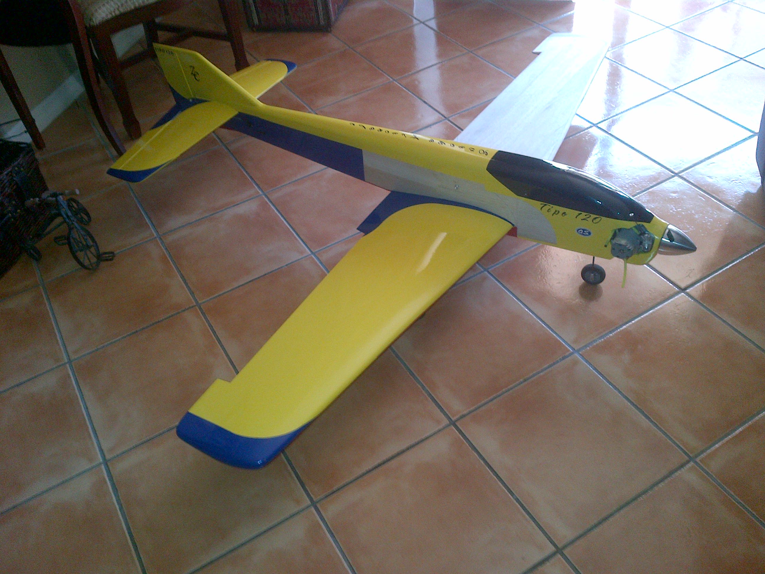

Hi,
I would like to report on the first flight of my Tipo 120. After tweaking a bit the low needle I got my 95 where I wanted (sorry no rpm meter at the moment but I will get it to measure the rpm output of my 95 with pipe). Taxing was fine, a bit of right drift that I have to correct on the steering servo mix, plane accelerated without effort and took into to the air with just a bit of elevator (I had taken of the weight I initially put on the tail as I found out my balancing was out of place), balance was perfect, I left aileron about 4 clicks and down elevator about 3 clicks to get the plane flying straight.
Rolls where very axial (I have aileron differential dialed in) and loops where well on line although I have to watch a bit un the upline as there is a slight drift to the left. Coming out of the loop was very straight. Plane was flown mostly at half throttle and it felt like driving a card in third gear all the time (steady run but with extra power left). Knife edge where more straight than I expected with very low input to keep it straight.
This plane is not a speeder as wing airfoil is kinda thick. But I liked the average speed. Did not try the retracts out on this occasion. As I prepared for landing I lowered speed and made a large final pattern ( I usually do that ), plane lowered speed accordingly, I had to give some gas to get it closer, wing tips stayed level at all moment with no intention to stall at low speed, as normal elevators can get a bit saggy but a first landing it was fine. Then it happened, as soon as main gear touched ground both wheels turned 90 degrees turning themselves into an emergency brake stopping the plane on a dime, lowering my nose thus breaking my prop tips and putting wholes in both my wheels.
I knew somewhere I was missing some additional fastening. Nevertheless the flight was superb, I packed and went back home to fix the landing gear issue and get ready for my next flight for more fine tuning and some more flying. I must say the plane catches the attention of some pilots as they are not much used to see the old type of pattern planes.

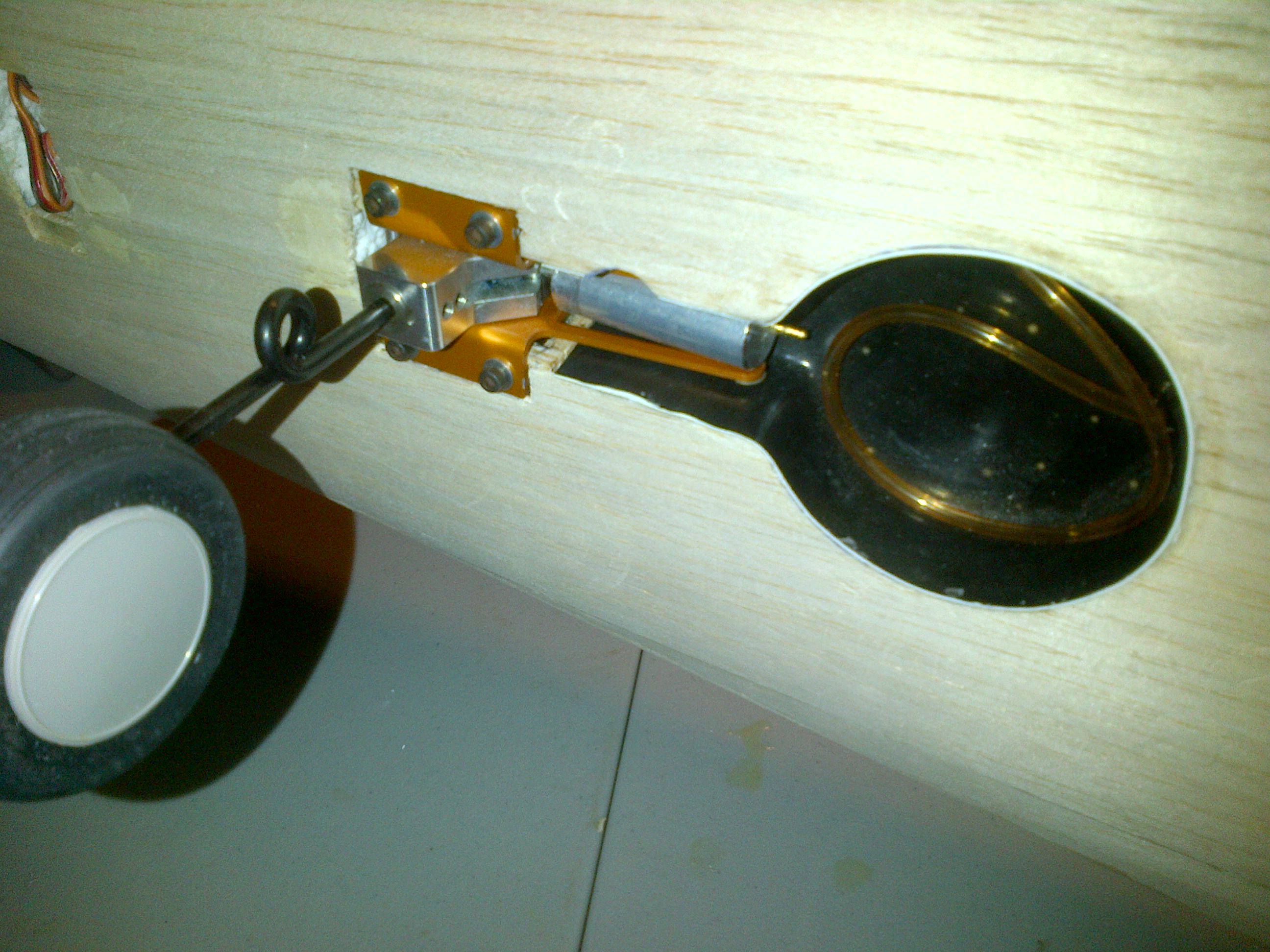

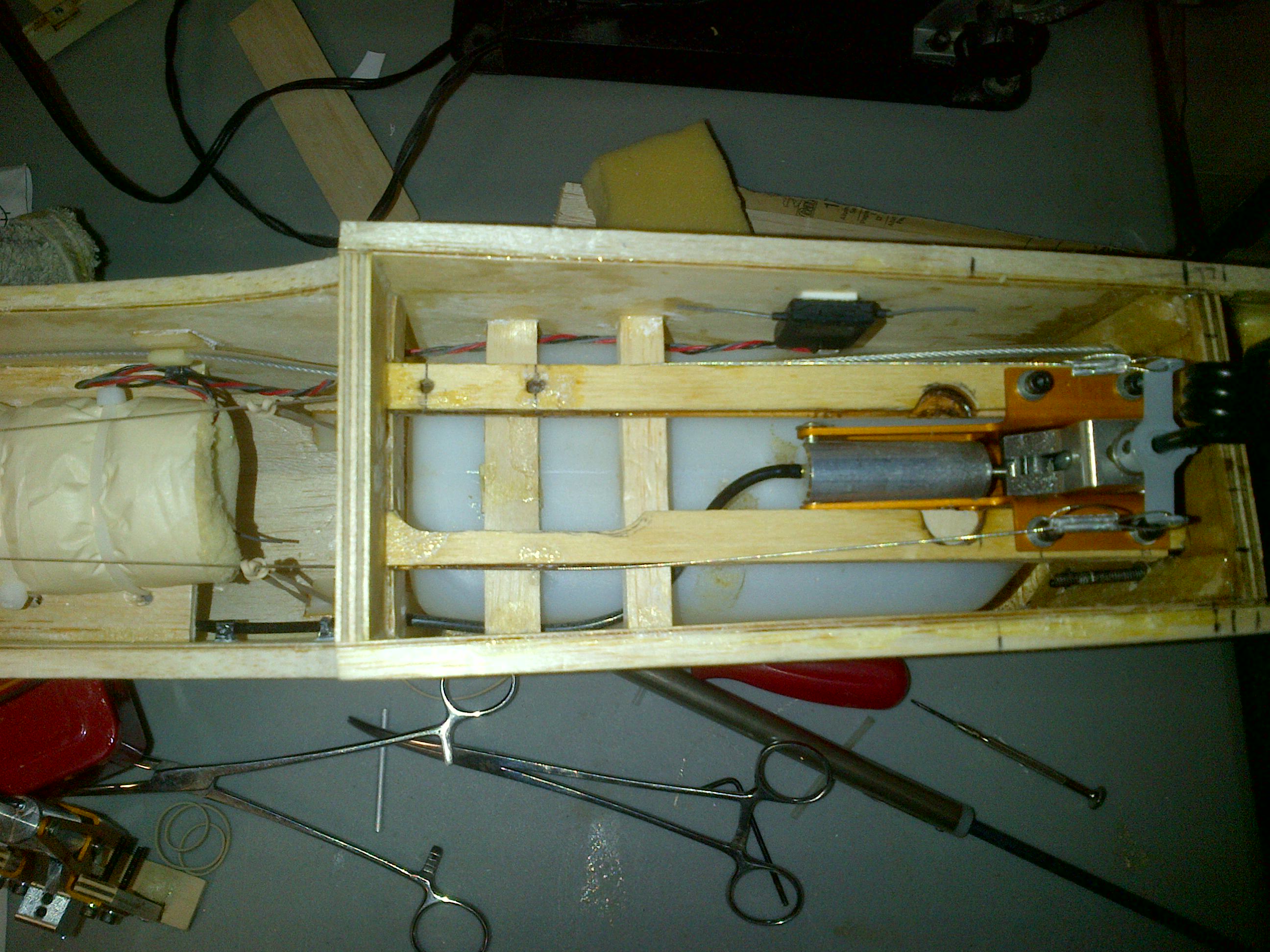

ehsanmorshedi 08-17-2013 11:16 AM
1 Attachment(s)
Hi Christian,
Congrats for the good flying behaviour of your big Tipo and sorry because of the tips and the wheels, I guess some hours working on your Tipo will heal the wounds.
I could'nt see the nose wheel mount well in the images you attached, because of the position of the camera while taking photographs, but it is obvious that you have used 2 hard wood rails as beam to hold the nose retract, I just wanna say my point of view and maybe it's wrong, I feel there are some weak points which could be a crack starter in the wood rails, as i said maye be these weak point are felt to be just because of the restricted angle of camera. If this pretty tipo was mine I would reinforce these rails whith epoxy and cloth or better with carbon fiber straps which just add a little weight to nose and this excess weight can be nutralized by restoring your elevator trim into its former position.the other more difficault choice would be changing the rails with wider and even reinforced rails in addition to some triangles glued at the coners. I wish no hard landing and no bouncing for your bird.
http://www.rcuniverse.com/forum/atta...mentid=1909622
Ehsan
HI847 08-18-2013 05:06 AM
Hi Ehsan,
Thanks for pointing out the details on the rails. Beefing up is not a bad idea. However I like to think sometimes to having the rail system as a "fuse" in case a hard landing shows up, better have the rails to give away that harming the fuse. Regarding the spots you circled, the two next to the base of the retract I had to carve out in order to have the steering arms to fit in. Otherwise the retract would not lock when the wheel is up. The two others holes where errors I must admit and I was to lazy to cut new rails and just turned them around.
Never the less I will take your advise in and do some reinforcement. I appreciate your advise.

HI847 08-25-2013 05:41 AM
Hi Ehsan:
Took some time to check on the rails of the nose gear and definitively some reinforcement was needed. I finished last night reinforcing the rails and now they feel really strong. Thanks for the advise.
Christian
