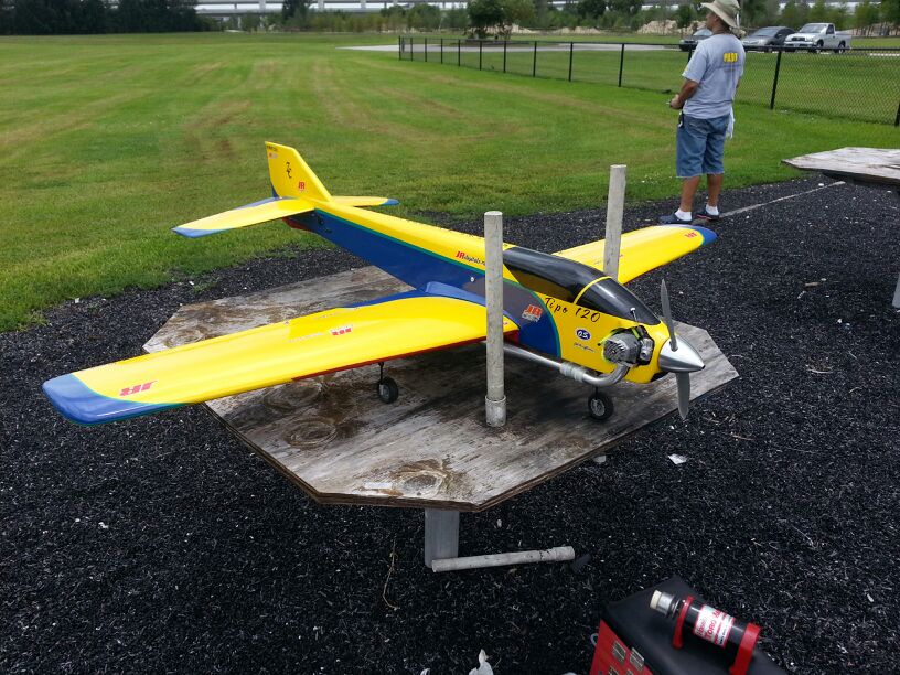

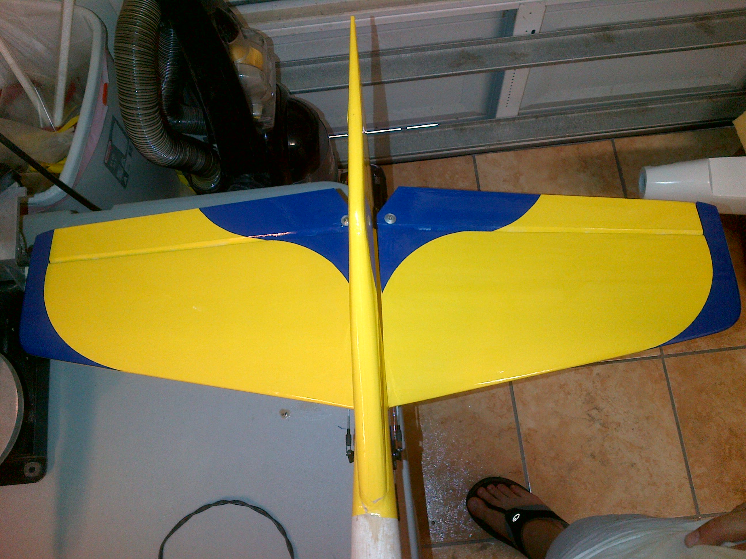

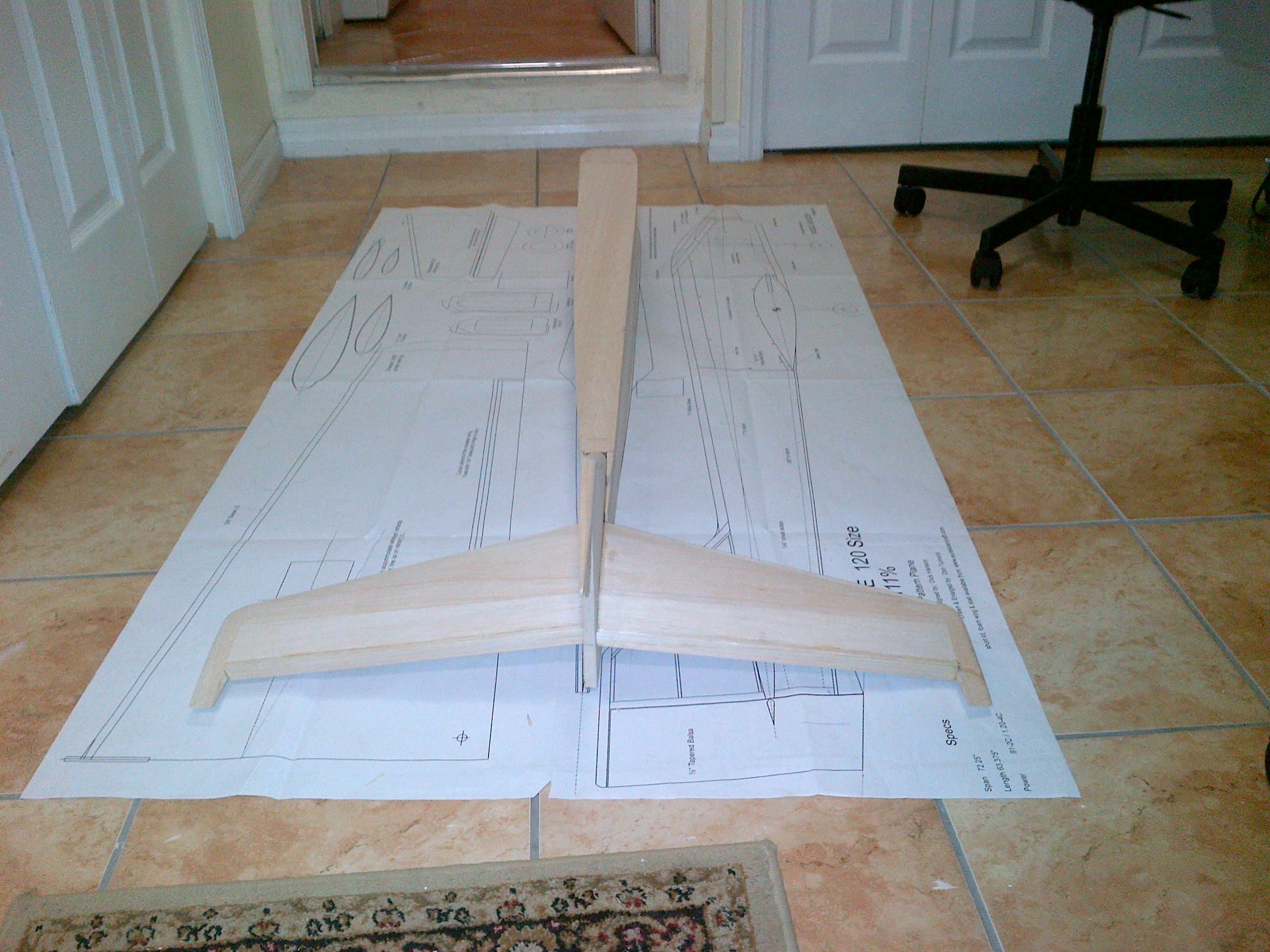

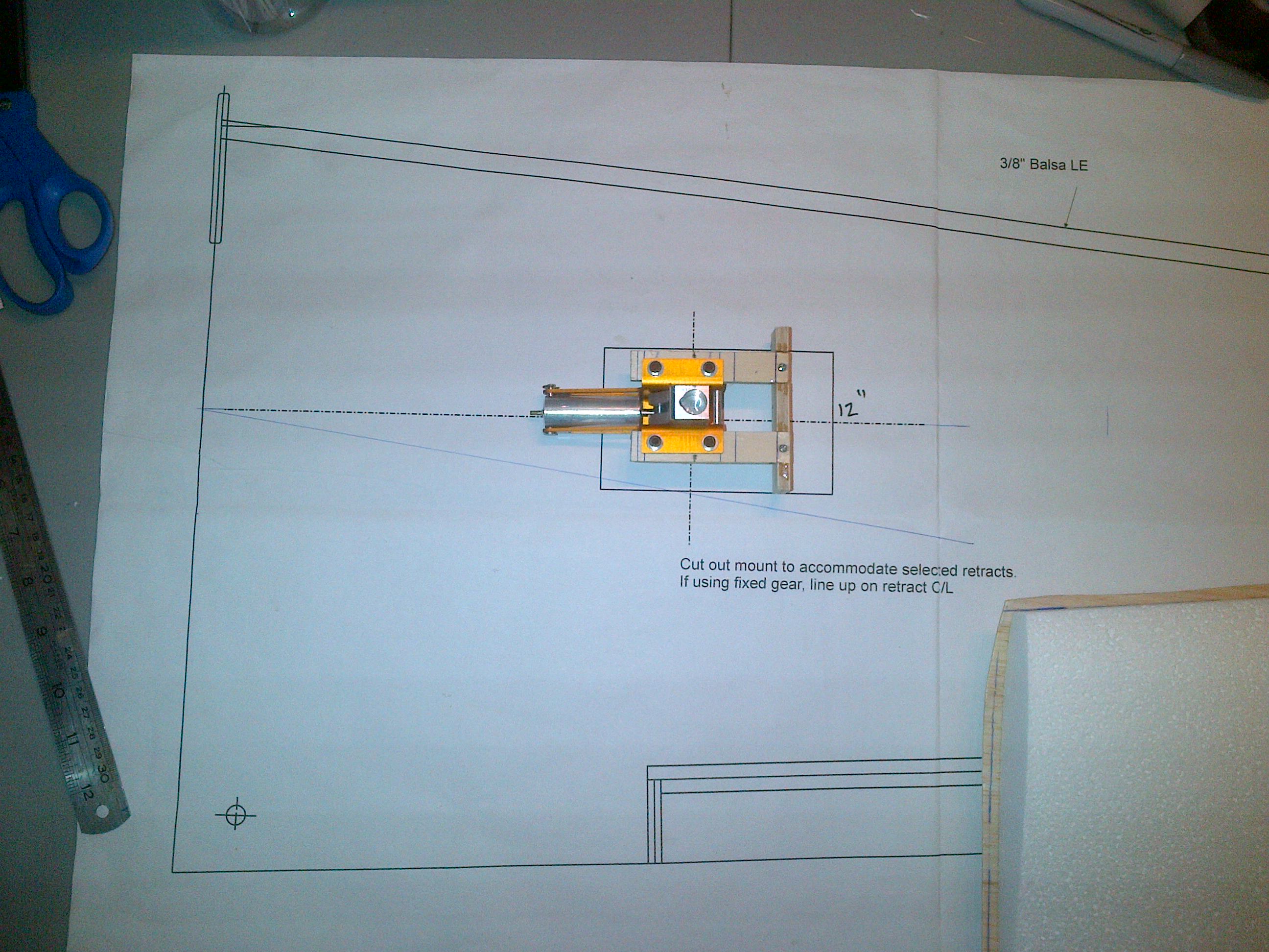

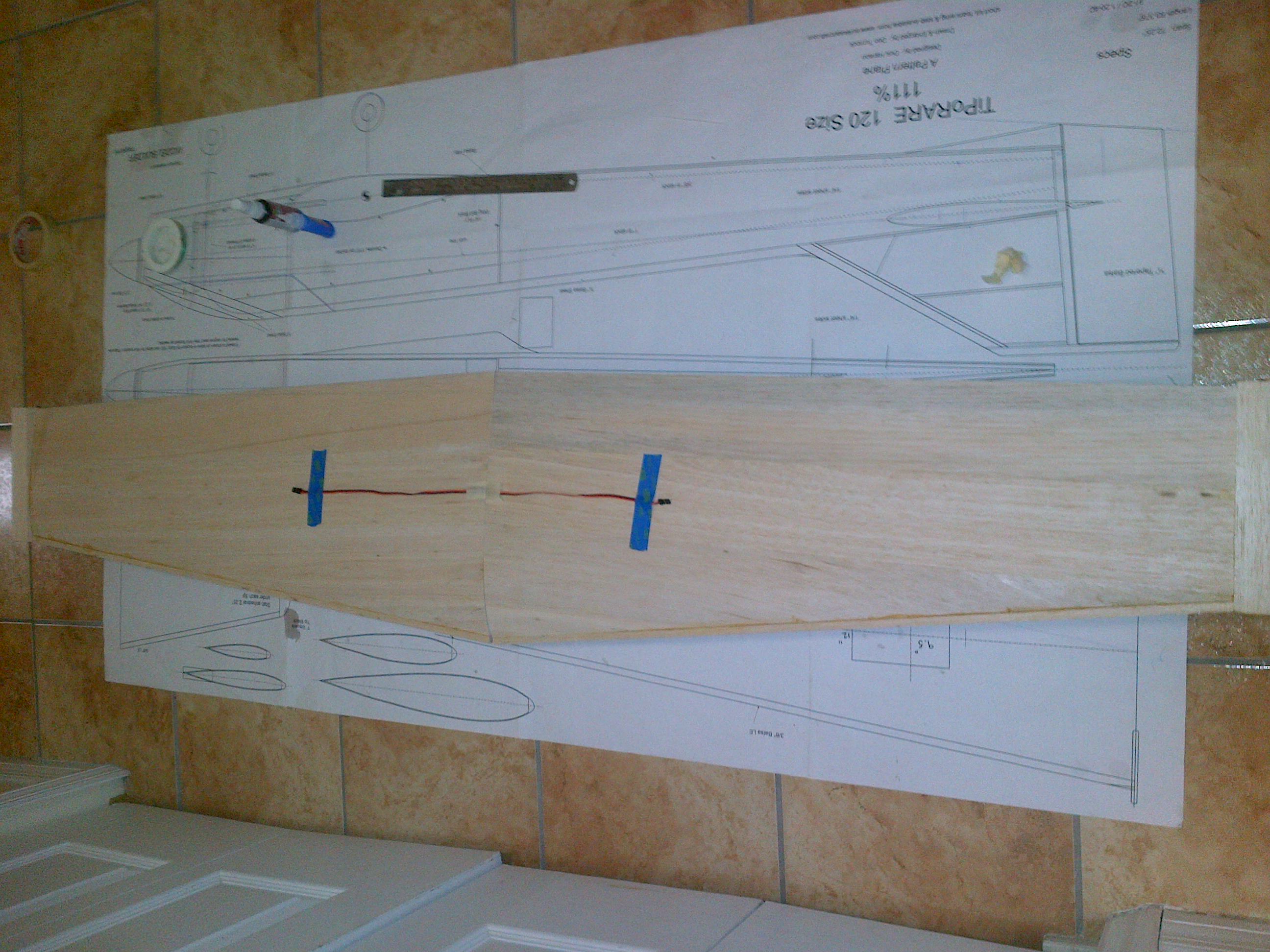

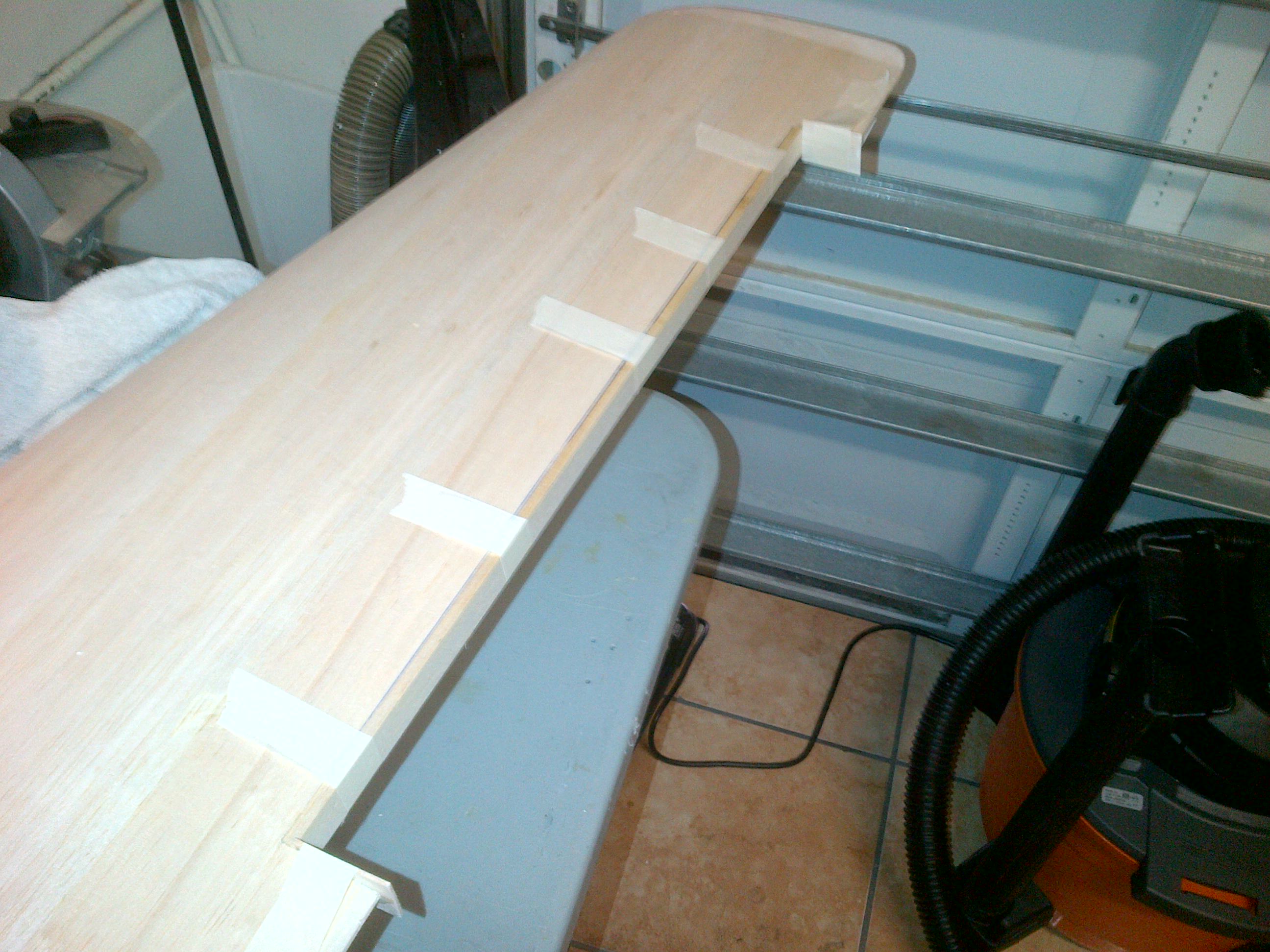

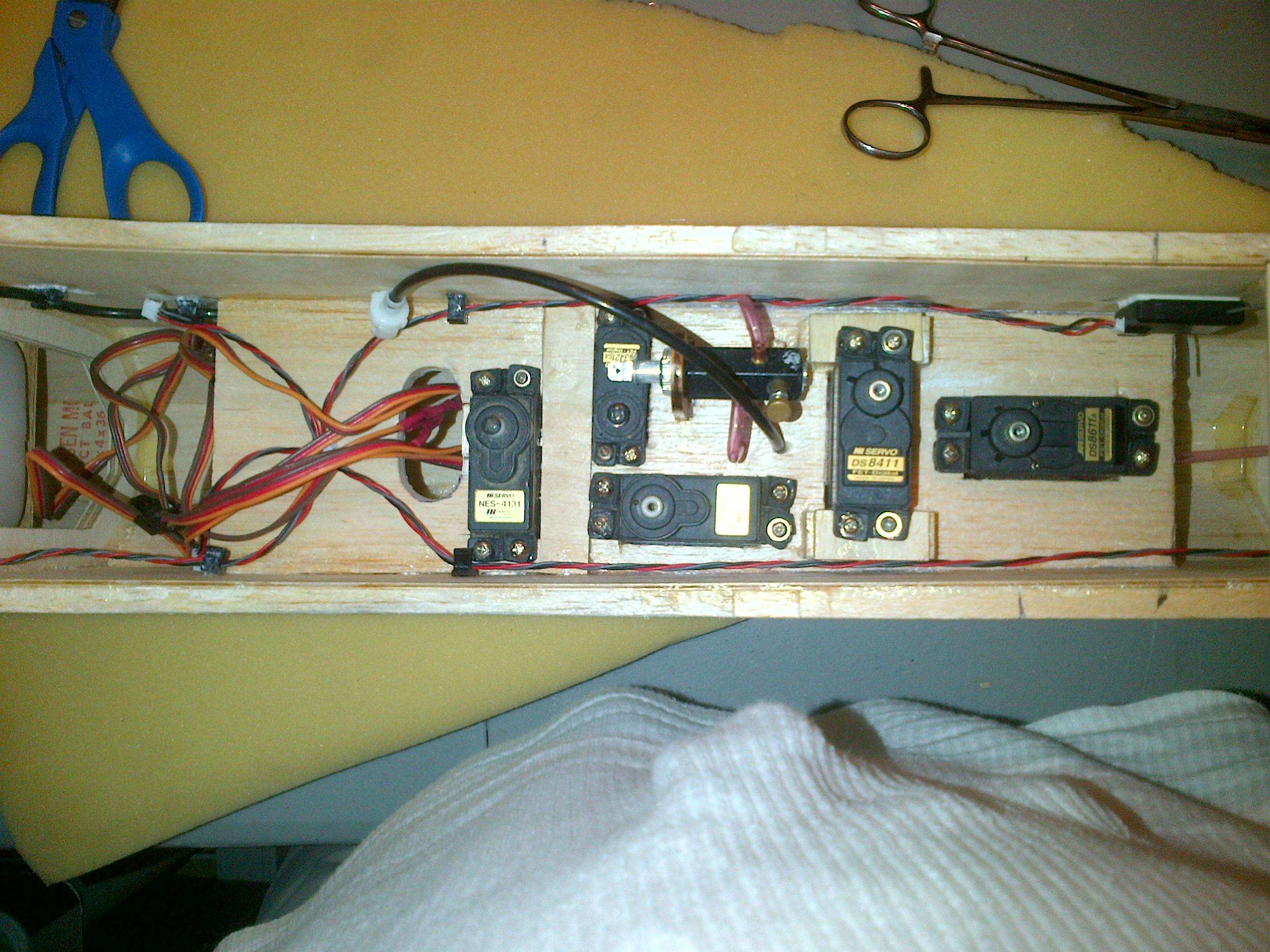

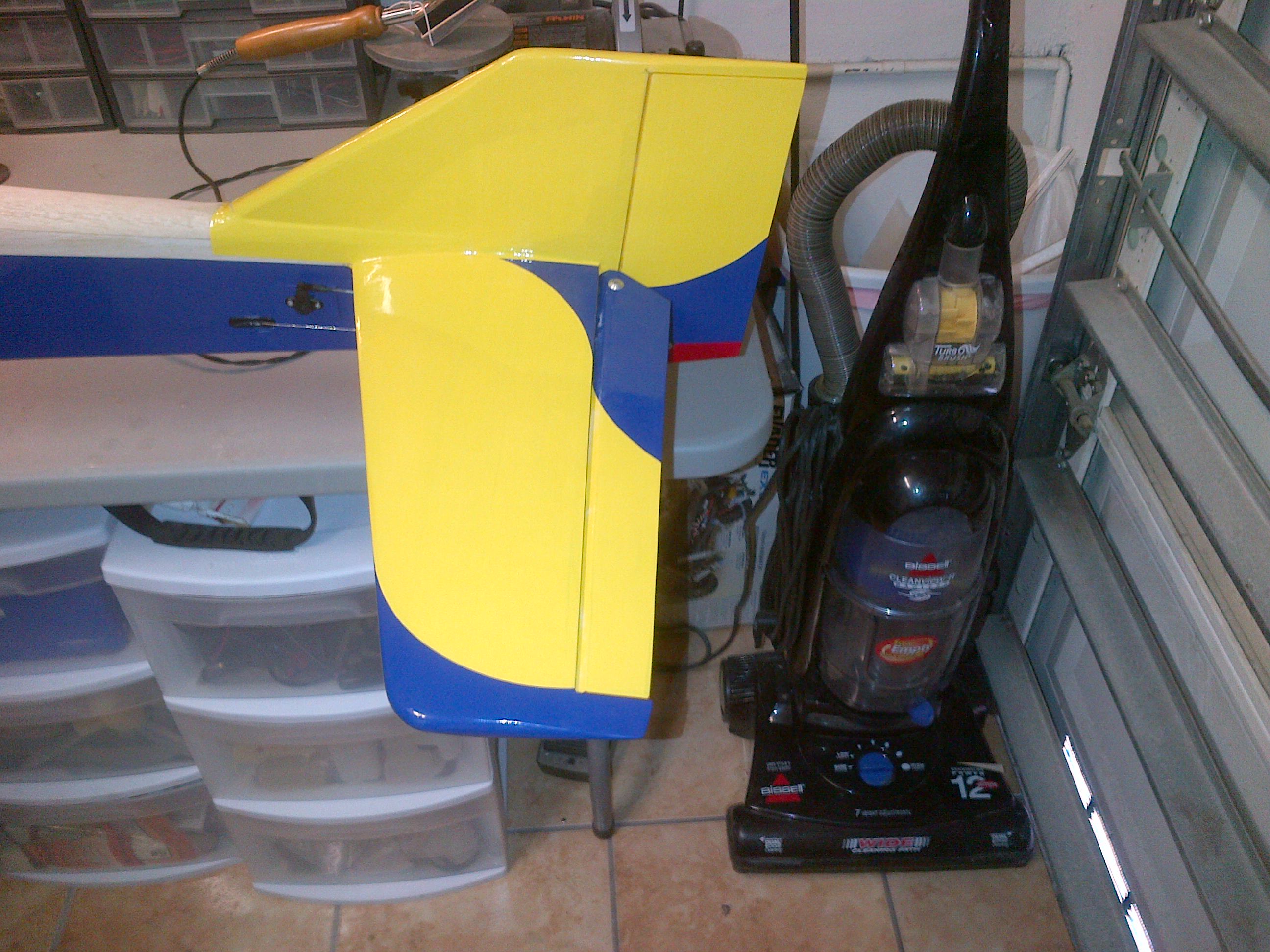

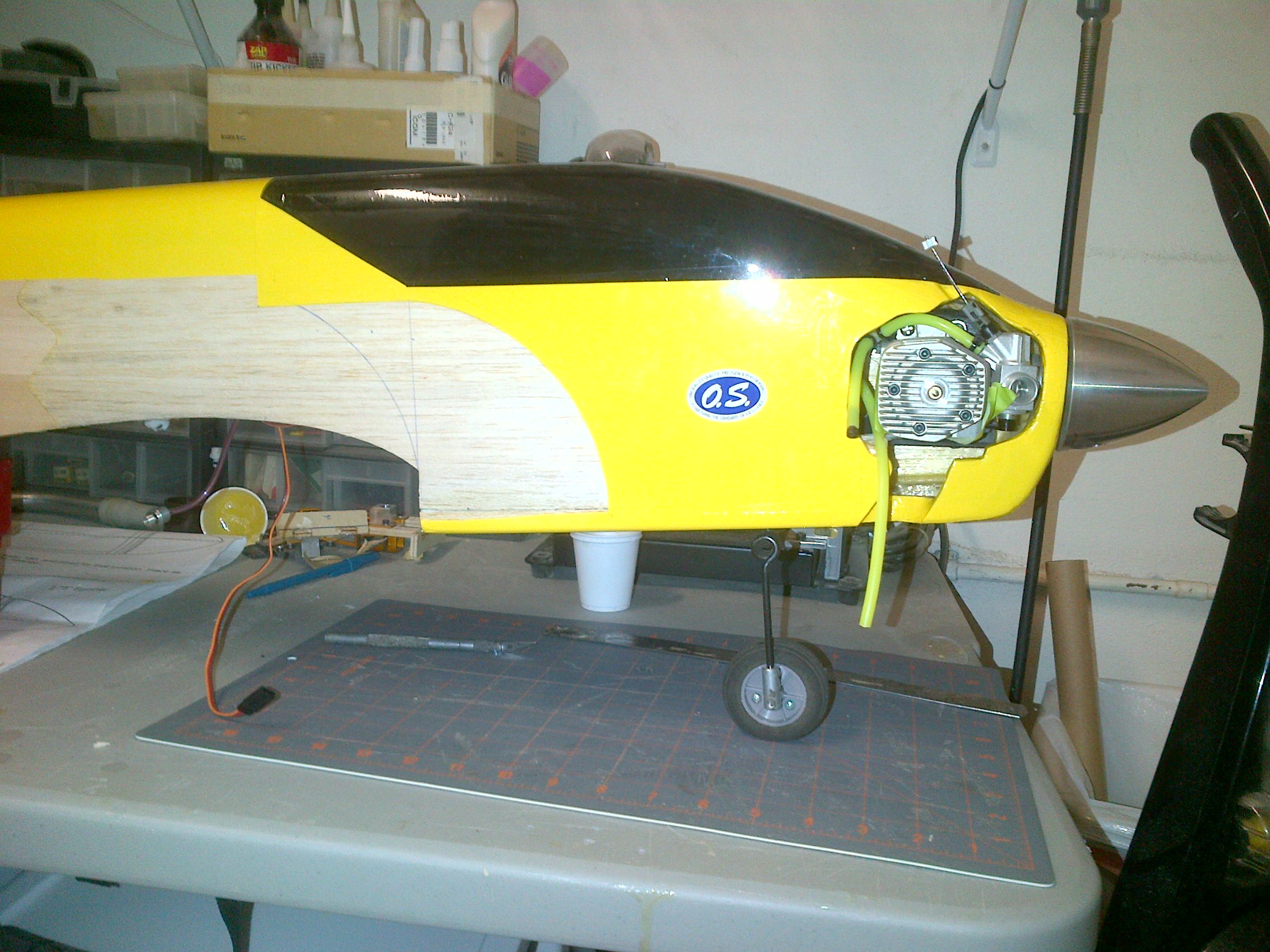

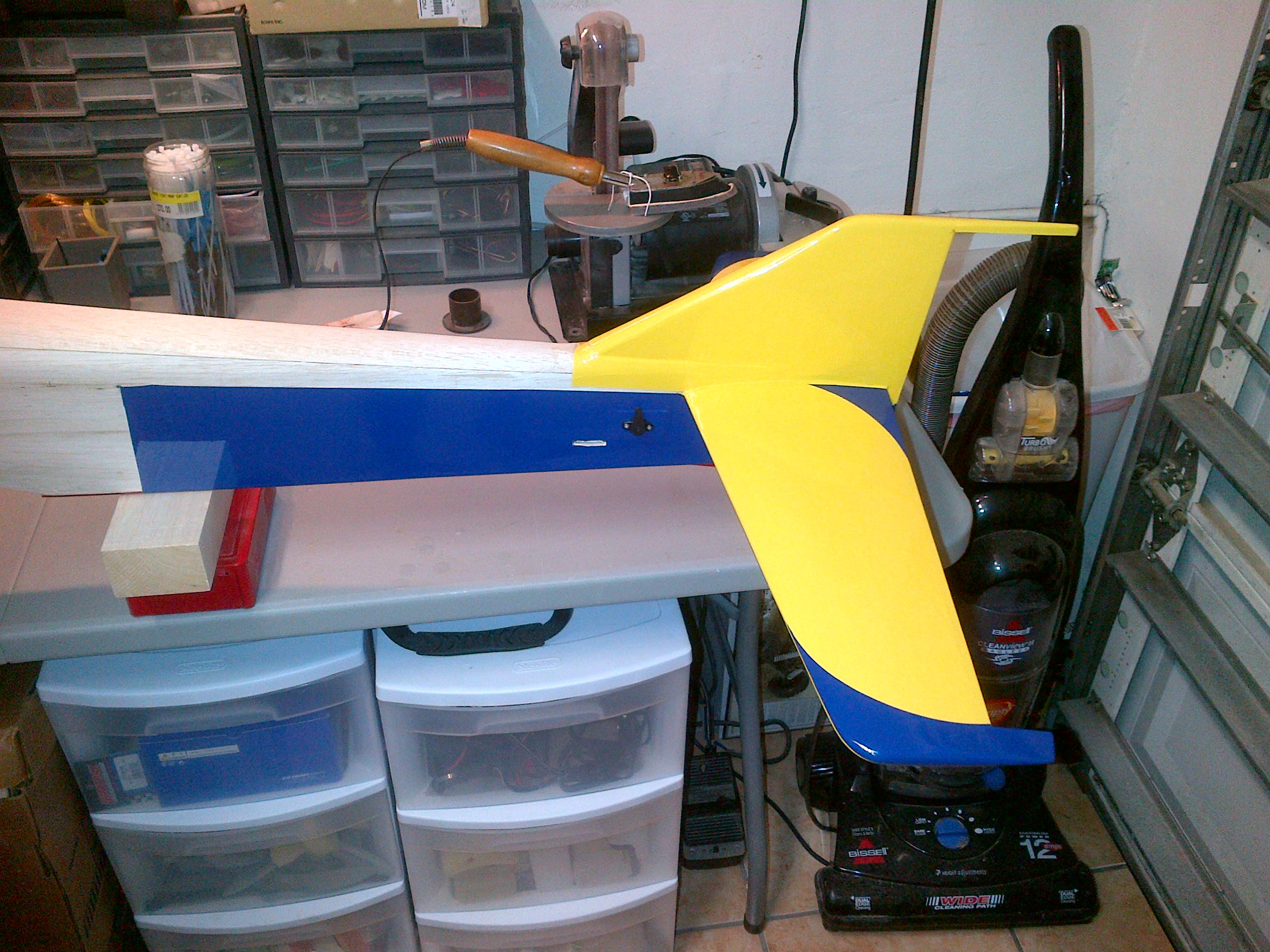

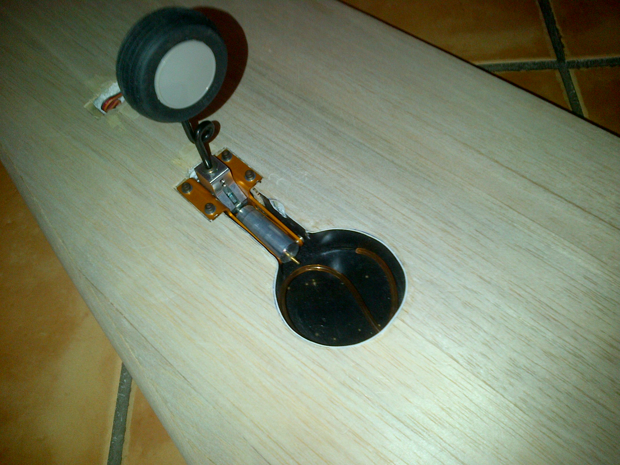

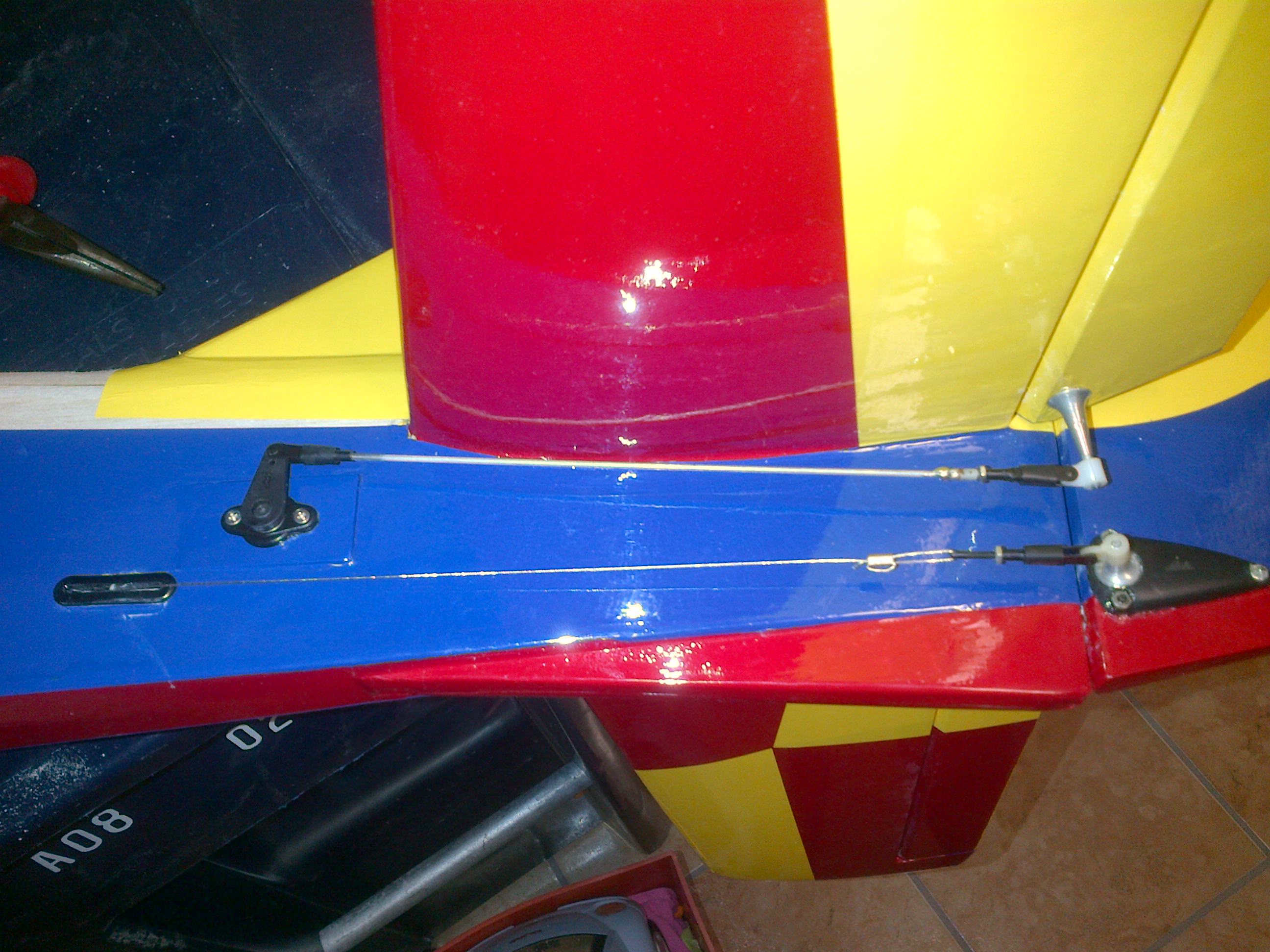

I would like to share with you my latest build. A Tiporare 120. Why 120?, Because its the 111% enlarged version I got from Don Turnock from Eureka Aircraft. At the time (about 2 years or more) Don only had a partial kit offering the foam wing and stab, plans and semi kit but was kind enough to calculate the remaining needed wood I would needed to finish the plane. It is now included in his list as a standard option.
Although I do not have the complete build I want to share some pic through out the build. The pictures are not in order but I will give you a brief description:
Tiporare 120
Span 72.25
Length 63.375
Power OS95 AX with Macs Pipe
Servos JR8411 on Elevator (elevator has a bearing bellcrank from RC City for double elevators) and Ailerons, Rudder JR8611 with pull pull system, Throttle JR4131 and gear JR 3421
Radio is a JR 12X DSM
Gear is Robart springdown
Construction is very straightforward, not for the beginner, lots of sanding,not much info on the plan but basics and no building manual (lots of guessing). Incidence and correct angle measuring on anhedral stab gave me a hard time. I just broke the engine a week ago and finished balancing last night (a bit nose heavy). Plan to test fly my Tipo this weekend.
If you have any questions I will do my best to answer them for you. Thanks.

FL

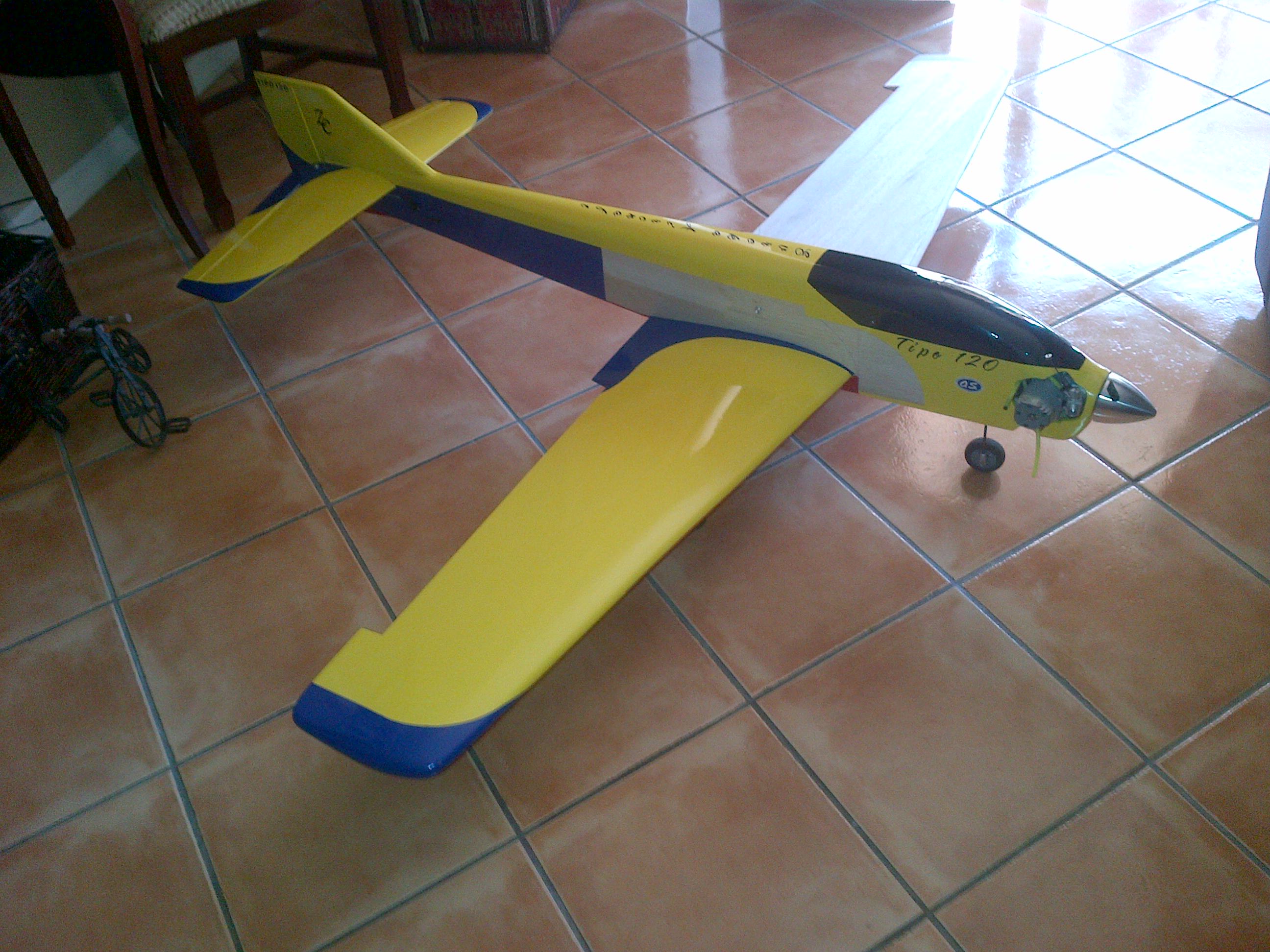

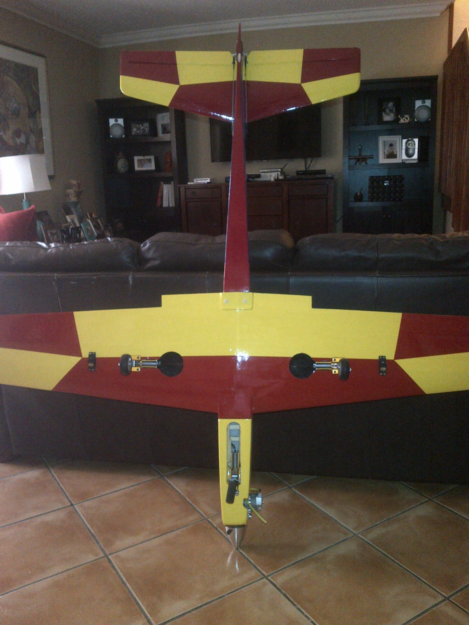

Hi,
I would like to report on the first flight of my Tipo 120. After tweaking a bit the low needle I got my 95 where I wanted (sorry no rpm meter at the moment but I will get it to measure the rpm output of my 95 with pipe). Taxing was fine, a bit of right drift that I have to correct on the steering servo mix, plane accelerated without effort and took into to the air with just a bit of elevator (I had taken of the weight I initially put on the tail as I found out my balancing was out of place), balance was perfect, I left aileron about 4 clicks and down elevator about 3 clicks to get the plane flying straight.
Rolls where very axial (I have aileron differential dialed in) and loops where well on line although I have to watch a bit un the upline as there is a slight drift to the left. Coming out of the loop was very straight. Plane was flown mostly at half throttle and it felt like driving a card in third gear all the time (steady run but with extra power left). Knife edge where more straight than I expected with very low input to keep it straight.
This plane is not a speeder as wing airfoil is kinda thick. But I liked the average speed. Did not try the retracts out on this occasion. As I prepared for landing I lowered speed and made a large final pattern ( I usually do that ), plane lowered speed accordingly, I had to give some gas to get it closer, wing tips stayed level at all moment with no intention to stall at low speed, as normal elevators can get a bit saggy but a first landing it was fine. Then it happened, as soon as main gear touched ground both wheels turned 90 degrees turning themselves into an emergency brake stopping the plane on a dime, lowering my nose thus breaking my prop tips and putting wholes in both my wheels.
I knew somewhere I was missing some additional fastening. Nevertheless the flight was superb, I packed and went back home to fix the landing gear issue and get ready for my next flight for more fine tuning and some more flying. I must say the plane catches the attention of some pilots as they are not much used to see the old type of pattern planes.
See you at the field.

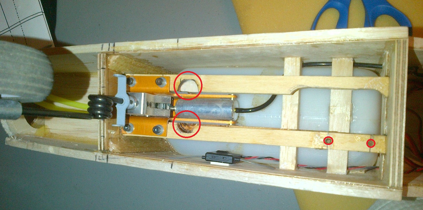

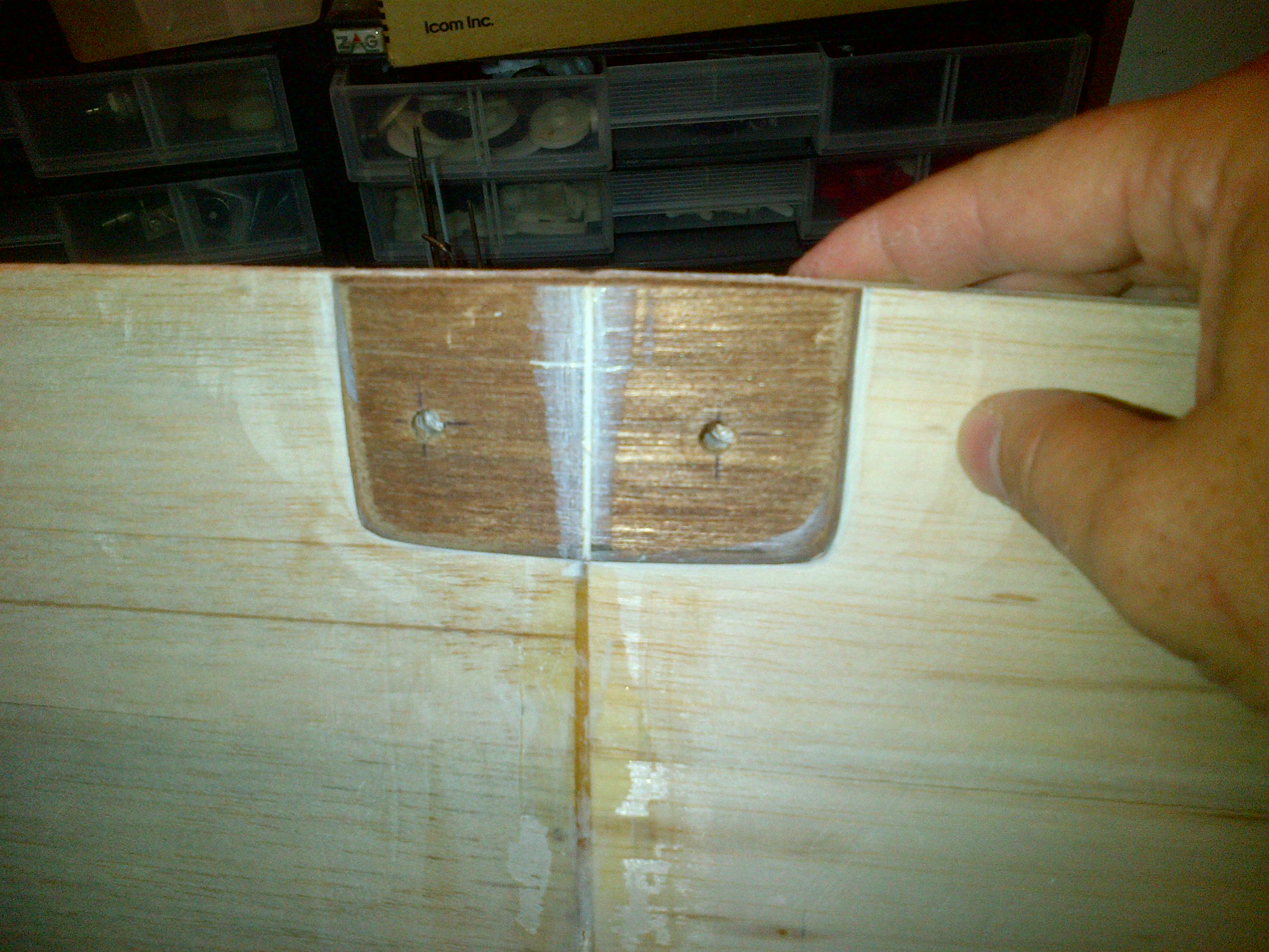

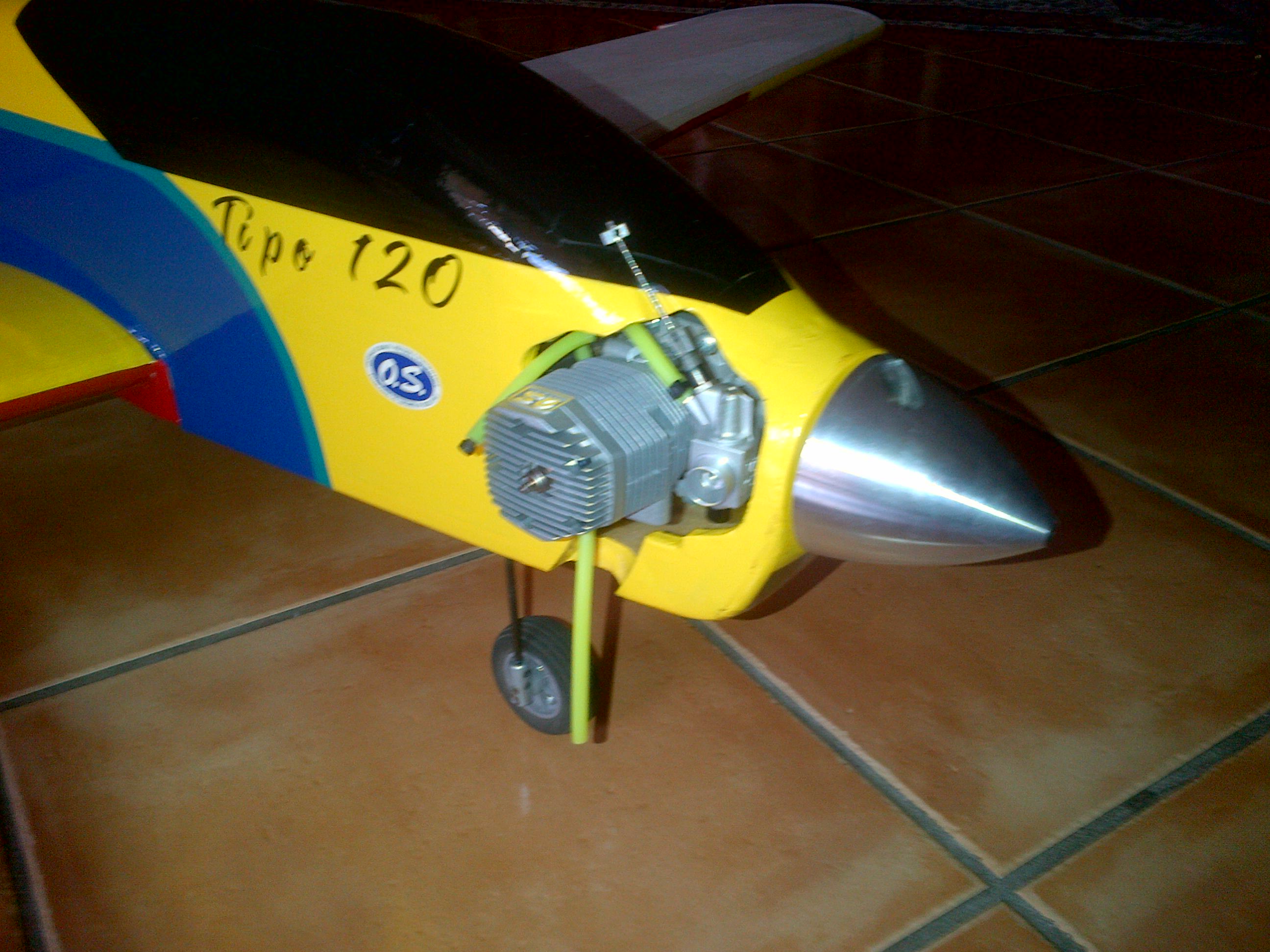

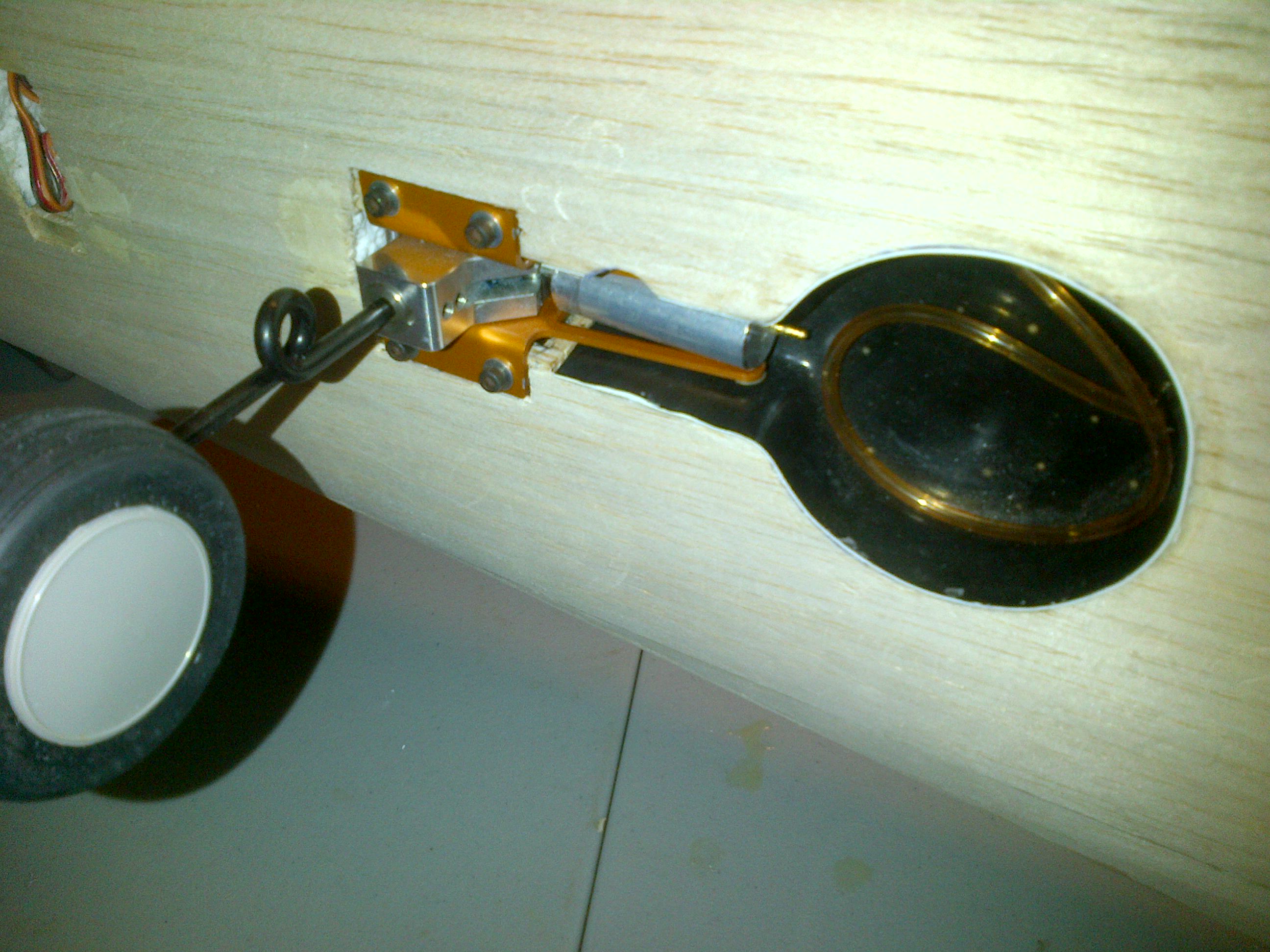

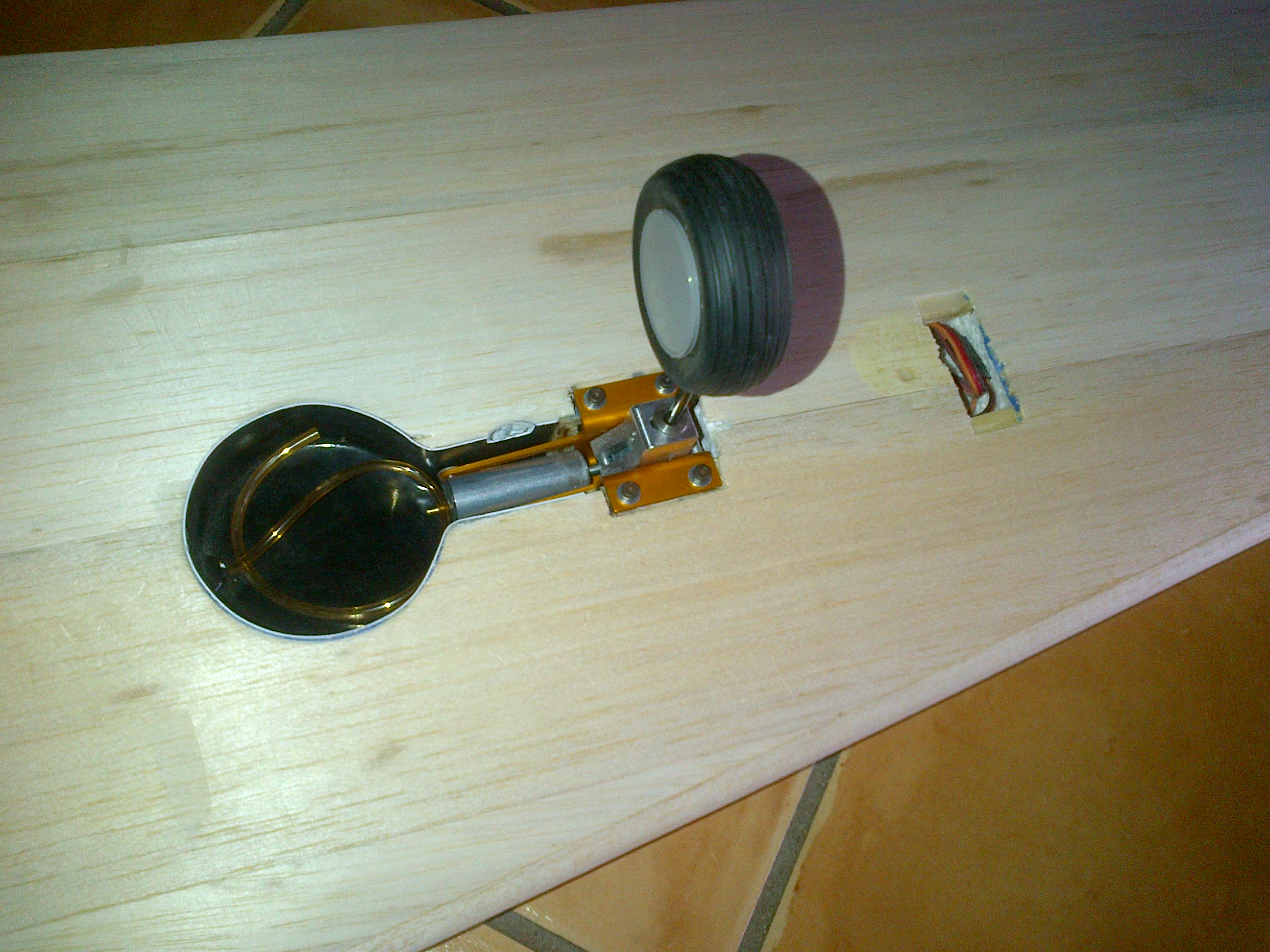

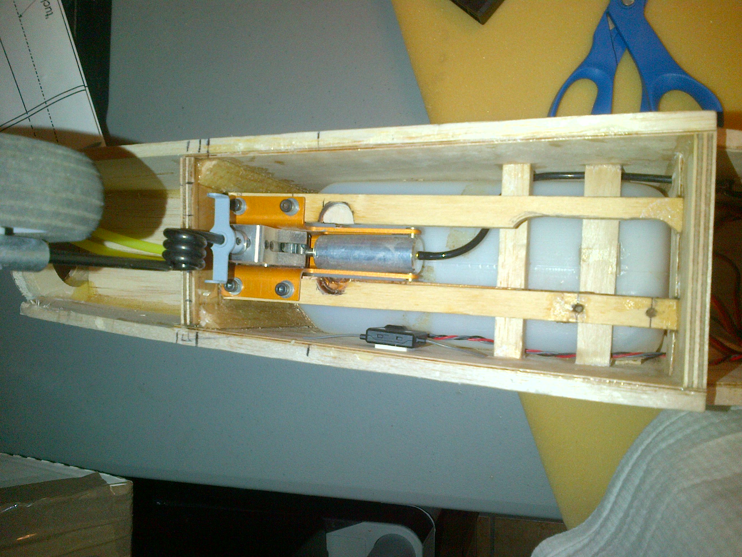

Hi Christian,
Congrats for the good flying behaviour of your big Tipo and sorry because of the tips and the wheels, I guess some hours working on your Tipo will heal the wounds.
I could'nt see the nose wheel mount well in the images you attached, because of the position of the camera while taking photographs, but it is obvious that you have used 2 hard wood rails as beam to hold the nose retract, I just wanna say my point of view and maybe it's wrong, I feel there are some weak points which could be a crack starter in the wood rails, as i said maye be these weak point are felt to be just because of the restricted angle of camera. If this pretty tipo was mine I would reinforce these rails whith epoxy and cloth or better with carbon fiber straps which just add a little weight to nose and this excess weight can be nutralized by restoring your elevator trim into its former position.the other more difficault choice would be changing the rails with wider and even reinforced rails in addition to some triangles glued at the coners. I wish no hard landing and no bouncing for your bird.
Ehsan
Ehsan

Hi Ehsan,
Thanks for pointing out the details on the rails. Beefing up is not a bad idea. However I like to think sometimes to having the rail system as a "fuse" in case a hard landing shows up, better have the rails to give away that harming the fuse. Regarding the spots you circled, the two next to the base of the retract I had to carve out in order to have the steering arms to fit in. Otherwise the retract would not lock when the wheel is up. The two others holes where errors I must admit and I was to lazy to cut new rails and just turned them around.
Never the less I will take your advise in and do some reinforcement. I appreciate your advise.
Christian

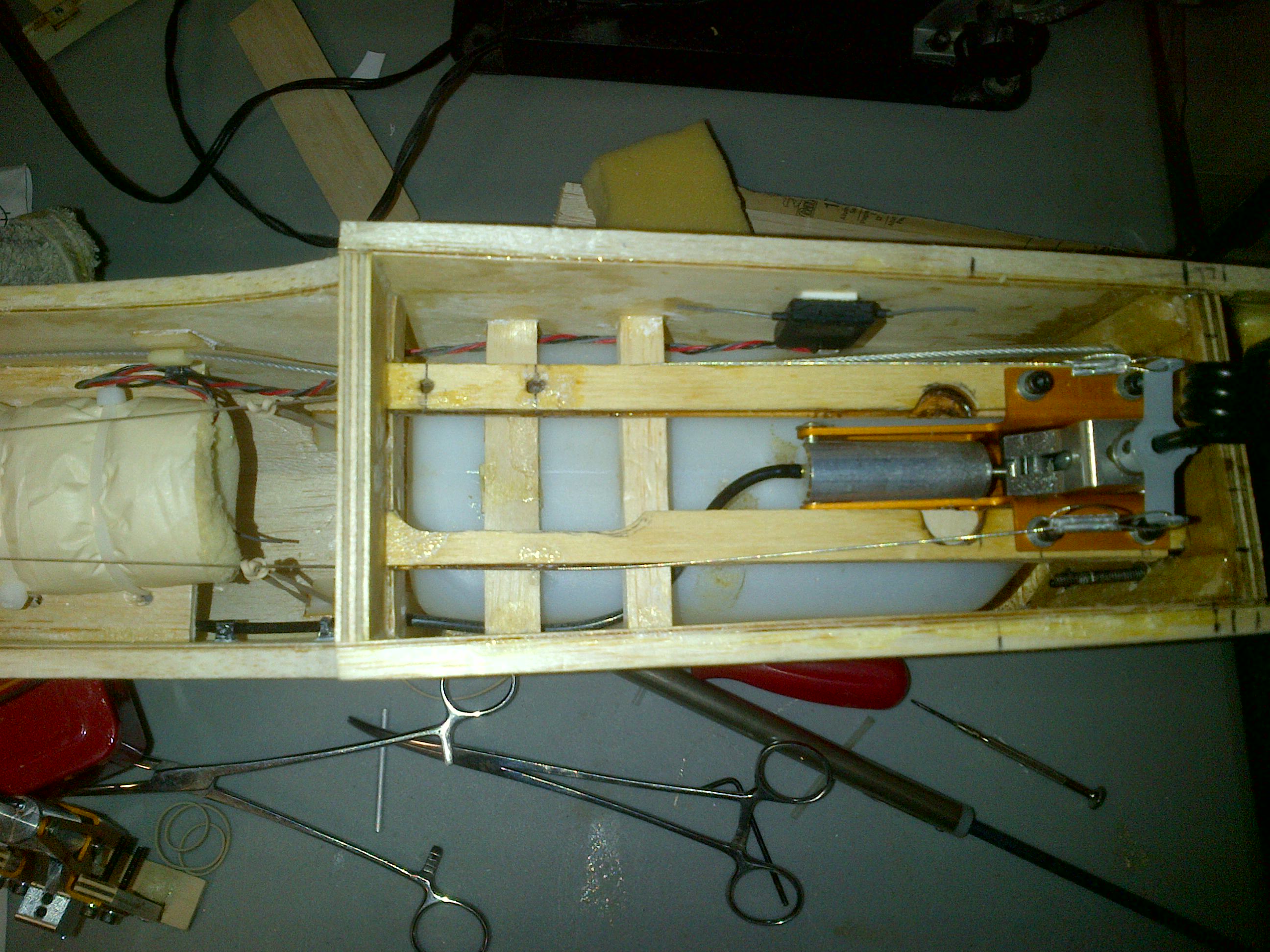

Hi Ehsan:
Took some time to check on the rails of the nose gear and definitively some reinforcement was needed. I finished last night reinforcing the rails and now they feel really strong. Thanks for the advise.
Christian

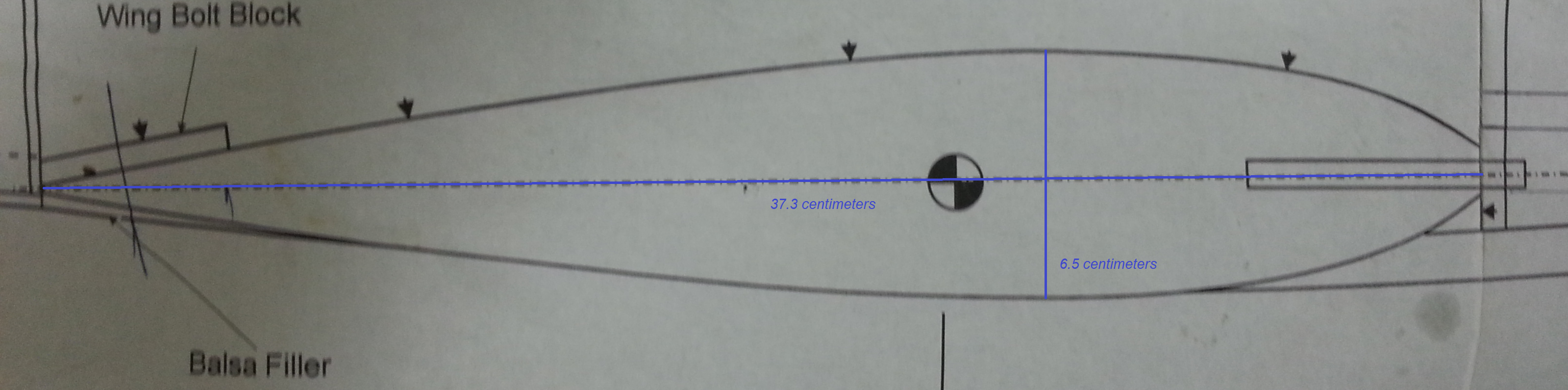

Adding to Christian's comments, I should mention that when I embarked on the Tipo scaling project, my goal was to hit target scales for a given class of engines. In that light, I never intended for the models to be built "verbatim" per the scale up or down of the plan. Naturally, a 60 sized design that uses 3/16" sides doesn't need to have 1/4" sides if scaled up to a 120 class model.
As one departs further from design scale (60), the reduction or augmentation of structural material becomes more critical. As one departs strongly from linear scale, one has to further lighten the model during the material selection and built phase. For example, a 61% linear scale model (the Picorare, Tipo 15), needs 3/32" sides (or lighter) which represent a 50% linear material reduction. By the same token, the T120 doesn't need 1/4" or 5/16" sides at ~12% linear enlargement. One can still use 3/16" sides with no structural loss of strength.
As it turns out, my scaling factors resulted in 1/8" linear steps in scale (almost exactly) all the way from the T15 to the T160 (yes, a 2m version was conceived as well). That was a very interesting discovery.
I have since redesigned the Tipo to not only make it easier to build using interlocking construction but also to result in a substantially lighter model. I'd venture that up to a 12-15% weight reduction can be achieved compared to the original structure. Use of 1/32" wing/stab skins (along with strategic CF) as well as a skinned former (or foam) fuse top are key to this redesign and restructuring.
Last but not least, design parameters like airfoil, decalage, moments, thrust to weight, Reynolds numbers and even planform are all factors that can be altered by the builder/redesigner. The extent to which one alters these, affects how much your final model looks (or "is") a Tipo or an entirely different design.

I had the opportunity to fly the Tipo again this past Sunday and in my humble opinion it fits the bill perfectly for my style of flying. Straight flight, very axial rolls (although at highest rate the rolls aren't that fast as I would expect - more in the book maneuver style), verticals need a bit of correction, knife edge need a small correction only, inverted barely need correction and landings are slow and predictable. I'm still trimming the plane for my taste. What does the flying have to do with the plan scaling? well that at the end if the flying is of your liking then you got a winning plane. Where would I work a bit? maybe on the weight, fin leading edge at its root is quite thick, access to tank having retracts installed can be very tricky, but at the end I'm getting the results I wanted so I really don't need to complain. Am a happy camper. Thank you for the input.
