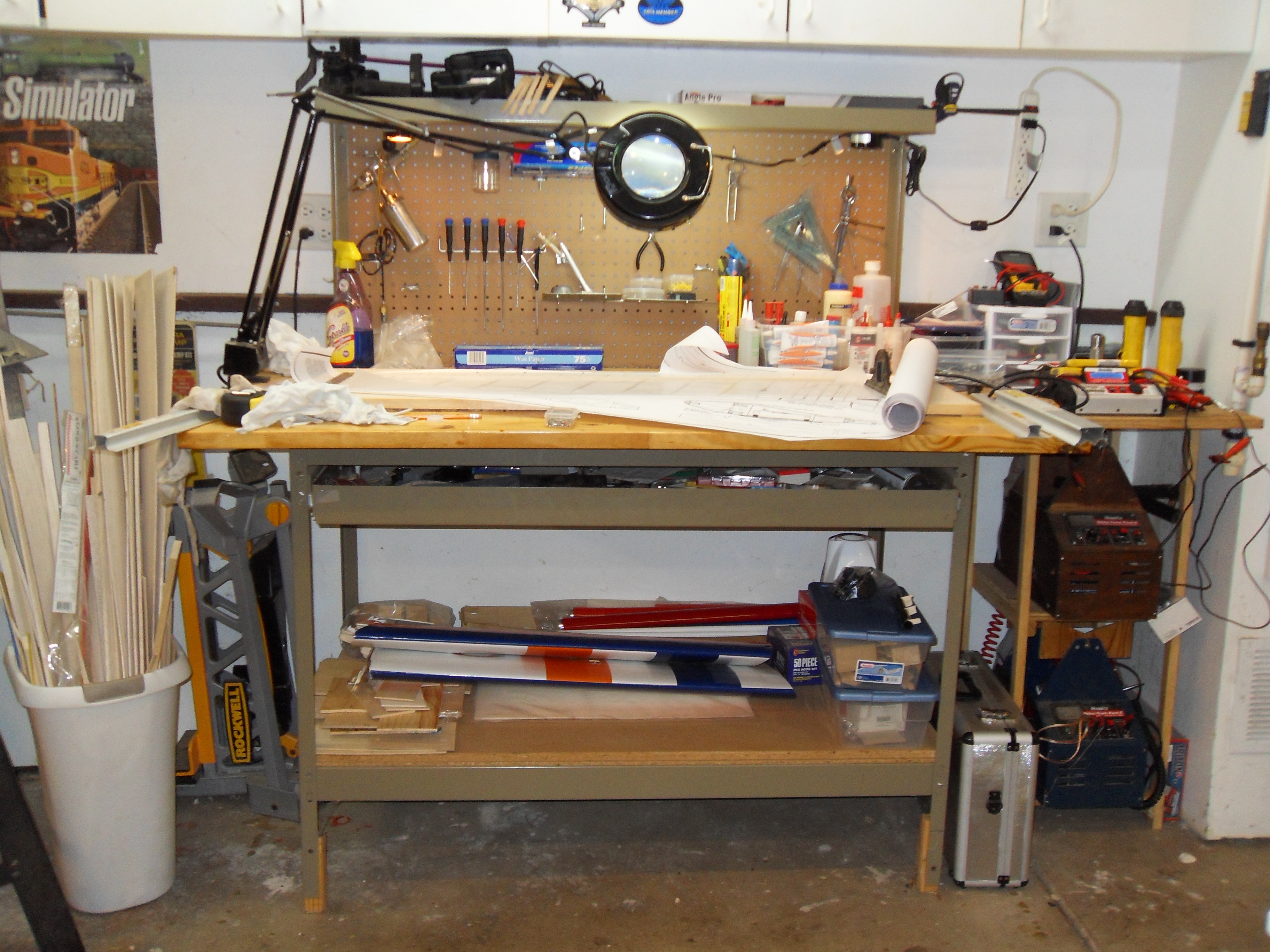

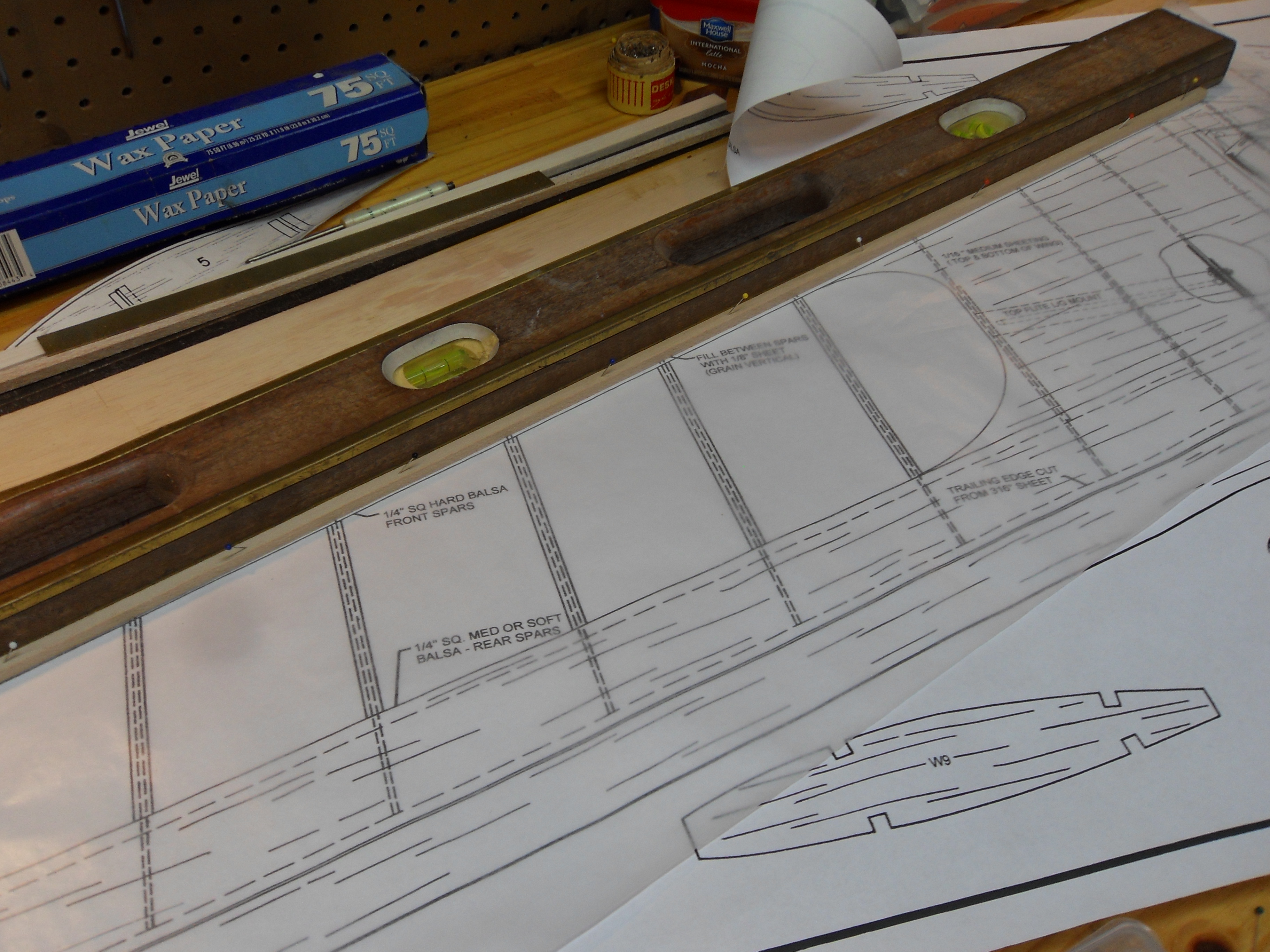

Nothing fancy - I got the steel bench at Menards (under $100.00) and found the 1" thick pine top in the lumber dept. I squared and leveled the bench, screwed it to the wall studs then used a Great Planes Pro Building Board 16x48x3/4" for the building surface. I put the board crown up on the bench and used deck screws, shims and a good 4' level and squared it up. Before each project I sand the building surface and do a quick check with the level and its good to go.
Hook - best I can do now on the pic as I started the wing layout already.

Nice setup Jim. Thanks for your good building Iinfo. Jim out
hook57 11-14-2013 01:31 PM
Good enough pic Jim, I was curious about how it was set up. Continue with the build :D !

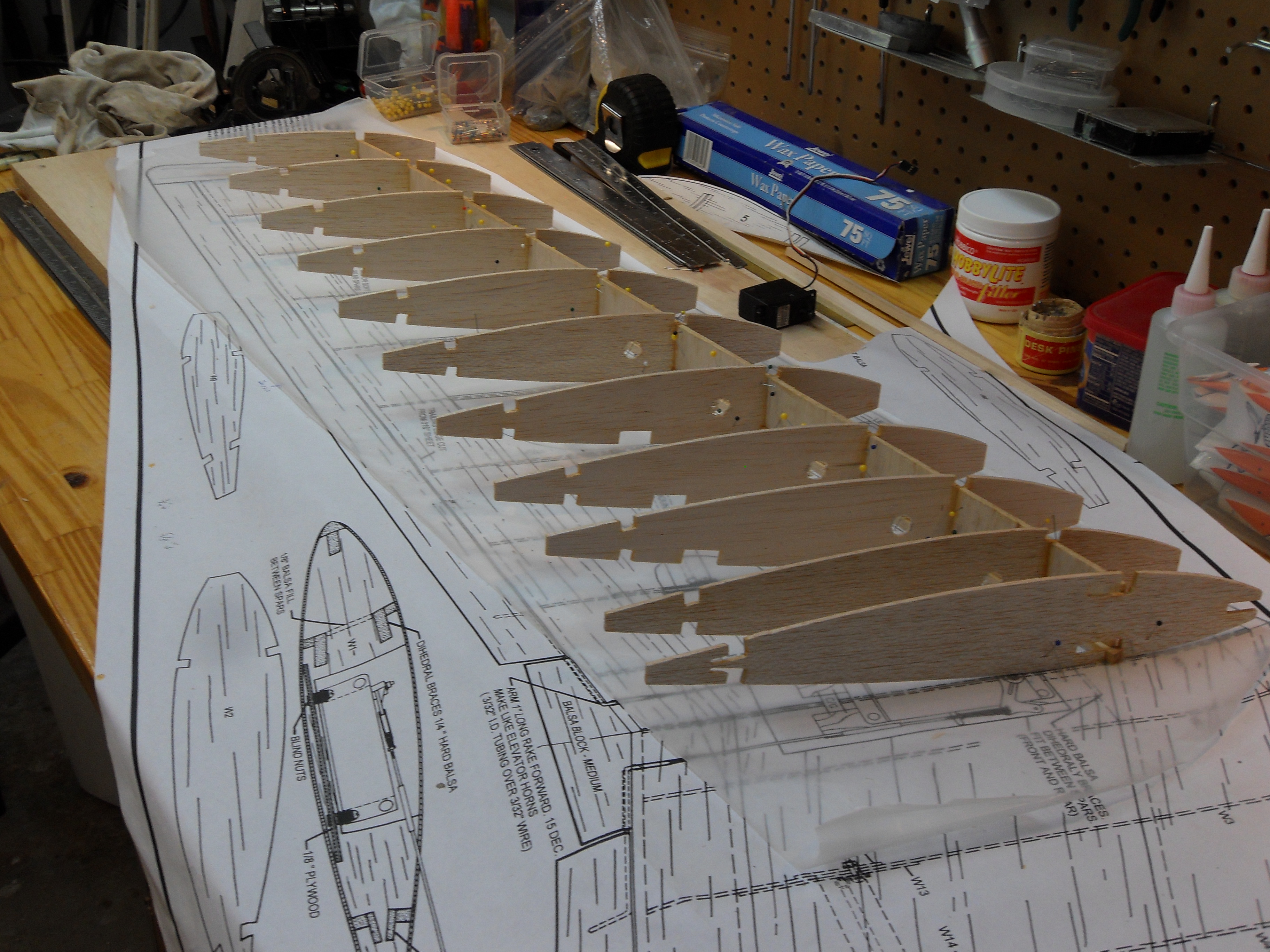

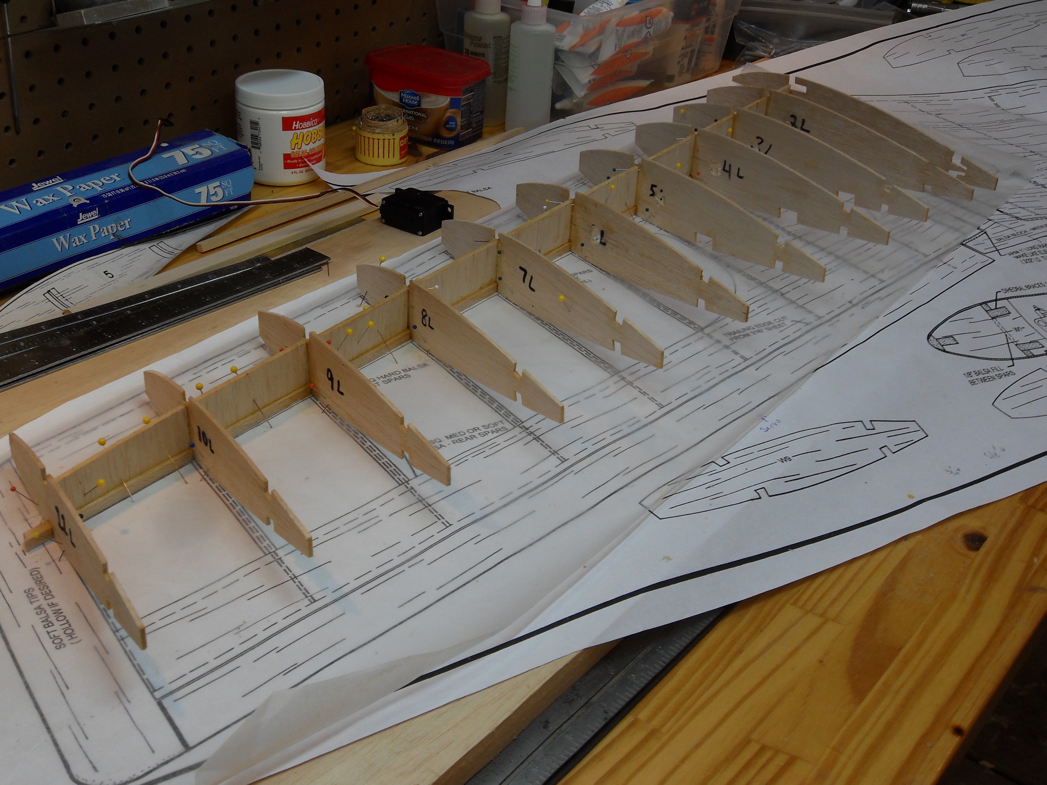

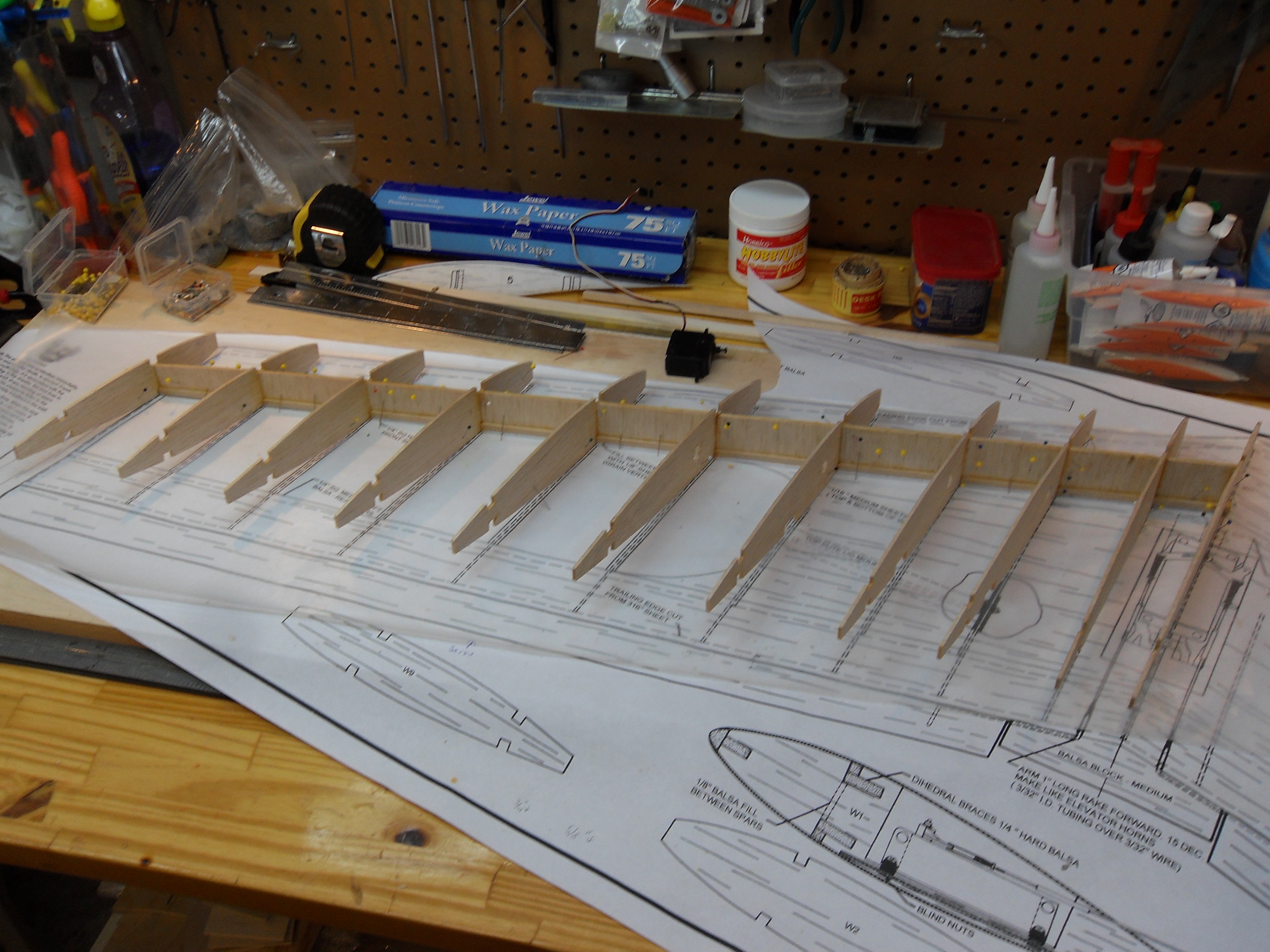

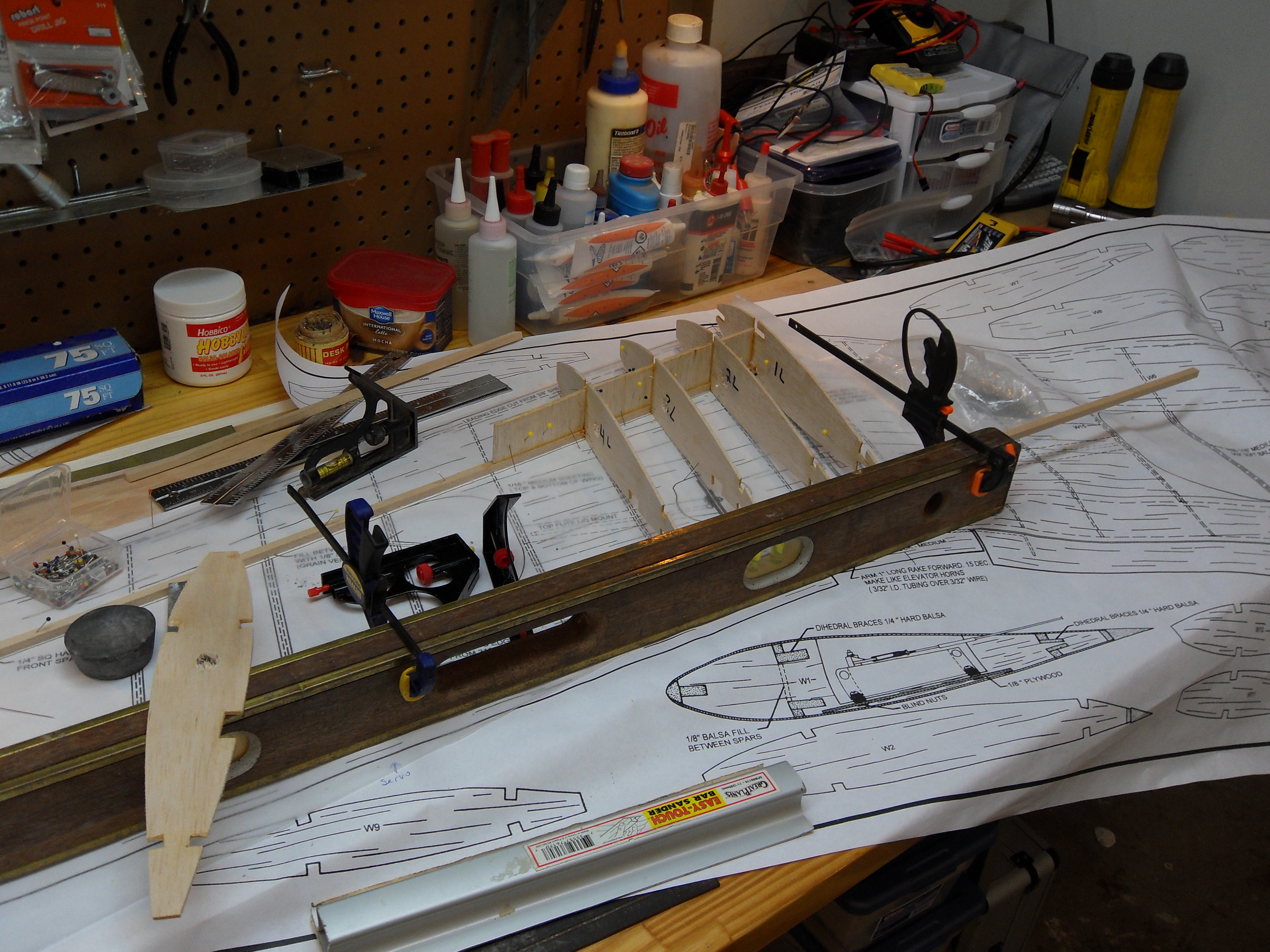

munster003 11-20-2013 01:47 PM
6 Attachment(s)
The wing is a little tedious due to the sweep - every joint has to be mitered for proper fit. http://www.rcuniverse.com/forum/atta...mentid=1940879http://www.rcuniverse.com/forum/atta...mentid=1940881http://www.rcuniverse.com/forum/atta...mentid=1940882http://www.rcuniverse.com/forum/atta...mentid=1940883http://www.rcuniverse.com/forum/atta...mentid=1940884http://www.rcuniverse.com/forum/atta...mentid=1940885
