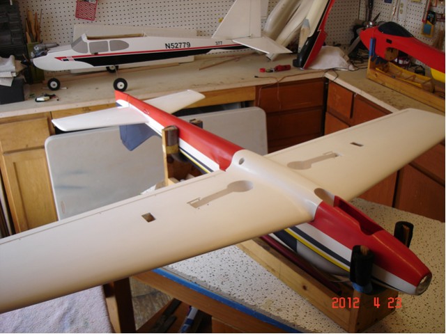

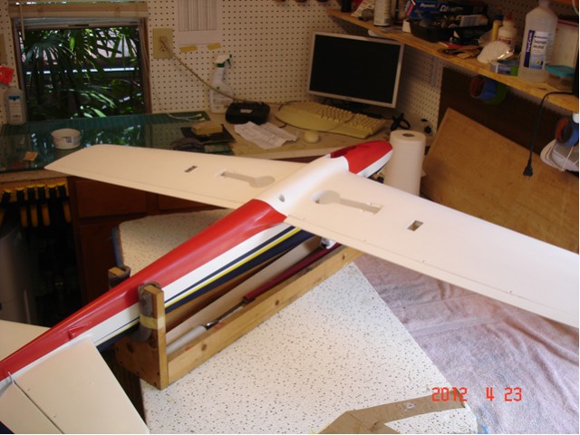

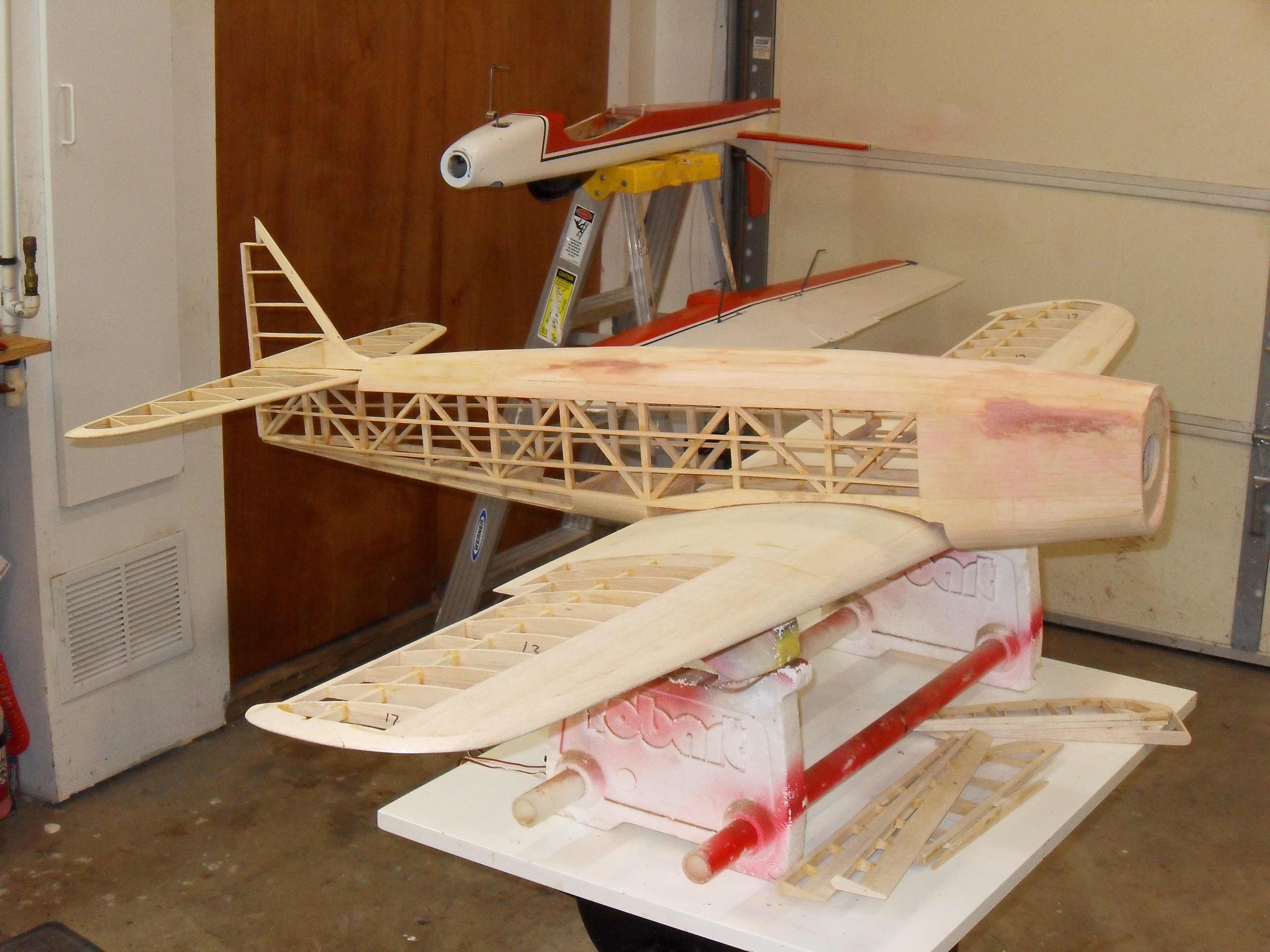

Original P-1. Great news, doing a build thread ? Here is originals on the V. All Phoenix' I have built, 1" under each tip, before pan secured.

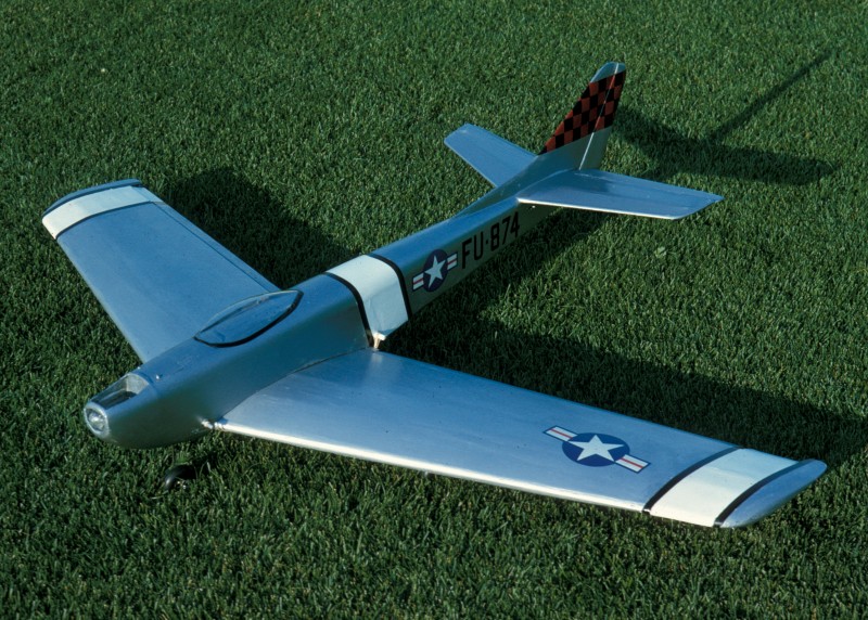

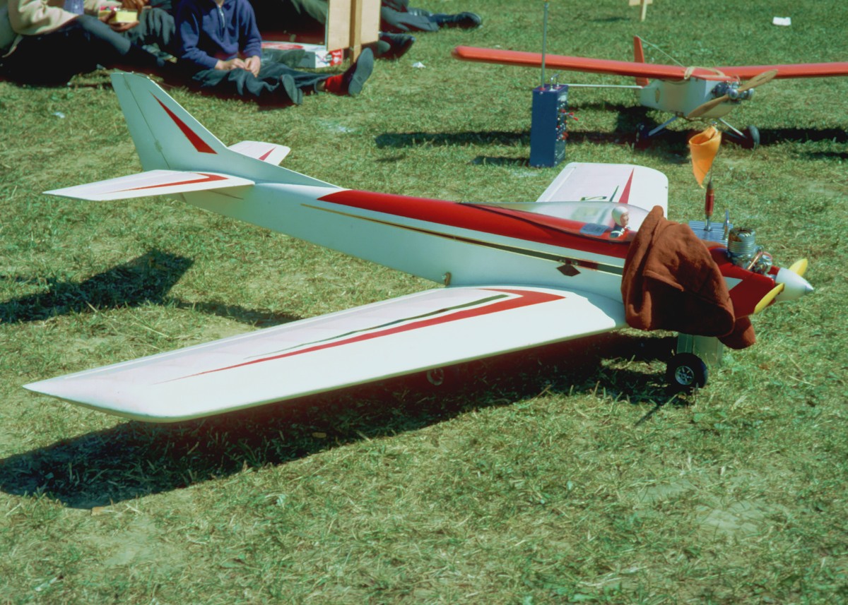

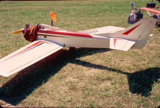

It's great to see a Phoenix 1 build thread. It was the very first plane I ever built, (I was ambitious and thought it was soooo cool). It was pretty rough, but that's how I spent my summer in 1965. The wing was built FLAT if I remember correctly--it didn't have any dihedral as such...I remember building it on one of the library tables at my Jr High school, (the librarian flew R/C).
I couldn't fly at the time, but who cares about details like that. I built the plane and painted it like an F-86 Sabre I saw in a book. I never flew it. Over the years of storage the 1/16" balsa sheeting got brittle and cracked. When I eventually moved out of state I gave it away to someone who I'm told flew it. The next sentence was that "It flew faster than hell, and made a spectacular crash..."
The pictures on the right are of Don Lowe's original Phoenix 1 taken at the 1965 Detroit Invitational. I showed him a picture of mine, and he just smiled as if to say, "...kid you're over your head"

Bump. Duane, any thoughts on the CG for the P-1 ?

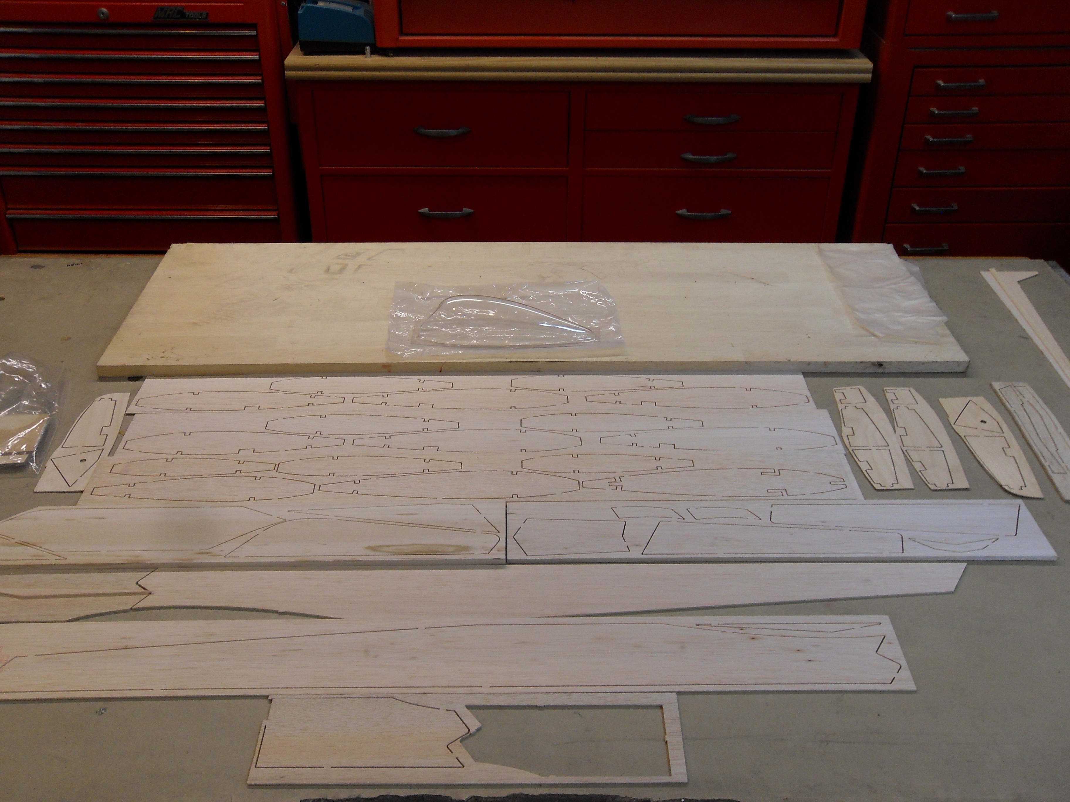

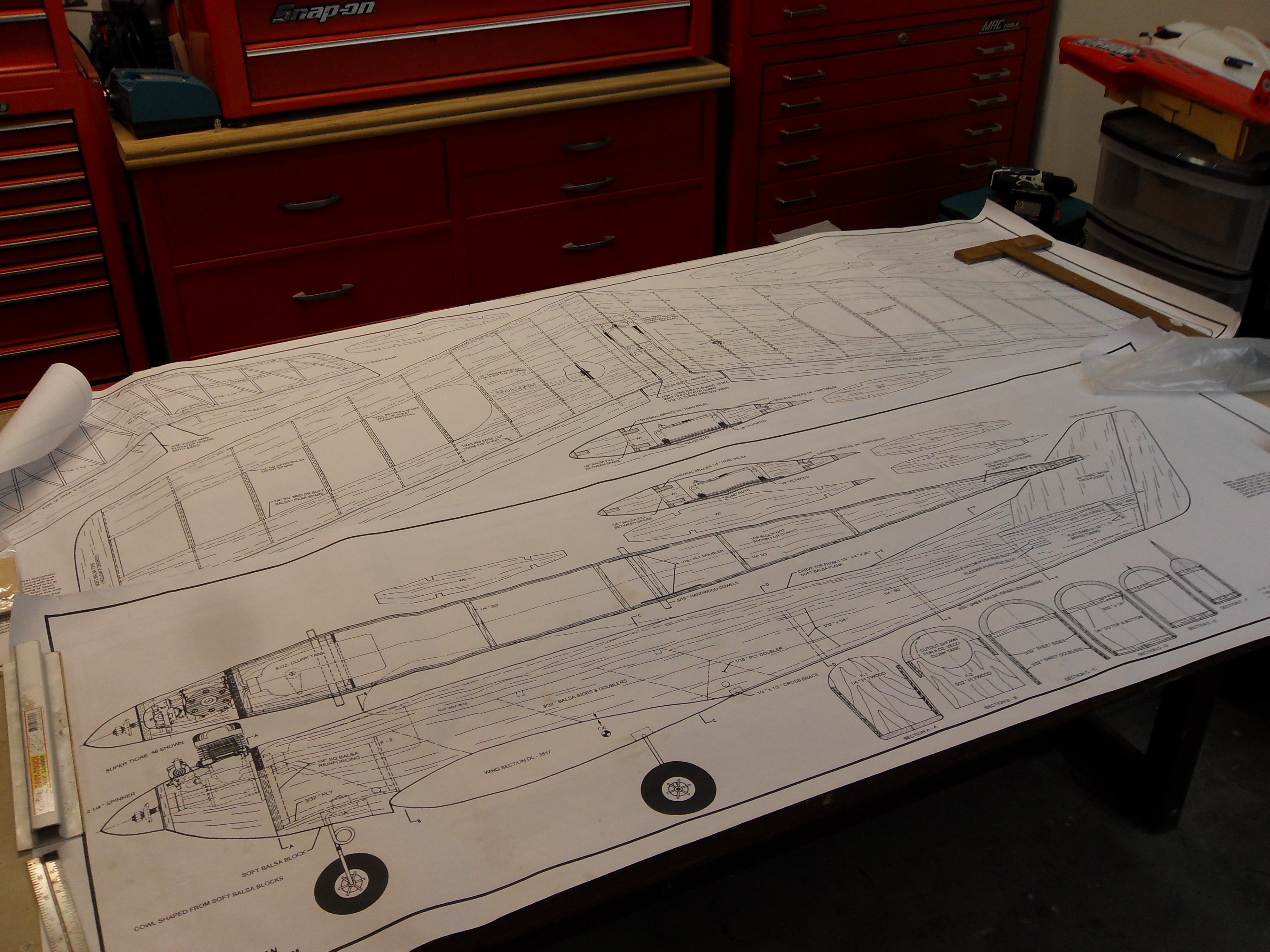

Pics show plans, and short kit (with Kaos cannopy). The remaining balsa is on order. Probably going to put a HP 61 GOLD CUP for power I've also added the B-17 after the maiden flight (check your shorts Jason) and the PBY. I also added a pic of my Fairchild being built from scratch from 1956 plans. Is that Marks Kaos taking refuge in there?

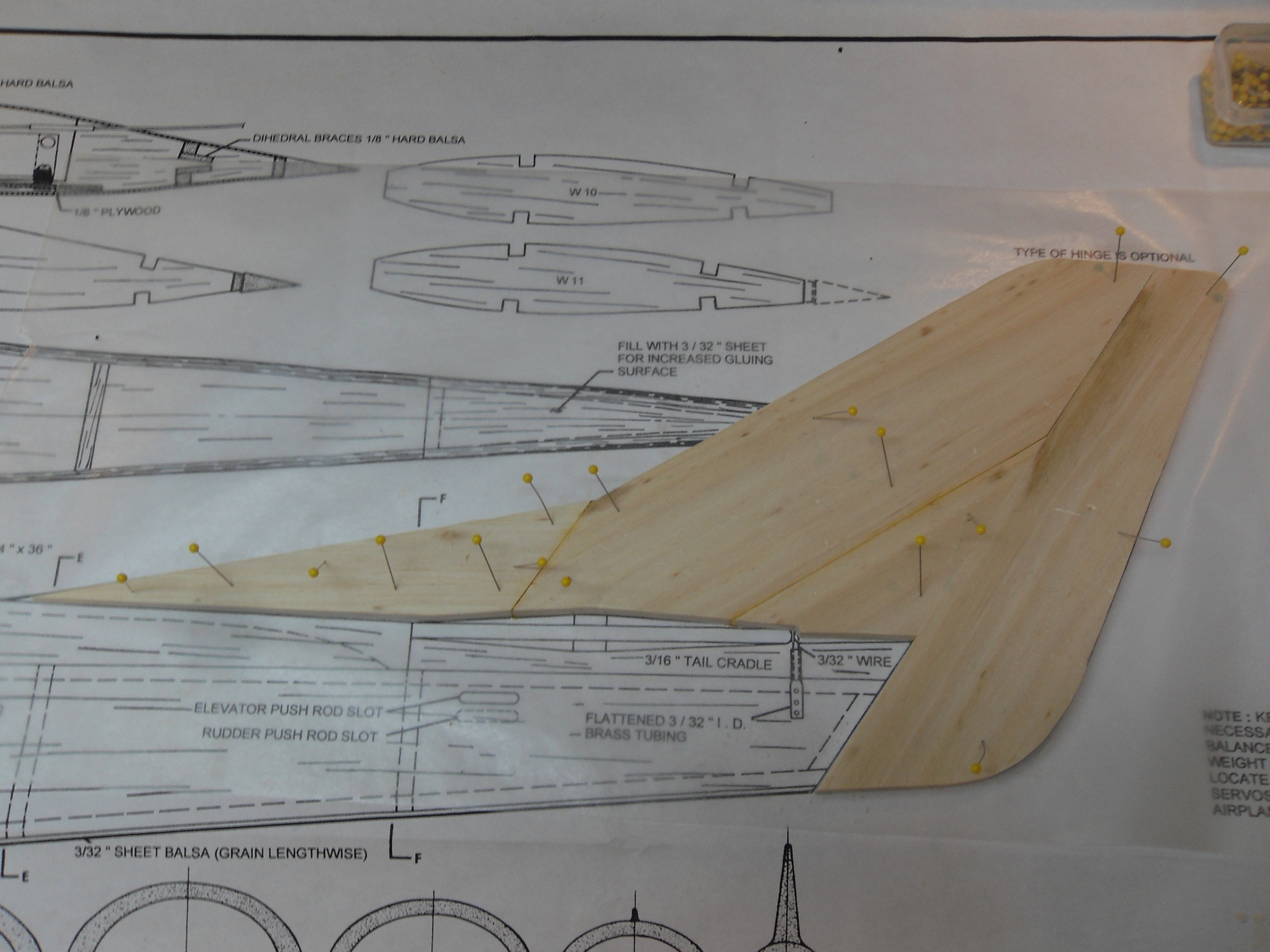

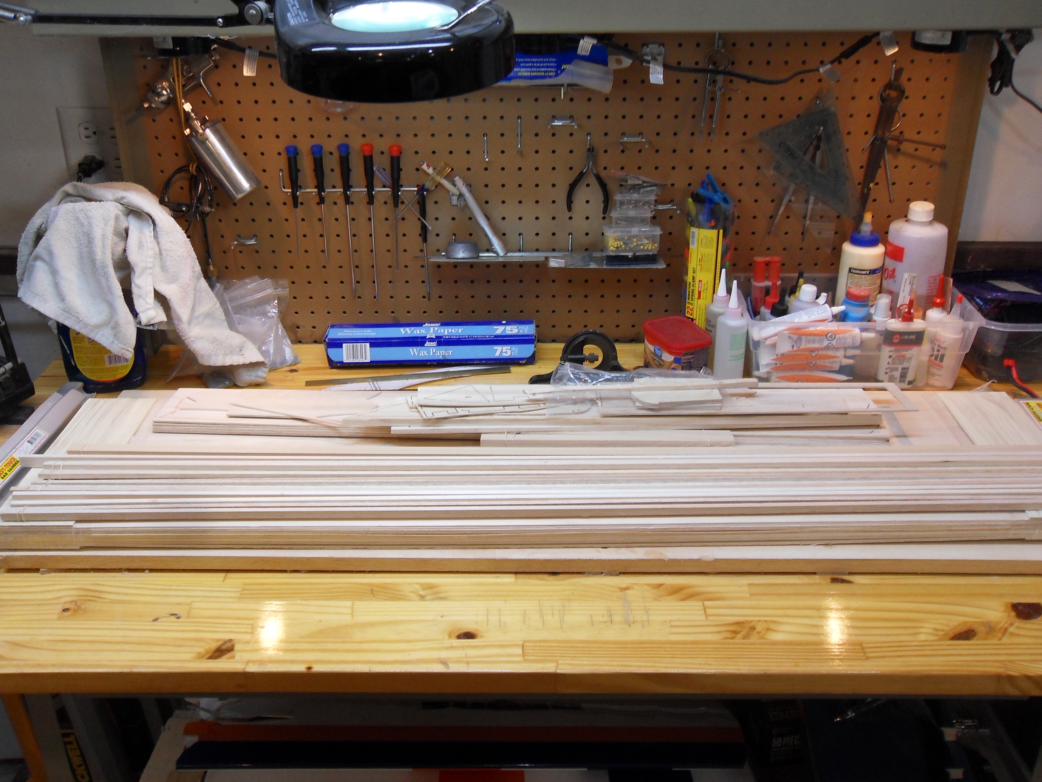

I have the rudder and elevator glued up. I will be installing Robart hinge points on all control surfaces (http://airfieldmodels.com/informatio...ints/index.htm) I had to add some balsa to the elevator to accept the hinge points. Final sanding will occur after the control surfaces have been hinged, although the hinge points will be removed and reinstalled on final assembly, after finishing.
Generally, I build the model to completion, radio gear, push-rods - everything possible PRIOR to covering and finishing. I will next start on the wing set up
Missile - I ordered wood from National Balsa. They sell landing gear block and I will probably be using Sullivan hardware for the gear. Mains need to be bent from 5/32 stock. I use a tubing bender for that purpose.
Plans/ pile o wood / rudder / rudder & elevator
