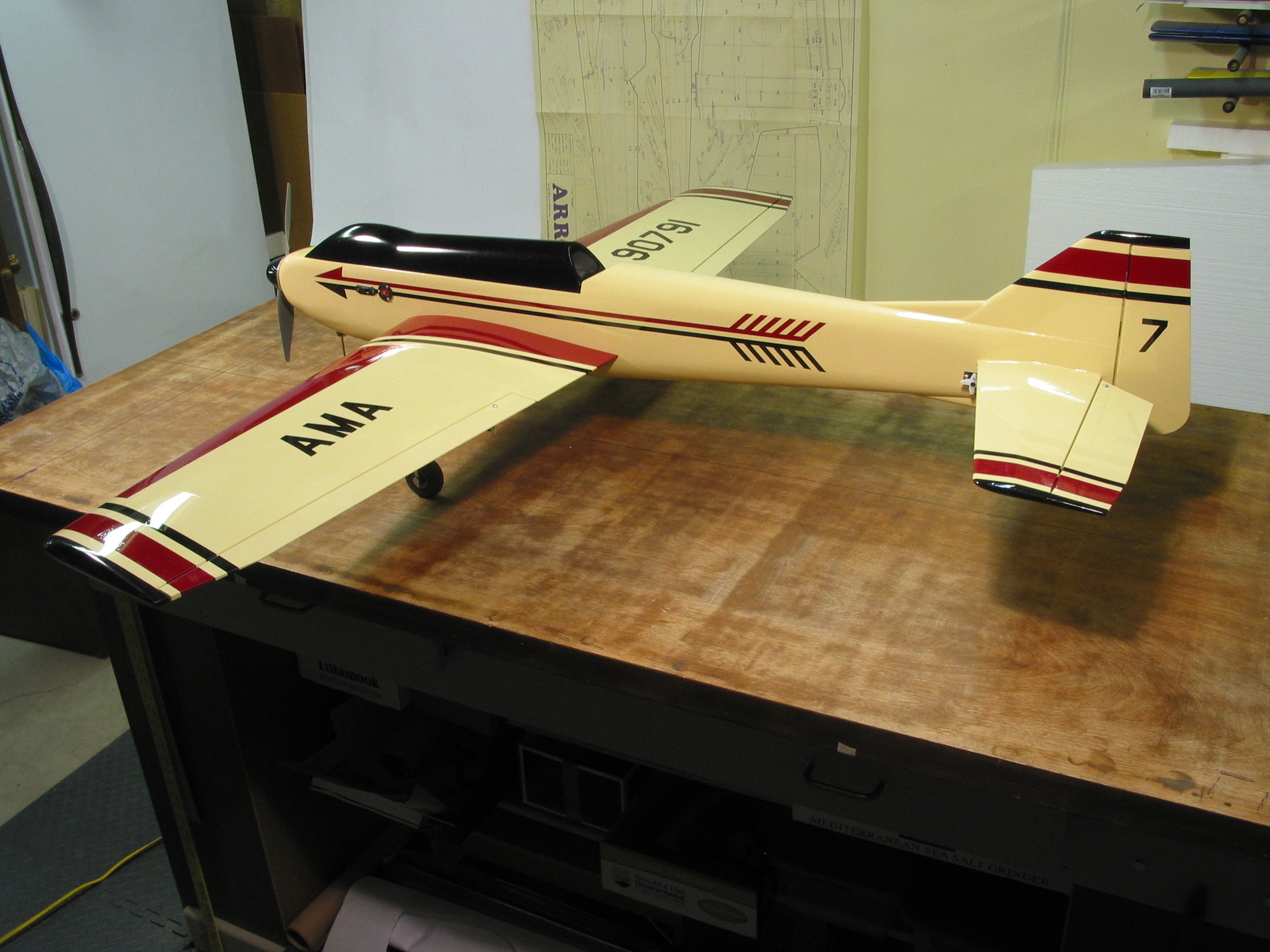

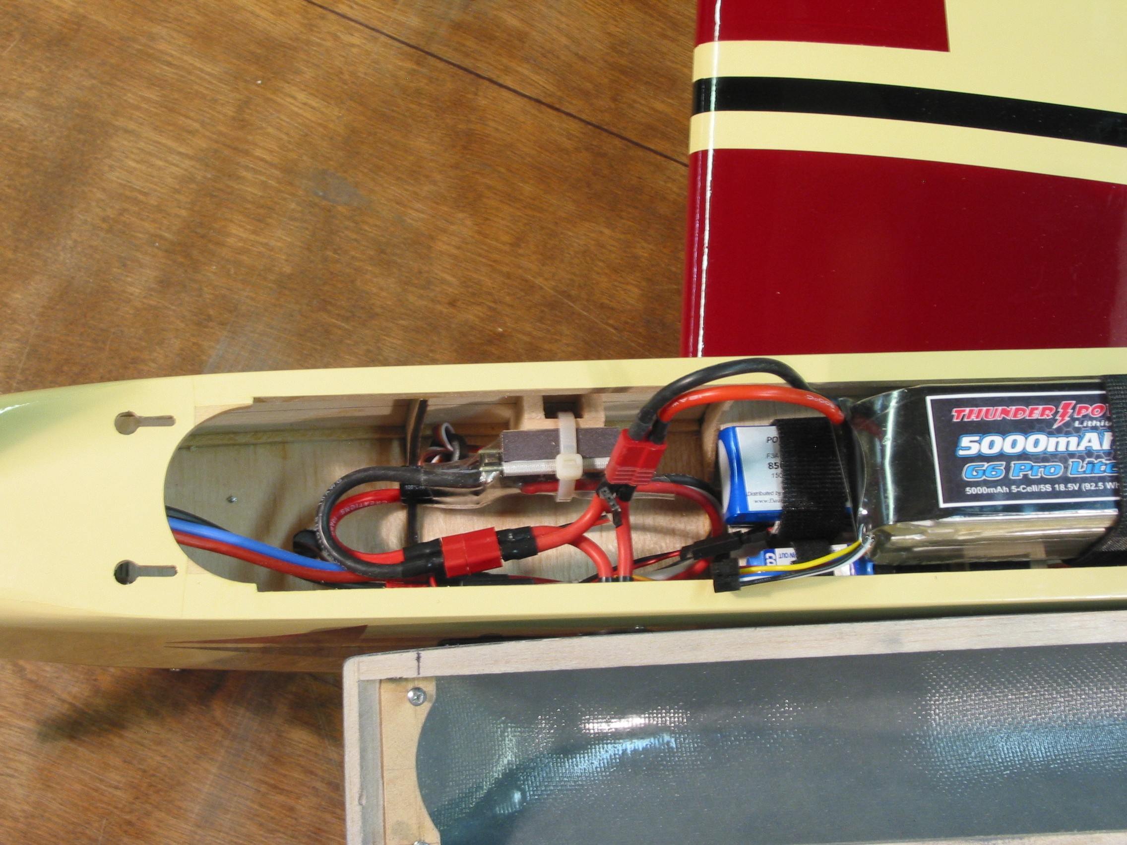

I ran OS VF powered Arrow's back then and recently did a redesign to electric using the E-Flite Power-52 (590Kv). I used an adjustable plug-in wing and diamond stab for adjustability and simplicity and E-retracts, which I found incompatible with a ESC-BEC requiring a receiver battery also. The removable pipe cover opens up the front half of the fuselage for equipment access.
At 4 1/2 pounds less battery the airplane really came alive with a 12-12 prop on 5S.
E-mail me for more info.
Jim

Jim,
that is a very nicely engineered and built electric Arrow!
I have been working on the re-design of a similar concept electric conversion of a Tiger Tail 4 (plug-in surfaces, top access, e-tracts, etc.) but the simplicity of the top glass Arrow deck coupled with the pipe opening in the rear for cooling purposes is very clever!
Also, 4.5 lbs dry is excellent weight particularly with a painted finish (I assume it is). Do you know what kind of current draw and power you're getting from your 12x12 5s setup? Flight times on your 5 Ah batteries?
Thanks for sharing and please do post more pictures of your build and electric conversion. It might inspire me to finish mine!

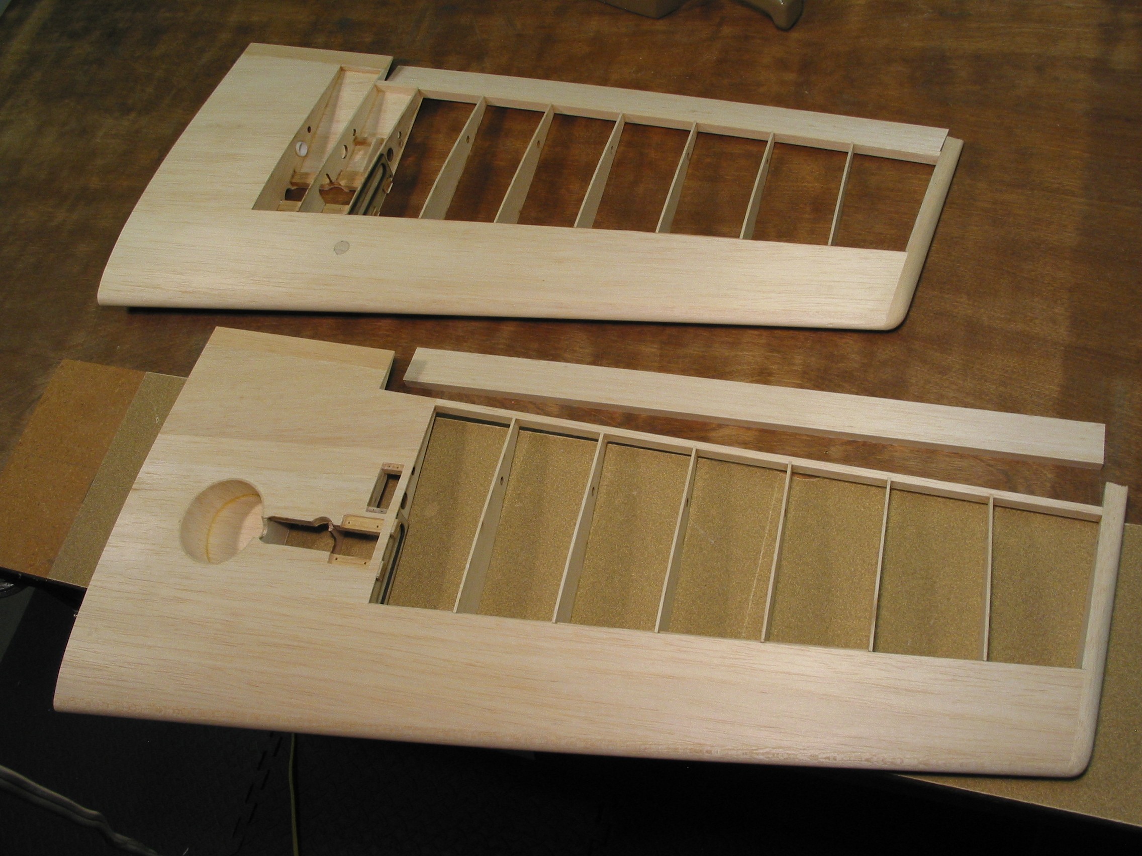

jnhiller 02-27-2015 12:21 PM
1 Attachment(s)
Thanks Yes the Arrow was a perfect E-power subject. I use iron-on-paint (MonoKote).
The data log is posting 61A full T early in the flight with 19V (1169 W). Late if the flight I'm seeing about 55A
I can no longer fly full T all the time and I have a 4 flight average of 26A (446 W). The longest of the four flights was10 min. I don't keep charge records and don't recall ever pulling a battery below about 3.6V / cell. The Arrow and a scale airplane get used 5S pattern packs or twin 3S (6S). I should also mention that in the re-design I thinned the wing also.
I don't have very many photos of this build. but here's one of the wings before covering.
Jim

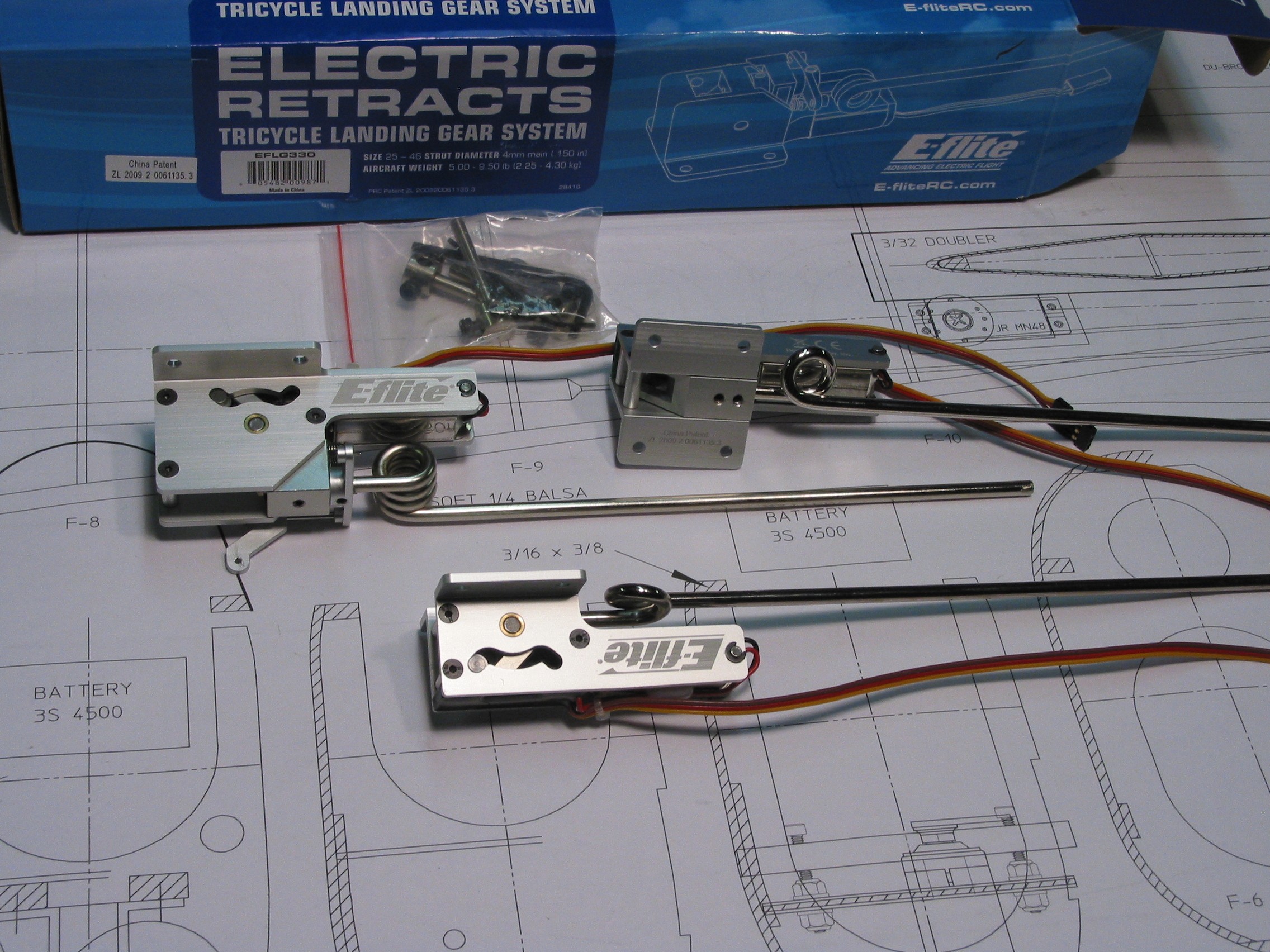

What kind of e-tracts are you using? Have they been reliable on the model?
I hope you don't mind the many questions - your model is quite unique among the few electric classics!
David

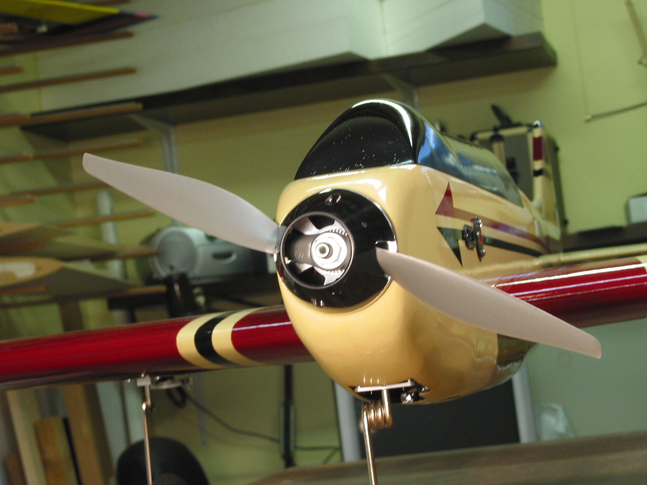

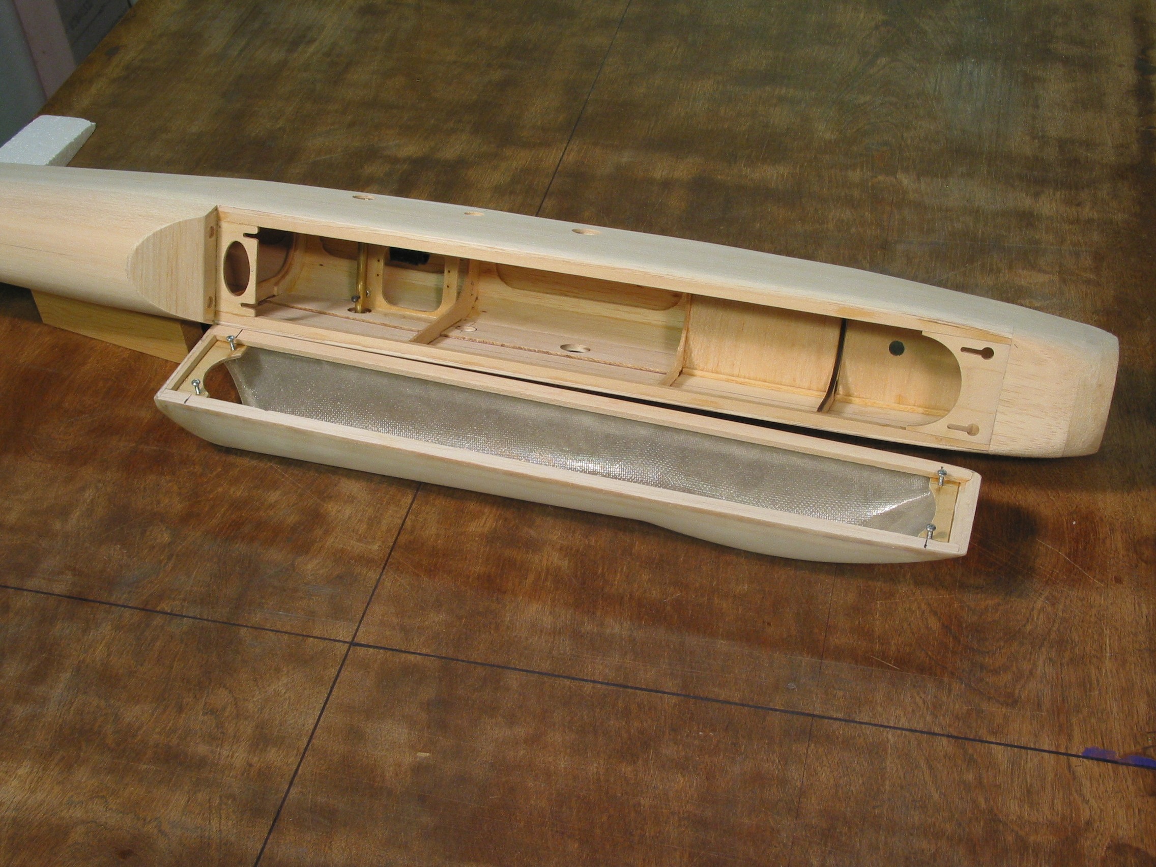

jnhiller 02-27-2015 04:27 PM
3 Attachment(s)
Dave,
The motor is rear mounted using the adaptor that comes with the motor. The firewall was located to accommodate the motor. Yes it installs from the rear through the top opening. This allowed a more open front for cooling air which comes in through a cut-off-nose Great Planes spinner (GMPQ 4772) which has a spoke aluminum back plate.
I haven't tacked it but the data log shows 9787 peak RPM with 5S (20.7V max)
Wing is about 13%, penetration and speed OK, but I've been spoiled flying large turnaround pattern airplanes (10S) with virtually unlimited performance.
E-Flite 25 - 46 Tri-Gear retracts have ben reliable using a separate receiver power source (2S Lipo & 10A Castle regulator. They were unreliable using the 75 A ESC-BEC, probably spiking the initial current draw beyond what is supplied, not locking in the electrical start signal on all three every time. I don't have the necessary test equipment to confirm the current surge when activated.

E-Flite 25 - 46 Tri-Gear retracts have been reliable using a separate receiver power source (2S Lipo & 10A Castle regulator. They were unreliable using the 75 A ESC-BEC, probably spiking the initial current draw beyond what is supplied, not locking in the electrical start signal on all three every time. I don't have the necessary test equipment to confirm the current surge when activated.
Well, I'm glad to hear that the E-Flite units are performing well on e-power setups. A number of folks have tried to use them on glow setups in classics with no luck on the nose gear. But, with no vibration and an airframe weight of only 4.5 lbs, they should be fantastic! And it sounds like they are.
With 6S I probably would back off to a 12-10 prop. If I had ground clearance for a 13" prop I'd probably run one.
Here are a couple more photos. As you can see in the photo the retract quality is absolutely assume, a little pricy but I'll never setup mechanical retracts again.
Yes this is the seventh Arrow I've built, 6 glow powered in the 80's before we changed to turnaround style pattern.

At 590 Kv, it sounds like you headed in the right direction with the motor. It might be worth sticking a power tester on it, propping down and upping the voltage to see how it fares on that. As you know, the classics were intended to be flown fast and to use momentum into verticals rather than raw thrust. With a 13" prop it will likely fly more like your 2M ships rather than an Arrow. Try getting your RPM's up and see how it fares on a lighter prop.

One classic that works rather well without a lot of modification is a Summit III. The reason is that it already has a suitable hatch in the form of a removable canopy. You can see it if you look closely at the side view photo.
I copied Doug's set up for his Conquest IV , although I used a Hyperion 4025-10 rather than a Scorpion. 5000mAH 6s. Mine ended up weighing 8 lbs. 7oz.with a painted fuselage and monokoted wings and stab.
I haven't flown it enough yet to be completely dialed in but a 13X9 APC seems to work well. I will try 12X11 and 12X12 when the snow melts up here on the frozen tundra .
Power and flight times are quite consistent with what I would normally fly with a good .61. If I use the same prop, my rpms are virtually identical to what a friend's OS Hanno .61 gets. Vertical is very good but not unlimited. I land at 7 minutes having used less than 4000mah. Current draw is around 64 amps.
The only thing I think I need to do is get higher C batteries. The ones I have get warmer than I like. Not excessive but I like them to stay very cool for long life. I was using Turnigy nanotech 24-50C , which are really just 25 C batteries.
Chuck
perttime 03-02-2015 01:20 AM
Chuck
And you have good airflow into, and ESPECIALLY out of, the battery area?

Jim - Your Arrow is awesome! You did a fantastic job. i assume you built it from scratch to your own design?
Beautiful plane!
jnhiller 03-02-2015 09:01 AM
Yes I did the redesign to insure light weight. Two things burn E-fuel, weight and speed.
The Arrow was not a large airplane that could be easily lightened and is what I competed with in the 80's.
I built only one from the MK kit the other 5 ware scratch built foam wing copies running 7 - 7 1/2 lb.
I piped the SO 61VF conservatively between 13500 - 14000 on the ground until I needed to reduce the sound level at one of the fields I was using. I added a soft mount and lengthened the OPS pipe about 2 inches and mounted a slightly modified 12-9 prop, dropping about 10 DB. The first thing I noticed was how it pulled away from the corners in a square loop with half rolls. We use to call it 'Grunt'. I also found that I used about half as much fuel and a glow plug lasted most of a season. With this behind me I was ready for turnaround with a different airplane, beginning the still evolving 'Option' series.
