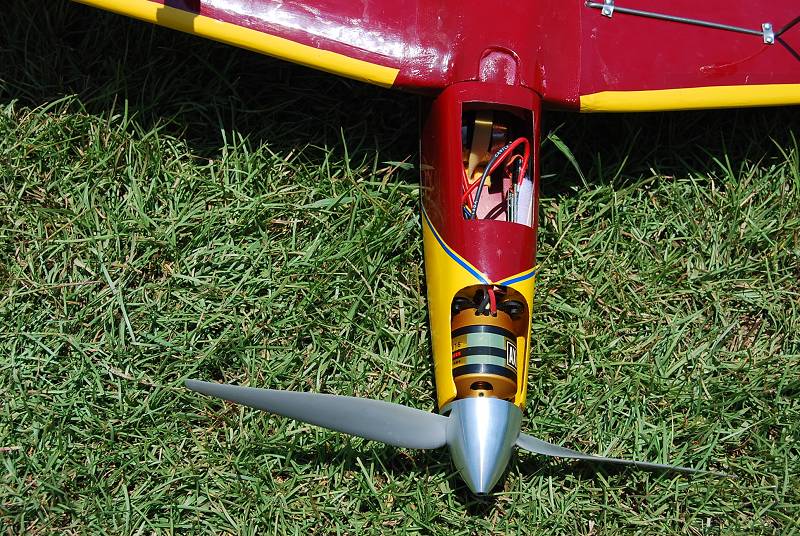

I have built and currently fly 3 different classic planes; Super Kaos, Phoenix 7 and EU1a. There is a thread here on the EU1a. I'm about to start on a Curare, an MK kit. The biggest challenge is finding room for the battery, and having enough battery to complete a full sequence, assuming you are looking to compete. The Kaos and Phoenix are on 5s 5000 mAh and the EU1 is 8s.
happy to answer any questions,
Dale

David, you hit the nail on the head, weight is the issue getting adequate flight times. I have no issue hitting realistic .60 size speeds with the right prop selection, but the power consumption goes up fast.
The 5s motor is a Scorpion 4020-8 with a KV of 790. On the light weight Kaos, I used a 12x6 prop and was pulling only around 50A, but the Kaos is not really a ballistic design. Same motor in the P7, which is an ARF and a little heavy, I used an 11x8 prop. It was plenty fast, faster that my buddiy's P7 on a piped 60 (albeit with a fresh battery) but flight times were much reduced, pulling up to 80A.
The EU1 has surprised a lot of skeptics now, with it's performance. I don't know the real speed, but the calculated pitch speed is 130 mph. It's the Scorpion 4025-10 with a KV of 525. I'm using an 12x8 for the best compromise of speed/thrust. For all out speed, I have tried an 11x10, which has a pitch speed of 150. With the 12x8 I'm pulling 80A static.

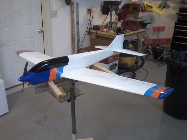

i just converted an old SL1 to electric. This plane is not in the ballistic category, but I wanted to test out a Neu motor that I have. It's 515KV 3000W and I used 8s. I'll be flying it with a non e APC 11x13, which should scream. If this works out, I am planning on this motor in another EU1.

I copied Doug's power set in a Calypso and it worked perfectly. A friend has a Calypso with a Hanno special in it, piped naturally. On the ground we turn the same RPMS with the same prop. ( Either a 12X11 or a 13X9). I've flown both and the flying experience is very similar, but I suspect the OS 61 unwinds a bit more in the air than the Hyperion 4024-10 on 6 cells. I don't have empirical evidence for that, but it seems so.
