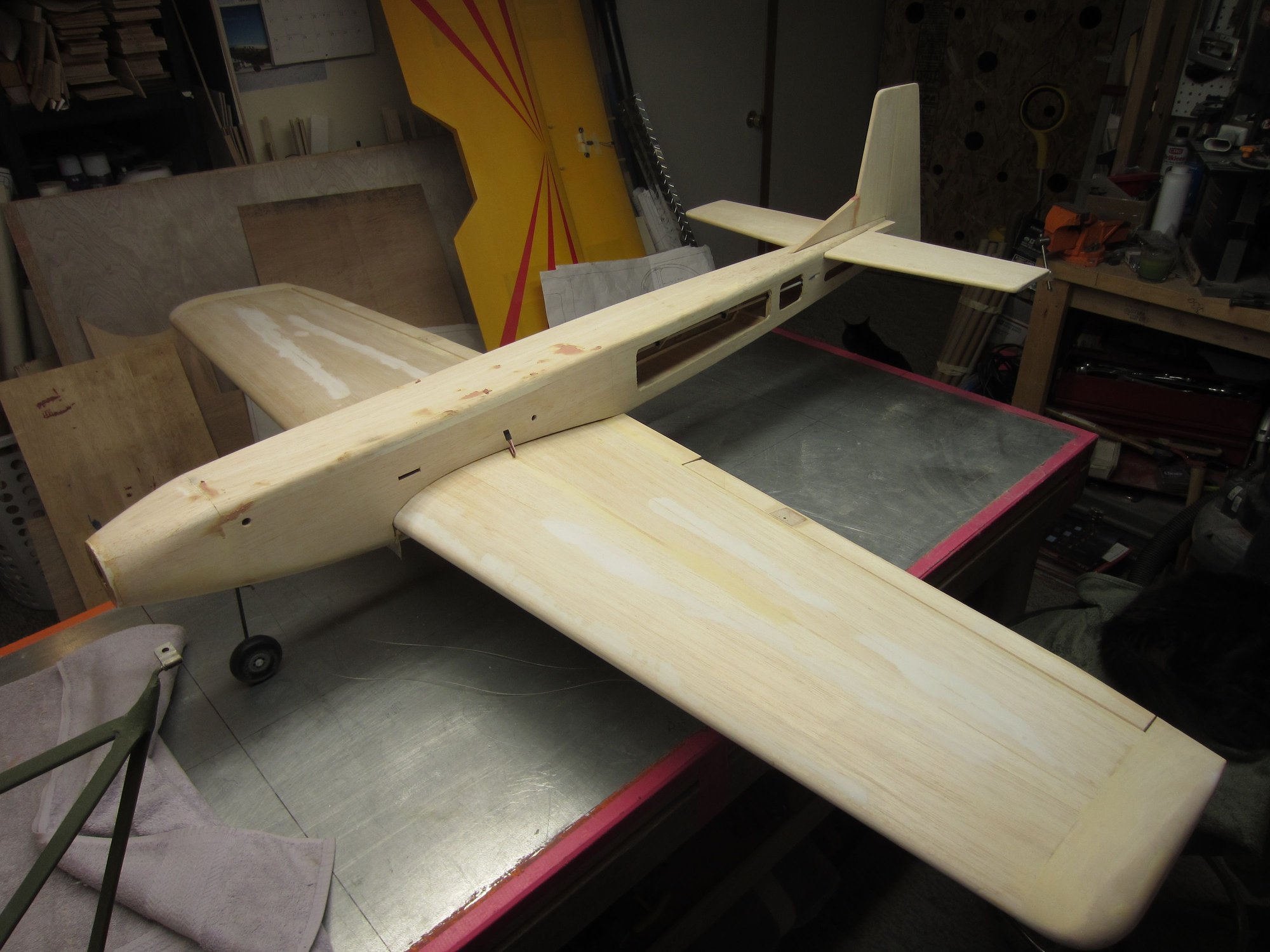

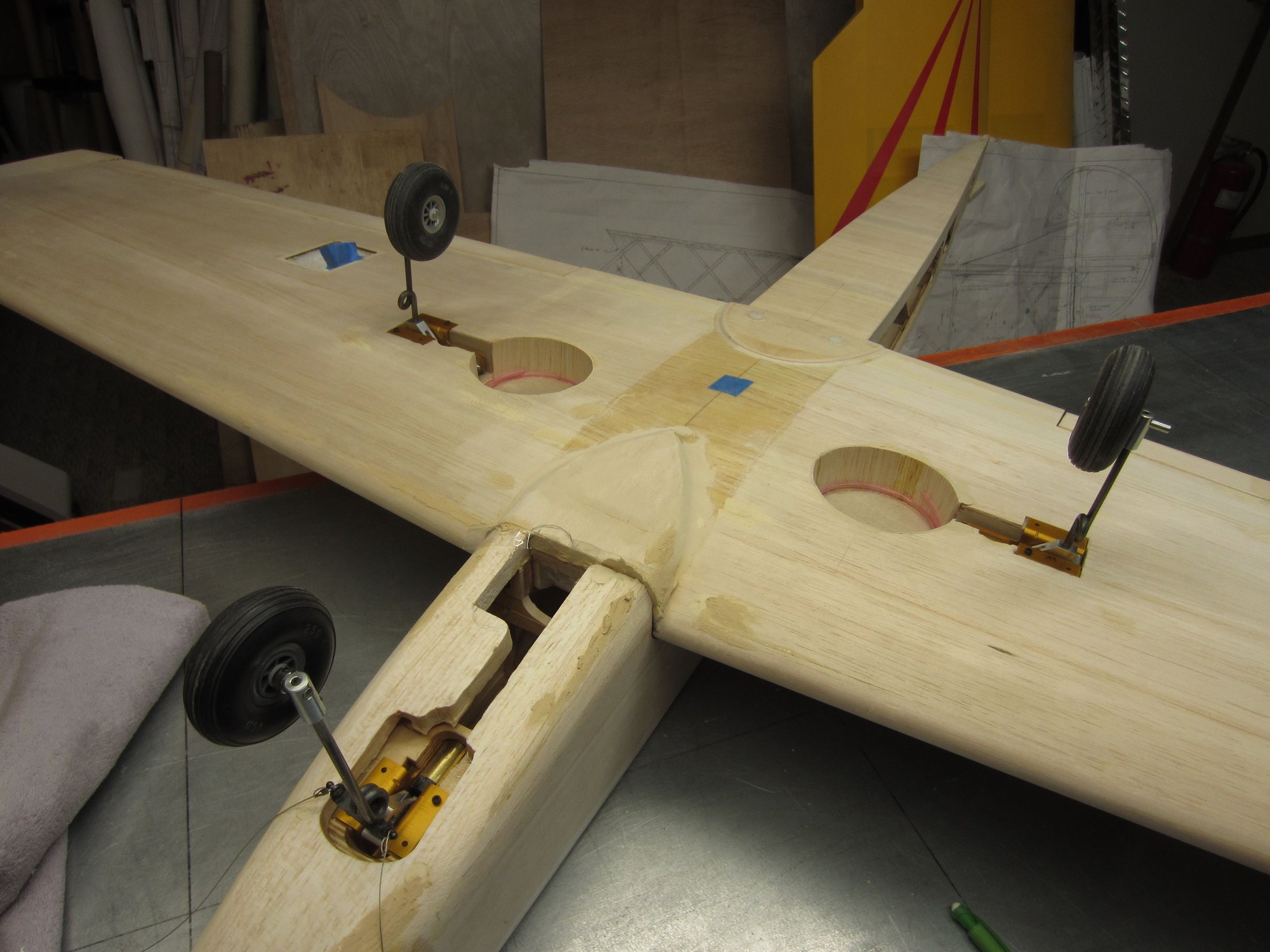

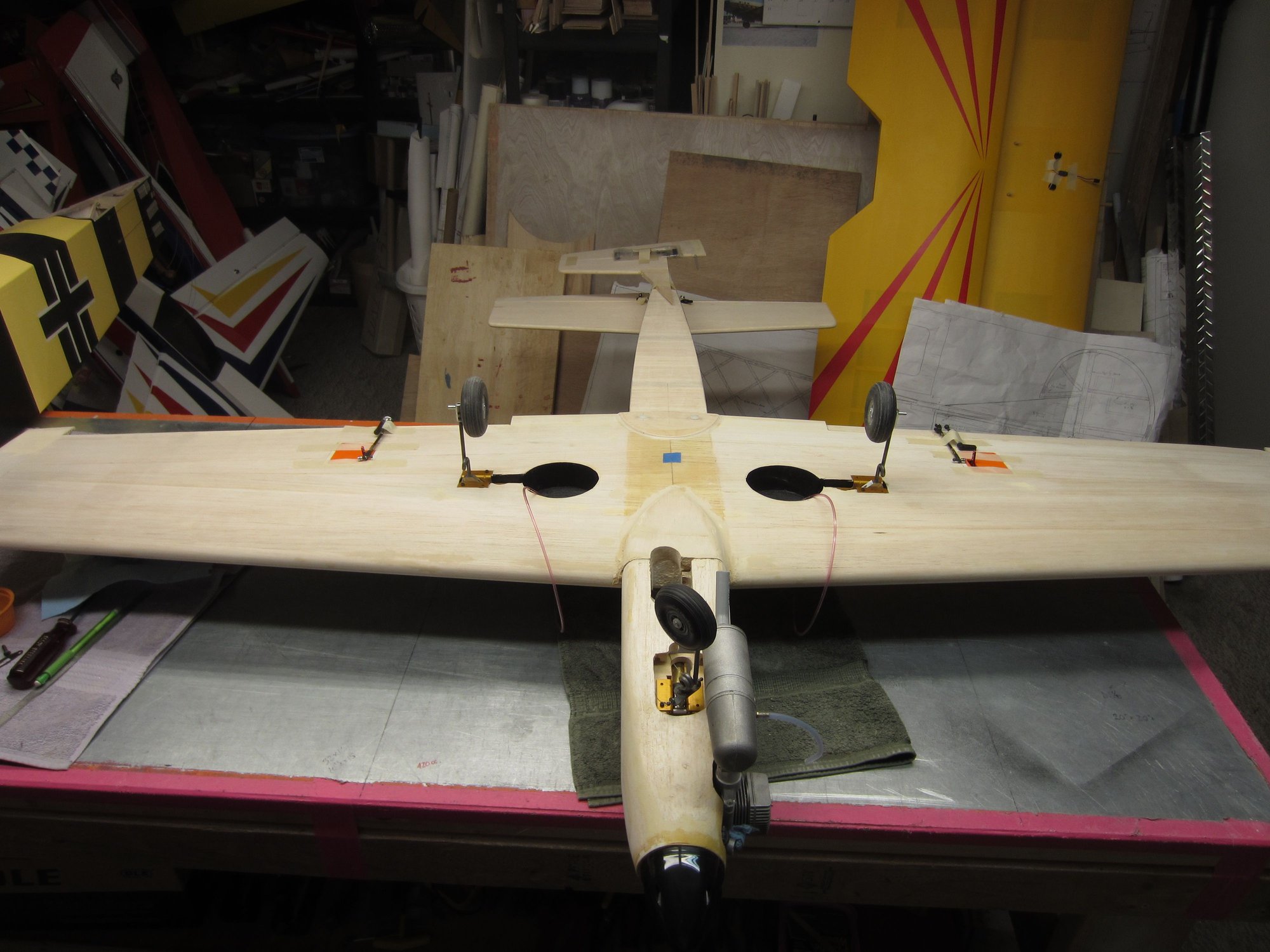

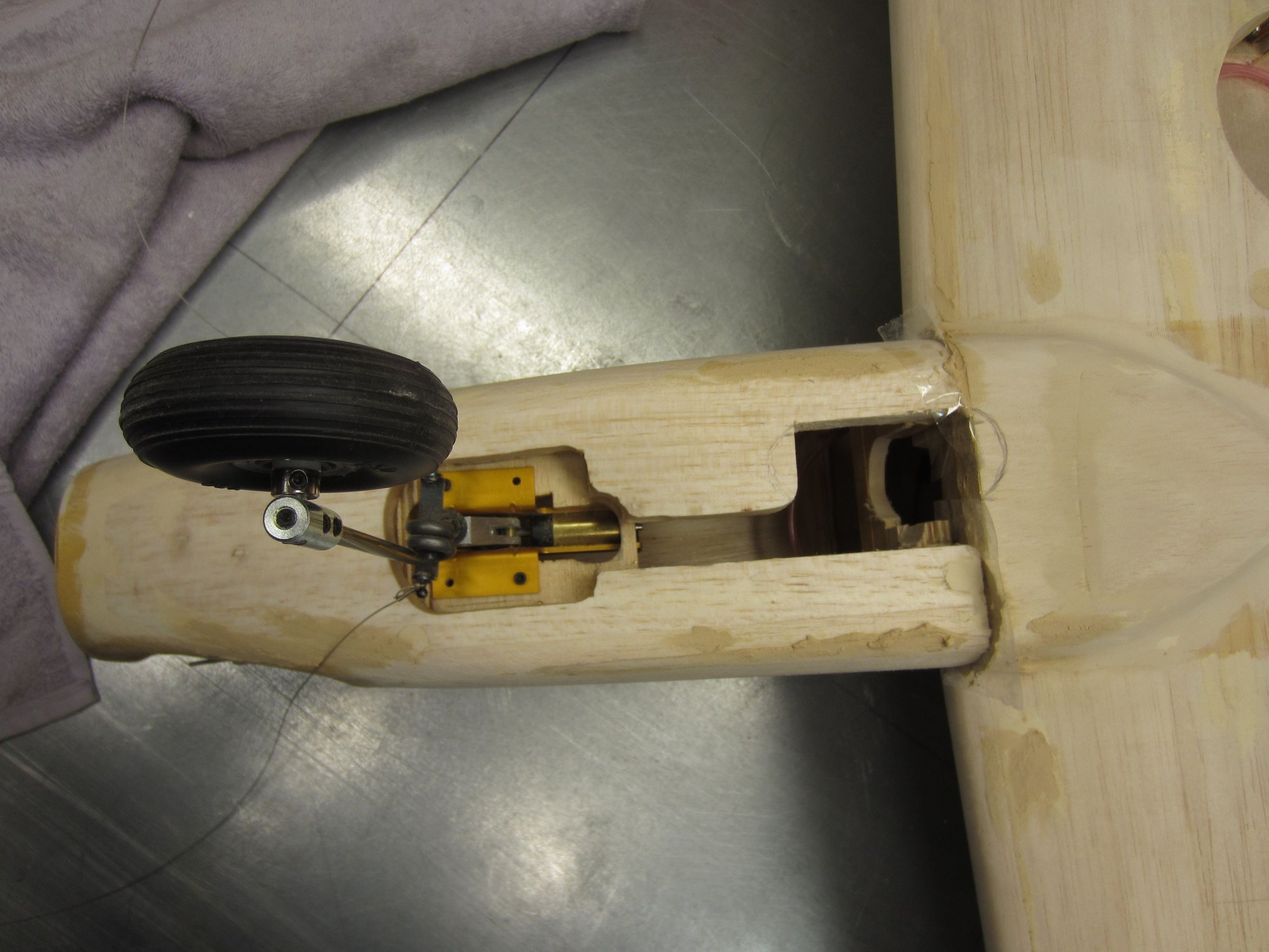

So here's a few photos of the progress so far. Everything mocked up, with the gear bolted in. I'm still adjusting the fit of the nose gear, but now have it just about right.

MarkD 04-17-2021 08:37 PM

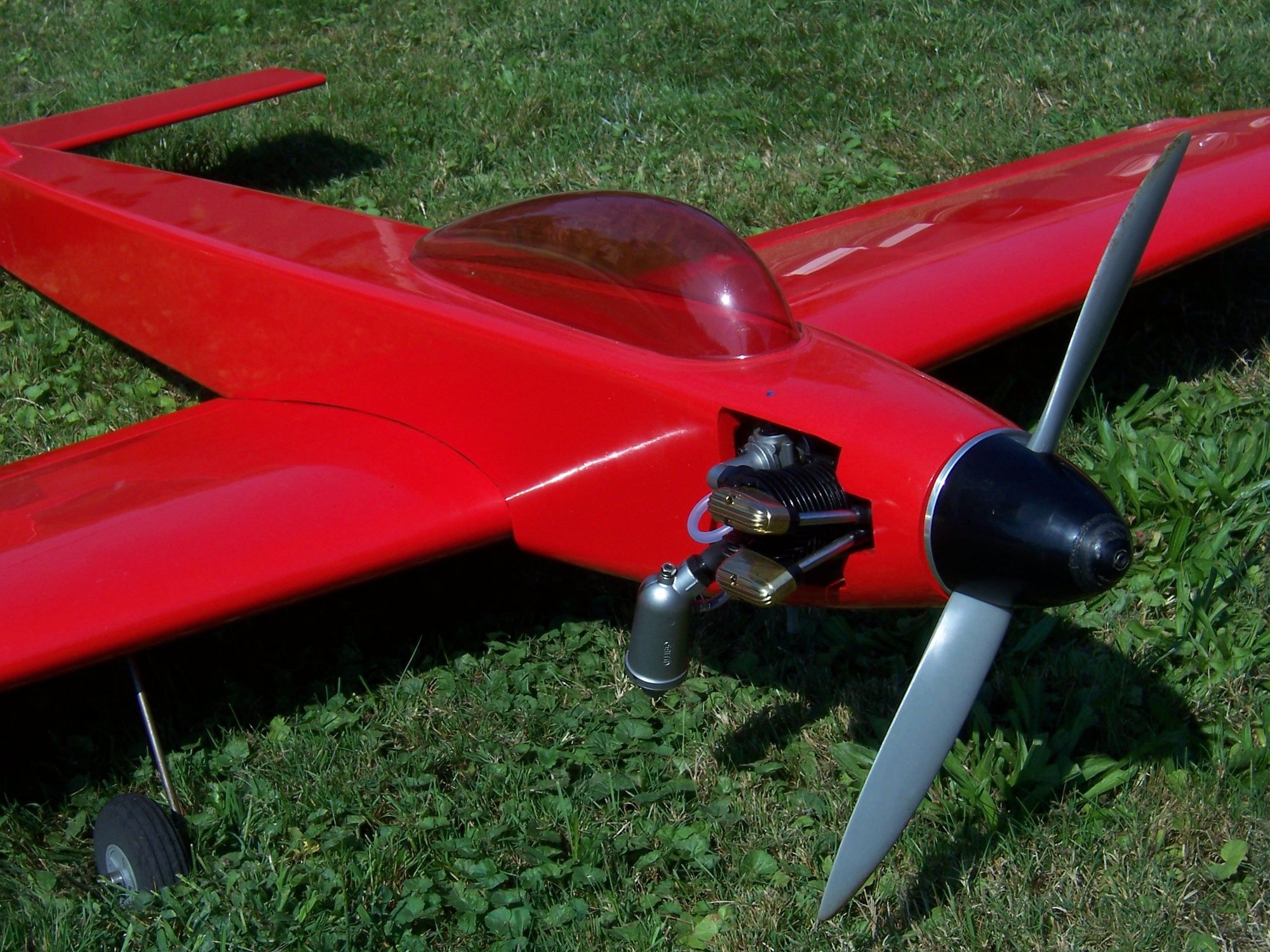

I built one in this size as a tail dragger with a Saito 180 FS back in 2003.
Mine was very heavy, but still flew very well.
You will like this plane.
Best of luck.
Mark D

Yesterday I put all of the pieces roughly in place so I could get a sense of the CG. I was pleasantly surprised to see that it needed some tail weight. This allowed me to move the elevator servos from the wing saddle area back to the tail, and do away with the solid wire pushrods and tubes that I had in there. I have the rear servo mounts in place now, waiting for the glue to dry.

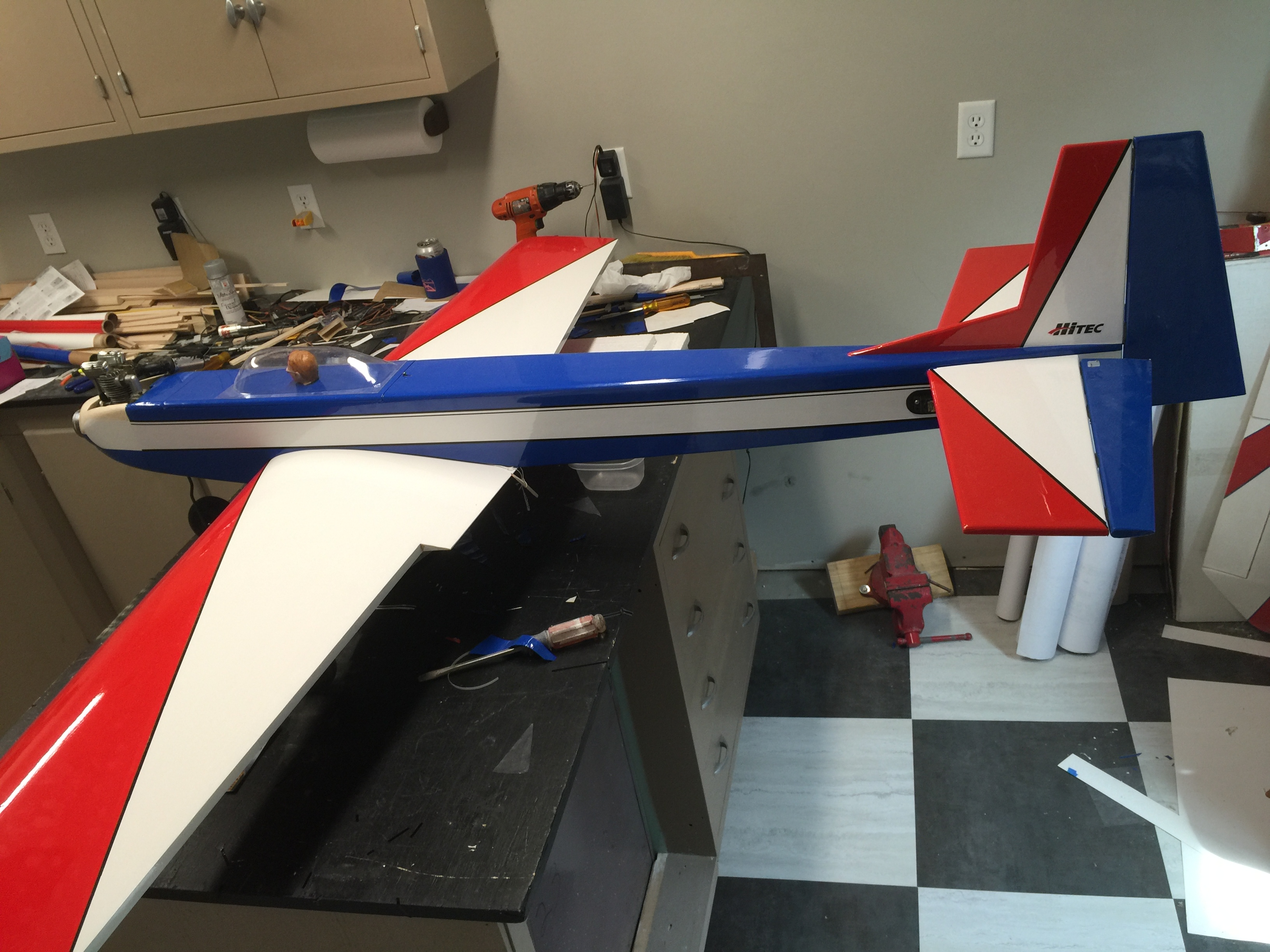

MarkD 04-18-2021 11:39 AM
By memory it was something like 12.5 lbs.- that thing was a tank.
The Saito would hover it, but there wasn't enough extra power to try it at low level.
I set my radio up to use the flaperon function (including mixing in a touch of down elevator). Made landings
a joy. My main gears were set 1 rib bay outboard from the original plans. Best ground handling plane I ever had.
Getting the elevator servos back to the tail is a good thing, much more solid than with pushrods.
It flew like a regular Kaos, but was a bit smoother in wind. The throttle response of that old Saito was unbelievable.
I still have a copy of my drawings posted on the bulletin board in the office with notes on how get at least 2 lbs out of it.
Maybe someday I will redraw them. The prototype has been waiting for the rudder to be re-attached to the fin since 2005.
How time flies.
Enjoy!
MarkD

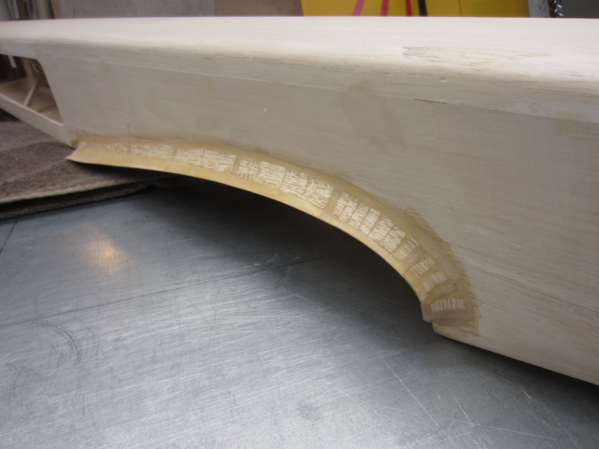

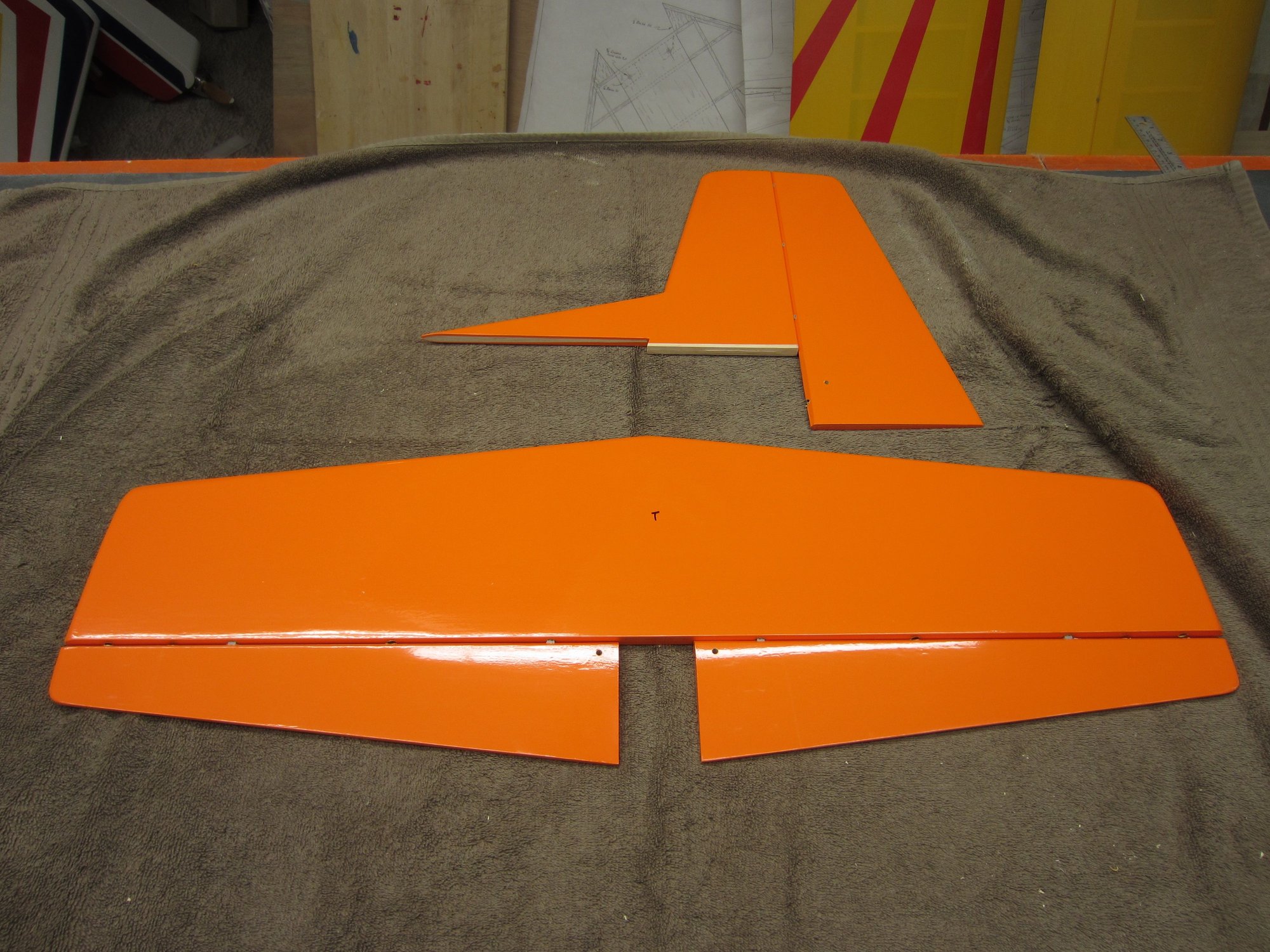

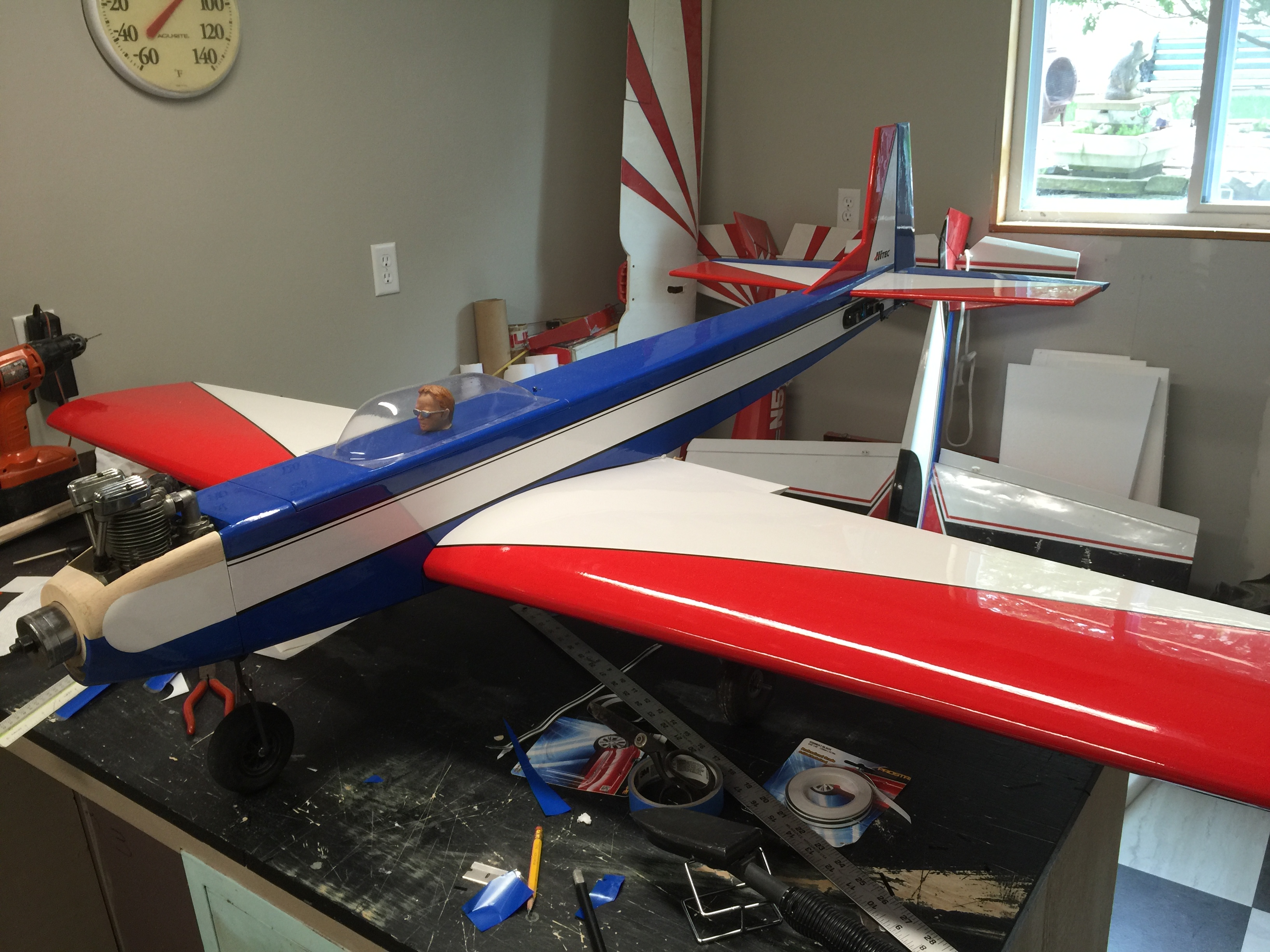

So, I have a bit more progress to show. I built the fillets for the wing roots, and got them all smoothed up nicely. Next, I started the covering, just the tail feathers so far. I'm using orange Chinacote to match my two existing Kaos planes.
