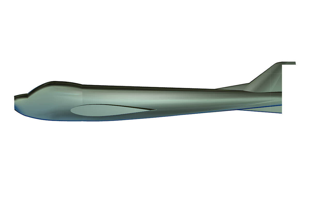

We want tolet you know in this forum: We decided to enhance the structural design and theproduction process of this classic ARF.
Many thanks to all who are interested in theproject.Such kind of an ARF project isnot an easy one - and needs its time.
The electric prototype had been test-flownsuccessfully, but we had our factory build also the glow version prototypebefore we would commission a production run - fortunately.Three weeks ago we finally got the glowfuselage. Checking it revealed some problems in accomplishing both an electricand a glow version – as I said: it's not easy.
We wanted the same fuselage design for bothversions, only the turtledecks may be different.But the glow version needs a much more ruggedfuselage than the electric version. Another problem is how to design thefuselage nose so it can accommodate different glow engines and electric motorsalike.
A fixed turtledeck is a less than perfectsolution since it should be easily detachable at the field. The existing designwas not good enough in our eyes, as was the whole fuselage structure which wasnot as rugged as needed for the glow version. Besides, the exhaust blowing overthe Ultracote covering would make the fuselage look awful after a few flights.
After a lot of pondering and discussing we nowdecided for a fiberglass fuselage.Todaywe finished the CAD design and next week we will mill the plug.
The built-up wings and tails from our"wood factory" are no problem, their quality is excellent. Coveredwith Ultracote (German: Oracover), the wing halves and tail feathers are justabout perfect.
Fuselage production will begin soon. It willbe a convenient ARF fuselage, ready for easy R/C and drive installation.

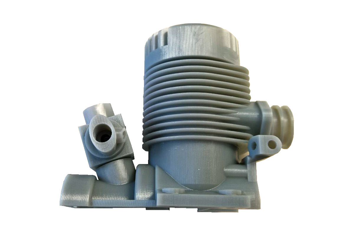

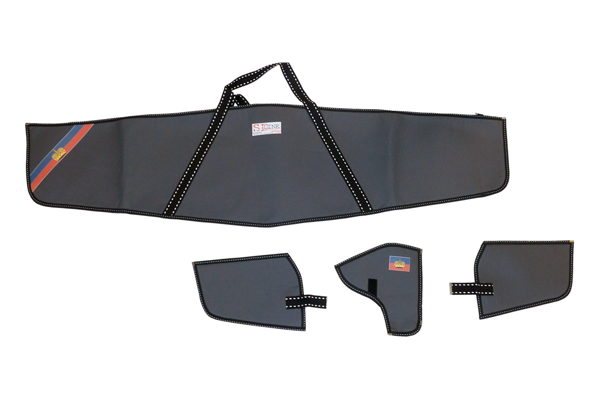

As an accessory we can offer a 3D-printeddummy Webra 61 Racing. Our ‘Made in Italy’ wing bags are just finished.
