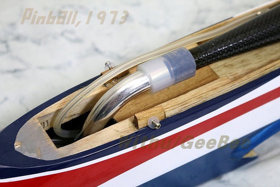

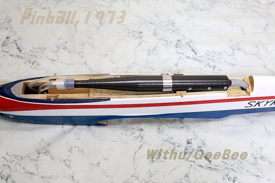

JHMIN 06-25-2021 12:35 AM
Rear exhaust parts for SKYMASTER 20
https://cimg4.ibsrv.net/gimg/www.rcu...2d2ddb09ac.jpg
ASANO carbon pipe & HATORI tuned pipe
https://cimg6.ibsrv.net/gimg/www.rcu...7810207e50.jpg
https://cimg7.ibsrv.net/gimg/www.rcu...afd32ae6ed.jpg
ASANO CARBON PIPE + SILICON TAIL PIPE = 48 g ( 1.7 oz)
HATORI TUNDE PIPE + HATORI TAIL PIPE = 112 g ( 3.95 oz)
I had no choice.
But the carbon pipe was little longer for skymaster 20,
so I decided to drill a hole in the part F21.
https://cimg2.ibsrv.net/gimg/www.rcu...bca701a2b8.jpg
https://cimg1.ibsrv.net/gimg/www.rcu...ce0afc9a0a.jpg

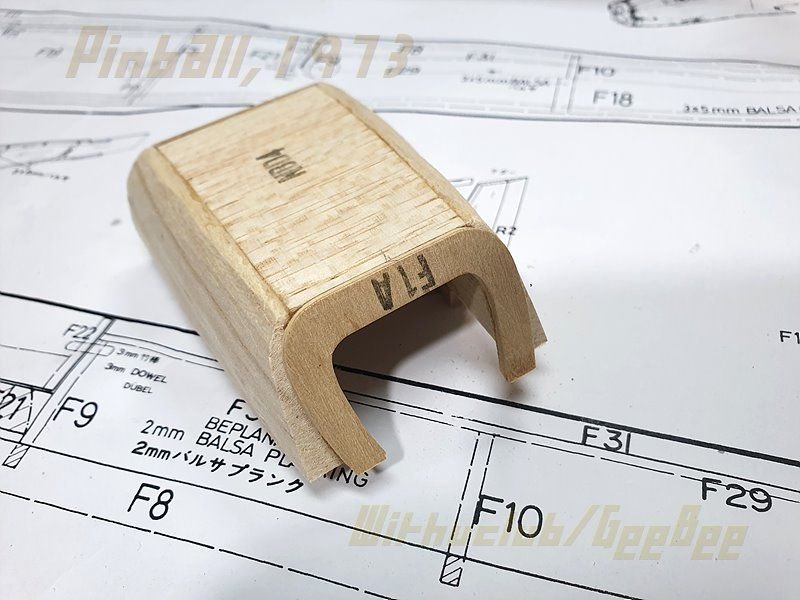

JHMIN 06-27-2021 11:48 PM
Fuselage assemble
https://cimg0.ibsrv.net/gimg/www.rcu...7b1c218c9f.jpg
under cowl
https://cimg1.ibsrv.net/gimg/www.rcu...60b6c29381.jpg
under cowl

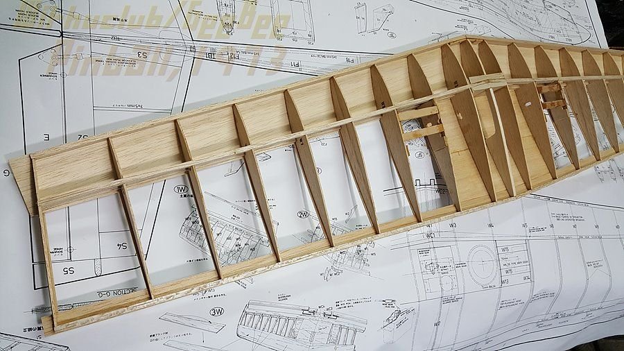

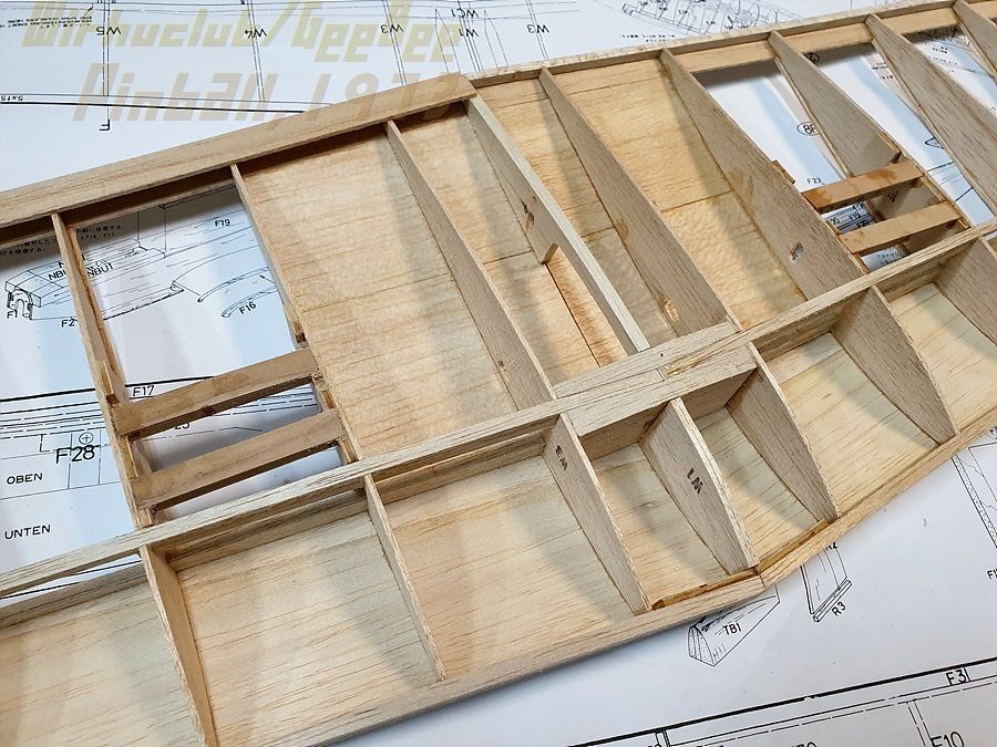

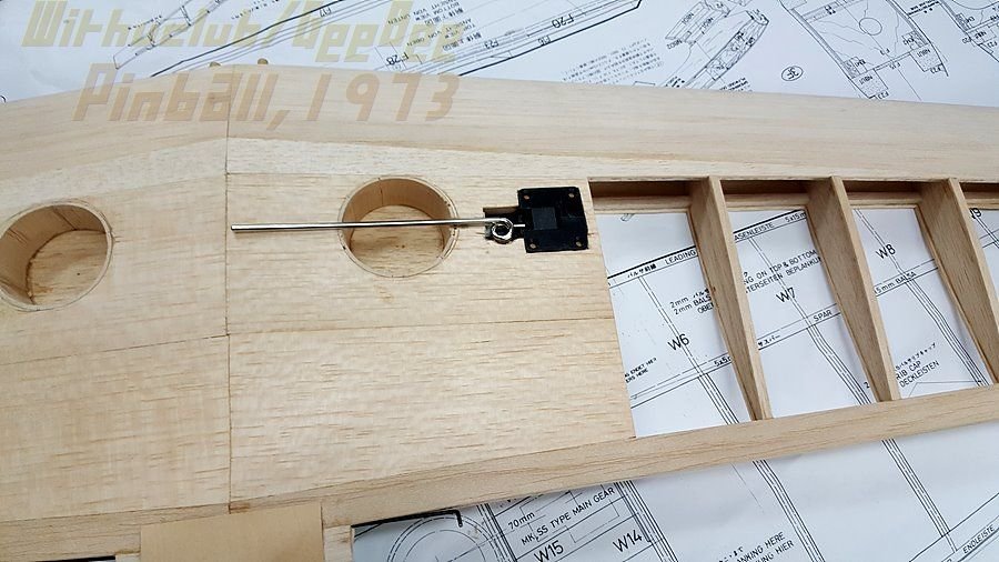

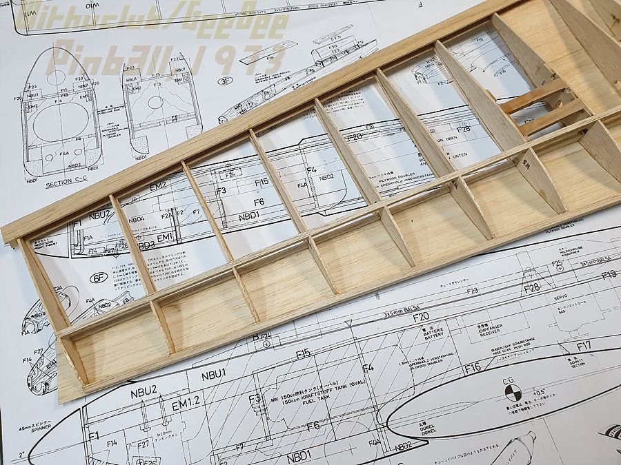

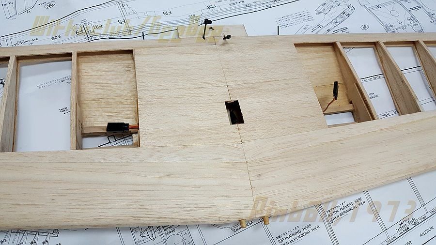

JHMIN 07-20-2021 01:00 AM

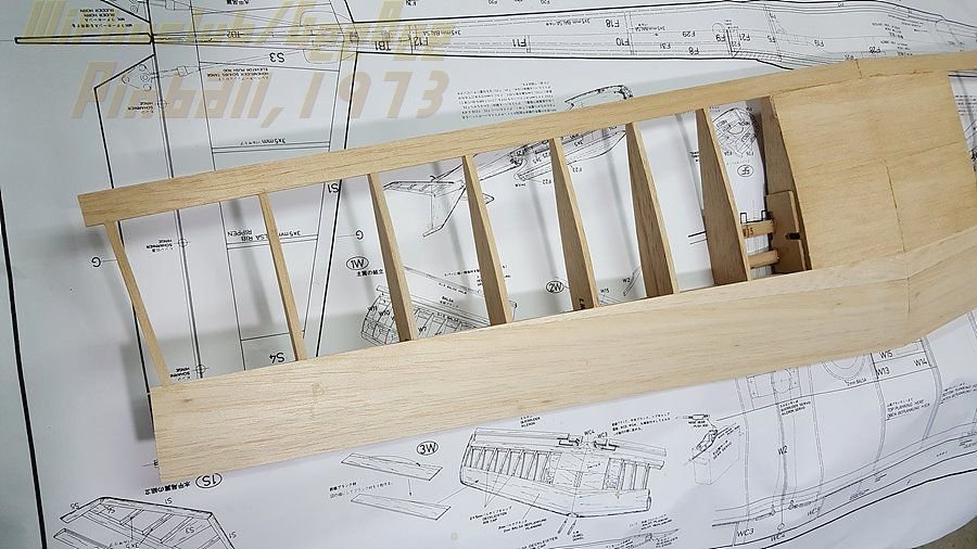

Main wing assemble
Main wing assemble
https://cimg9.ibsrv.net/gimg/www.rcu...17cba8230e.jpg
https://cimg1.ibsrv.net/gimg/www.rcu...82f8e12fcb.jpg
https://cimg6.ibsrv.net/gimg/www.rcu...285ddaa302.jpg
https://cimg7.ibsrv.net/gimg/www.rcu...507bfd23d0.jpg
https://cimg3.ibsrv.net/gimg/www.rcu...7b55d4e855.jpg
https://cimg8.ibsrv.net/gimg/www.rcu...fb1202c6d0.jpg
https://cimg2.ibsrv.net/gimg/www.rcu...ee0d3e8647.jpg
https://cimg4.ibsrv.net/gimg/www.rcu...f05496c3a0.jpg
https://cimg4.ibsrv.net/gimg/www.rcu...4c85c8de36.jpg
https://cimg5.ibsrv.net/gimg/www.rcu...d9643c3d40.jpg
https://cimg5.ibsrv.net/gimg/www.rcu...97c750901b.jpg

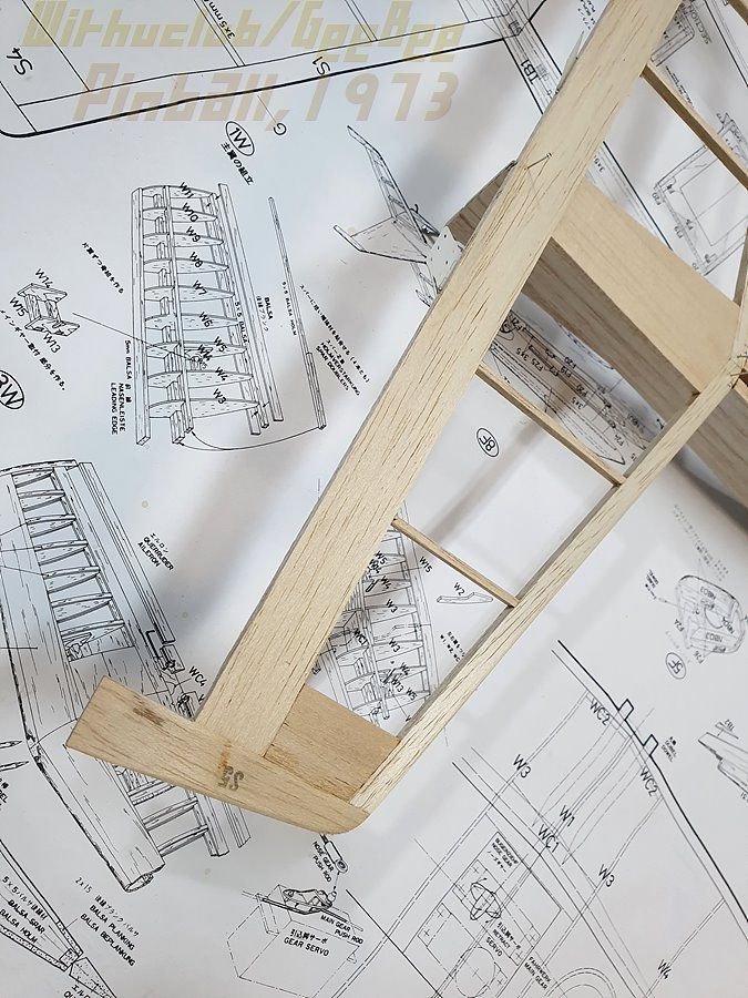

JHMIN 07-20-2021 11:55 PM
Horizontal & vertical stabilizer
https://cimg8.ibsrv.net/gimg/www.rcu...7cd1d22533.jpg
https://cimg9.ibsrv.net/gimg/www.rcu...fa7bd24622.jpg
https://cimg7.ibsrv.net/gimg/www.rcu...ca910fae2a.jpg
z

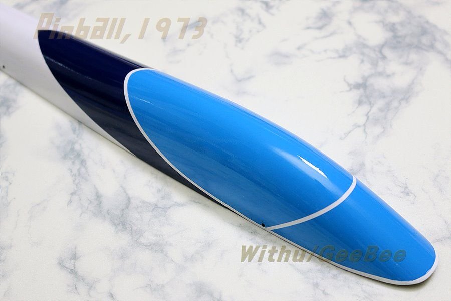

JHMIN 07-22-2021 11:47 PM
top turttle painting
tamiya surface primer painted
https://cimg2.ibsrv.net/gimg/www.rcu...a4ad7a50a1.jpg
https://cimg1.ibsrv.net/gimg/www.rcu...4399f646c3.jpg
https://cimg0.ibsrv.net/gimg/www.rcu...ffbb3ac548.jpg

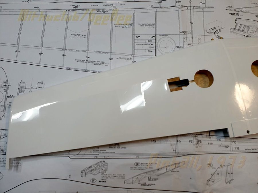

JHMIN 07-22-2021 11:56 PM

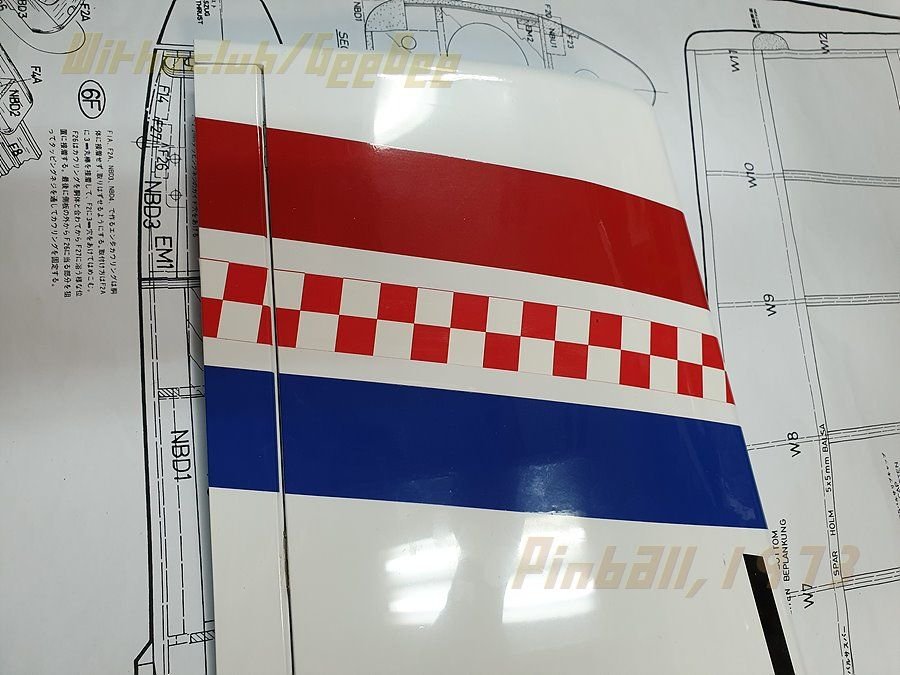

main wing covering
oracover covering
https://cimg8.ibsrv.net/gimg/www.rcu...2f840da72e.jpg
https://cimg9.ibsrv.net/gimg/www.rcu...929b329cf1.jpg
https://cimg0.ibsrv.net/gimg/www.rcu...5b1b78a2f4.jpg

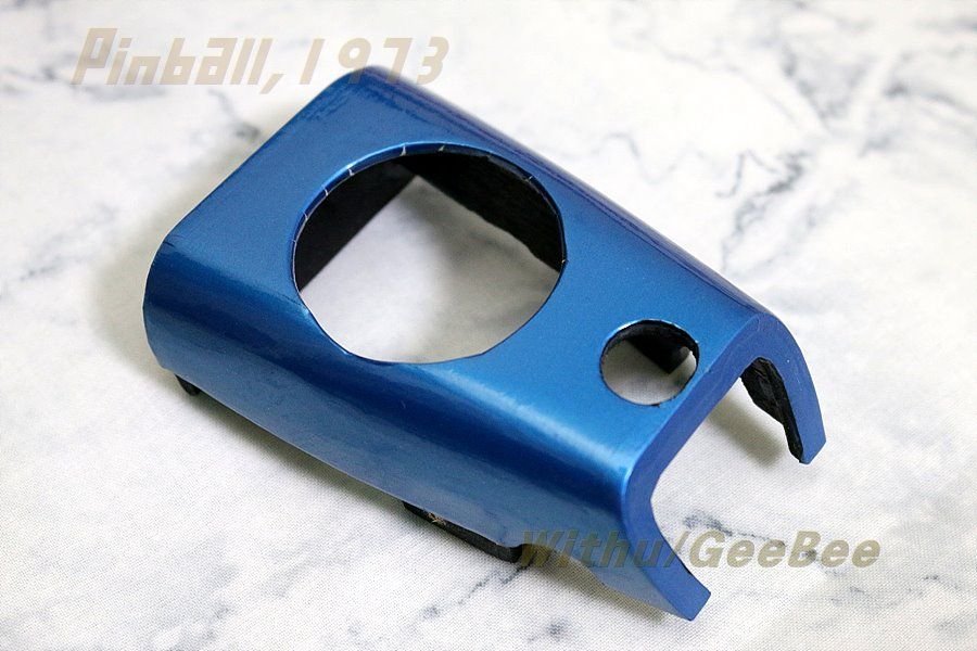

JHMIN 07-23-2021 12:08 AM
under cowl covering and fuel proof painting
https://cimg1.ibsrv.net/gimg/www.rcu...8a81d61364.jpg
https://cimg2.ibsrv.net/gimg/www.rcu...67862b980b.jpg

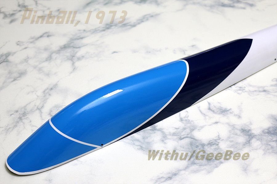

tamiya ps spray & urethane clear coat
https://cimg7.ibsrv.net/gimg/www.rcu...9f8c08142d.jpg
https://cimg8.ibsrv.net/gimg/www.rcu...8022e1f7ae.jpg
https://cimg9.ibsrv.net/gimg/www.rcu...60d4b4da72.jpg

JHMIN 07-27-2021 12:09 AM
exhaust system
https://cimg1.ibsrv.net/gimg/www.rcu...e60957b812.jpg
https://cimg2.ibsrv.net/gimg/www.rcu...1805016509.jpg
https://cimg3.ibsrv.net/gimg/www.rcu...e05484ba13.jpg
https://cimg4.ibsrv.net/gimg/www.rcu...8a5342d9e8.jpg
carbon extended pipe
