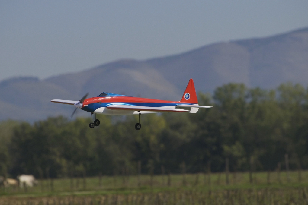

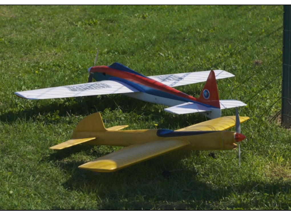

gghisleri 11-01-2016 11:00 AM
3 Attachment(s)
My electric Banshee, completely scratch built.
http://www.rcuniverse.com/forum/atta...mentid=2188451http://www.rcuniverse.com/forum/atta...mentid=2188452http://www.rcuniverse.com/forum/atta...mentid=2188453
Banshee at rest with UC electric Cobra by Steve Wooley.
