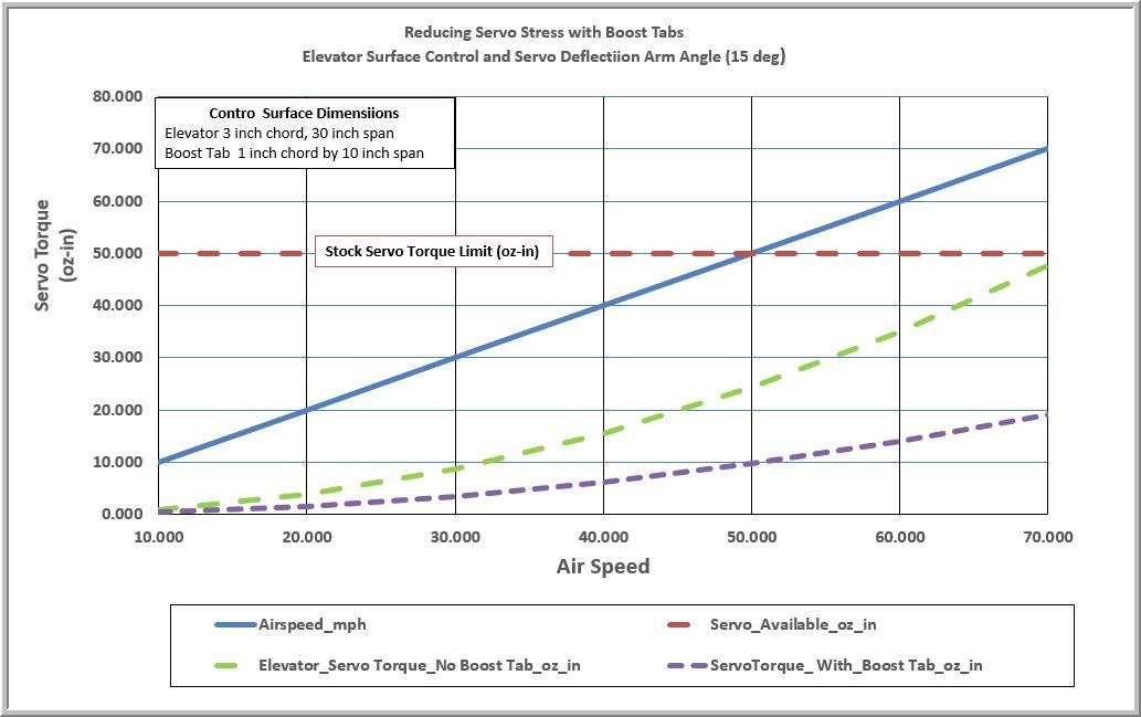

This plot estimates elevator servo torque with and without a boost tab.
It shows how airspeed, surface size, deflection angle, and linkage geometry affect servo load.
The goal is to check if your servo has enough strength and how much relief the tab provides.
Comments would be appreciated
