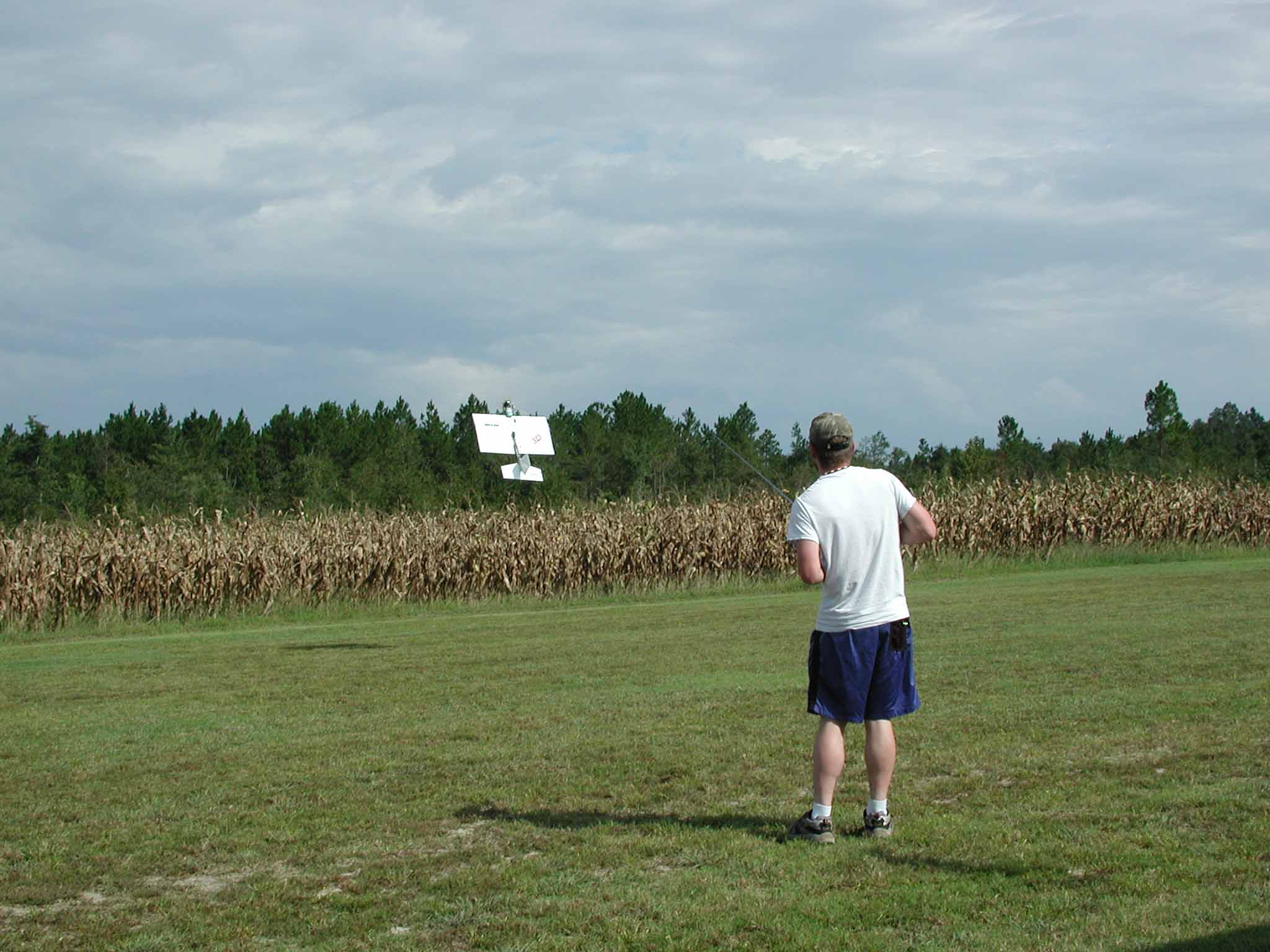

Posts: 162
From: GA
spadtothebone.com is a good site for making them. I build them and sell them locally at funfly events. I am looking into the logistics of selling an ARF version online. Since that airplane in the photo (the prototype) I have found a Jam up way to cover them with vinyl lettering material. The kits would be pre covered and predrilled. The buyer would just have to scew in the scews required to hold the wing and tail on and put the engine mount bolts in. Of course no radio gear or engine would be provided or installed. The only thing holding production for the net off is finding a good reliable source for landing gear. All of the gear that are on my modified qhors and spa3d's are custom built and are VERY VERY LIGHT!! I havent been including gear on the planes I have been selling but I listened to the guys buying them and not buying them and landing gear seemed to be a big issue. My only other issue is a box to fit the odd shape. I would need something like a box that posters are shipped in, being as its back to school time I shouldnt have a hard time finding that.
