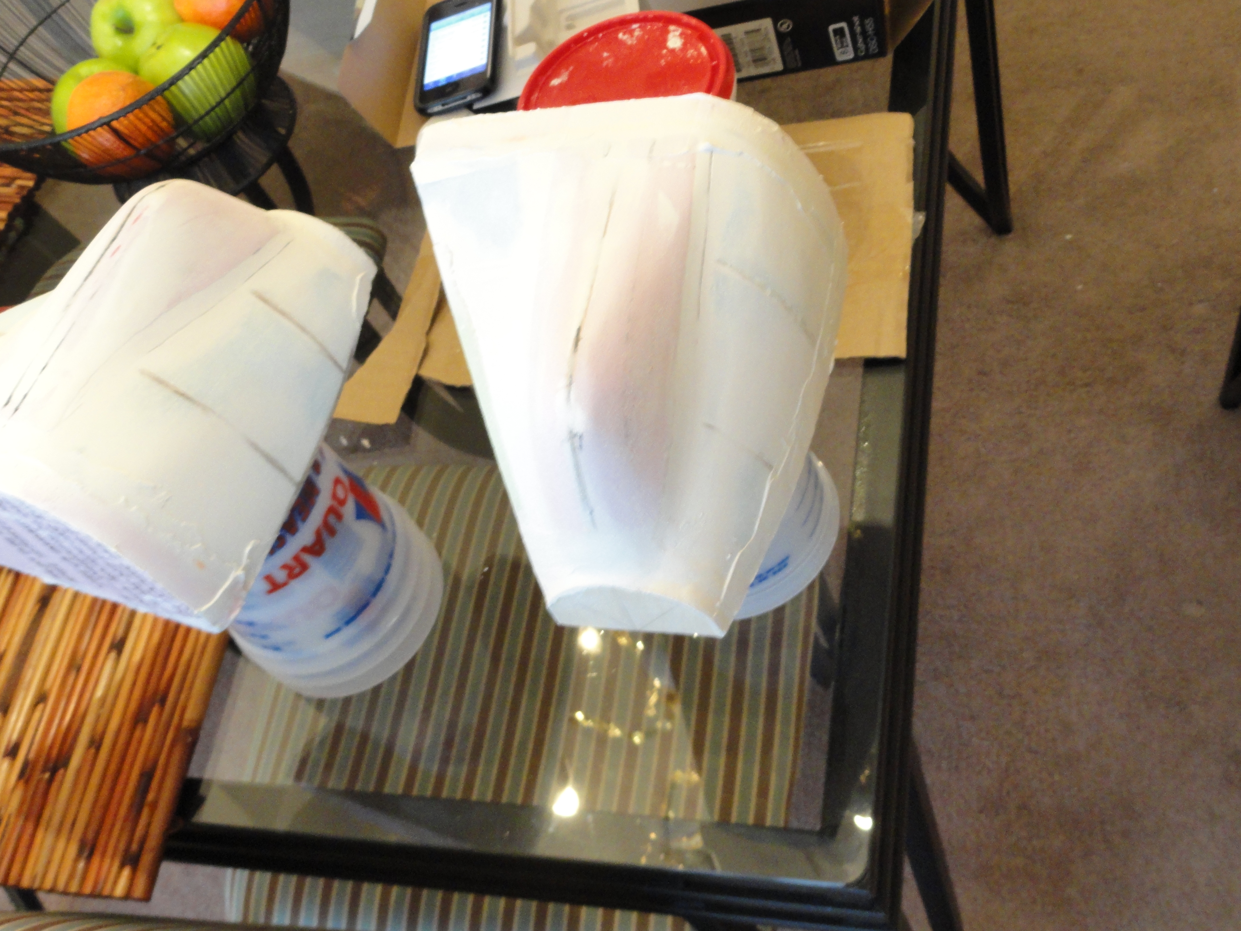

My Feedback: (11)
Joined: Jul 2003
Posts: 269
From: Eugene,
OR
here are some pics of my plugs and the plane that they are for.
I am ok with the wood but when it comes to paint and glass work i get stuck.
Been sending all evening, there is one spot on the plug that paint does not cure so i had to get it off again and sprayed a light coat
it has been cold here so i dont know if that may have something to do with it

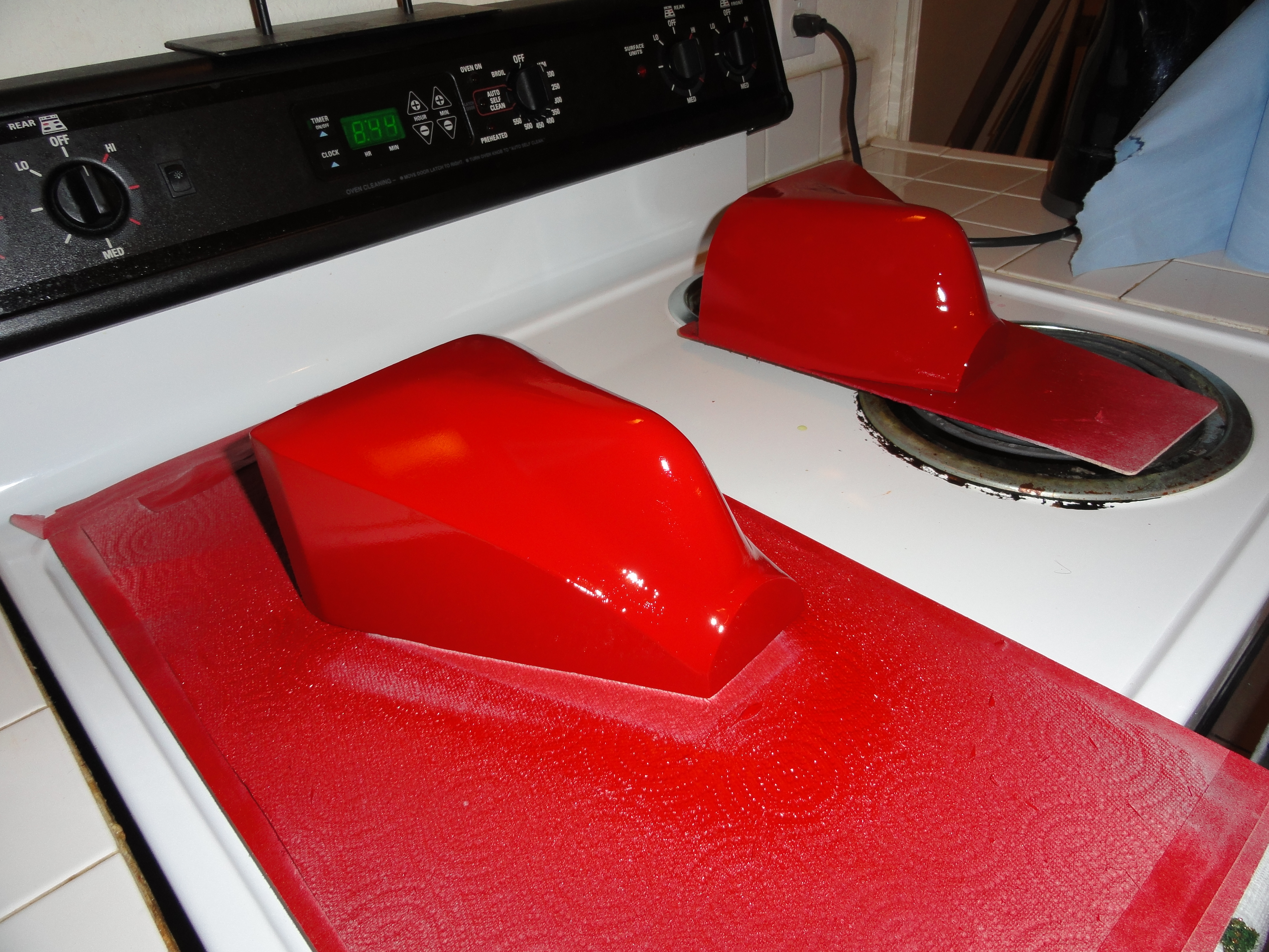

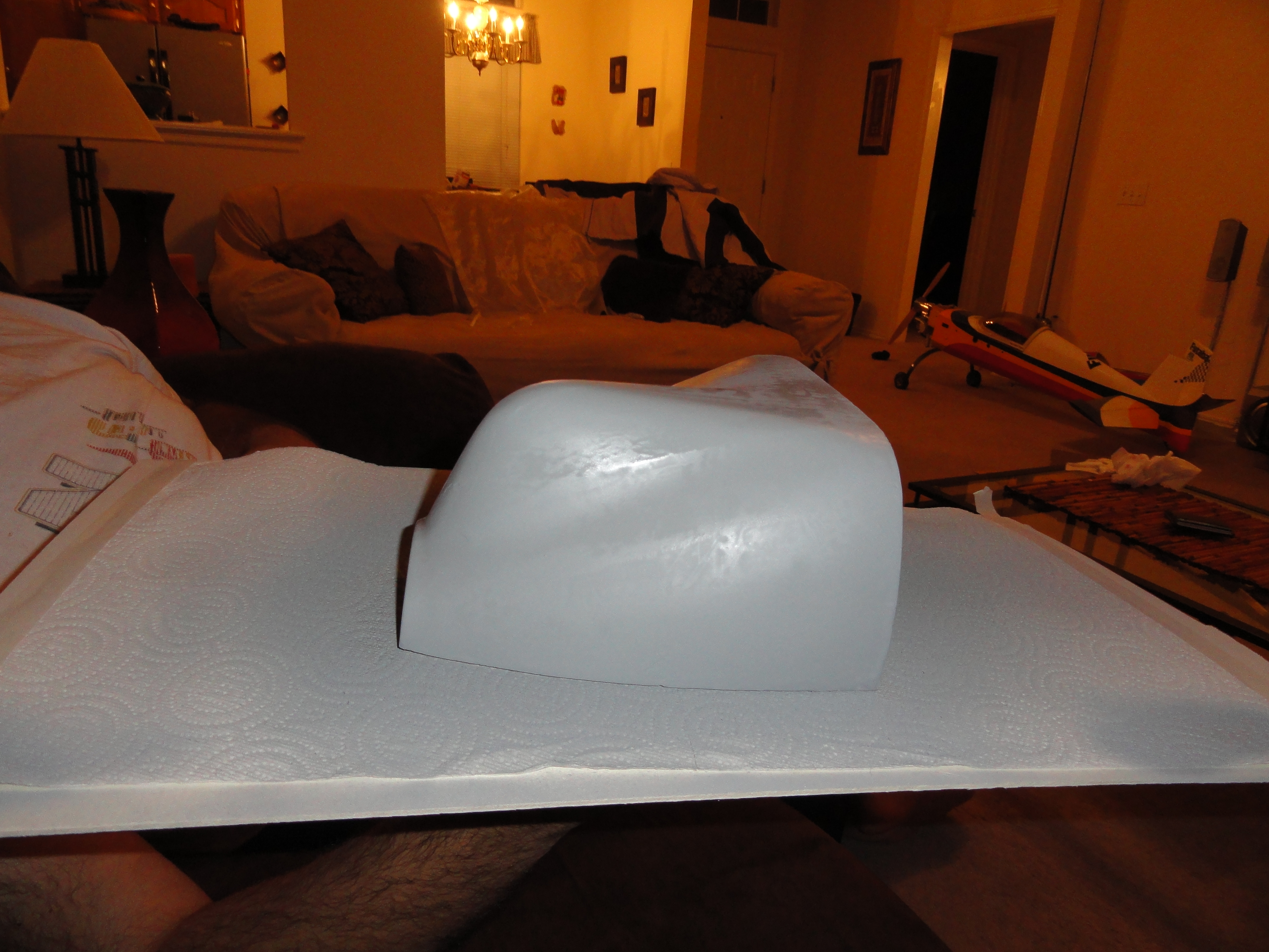

My Feedback: (11)
Joined: Jul 2003
Posts: 269
From: Eugene,
OR
i got the molds done and got some parts done I will post some pictures soon,
the tooling layer came out great and the whole thing is good only I had little issue with releasing the plugs. damaged the plugs to get them out.
how do you wax and pva the plug?
I put on 3-4 layers of wax ( one min dry time and buff on each layer)
after 4 coats i let dry for 30 min and spray pva. Let the pva dry for 1 hour and start layup
