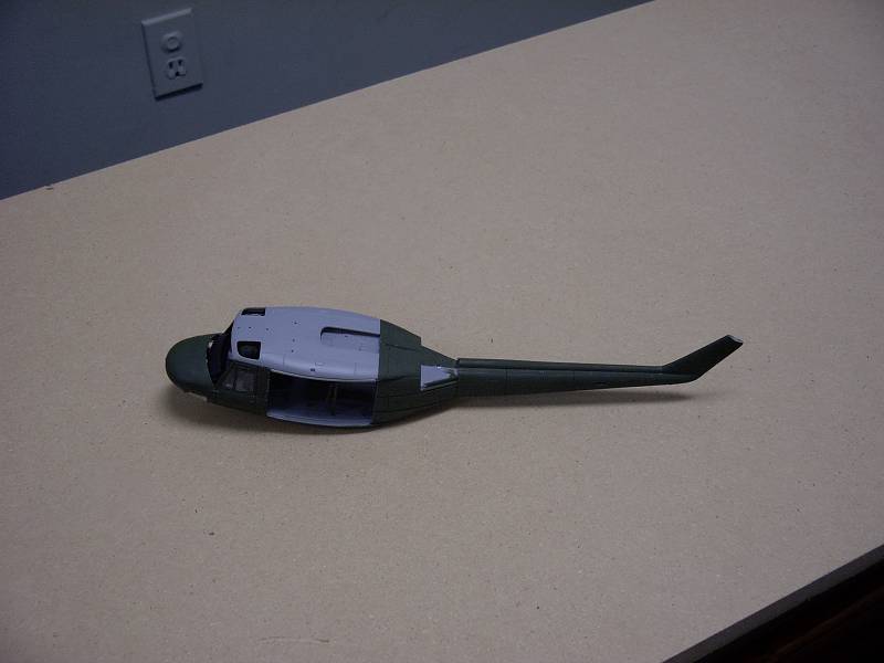

Thus the project begins. The first thing I like to do when I am building something like this is to go to the hobby store and pick up a model of the helicopter that I want to build. I use this model as a three dimensional reference. While 3D references are not always available, I do like to use them when possible. For this project, I selected a 1/35 scale UH-1. Using this model, I can get a good idea of the size that the fuselage has to be relative to the diameter of the fan blades in order to maintain a scale appearance.
I began to build the fuselage of the model and began to analyze the proportions, angles and curves of the copter. See the photo of the fuselage below.

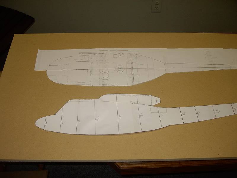

At this point, I can begin to produce profile drawings of the copter. I definitely need to start with a view from the top and a view from the side.
Some of this is accomplished through artistic ability and some of it is cheating. The model that I bought had these views in the painting instructions. Based on the diameter of the fan blades, I figured that the fuselage should be about 40 inches from nose to tail. I simply used my copier to blow these views up to the size that I need. Then I drew in some details that were lost in the enlarging process. See the photos below.

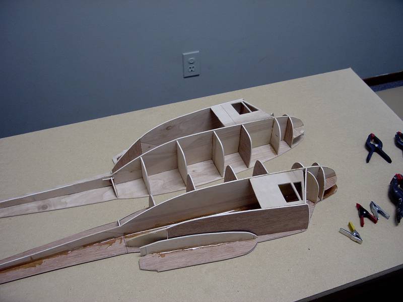

The next step for me was to trace these profiles onto a base that I can use to build a plug. I like to use 1/8 inch mahogany door skin for this. I like mahogany because I can buy it at home depot for cheap and one sheet is more than enough material for a project like this. In the photos below you can see the cut outs that I did in the door skin.
You can see that they warp a little. This warping is no big deal since I will easily straighten the pieces out during assembly of the frame. Next, I want to decide along which line to epoxy the primary horizontal shape to the vertical shape. Having access to my plastic model makes this decision easy. In the photos below you can see how I glue two pieces like these. Angle aluminum stock is easy to clamp the pieces to and assures reasonable alignment of the parts.
In addition to angle aluminum making alignment of not so straight pieces easier, it also gives a pretty good 90 degree alignment of one piece to the other.
At this point I need to make a statement concerning scale. I am no artist, I know from the outset of a project like this that when I am done, anyone who knows anything about helicopters is going to look at this and say “Hey, that’s a Huey UH-1â€. That is good enough for me. You can put as much talent and time as you wish into a project. This is your prerogative. I like to get a project’s detail to the point where I am satisfied. I think that I am usually satisfied with my projects bearing a close resemblance to the vision that I started with. That being said, nothing that I ever build will ever be completely scale (unless I happen to trip over a bucket of talent and patience)

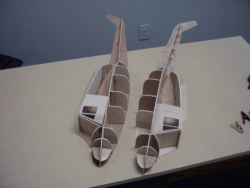

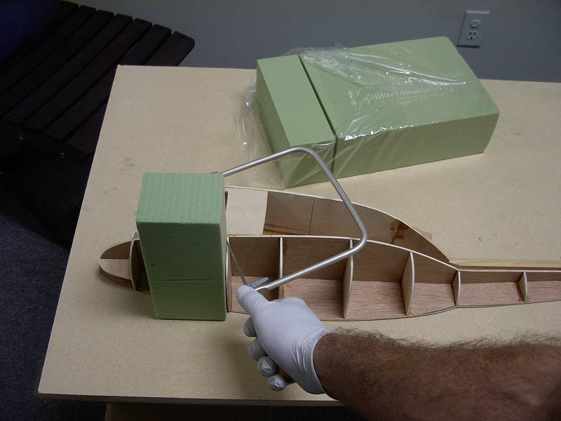

Now, I move forward with creating buck stations. A buck station is a guide that ensures that your plug is going to resemble what you want it to in the end. For this project I use the same 1/8 inch mahogany that I used for the initial profile pieces. My strategy for placement of buck stations is simple, I put one anywhere that I am concerned about maintaining the correct lines of my project. Usually I am of the opinion that more stations are better.
Another rule that I like when deciding how many stations to use is to make sure that my sanding block is longer than the span between the stations. I am going to fill the spaces between the stations with floral foam blocks and then sand the foam down to the level of the buck stations. The sandpaper will easily cut the foam down. If the sanding block is shorter than the distance between the stations it will create a depression in the foam. Not that a depression in the foam is enough to ruin your project, but it is enough to cause you more work in finishing your project.
In the photos below I have placed numerous buck stations on both sides of the copter fuselage. Make sure to measure all of these out when building a mirror image project. Another way to ensure symmetry of your project is to cut the buck stations for each side at the same time, if necessary, clamp the mirror image pieces together and smooth them with a sander to ensure identical shapes and epoxy the stations in place at the same time. These procedures keep you in focus and your project symmetrical.
With all of the buck stations in place, I can examine the two halves of this project for symmetry. It doesn’t have to be perfect, but it should be pretty close. Once I am comfortable with the symmetry, I can move on and start filling the two halves with foam.

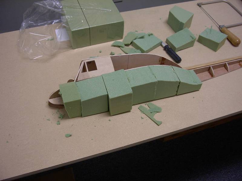

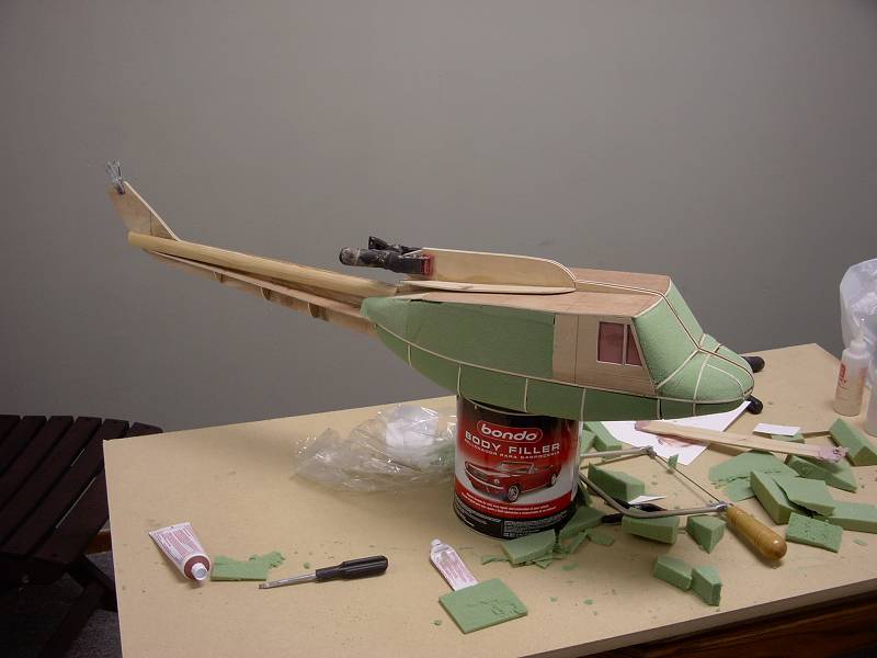

This post in the build of this copter is short because I had no time to write this weekend and I covered some of this in a mid week post. Moving on, filling the voids with dry floral foam is easy. I simply push the foam into the forms in away that gives the best use of each foam block. When necessary, I use an adhesive to secure the foam to the developing plug. I love using regular automotive bondo as an adhesive. It holds strong, cures fast and is cheap compared to epoxy adhesives. The photos below show the insertion of the first few foam blocks.
I like to rough trim the foam with a blade to make it easier to work with. Trimming can be done with a sawing motion using any type of serrated blade. Usually I use a hacksaw blade – I couldn’t find it so I used this coping saw instead.
I continue placing more foam between the buck stations. This is my breaking point for my first session of foaming. Kind of looks like a mess but I am right on track.

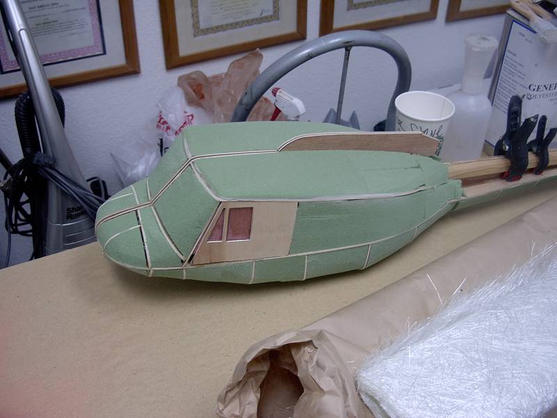

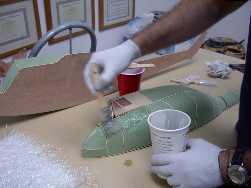

Here is some more on this tutorial, sorry it took me longer than I thought - pre holiday hang-ups. Sanding will make short work of this foam. I like to use a sixty grit paper on a block. One quick sanding session and this thing is really starting to look like a helicopter. I will continue placing foam in the voids until everything is filled and shaped. Continue filling with foam and sanding.
At this point, I will start to fiberglass over the foam. I have decided to hold off on forming in the turbine housing and the top of the tail section. My thoughts are that I would like to have something to place clamps on so I can check the alignment of the body halves during this next phase of the plug build.
I begin the fiberglassing process by using a brush (a cheap disposable brush is best) to cover the foam with catalyzed resin. I have decided that initially I will only do the main part of the fuselage and I will do the tail later. Once the foam has been soaked with a coat of resin (see picture below) I can start applying chopped mat over the foam.
I work the mat onto the surface of the fuselage. It must lay as flat as you can get it. I have spent a bit of time forming this fuselage. I don’t want to get sloppy at this point. Laying fiberglass mat over the foam will provide a nice hard surface for the next step of this build which will be the bondo application. Once the fiberglass has been laid, the only thing to do is let it cure. Time to put the chemicals away, clean up and let the resin cure.

It's interesting that you go right for the chopped mat instead of a 4oz cloth or something like that which I would think would give you a smoother surface. Is the chopped mat due to the complex shape?
Join Date: Aug 2006
Location: San Diego, CA
Posts: 106
RE: Fiberglass How to: Plug to Mold to Parts
Yes. I like the way the chopped mat conforms. It is not as smooth when cured but it will need more shaping anyway.
ORIGINAL: Spike
Remember that he is working in reverse. The finish layer is on the outside, and goes on last.
