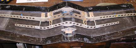

Default Composite corsair wing
The wing plug was a Foam balsa design.

The wing was done in one piece. It is 54" span. The 109 im working on will have an 80" span and will have plug in glass wings. they will be joined at the scale location.

SCALECRAFT, are those the spars in the female mold for the Corsair wing? Very nice! I am trying to visualize how you went from plug to mold. What kind of parting board did you use?

The parting board that we used at the time was a PVC 1/4" plastic that was heated for the curved section of the wing.
Now days you can use anything that is non porous and will not soak up the wax/pva barrier. I have a freind that uses styrene sheet that is shored up to the plug.
Takes time but yields a almost seamless joint.
See vicrc.com for some good pics of molds. He is a local guy that knows what he's doing.
