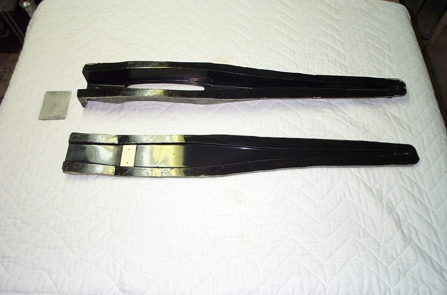

I am inclined to agree with that. I have never used "Paint" of any sort as the mold surface. I always us an epoxy gelcoat. I make the gelcoat from the resin and graphite powder. The result is a hard glossy surface.
Ed S
