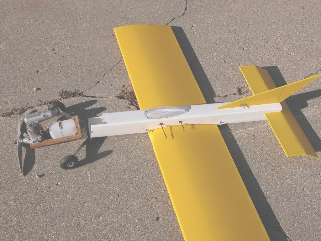

With the political season upon us and the proliferation of coreplast signs has anybody desigend a Spad type trainer for a larger engine like the Fox 35? I have the plans for the Man Win trainer which is geat for the Cox Black Widow but would like to see a trainer with a coreplast built up wing. If no plans what would be a good wingspan for something like this.

I designed a SPAD trainer for my Fox .35. It has a built-up wing with a 48" span and 10" chord and a drainpipe fuselage. It is too heavy for a stunt trainer with the .35, which will just get it off the ground. I upgraded to an OS .40 and then to an OS .46LAS.
Its not a bad trainer but not a good stunt trainer as I had hoped. It stops flying real easy if you try to turn too hard.
It might be a better plane with a light weight .60.

I built a plain a few years ago for a .35 Enya engine. It is all coroplast the fuselage is 10mm, the stab and rudder are 4mm and the wing is 2mm. The plane float very nicely, I am not a good stunt pilot but it will do 8's inside and outside loops and flies just as well inverted as upright.
The plane has a 48" wing span with a 12 cord for 576 sq. in. it weights in at 32 oz when the tank is empty. In my opinion it would be a fantastic trainer or stunt plane. But it would never win anything on appearance
