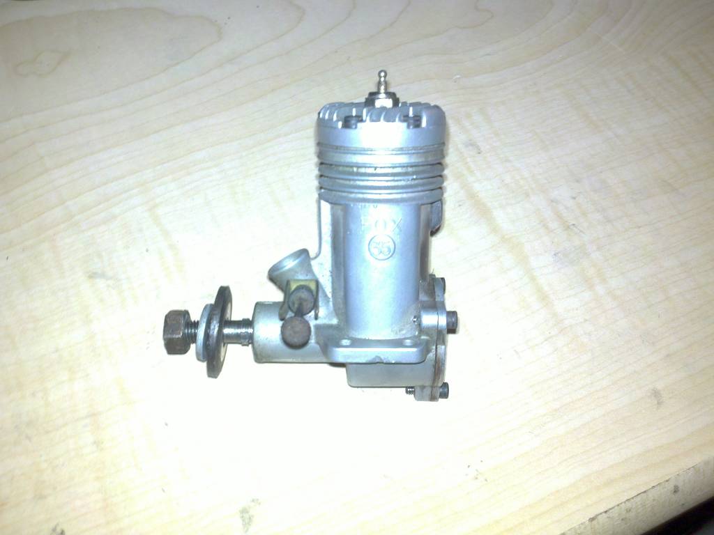

here are a few pics

Yep, that is a Fox.35, the classic stunt engine. Get yourself a SIG Twister kit and a set of 60' lines and go have some grass roots stunt flyingfun. C/L rocks.

First thing to do is remove the head and reinstall it properly. I doubt it will turn over as it is right now.[:@]

What contolliner said. With the head that way you might get $10. That is an early model, early 1950's, which makes it more or less valuable depending. Check the competed auctions on eBay to get an idea of price.

Jim, I'd have placed it a bit later: late 50's-early 60's? ...Splined prop driver... ...May also have cylinder exhaust opening narrower than the stack.
To A2Helos, just a check list: The piston has a low "fence" (baffle) across its top that goes on the side opposite the exhaust port. The head should have a groove to match the baffle. With those set right, the head fins run front to back, not angled.
A positive - looks like the head bolts were changed to Allen heads. Much easier to work with than the Phillips (or Reed&Prince?) originals.
