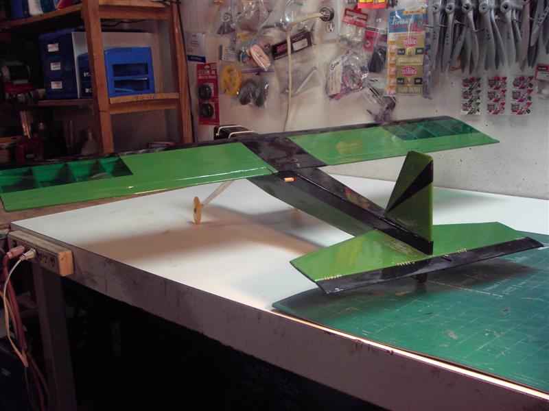

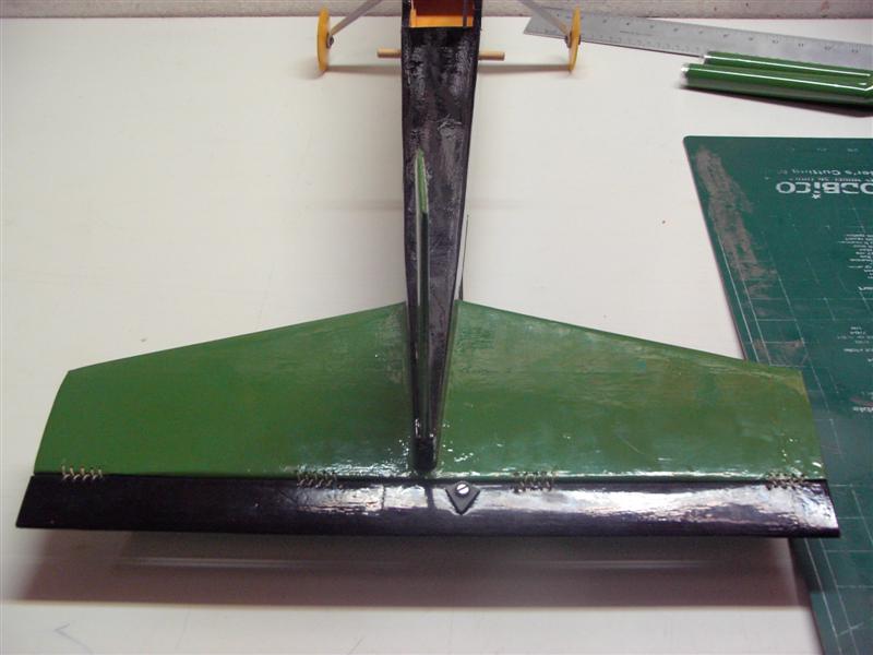

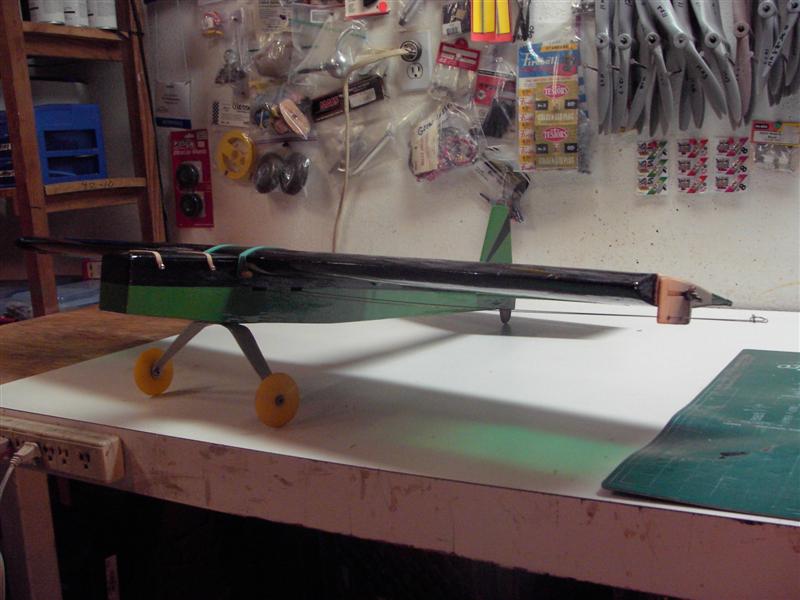

Last week end one of the fellows daughter about 12 I think got a shot at it during the during the Ringmaster flyathon and apparently she got totally excited about it and turning it into her 4H project.
She is heavily involed in 4H for some years and apparently this kind of project and 4H presentation does fit under some sort of aerospace catagory.
Anyway Her pop (one of my past RC students) asked me to put together a trainer for her that would fly very slowly and strictly an around the pole type that could be flown on sixty foot lines.
The plan is to use a Magnum .15 RC engine that he has and the deal is I would bash an airplane for that mission and here it is just finished it tonight.
The fuse is a left over Quickee pylon ship and the wing is an unknown small sport aerobat for RC of some short. Had to do this thing quickly and the bash has taken about four days.
I provided a line slider to make the ship practical for the long lines in the common breezes and it is quickly adjustable with one wing nut for those calm mornings. Out thrust and fin rake are also employed.

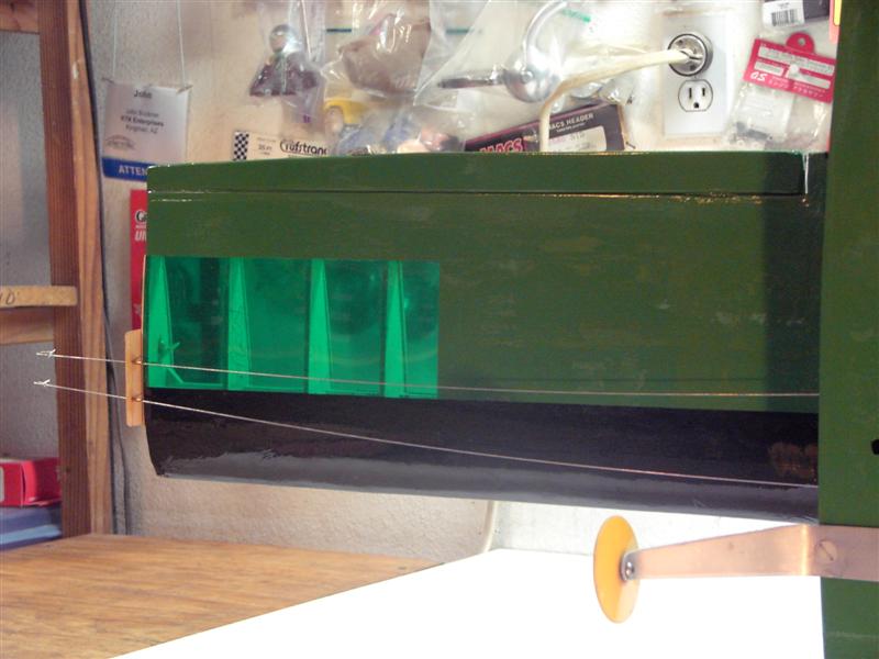

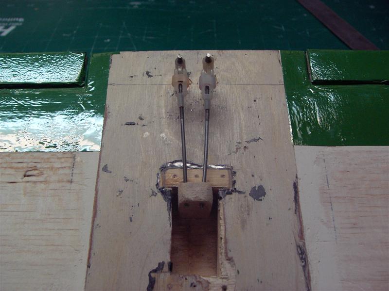

One interesting experiment are the old ailerons which I choose leave intact and provide dead ended rods and clevis and in this way not only can the roll be trimed but more importantly with this full camber control lift can be increased to slow down the flight or chamber can be reduced to increase flight speed a little'
Ready to go minus the engine prop and engine mount she weights 19 ounces Wing span is 42 inchs and wing area is 378 square inchs.

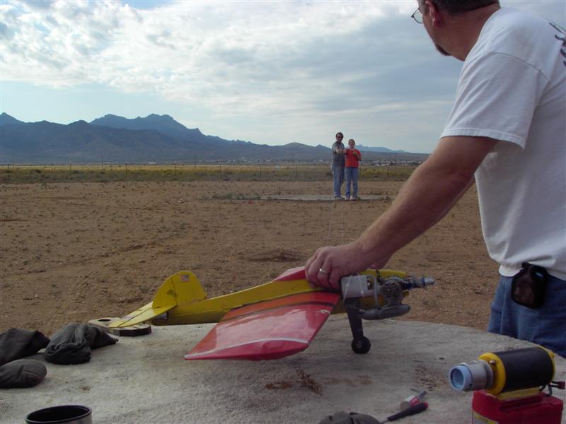

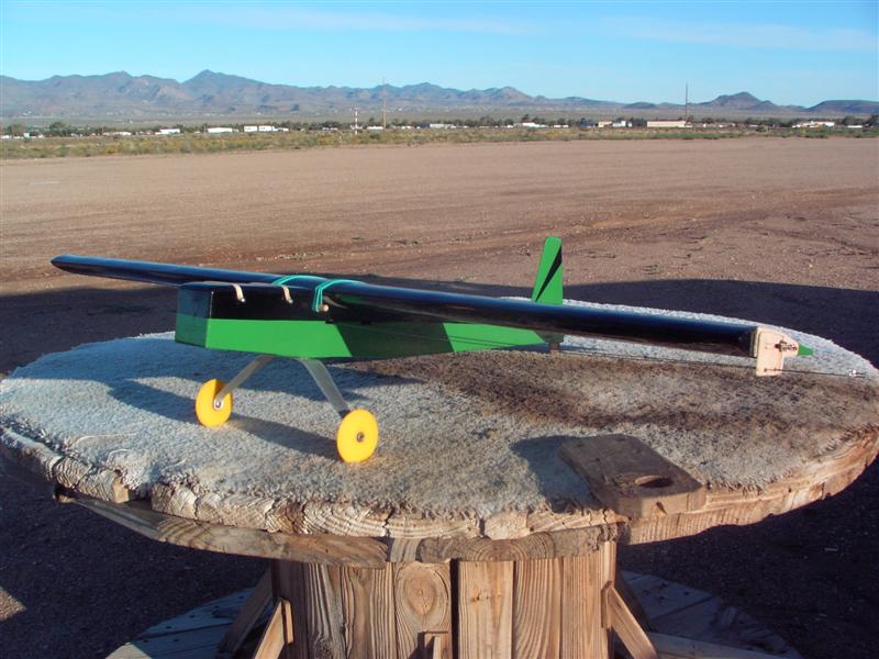

The 4H Trainer got its maiden this evening after sunset just two flights but they went great. Sorry no pictures this time.
This pic is at the field several days ago when I gave it to the Dad to hang the engine. Anyway the Dad called me about several hours ago shortly before dark to tell me he was gonna run the engine and when that went good he conned me into making a late run to the field and test the ship.
Arriving at the field the sun was very low and the breezes were around four miles per hour. These conditions sure would be a litmus test to see if this little ship could with that lowly 15RC engine could stay out there on those long sixty foot lines. I made the decision to adjust the line slider to the full rake position.
This proved to work out well and its a sweet little ship that flys quite slow but still stays out there on the unusually long lines for a fifteen. It was a pleasent first flight that I thoroughly enjoyed. My take off we delayed to just as the set was fully set to and we had just enough time for the dad to have a go since he is the one who will be mentoring the young lady.
The chamber controll wing was set at neutral with the symetrical airfoil and no changes were made but it will be interesting to explore a bit.
The daughter was extremely excited when she received the the airplane several days ago and has been researching modeling extensively for her presentations. She was not at this maiden flight since she was ill tonight. But I think its gonna be a great day at the official maiden and her first flights.

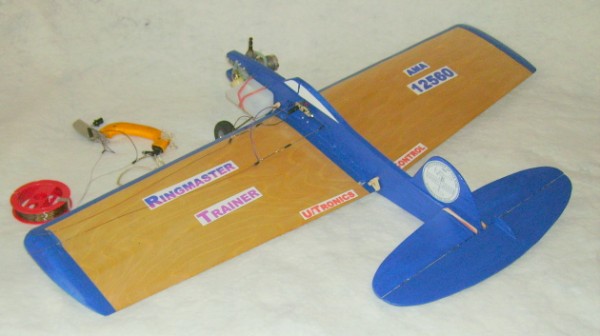

I have a good Control Line trainer. It is a Ringmaster Trainer designed by Pat King. It has the outline of a Ringmaster but the Wing and Tail are held on with rubber bands like a Free Flight model. It is powered by a Blue Bird 25. Lap tiles have been flown from 6 to 12 seconds per lap.
Mine has one of my U/Tronics Control single channel units and this allows the flight speed to be adjusted in flight and if the student pilot is having a problem they can shut the engine down. It is fun to do several Touch and Gos during a flight.
Clancy

The 4H project lives and is blooming beautifully. The 4H trainer is reaching its design goals very well and has just graduated its first student. The little ship is flying slowly and steady pulling the sixty footers and the speed is ideal.
The young ladies first two solo flights occured early AM this morning and to date there has been no incidents or anything close save for an occassional nose up rolling to a stop and one broken prop.
The solo was done in light winds perhaps three mph but with the line slider all the way to the rear it handled the breeze well even with the long lines.
